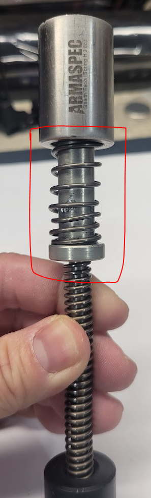

You are correct. I only use 2 loads and they are 110 Barnes TACTX for my supers and 220 Noslers for my subs. I think I found my problem last night and it is a bent 1st stage spring on my Armaspec. I will confirm this afternoon when I hit the range with another Armaspec Stealth H that I am using in my 6 ARC that has no damage.
After digging around more info I found 2 other guys that has had the same problem. Common theme is they all have pistol gas system .300 blackouts too.

I have no detent spring in so there's always some contact between front face of buffer and rear face of carrier. I took the same type of Armaspec from a different AR and my black works fine. It's a buffer issue.
