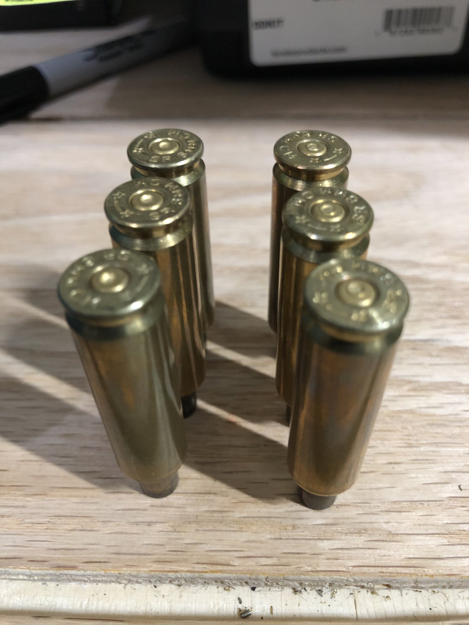

At the range today, I noticed quite a few of my fired cartridges had these light (ish) primer strikes with craters. I’m using a howa 1500 in 6mm CM and using Starline small primer brass, Winchester small primers and Hybrid 100V, slightly higher than medium charges. The pic has what looks to be normal strikes and the right are the weird ones. Cratered primers but a light strike. The left and right rounds were of the same powder/brass/primer/bullet/etc combo. Any thoughts? I got about 10 of these weird ones out of 45 rounds. I appreciate any ideas!
