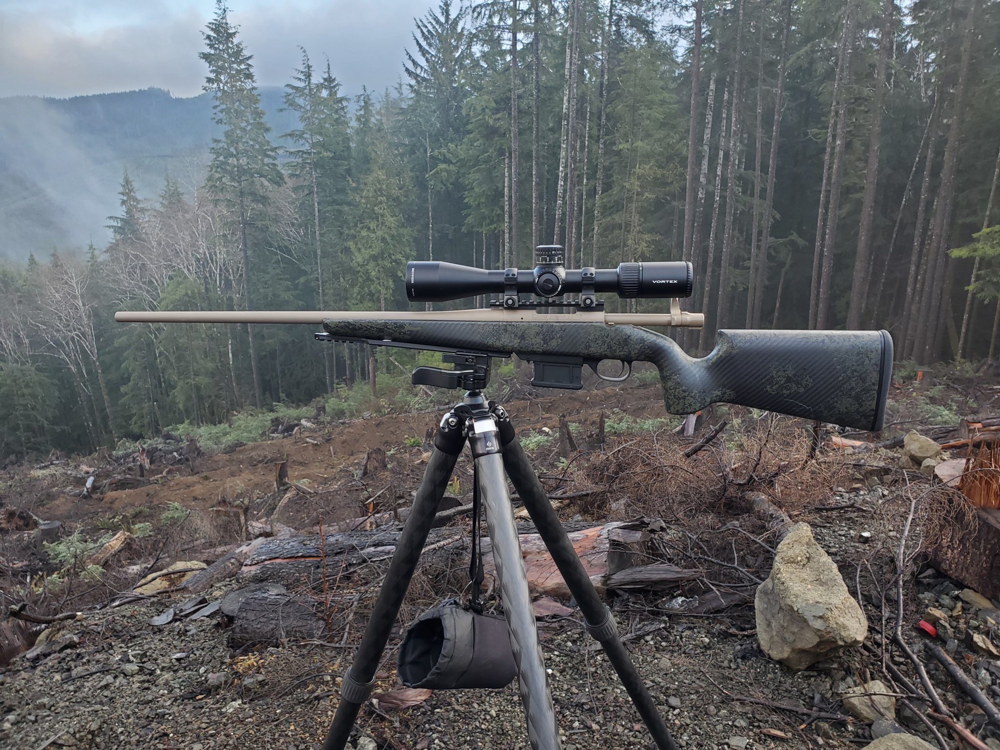

This is my kids grendel with a Stockysstocks carbon.
7lbs 9oz with the magazine empty. Scope is a fairly heavy PST Gen2 3-15 (28oz).

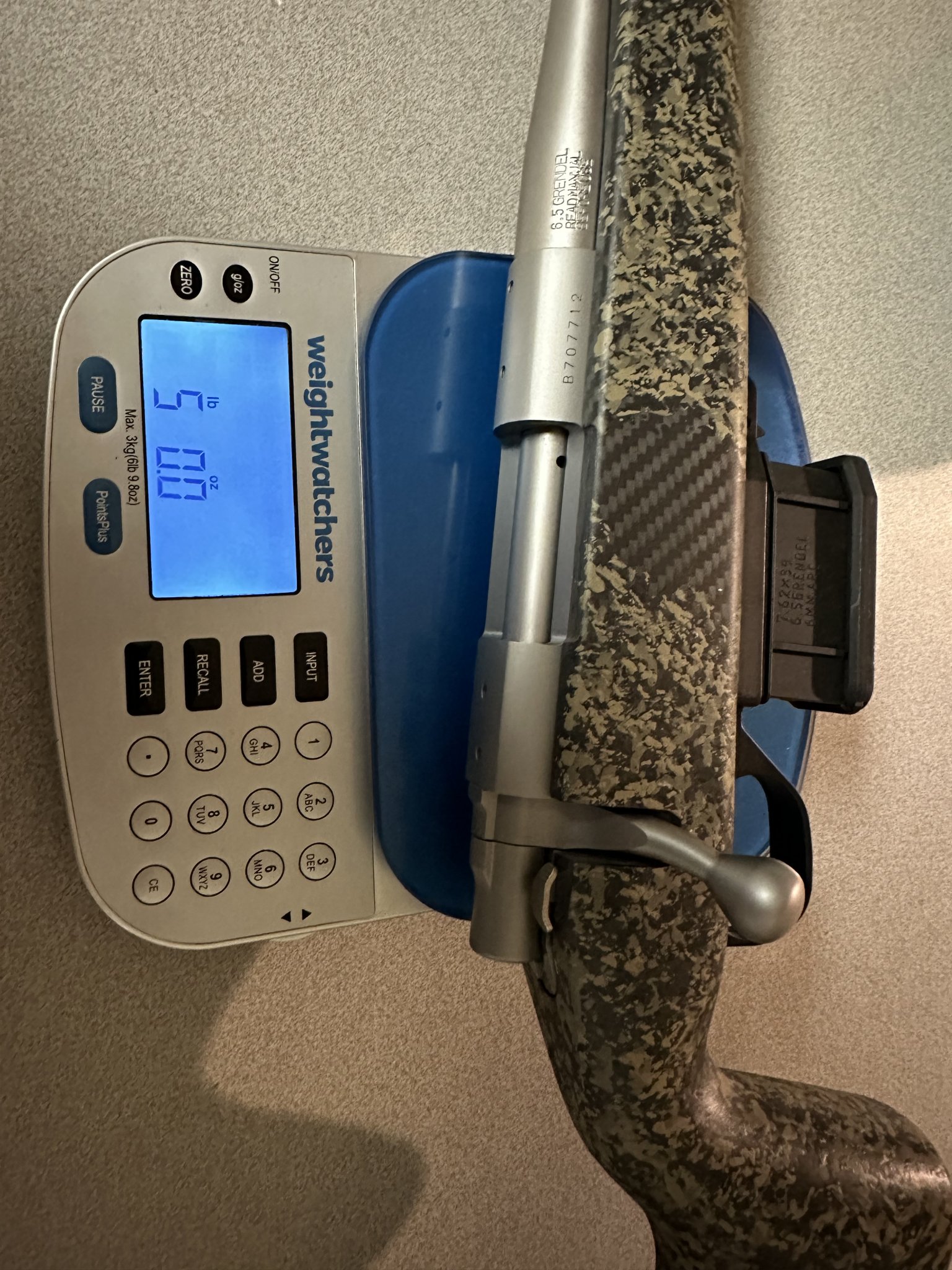

6.5 Grendel barreled action from Brownells with the 20” light weight barrel threaded 1/2-20 (FYI). Stocky’s Carbon VG stock. Exactly 5.0 lbs empty and un-scoped. Will cut barrel back to 18” and thread to 1/2-28 and add a hinged floor plate as soon as they become available. I have a Leupold VX-R 2-7x33 and a VX-6 2-12x42 on hand. Leaning towards the 2-7 for sheer weight advantage.

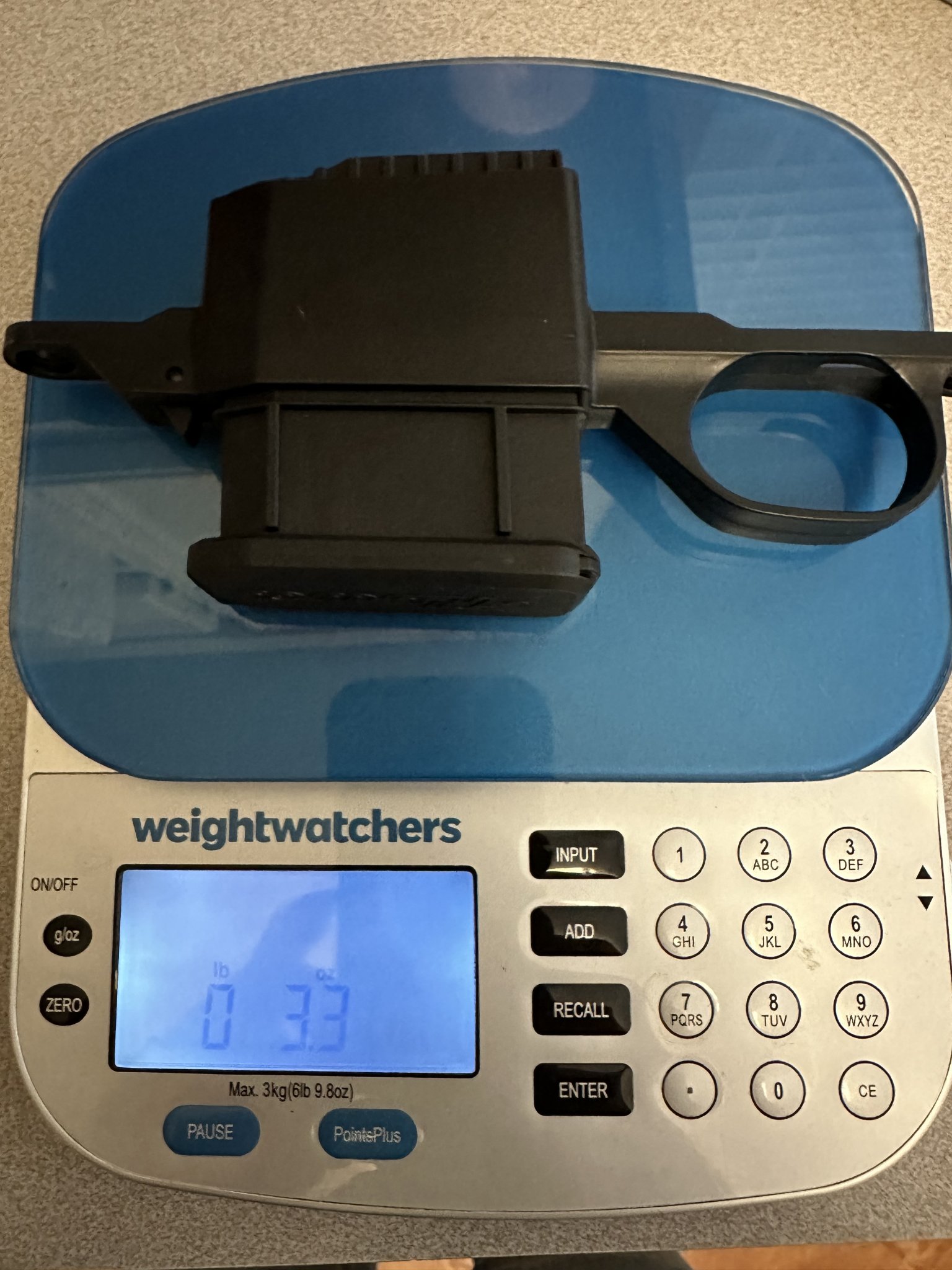

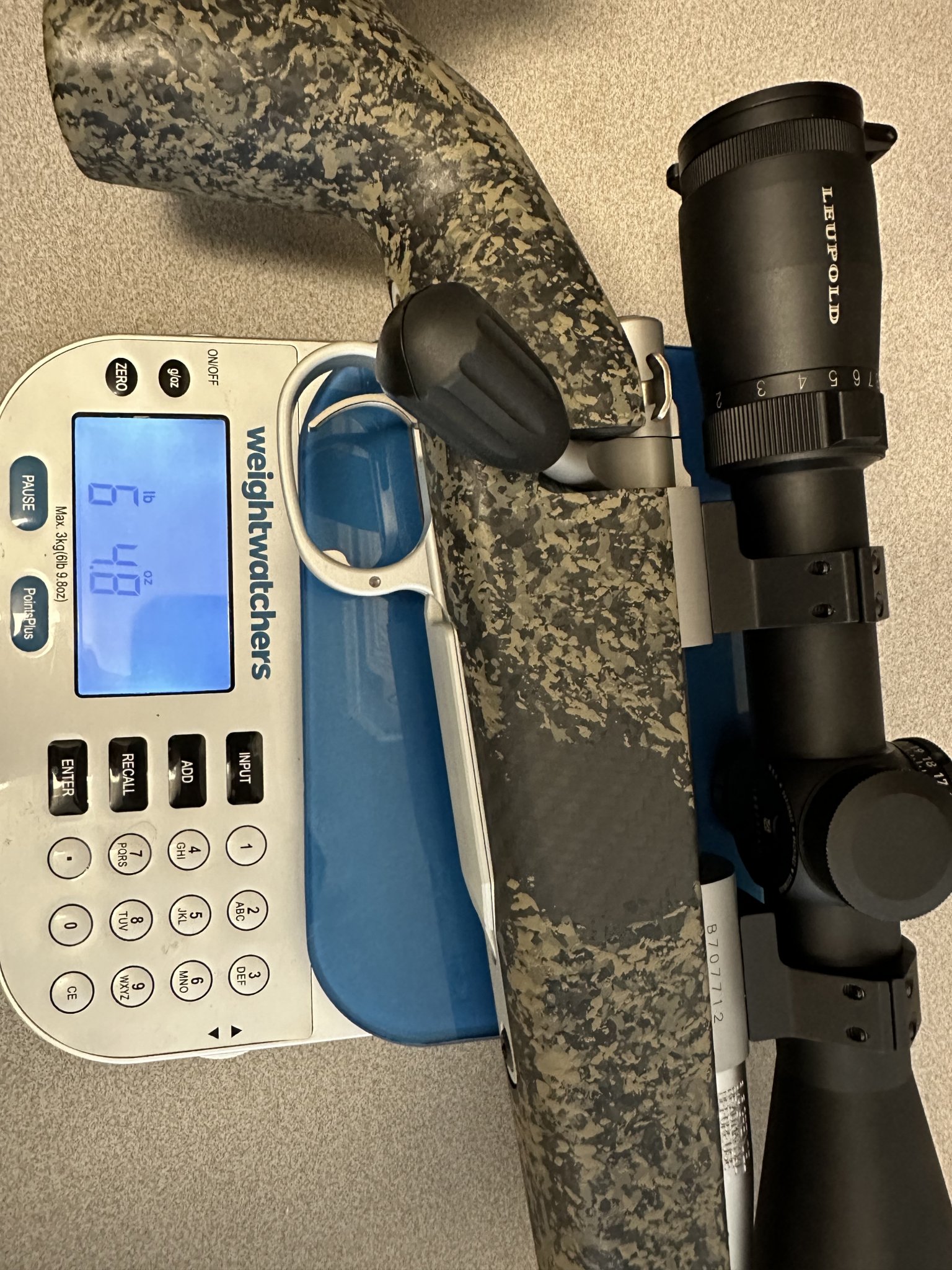

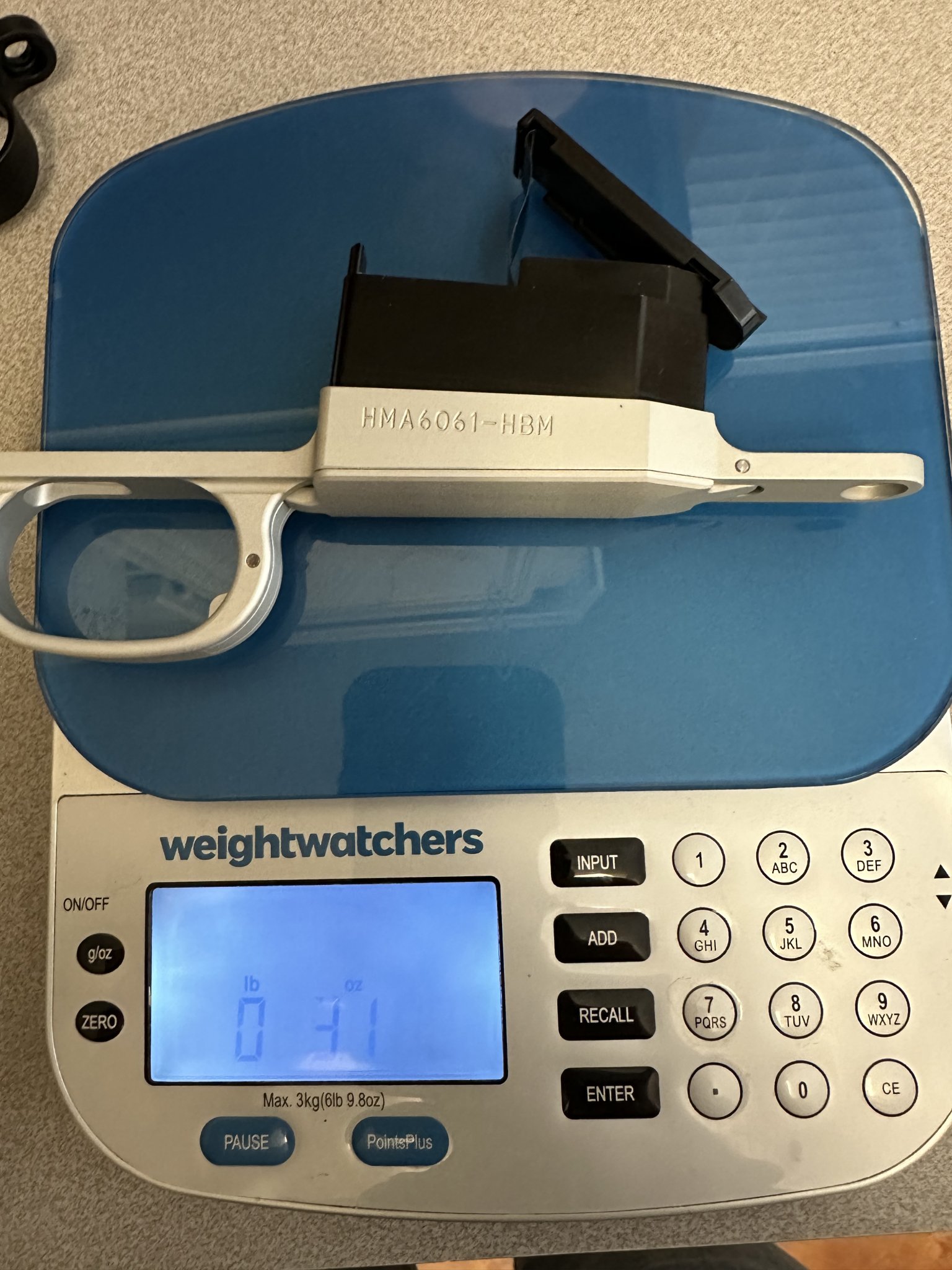

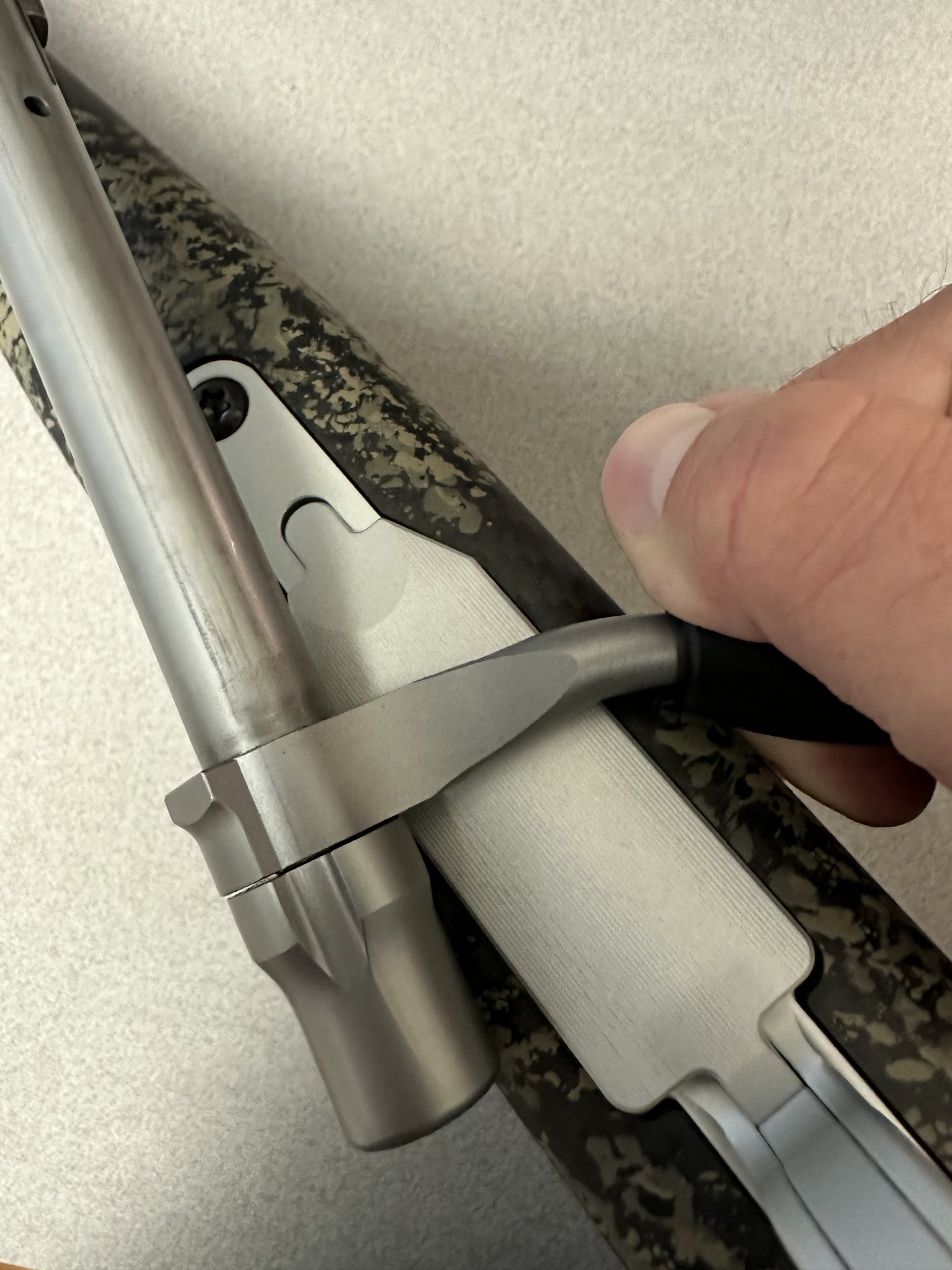

Howdy all! I just received my Jefferson Outdoor bottom metal. Fit and finish is very nice. If anything it could be just a little bit darker to match the matte silver finish on the action. Overall I am pleased with it. I also had the barrel shortened to 18” and threaded for the more common 1/2x28 and I added the clamp on bolt knob from Howa when they went on sale recently. Picture of overall weight is with Talley Lightweights and Leupold VX6 2-12x42 minus a sling.
