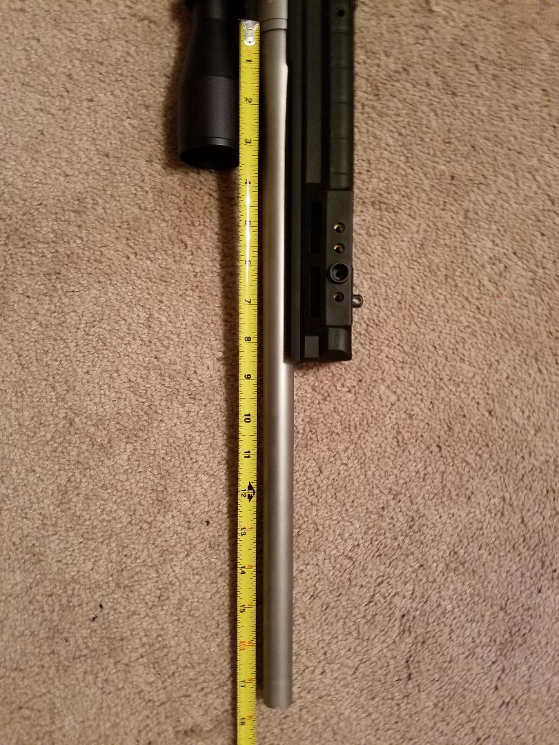

Lightest contour 16” barrel with 5/8 threads ?
I believe a Bartlein 3b would be the smallest profile that has enough meat for 5/8x24. Or you could go with a Carbon barrel.

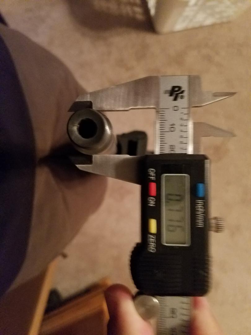

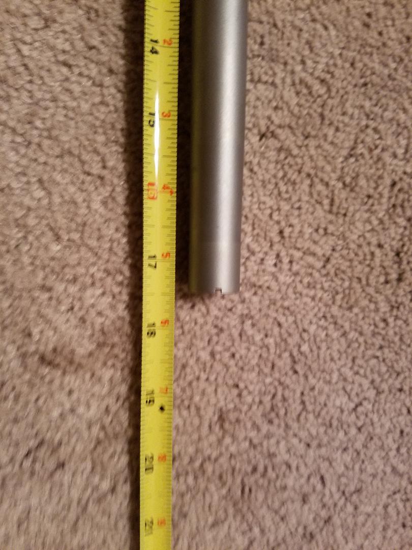

For suppressor alignment I like .100 shoulder, or .200 over thread major.
Every smith is going to have their own "comfort zone" with this (and for me depends somewhat on the device as well) just like min barrel wall thickness.
If you want to use a skinny barrel, try to source a mount that indexes off the muzzle instead of the barrel shoulder.

You can use a jam-nut on any muzzle that is .620" OD. Someone will probably say that's a bad idea but it's the same thing on the breech end for Savage, "remage" and other nutted barrel systems. Thread locker and witness marks will be your friend.

I’ve got several 18” Bartlien 2Bs ( Rem Mag Sporter) with 5/8s threads. They all are 6.5 bores and smaller and I’ve had zero issues.
Add: .725 behind the CB brakes with a 1” shank.
Reactions: deersniper
The bartlein sporter contours taper in front of the neck at .010 to 12 thousandths per inch. A 3b tapers at .010/inch, so it will have a .8” muzzle at 16”. A #3 tapers at .010/inch, so .770” at 16”. A 2B tapers at .012/inch, so .727 at 16”. And finally a 2b tapers at .011/inch, so .688” at 16”.
