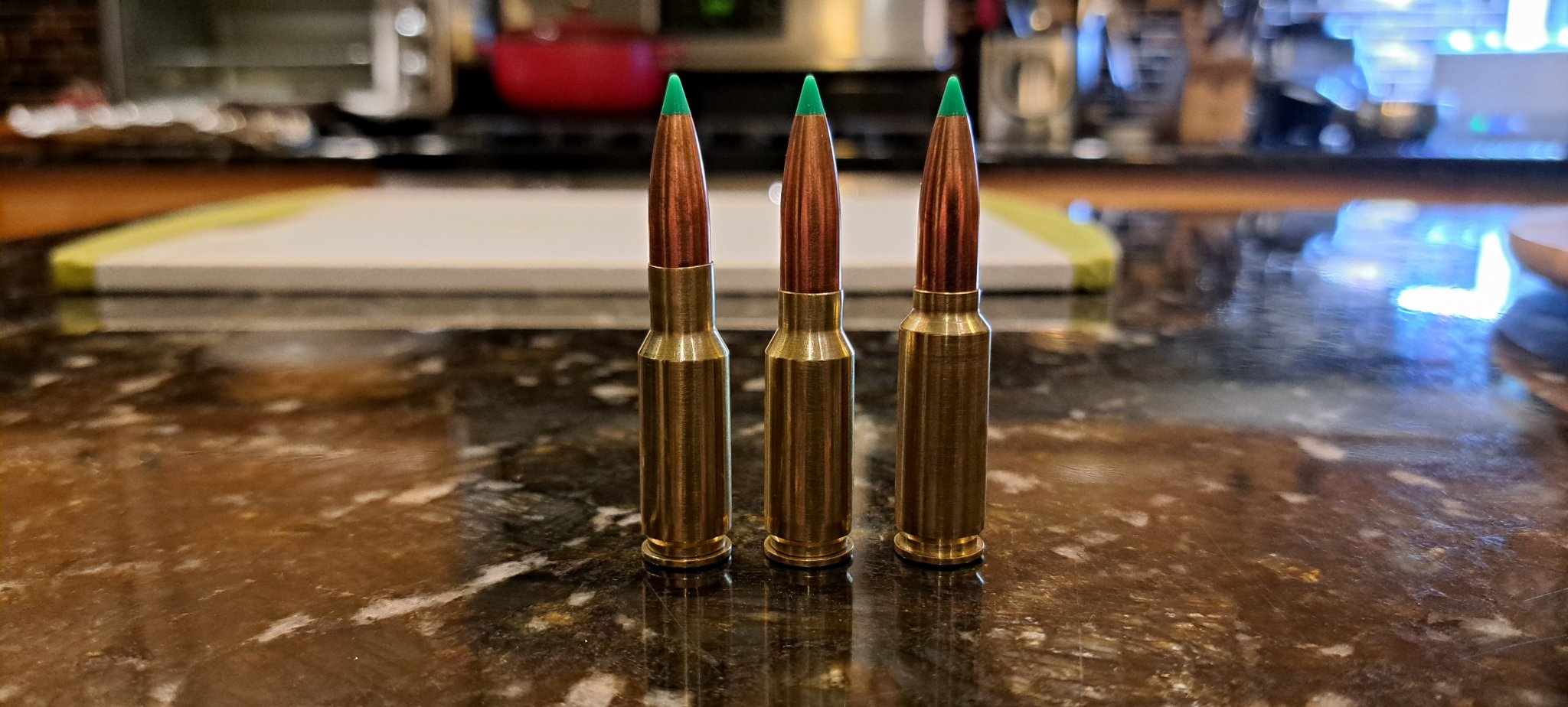

@Rthur
Can you help this guy out with a 30 LOL?
L-R:
30 BR 1.500" (Normal case length)
30 LOL 1.400" (30 BR cut to 1.4)
30 Dasher 1.400"
All loaded with a 125 Nosler BT.
2900fps with a 22" barrel.
Not sure what the stubby Dasher will do.
Thought I'd throw that option out there for you.

@Rthur
L-R:
30 Dasher 1.400"
I built a 30 RAR, more case capacity. 500 dia case of the trimed 450 bushmaster brass, feeds well with 450 bushmaster mags in an AR 15..
Would be even better in a short bolt action, uses a 308 bolt, with a .500" dia body & SR primers potential for excellent accuracy like a 30 BR with more capacity. Pictured: 30 RAR, 6 mm ARC, 6mm Dasher for size comparison.
