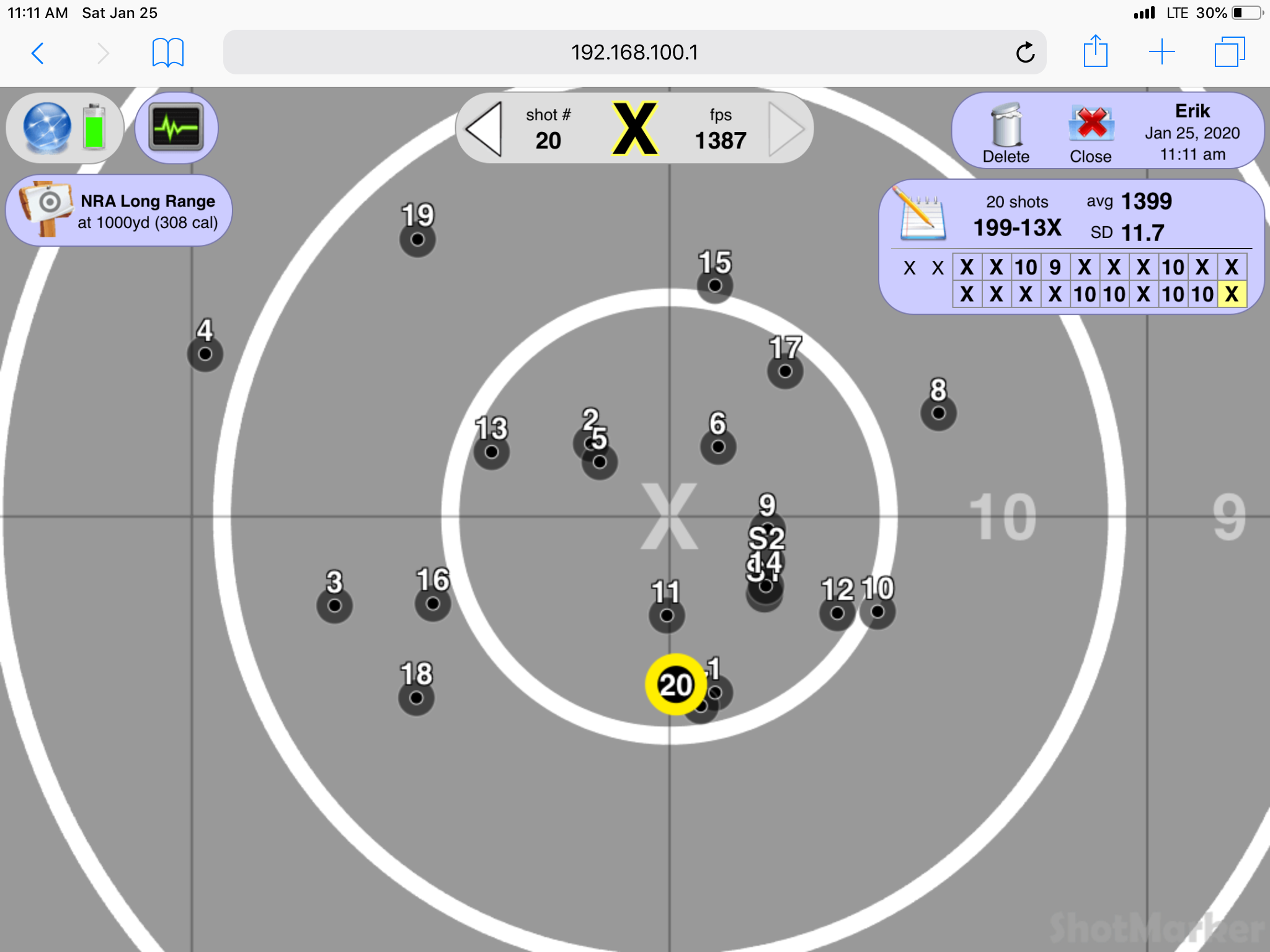

If you can get enough speed, you'llv be surprised by the performance. I shoot 155 hybrids and Sierra 2156's at around 3030, and they are both just great at 1000. They go transonic at right around 1200 yards in my part of the country, which is around 900' elevation. The attached target was shot with Hybrids last Saturday morning. Temp was 28º, with left wind varying from 2.75 to 4 minutes. I lost one out the left in a let-off, but kept the rest reasonably centered, and elevation was pretty good considering I was freezing my ass.
Those are some great results. I am just running a 20" barrel right now though, so I am not sure if I can get close to that speed. I am considering a longer barrel when it is time to replace the current one.

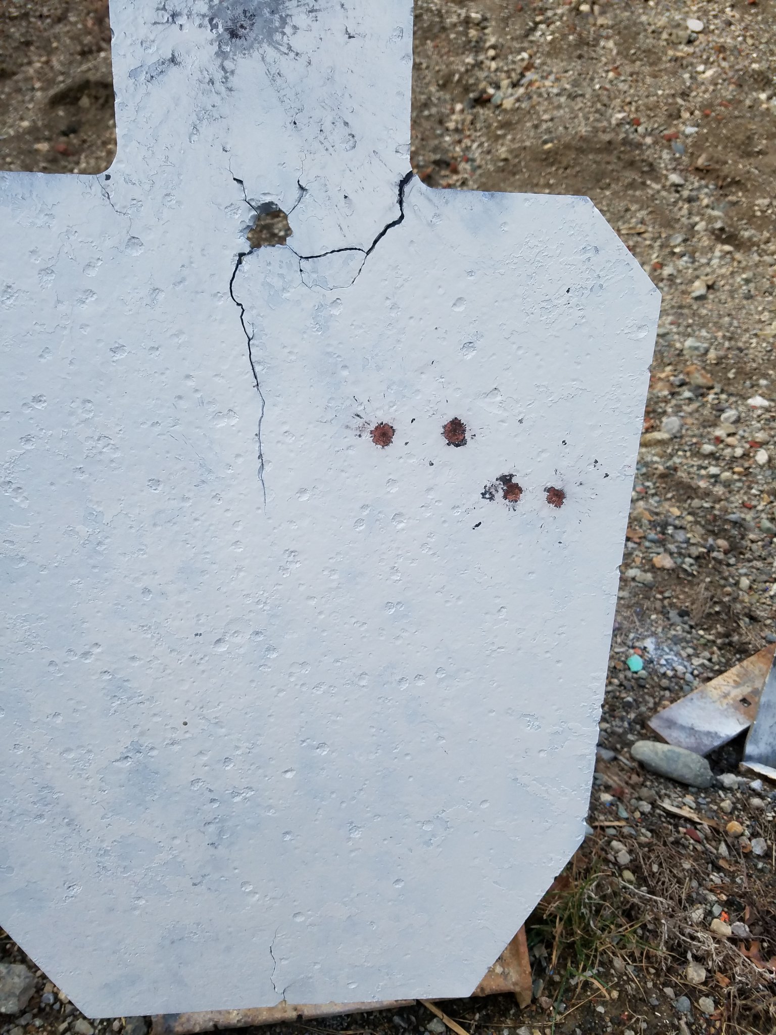

I have a Lehigh load in a 26" running 3035 with CFE and 2990 with RL15. I find them better in the wind than everything below the 195TMK and they hold vertical extremely well. I can push them faster but these are the speeds they shoot extremely well at for the charges.
BC works out to .522 to line up for me. They shoot well I've shot about 100 of these in the last 2 months. Recoil is less they are fast to target and you can tell they are your bullets on steel
