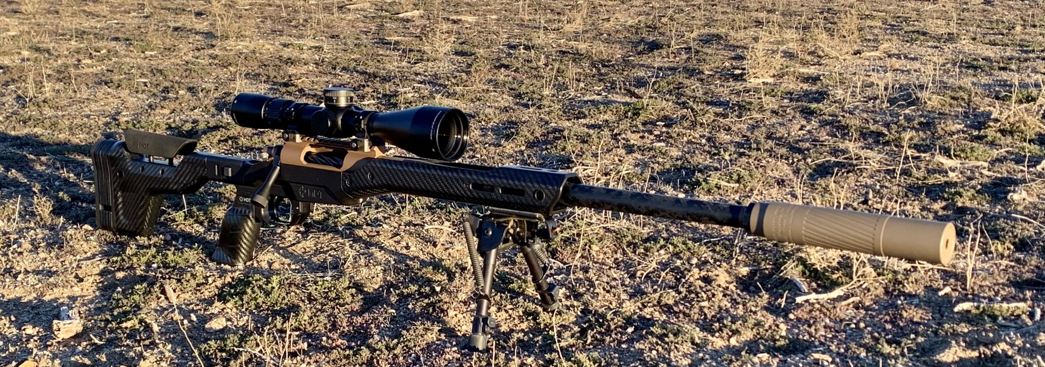

Here’s the HNT26 with a Lone Peak Razor, 20” Sendero lite Proof, and a Vortex LHT 4.5-22. 7lbs 12 oz without the can.

What mags do you run in the HNT26? That's a nice looking rifle and looks very similar to what I had imagined(except the gold action color lol).

MDT sells a polymer flush fit 3 rd mag for 308 sized cartridges. Same rifle as above.

Just a heads up, if it needs to be flush the Hawkins PRC mags barely fit inside the HNT26 but I did not check feeding with them. I typically run the Accurate 3 rounders which actually hold 4.

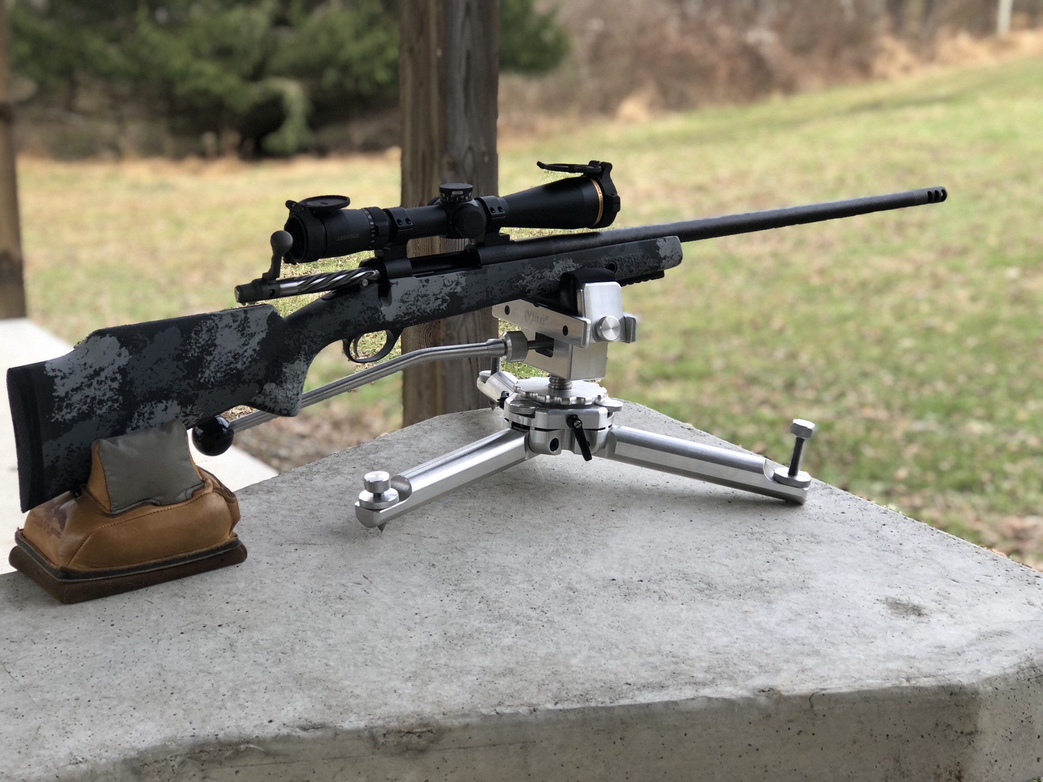

Here’s my sub 8lb 300wsm built of a Defiance Sheep Port intermediate length action and the matching Defiance bottom metal. Plenty of room in the box to set long bullets out far.
