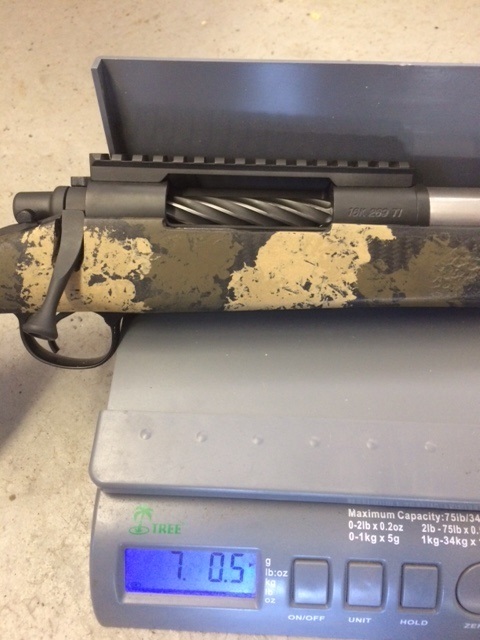

Just finished a 6.5 WSM as light as I can go with enough barrel for a 16 oz. suppressor.
Long action Pierce titanium action with titanium recoil lug and pinned aluminum rail, cerakoted with Elite Smoke
Manners EH1
Proof Research 1:8 26" carbon barrel
Timney Calvin Elite
Elk Meadow titanium muzzle brake
Remington BDL bottom metal

It's 7 lbs pretty much on the nose. The muzzle is threaded 5/8-24 so any thread-on muzzle brake fits. I've been shooting similar setups for two years with no issues.

I decided to change to the lighter titanium which necessitated a barrel change due to the new action's TPI being 18 vs 16. I've been getting 140 Elite Hunter and ELD's at 3300 fps and I'm a speed freak. I have all the stuff to reload for it and have been using one for the last couple years so really no other reason than I've already got the stuff. I might decide to play with a 6.5 Sherman Short at some point.
I like how light it is. Perfect for a hunting build. The bolt fit is not as tight as a Defiance which is good in the long. I found I had to push that Defiance straight in or it would bind a little. The bolt feel of the Pierce is a lot like the Kelbly.
