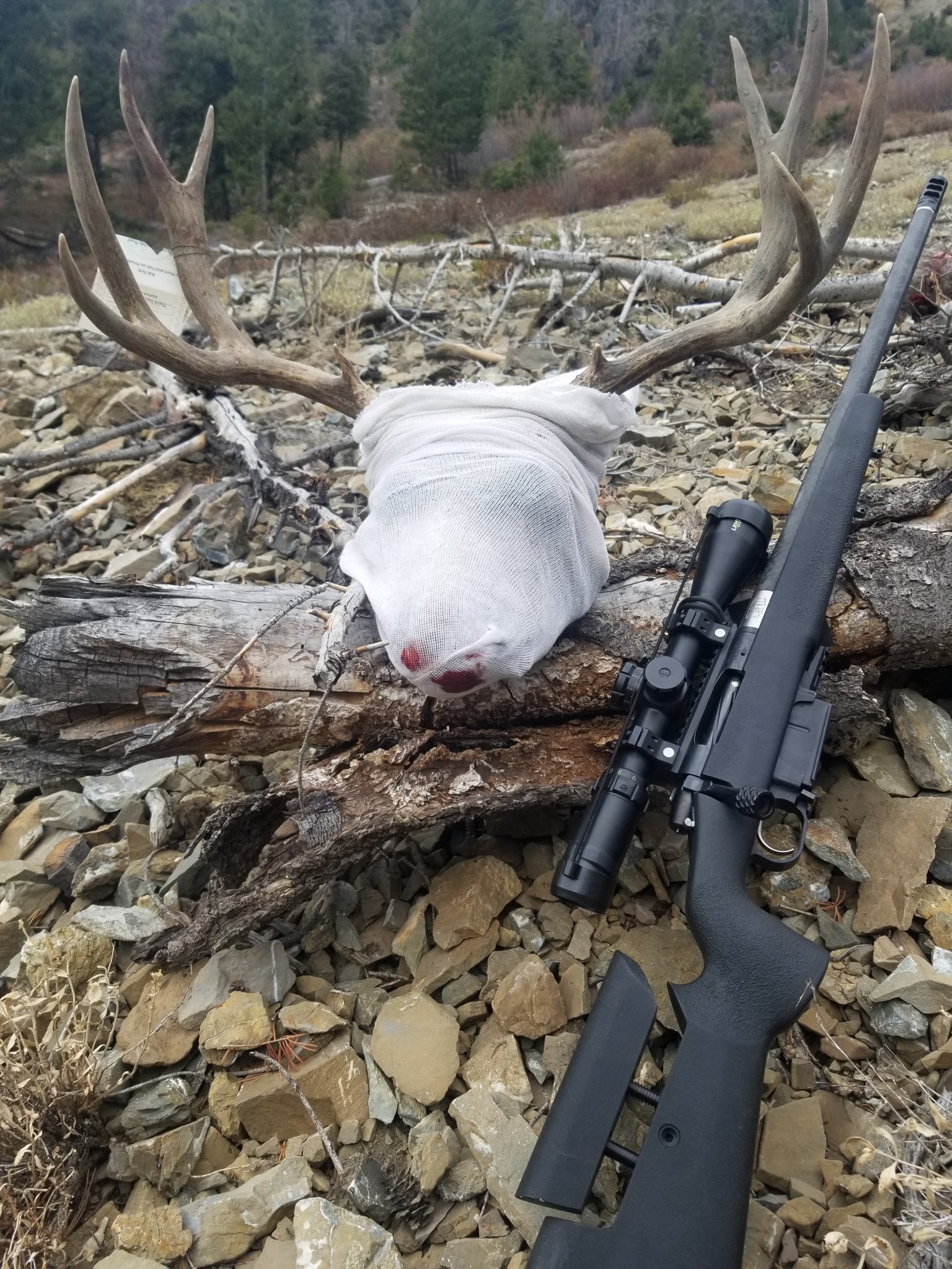

Kimber Montana in 7 WSM would be perfect, but a .280AI could do in a pinch.

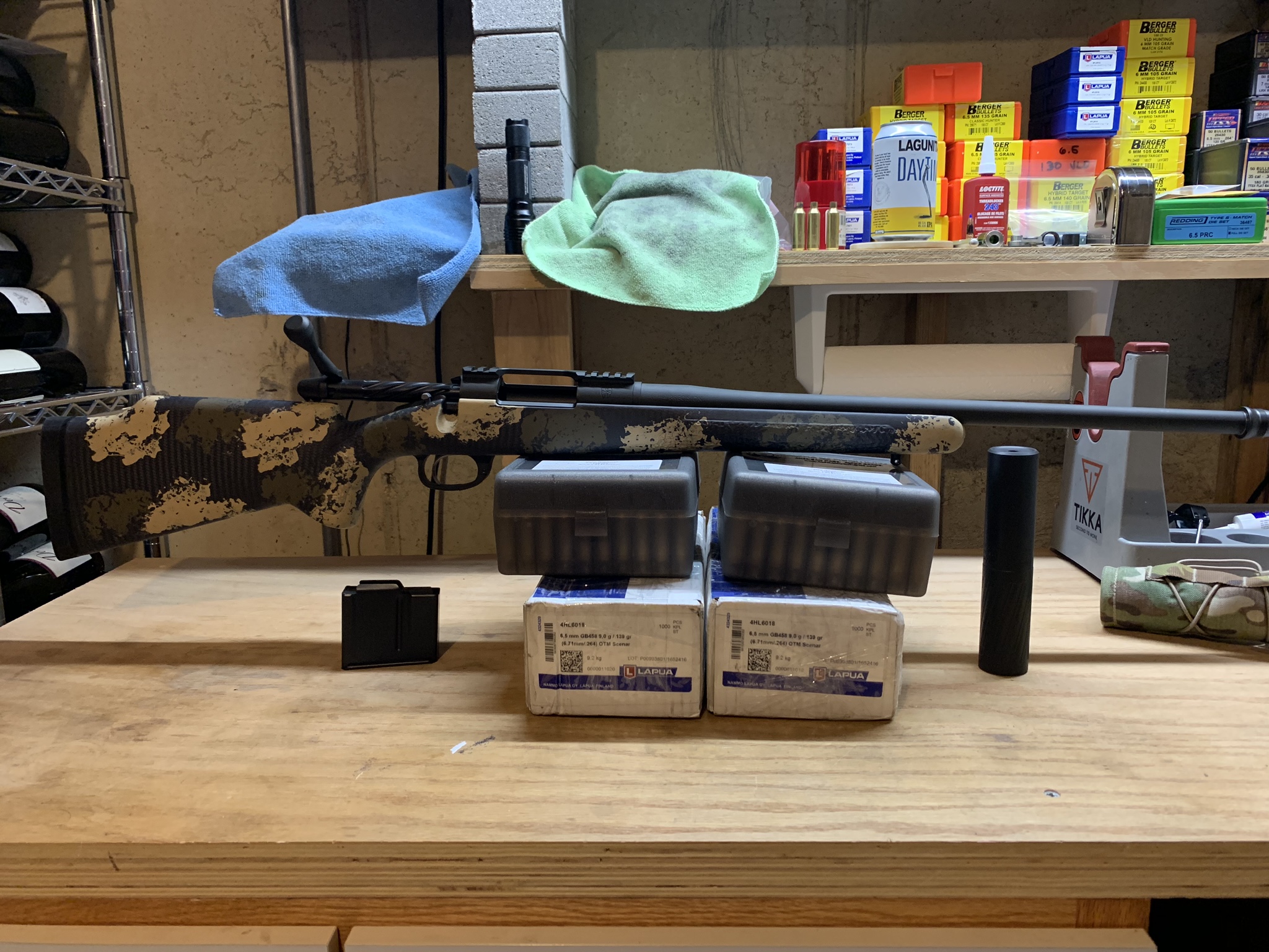

Tikka T3x Lite Stainless in 308.
20" barrel factory threaded
Suppressor
(Upgrade stock if you feel the need)
Sportsmatch Rings
S&B 10x42 or NF 2.5-10x42
Easy 500 yards shots possible..

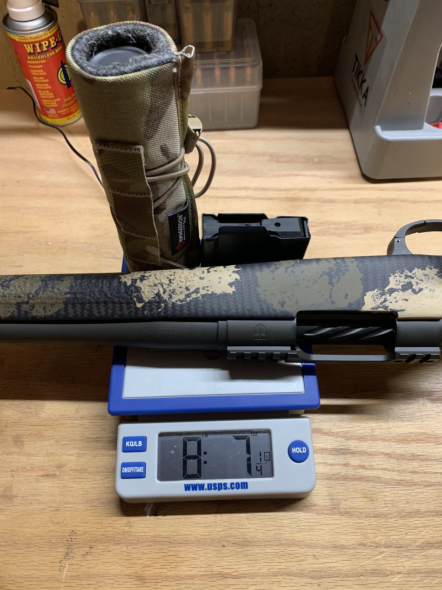

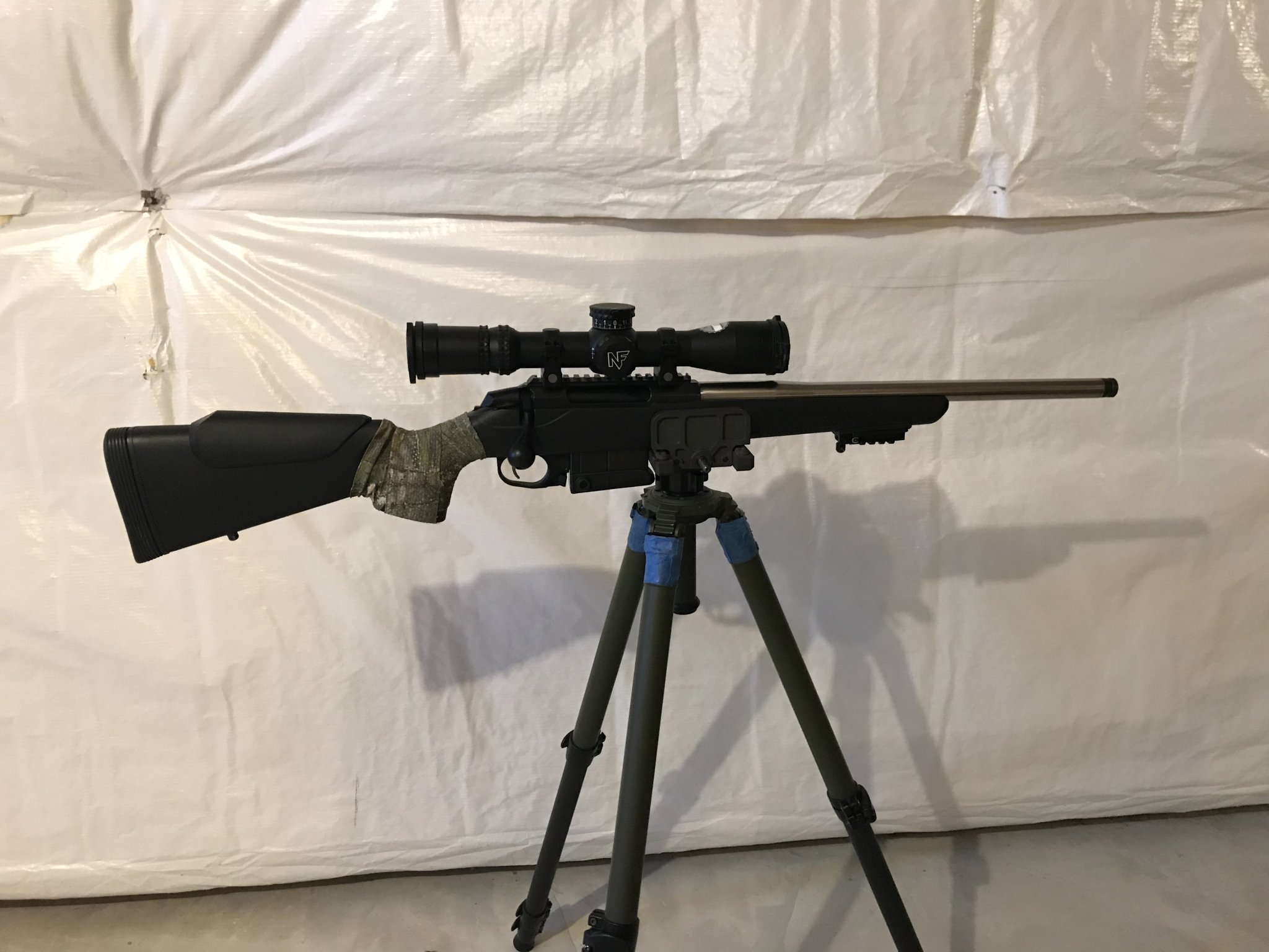

300 WM, 26" proof sendero, apr hunter action, ag composites alpine hunter. Weighs 7lb 3oz loaded no optic. It started with a vx5, but i wasn't happy with the tracking, so now its got a mark 5 on it.

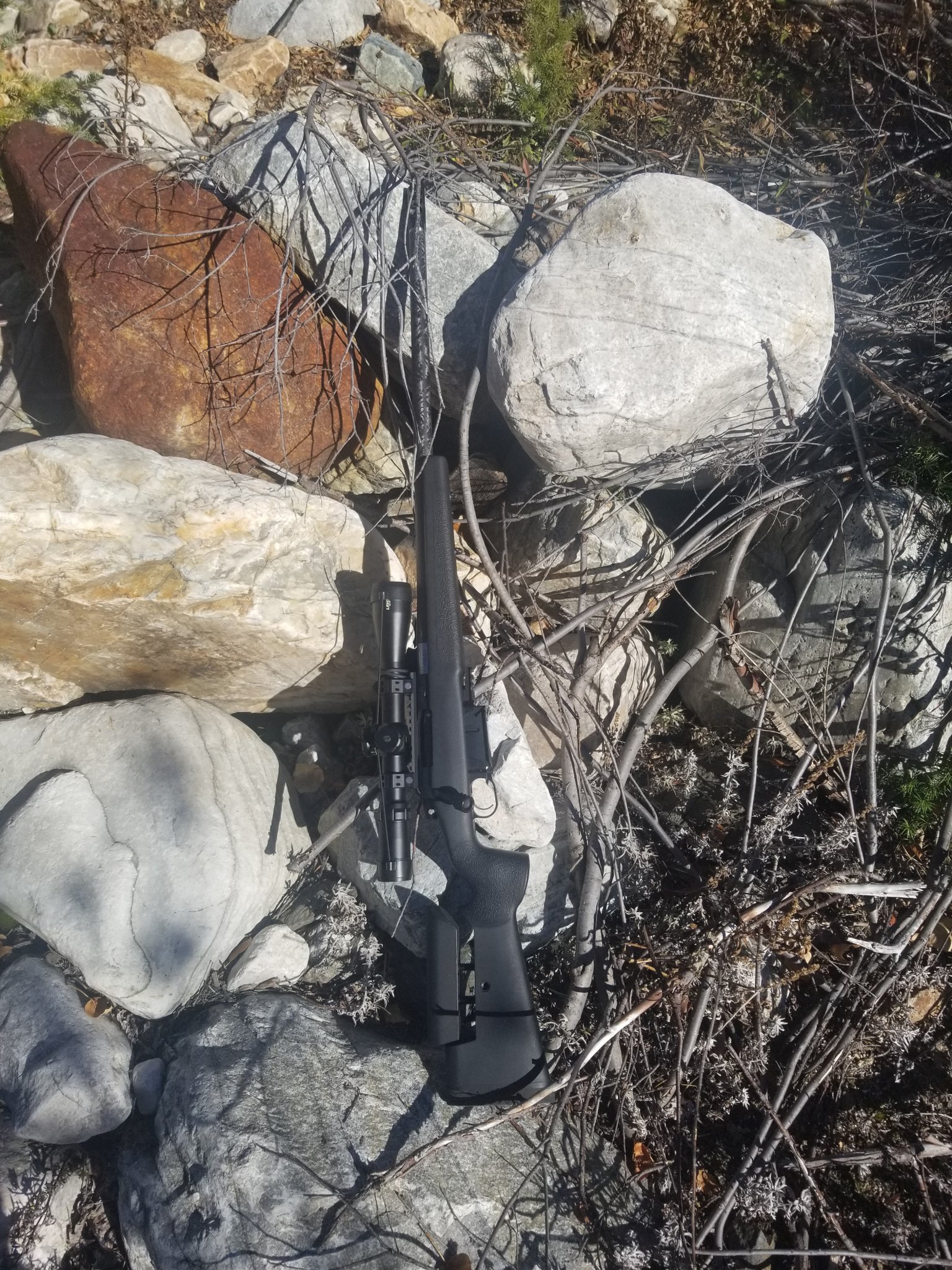

I went with a Kimber Montana. After a custom trigger guard and bolt handle and being rebored to 358win, it's under 6 pounds with a Swarovski 3-10x42 in Talley Lightweights. Perfect rifle for my uses.

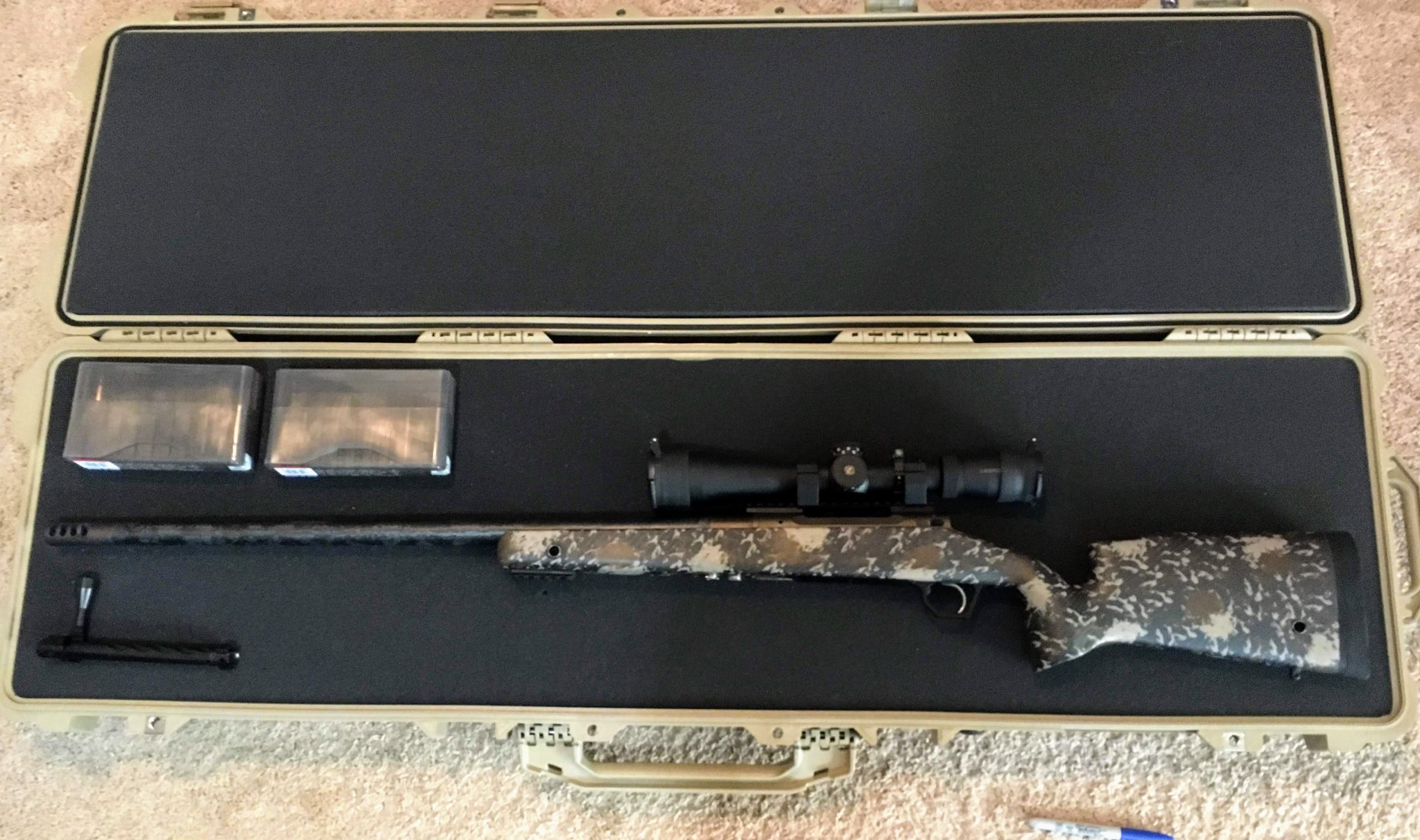

My 7ss:
ARC Nucleus Action
Proof 26" cf 8.44 twist
Area 419 brake
AG composite Adjustable Hunter
MK5 3.6-18
ARC M10 low rings
Mesa Precision bottom metal
Accurate 300 wsm mag
Trigger Tech Special
A couple buddies have similar builds as above, in 7SS, but with a lighter AG composite stock or different scope or action. All, theirs are all lighter than mine, one is lighter even with his bipod.

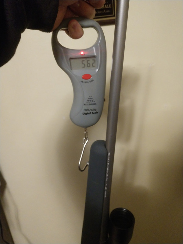

I am currently in the process of building a lightweight hunting rifle.
Chambered in 6.5 Creedmoor & 7 Sherman Max prefit barrels.
Action: Steel Lone Peak Arms Fuzion - Medium Length - BDL - Alpine Port
Bottom Metal: Lone Peak Arms/Hawkins Precision BDL Medium Metal Kit
Trigger: Trigger Tech Diamond
Stock: Mesa Precision - Altitude Stock
Barrel: 6.5 Creedmoor (22" Medium Palma Steel) & 7 Sherman Max (24" or 26" Carbon Fiber)
Muzzle Brake: Ultralight Jet Blast
Bolded
is what I currently have on hand with a weight of 6.5lbs. The stock should be here in another week or two and will bring the total weight to 8.15lbs.
I was anticipating the action and BDL weighting less. The action tips the scale at 32.56oz & BDL at 6.66oz. I thought the combo would be 5-6oz lighter.
The reason why I went with a steel barrel on the 6.5 Creedmoor because it will see more range time than hunting. I'll get another barrel spun up in CF which will drop the barrel weight by 1lb.

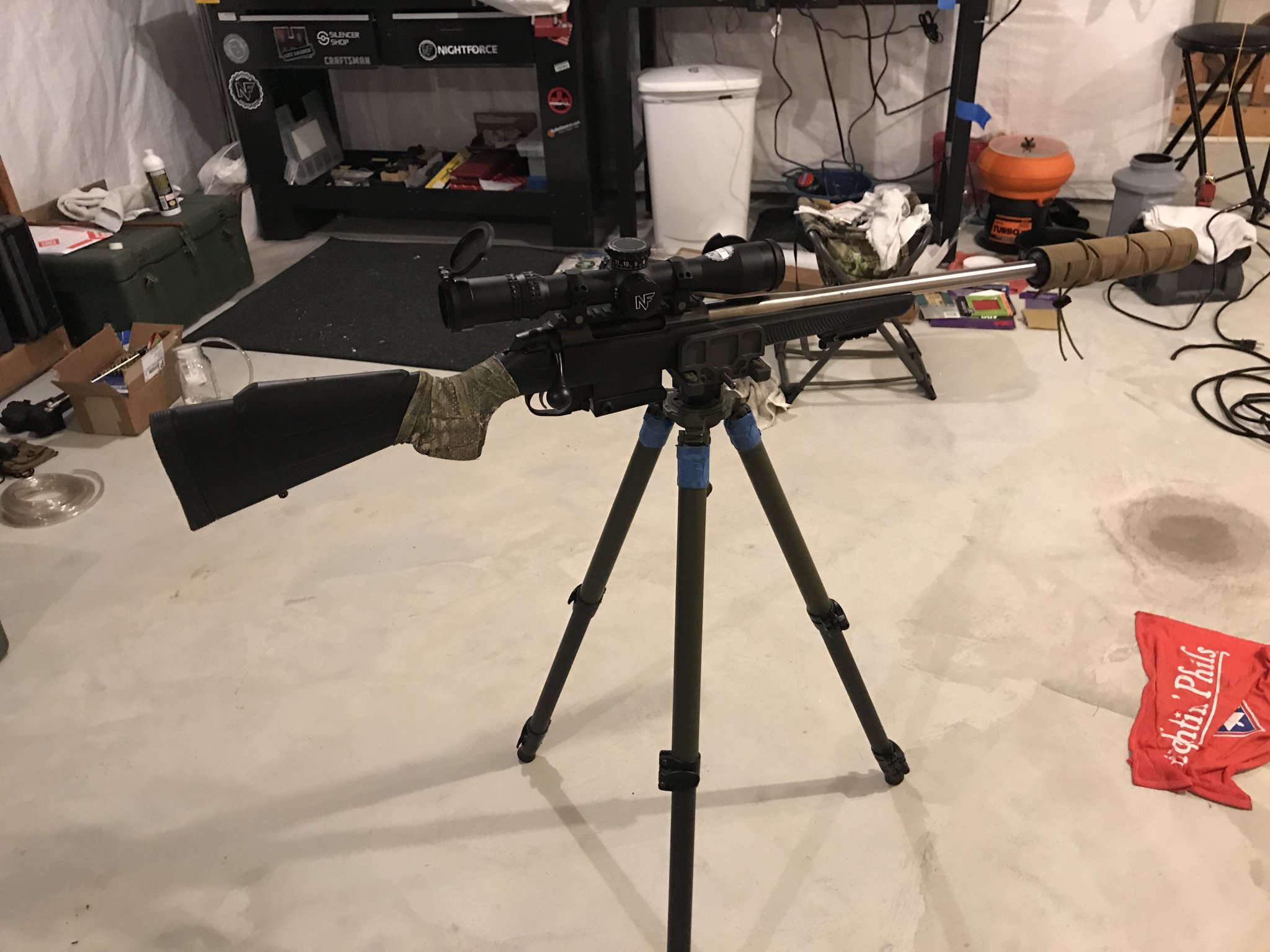

I ended up rebarreling my tikka tac a1 to an 18” light palma in straight 7mm-08 and put it in a ctr stock. Weight with the NF ATACR 4-16x42 is 10lbs1oz which while might not be a true “light weight” build, it is showing to be a perfect balance of weight/handy/stout enough for steady hold and range use. Especially with my TBAC on.

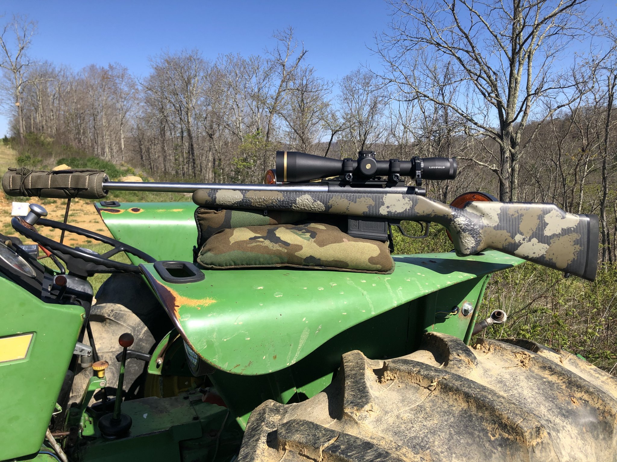

My Kimber Montana in 358win with a Swarovski 3-10x42 ontop.
I guess lightweight means different things for different shooters. Anything 7-10lbs all up is average IMO. Anything over 10lbs scoped is heavy IMO for a hunting rifle.
you don’t see many .358s these days but I always thought that was a cool cartridge, what is your barrel length and what bullet do you use most often?
I left the barrel at 22" for now.
Last year was the first year owning the rifle. I hunted with it as a 308win and 22" barrel. I didn't feel the length was bothersome so I left it 22" when I had the rebore/rechamber done by JES reboring.
I haven't hunted with it as a 358 and haven't decided on a bullet. I really wanted to run 225gr Woodleigh Round nosed but I am having feeding issues with 200gr Hornady round nosed I found cheap enough to run some rounds through the bore/brass. Forget what side of the mag gives a fit when feeding ...I don't know think longer bullets would have the issue though...and know a few guys running rebored Montana's without issue....
Actually using Lapua 308 brass since I don't own a 308 right now lol.
I've been carrying a 35 Whelen for a while now and just love how it hammers. Wanted a smaller and much lighter rig and that's where I ended up.
180gr TTSX is intriguing. I don't know if I will get the expansion I wanna see though. I'm a weirdo...I wanna hit em hard, open em up and have an exit. Which is why the Woodleigh Round nosed was my pick. Love Accubonds but hear even the 200gr Accubond is too long. I may have to try em.
And may try the 180gr TTSX. A 200gr partition would be awesome. 225gr partitions are another possibility to try.
Obviously just my experience but the Barnes hunting bullets in multiple different calibers have all been hammers for me. I’ve gotten to the point I don’t think I’ll ever hunt with anything else.
Reactions: Mauser06
Appreciate that! I've heard it both ways on Barnes bullets. I think I definitely need to try them for myself. I'd actually like to get away from lead for hunting bullets for a variety of reasons. When it comes to hunting bullets all I care about is performance. I like consistency. I want to know what it'll do and it's capabilities. Accubonds and partitions have been my favorites.
One reason I went with the 358win opposed to the 338fed was bullets. Most of the 338 bullets are built for magnum speeds. Where as the 358 bullets vary from 180-310gr for a variety of different speeds.

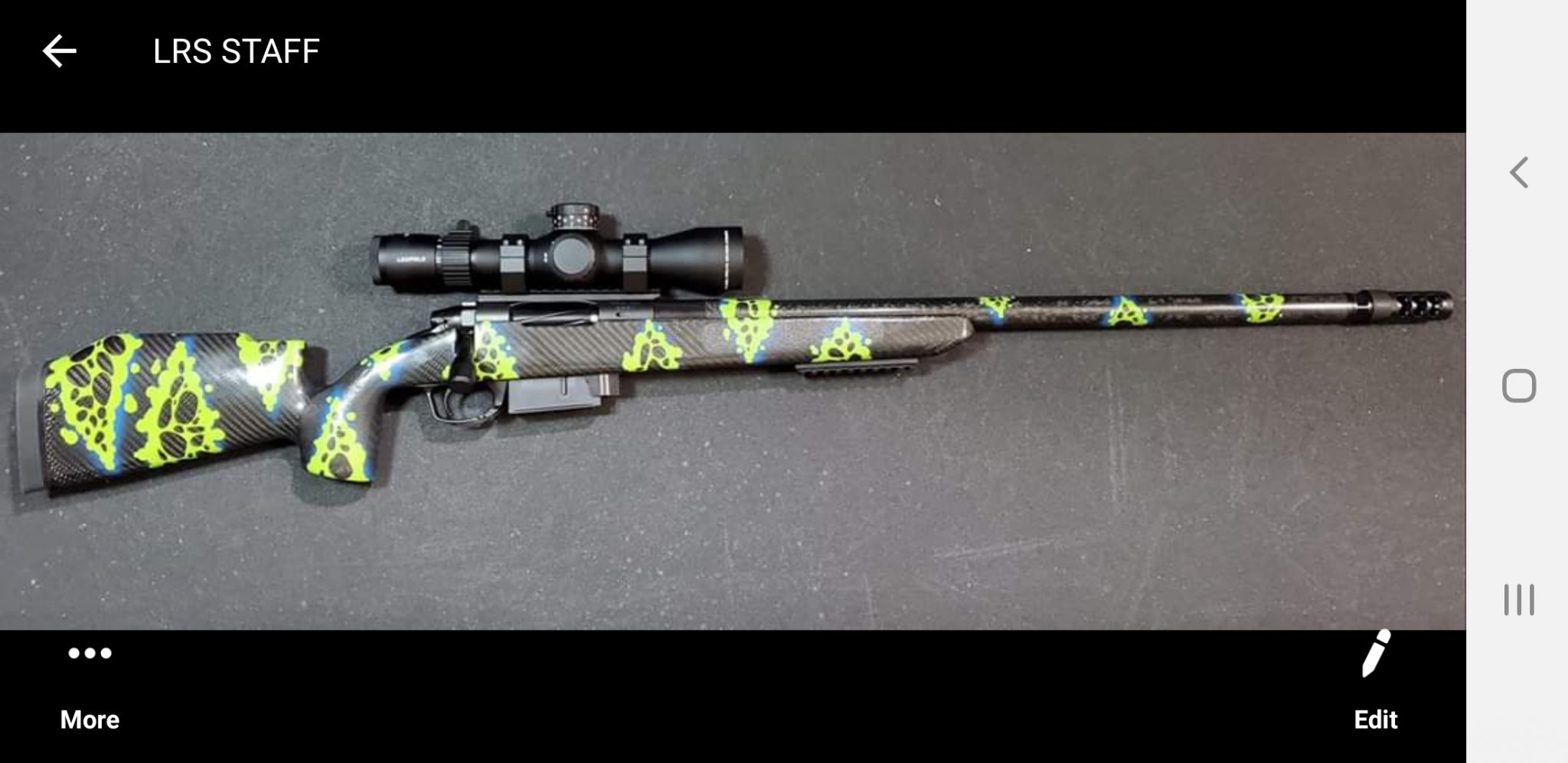

I'm not the best at identifying all the parts. Can you give us the details of your build please?
Sure, ultralight Jet Blast brake from PVA, Proof carbon 26" Sendero, Bighorn Origin action, McMillan A3 carbon fiber stock with Stockdoc cheek piece, Triggertech Special, Hawkins Precision bottom metal, Accuratemag 300WSM 3rd mag, built by Short Action Customs. Rings are Hawkins Precision, scope is Bushnell LRHSi 4.5-18x44.
