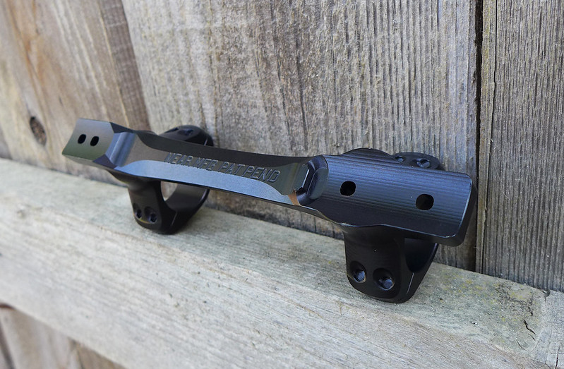

The Near Alphahunter does have lugs. I was searching around and found this review:
Here are pics for posterity:
On his picatinny bases the bolt holes on the base are oval so one can abut the lug to the edge of the ejection slot. I bet that’s how the Alphahunter is too.
Edit: yeah, you can see that in the upside-down pic above.

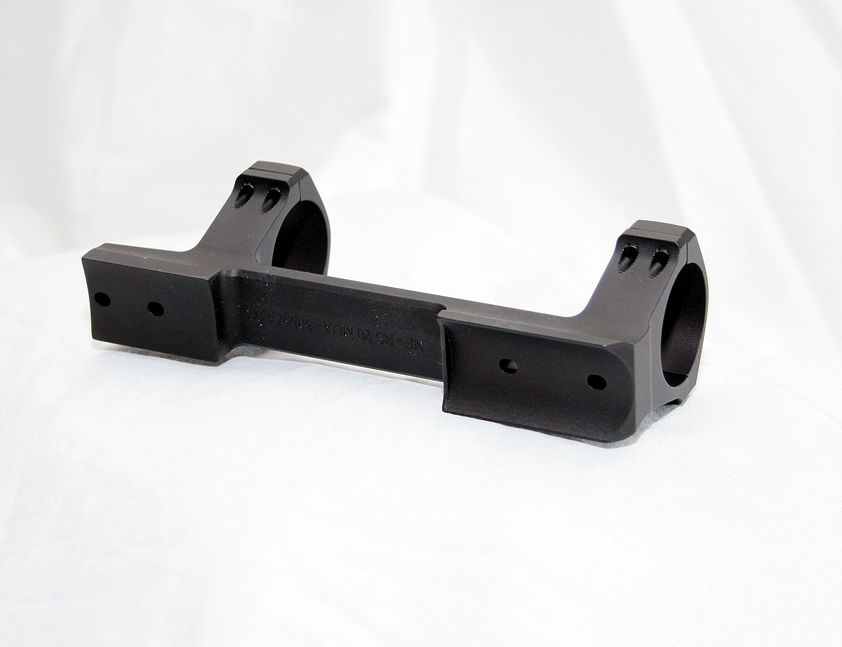

Here’s a pic of the Nightforce one piece mount. It also has a recoil lug and ovalized holes. Their stuff (pic rail too) is sort of a lower buck Near mount.
Although the NF comes in a 20moa version, I’ll bet dollars to donuts that Richard at Near can whip up whatever you so desire.

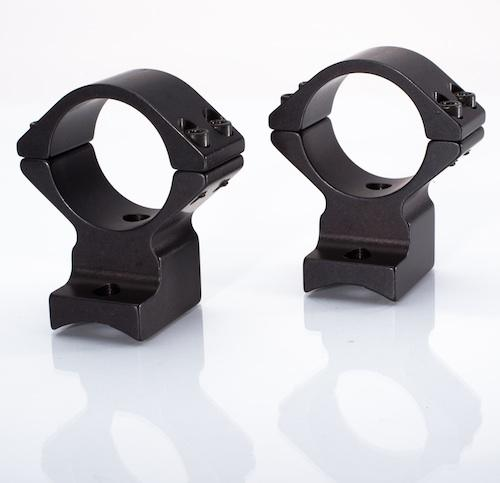

I like the ARC rings a lot but they aren't exactly light when compared to something standard lightweight like Talley. While Talley isn't the sexiest option, they are pretty much the standard for light weight hunting rings and bases for a reason.
