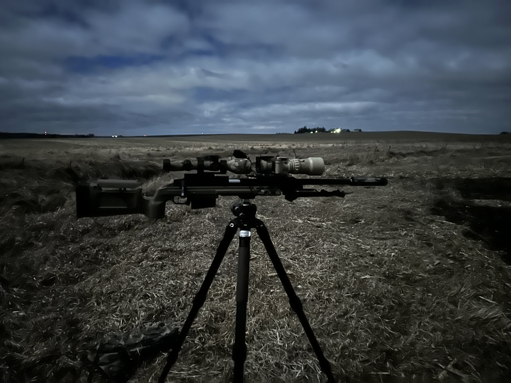

    Currently running Zeus QC in a KRG Bravo but am looking to save some weight (and potentially build a dedicated 6 CM yote gun). I’ve got a long action, full length Arca, bipod (and spigot), NX8 2.5-20, NV Cap, and a 22” proof barrel with a direct thread suppressor.
    I still come in close around 12 lbs and I think my best bet to lose some weight would be to ditch the bipod but I don’t want to do that on this rifle. This the idea to potentially build a dedicated 6 CM if I can save meaningful weight.
    The biggest unknown for me is which stock? I need Arca and the ability to run a CNVD.
    Pics for the fun of it, and yes I recognize the PVS30 is ~3lbs… I will have a thermal clip on someday which is why I’d like to cut some weight now
    You could shave a pound-ish by going to a sporter contour steel barrel and still have enough shoulder for the suppressor. 12 lbs for a rifle with a pvs-30 on it in addition to a day optic is pretty light though. The Bravo is already one of the lightest stock/chassis options on the market so to go beyond that you're going to spend a lot per ounce to get lighter.

    XLR Element Mg with the NV bridge will save just under 21oz vs Bravo, arca rail, backbone NV cap (in short action). Not sure how much different long action is though.
    Going with a dedicated gun will save the most weight. 16-18" barrel and dedicated thermal will save a ton over your current host.

    Thanks guys, I’ve thought about a dedicated thermal too, but not sure I’ll go that way.
    Btw, I’m at ~12 lbs before the PVS30. I’ll take a look at the XLR and was looking at the HTN 26 as well.
