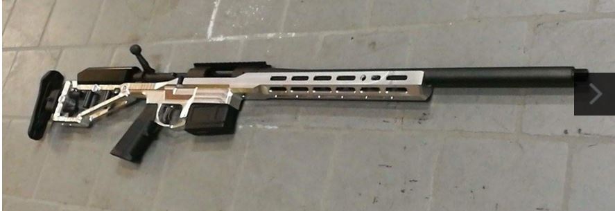

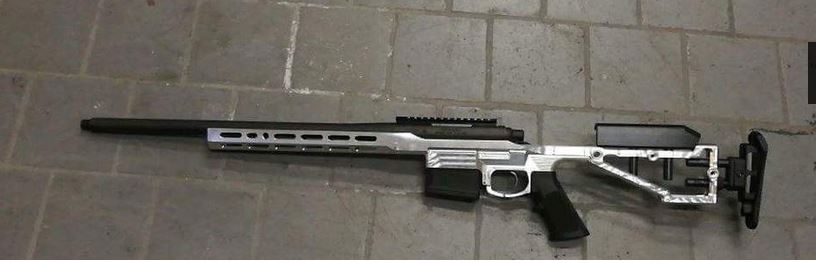

Well. It was a long time ago i've made Carbon fiber Stocks from Evil Empire.
and now it was time to make something cool, comparable in weight with CRFP stock but in T7075...
Well - today it was just off the mill - one piece CNCd Rem 700 SA chassis.
Fully adjustable, Just 2lbs 12oz \ 1245 grams (w\o magazine) (that is 2 times (!) lightier than new Magpul Pro chassis)
and alomost the same weight as the base Hogue with bottom floorplate.

Here ya go.
That looks pretty good. As far as I know, other chassis stocks are made of 6061. This is the first I've heard in 7075. My interest really depends on the price point though.
all atattach points are M-LOK (foreend 3-6-9 o'clock, buttstock - 6 o'clock
QD holes at the foreend amd the neck of the buttstock (3 and 6 o'clock) and on the bottom of the buttpad.
Everything milled from the chunk of aluminium alloy.
All bolts are threaded into steel inserts.
Mag latch is flush with triggerguard.
Fully adjustable - cheekpiece is up and down, buttpad is back and forth and up and down.
total weight of the chassis is lightier than original higue stock with triggerguard and internal magazine.

I'd like to see those holes on the top of the handguard plugged with some low profile screws, like buttonheads. Leaving them exposed doesn't jibe with the level of detail evident everywhere else. Nylon screws are available in a few colors and would add practically no weight. Just a thought.
Whats the weight VTB?
1245 grams with Magpul MOE pistol grip w/o Magazine.
Very pretty.
Good advice. Thank you.
