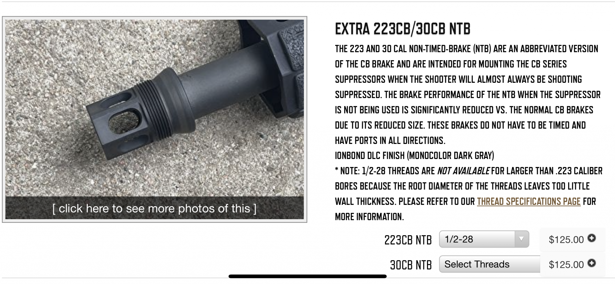

You can get the CB version and use a CB NTB. The sum of the weight savings on both parts (can and brake) on a 1/2-28 muzzle would be 5.7 oz.
