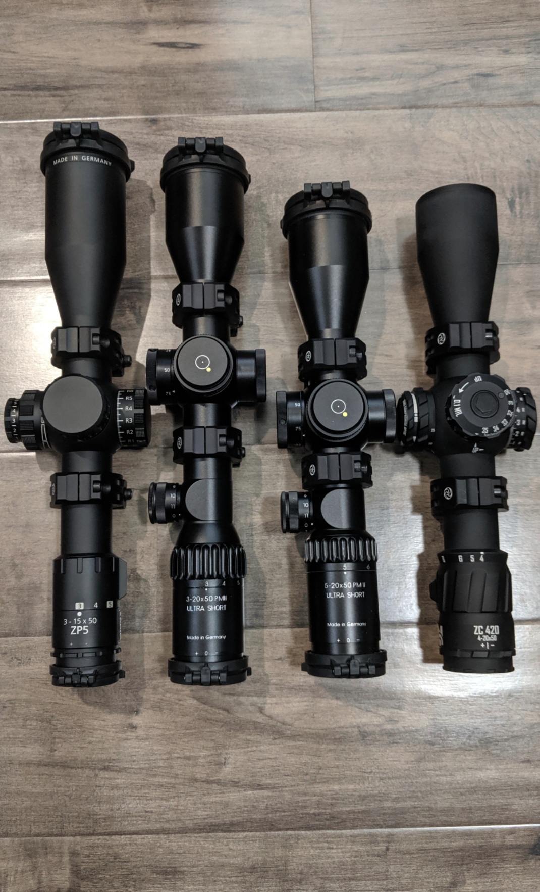

Building a lightweight hunting rig. It’s so hard for me to sway from Schmidt as that’s what I used to, but they are heavy. Is there a lighter weight scope out there that compares to the heavier match type scopes?
Or just get light on gun and roll with a pm2? Just a pound or so lol.
Depends on what you want. I'm putting a ZCO 4-20 on a 10.5" SBR that weighs a little over 6lbs (semi-light) - but I want something with great glass and durability. Would I like lighter? Absolutely. Am I willing to compromise on glass quality or reticle? Nope. There's a lot of options that are lighter with nice glass, but it's always a tradeoff. What, specifically, are you looking for in the scope? If you can narrow down reticles you like first, then stack rank the qualities you care about, that'll probably be enough to help with suggestions!
I am itching to try out the new TT315M with Gen 3XR reticle. The 3-15 Light Tactical isn't new (just over 27oz) but the Gen 3XR in this scope is. There's also the Vortex AMG 6-24x50 that is sub 30oz with excellent glass. You didn't give many parameters but mentioned Schmidt has been your goto. Ain't nothing wrong with putting a Schmidt Ultra Short 3-20 on your hunting rifle, yes they are heavier than the aforementioned scopes, but by what 4-5oz, at the end of the day will it matter - only you can decide that.

right now I have a SB 5-20 US on it. Glass is great. Size is great. Weight not so great. It isn’t so much the weight itself, but the balance is a little off in the vertical plane. Not terrible, but I think a scope in the 23-24oz range and a 30mm tube would be better. However, that is a category with slim pickings for ffp scopes ie TT315M/315H, or one of the Match 3-24 scopes.
