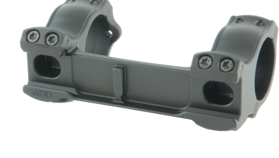

2. Spuhr SCP Hunting Series - I have a lot of faith in Spuhr but zero experience with these mounts. 1 piece mount, various mounting options, etc

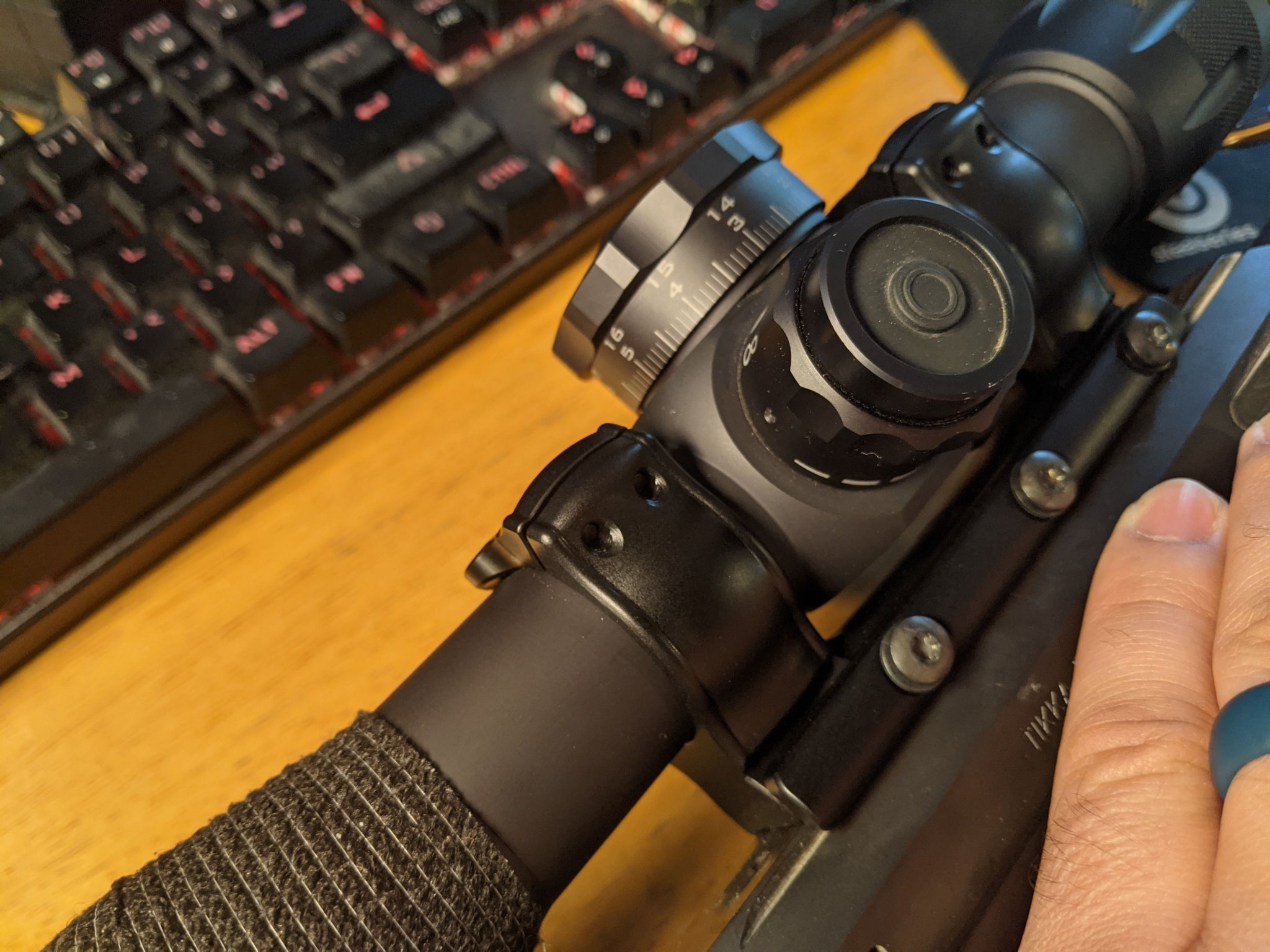

I just mounted my USO FDN in one my Tikka CTR, but haven't shot with it yet. On the tikka version, it's got a lug that locks into the receiver. Not sure how it works for other rifles, but I feel like it's pretty solid. I like that the locking surfaces are torqued down on the entire length of the mount that mates up with the dovetails.
Top that off with Spuhr's leveling system, and I'm sold on it. If it came in 20 MOA, I'd be swapping out my MPA on my other rifle wearing an M7XI.

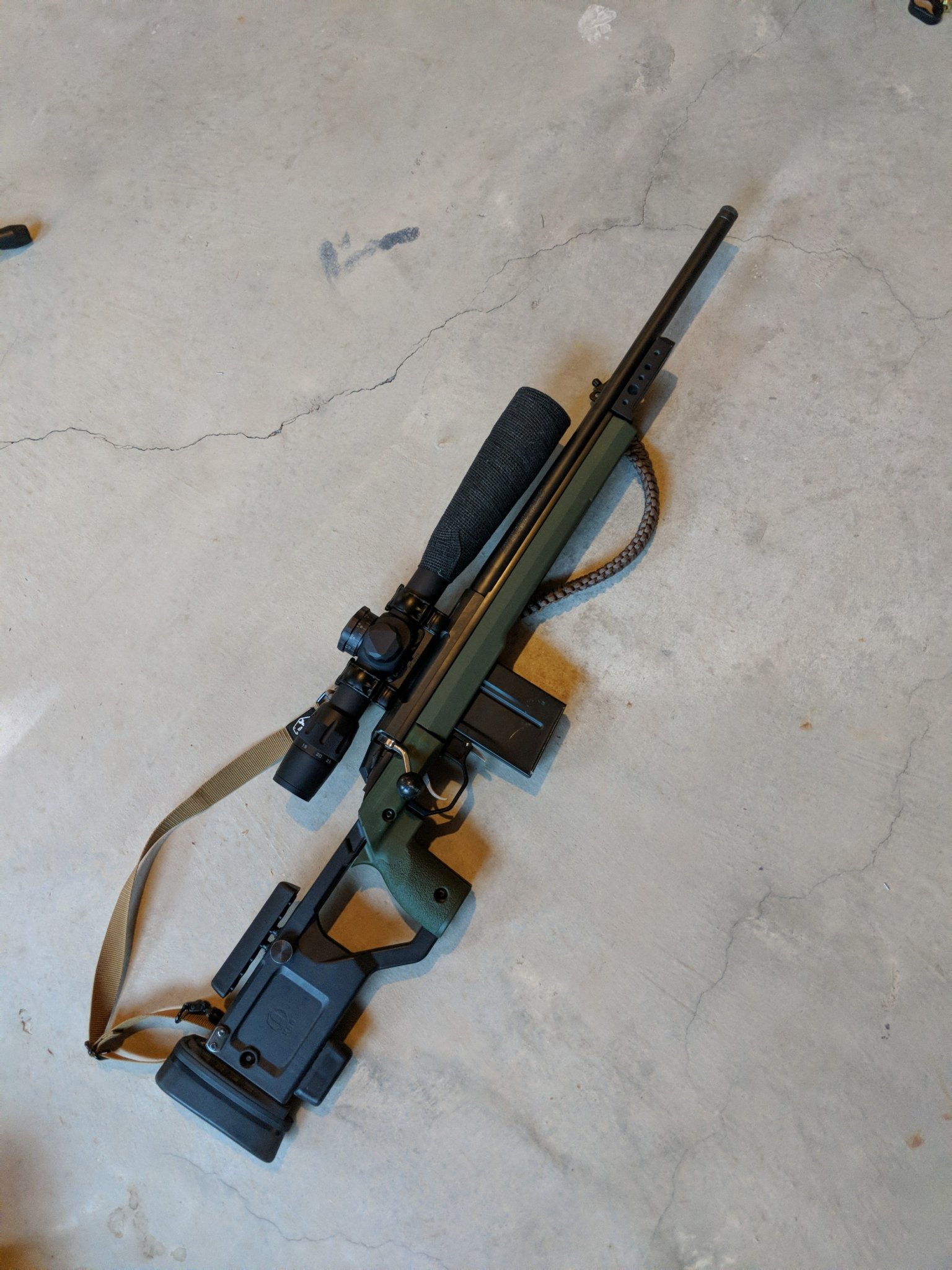

It's finish is different from my ISMS - it's more shiny instead of matte. My rifle as pictured is 12.6 lbs, 11.9 minus the sling. Mount is Spuhr SCT-4006D.

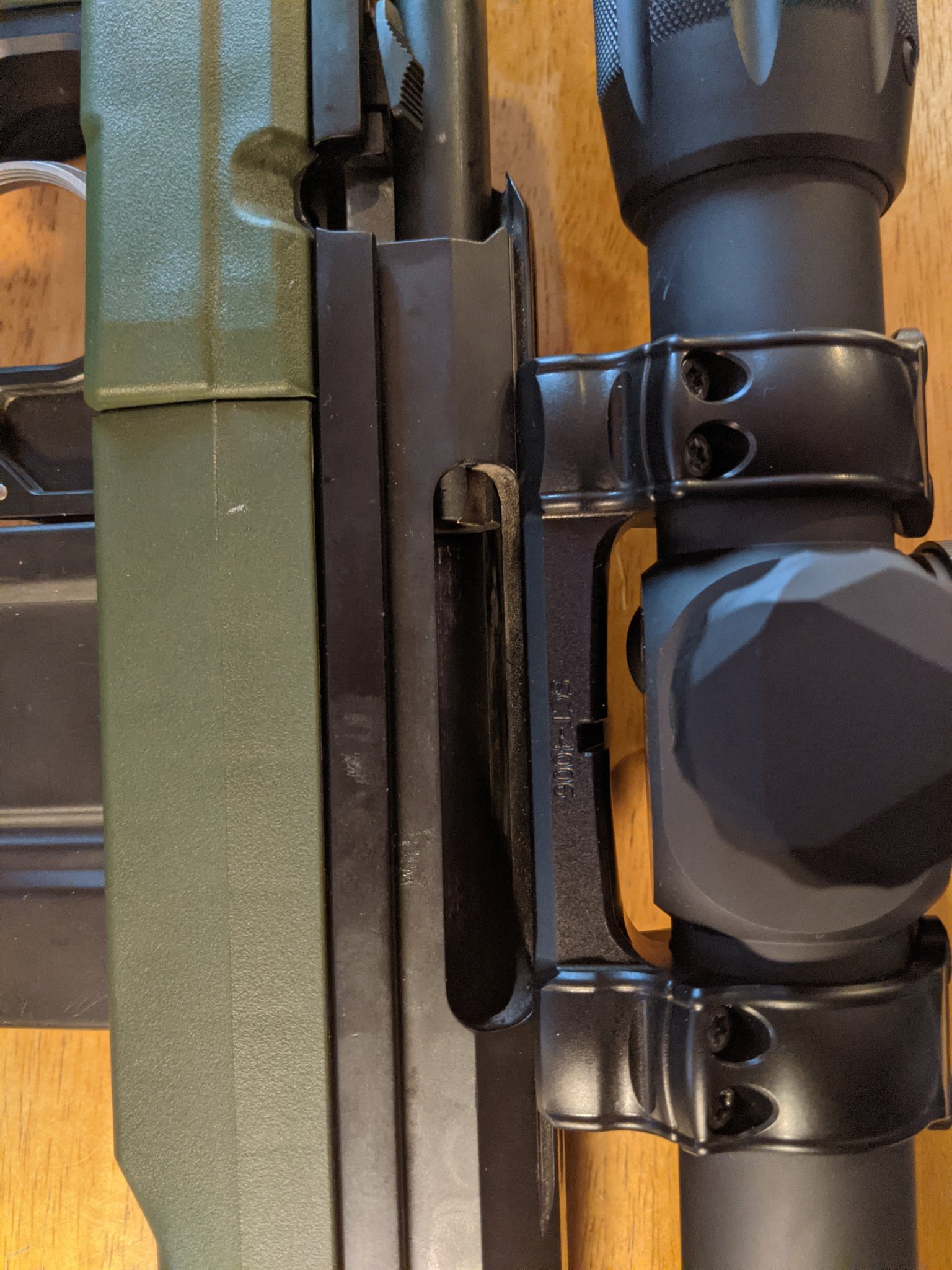

Since I haven't zeroed it yet, I figured I'd take the mount off and show you the underside too. Recoil lug can be put in any of the four slots to accommodate your eyebox. Not sure if this is included in non-tikka models. Also not sure if you're planning to use a dovetail SCP or a pic rail, but I figured this was relevant to your question. Might be beneficial to people who find this thread via google in the future too.

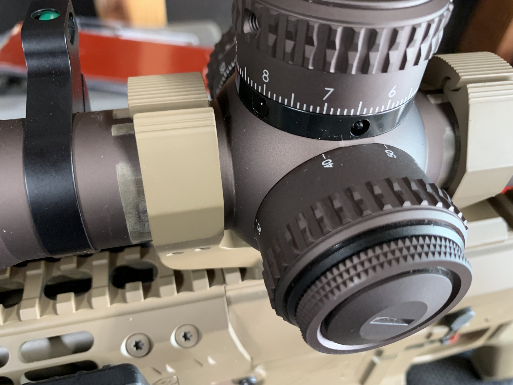

I am running it on a pic rail. It looks like the pic-SCP mounts have 2 separate clamps for the pic option (see picture). I see your dovetail uses that full length rail. I wonder why they wouldn’t use that on the pic model?

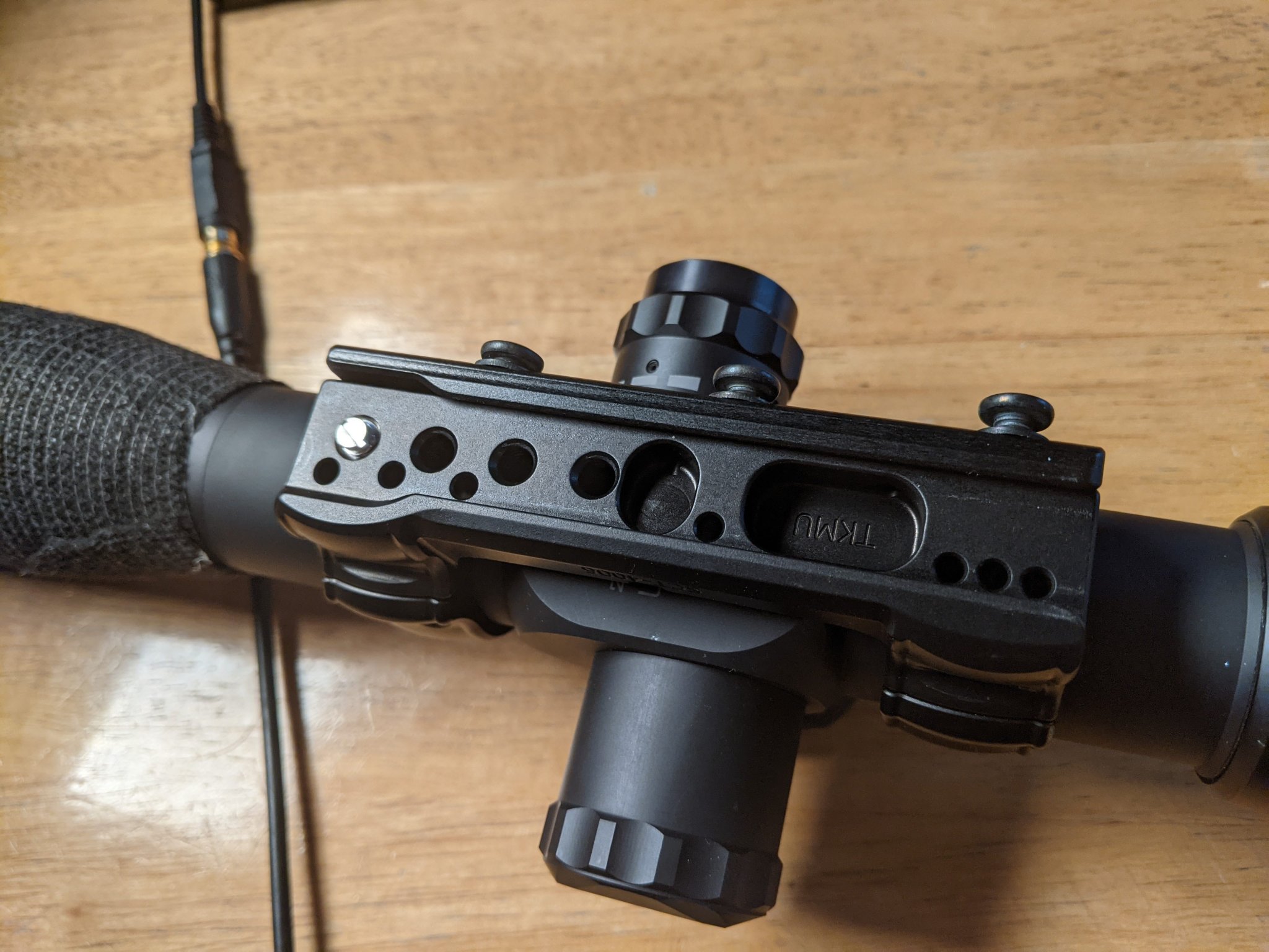

Have you had any troubles with your scope moving? I’ve got one of these mounts but after my first range trip noticed that the scope had moved. Torqued them to 20ftlbs.
Not at all. And I only torqued to 15 in-lb, per their specs. Not just no change in zero, but no visible ring slippage as you get, etc. And while my biggest is .308, I also carry them through woods, am clumsy and drop them, etc.
My scopes in these are all Steiners, and one Bushnell SMRS. If that matters?
