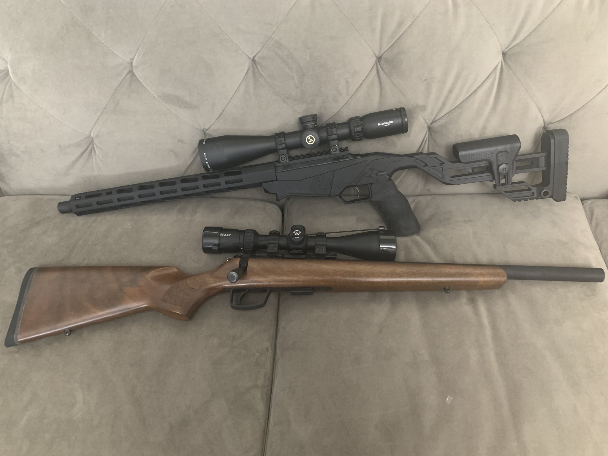

Just got it in and took some photos.
Make: Whistlepig
Chamber: Match (we will get to that later)
Length 16.25"
Threaded
Cerekote: black
Weight: Roughly 17 oz (need an in between scale) - Shaved off 27.8 oz or roughly 1.7lbs
Pics or it didn't happen
Reactions: gunner442
Well, finally got my boys barrel in for his RPRr. The purpose was to shave off as much weight as possible and increase the precision. I requested it to be a match chamber and threaded so we could use my sparrow on it.
Got the barrel in today and it all looks good to me. Super light weight and the cerakote looks good. Threading looks a little long (will have to take my calipers to it to verify but compared to the Ruger OEM it is longer.
One area of concern so far is the match chamber. I tried a handful of different brands tonight just dropping them and out and all fell free and dropped in smoothly except the Eley target ammo. It seemed the wax was causing it to stick but I didn't see grooves on any of the ammo and that makes me think that it isn't a match.
The proof will be in the shooting but it won't be until next week. Going to take my boy to a 100 yard indoor range next week (either Monday or Wednesday).
The handling of the rifle is so much better right now. Makes one wonder why Ruger didn't drop one of their LW aluminum barrels in one.
The 16 incher looks much better IMO. It’ll be interesting to see if taking a bunch of weight off the front of the rifle makes the polymer chassis less pressure sensitive. It certainly couldn’t hurt the balance for shooting offhand

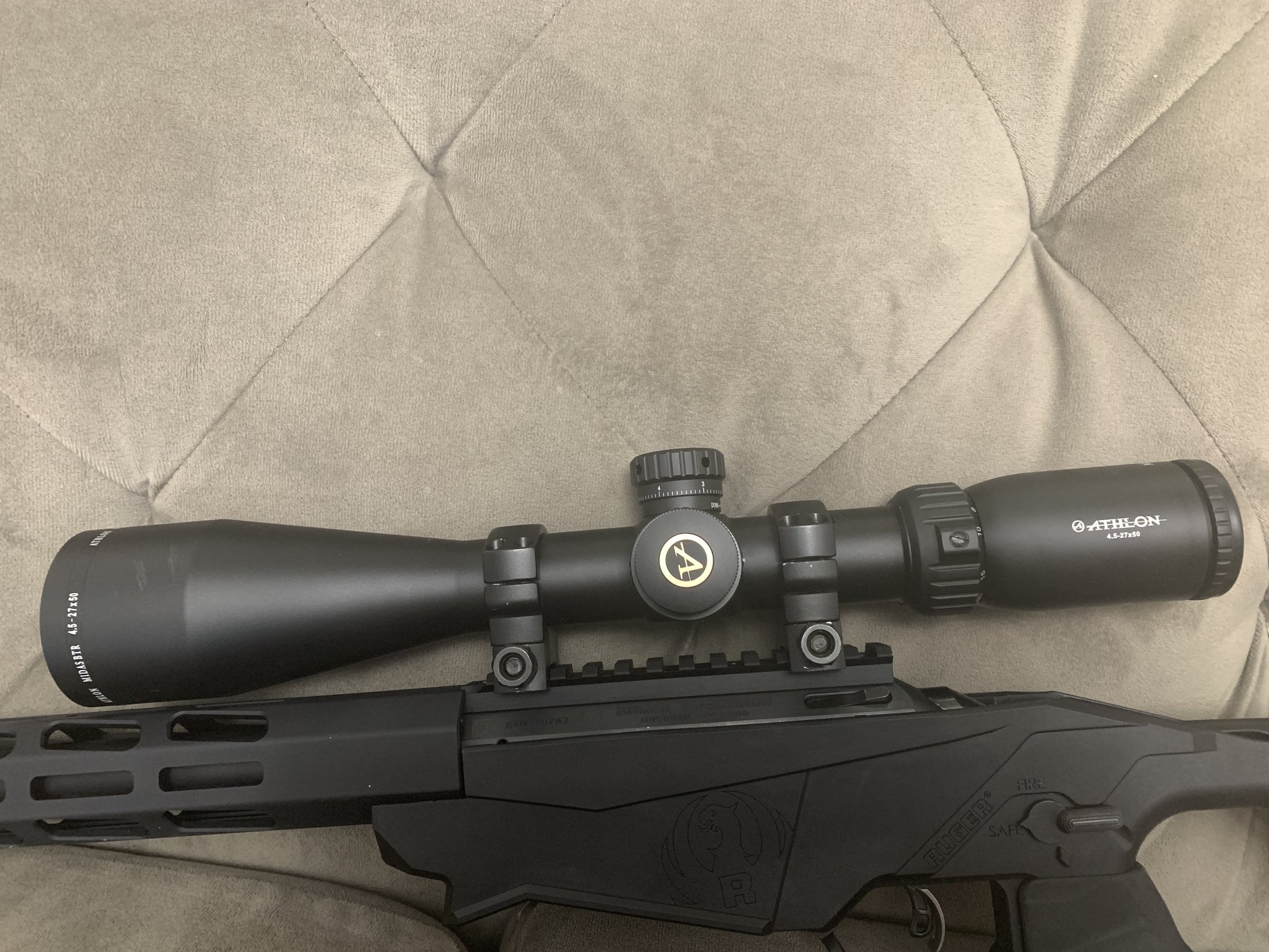

Got the 4.5-27 mounted up for this week. Looks like it will be Friday when I can get out. The 3-12 off the 455 will probably live in the rifle but I want to test the accuracy using the 4.5-27.

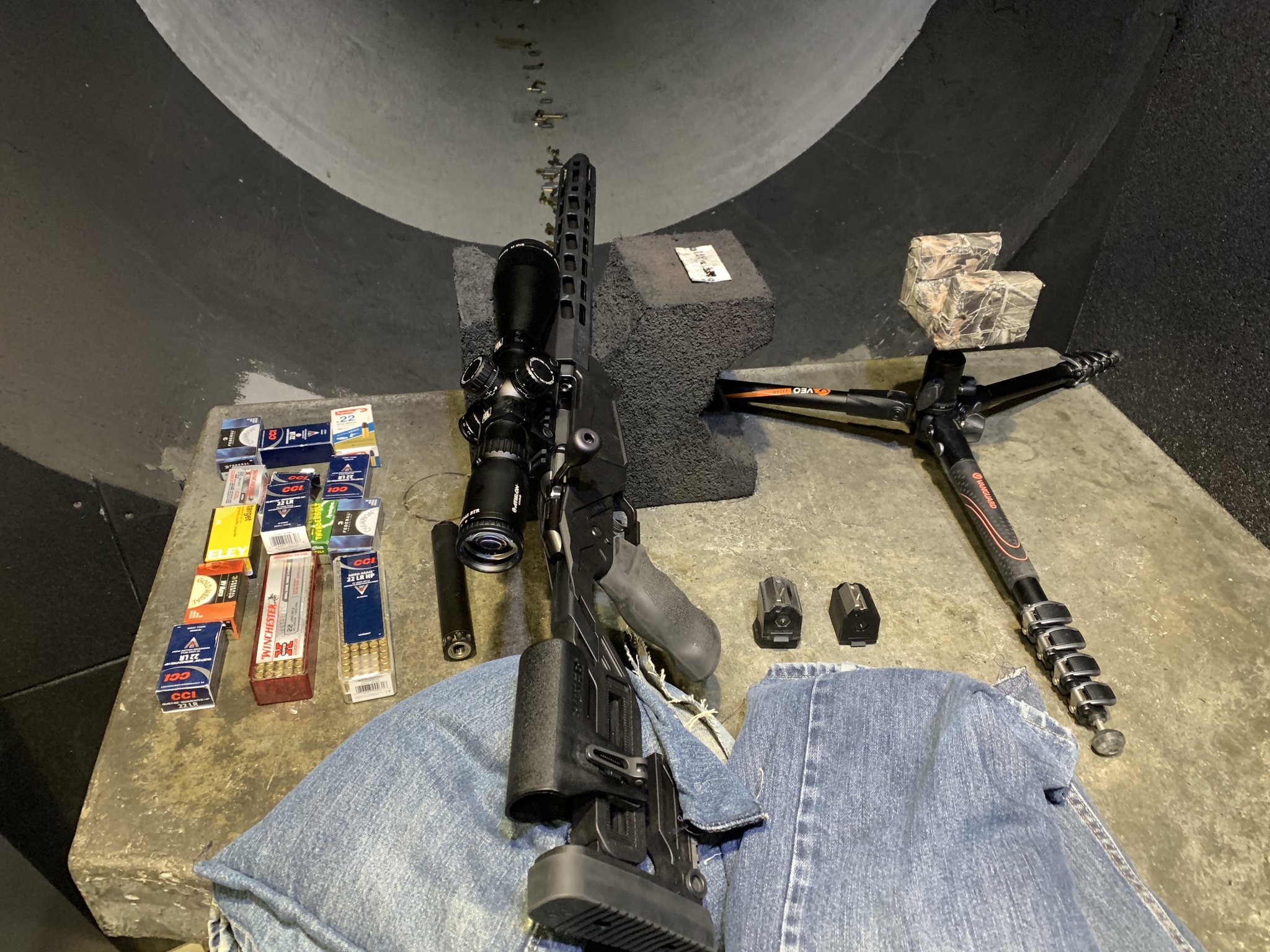

Here is the set up. Had high aspirations today but the range was packed and ran out of time.

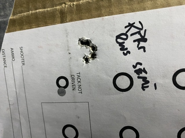

Still shooting pretty good. Eley Tennex shoots better and surprisingly I had a lot of RWS pistol match that it loved.
Here is a group of low/mid-grade ammo (RWS semi-auto) from this week. Almost out of this ammo but I got it for 24.00 a brick

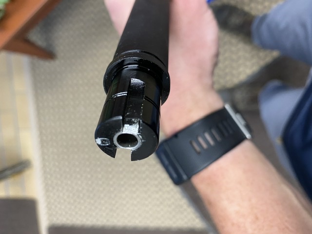

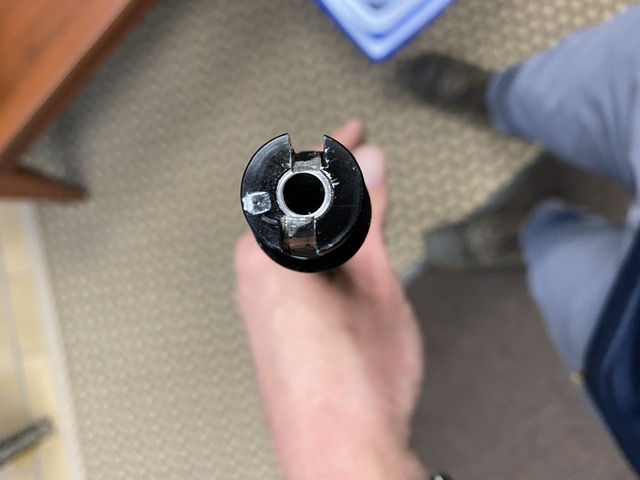

Here is the shank of my boys barrel and you can see the firing pin mark on the barrel. Don’t know what to think about that.
