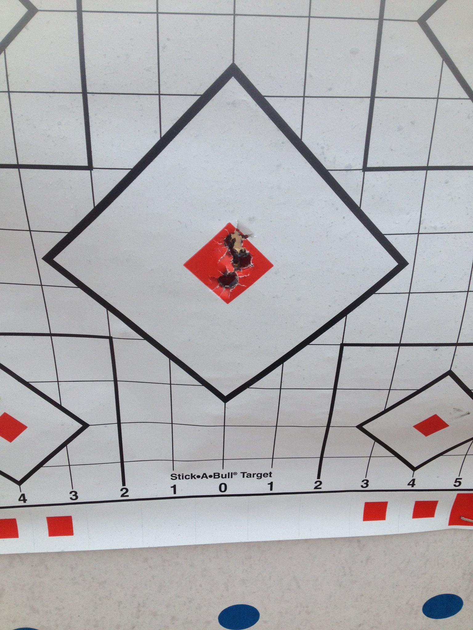

As for accuracy, it shot better than i did for a semi. One grouping (Hornaday 150 sst @ 100):
Overall it was too pissy to be consistent. I found it awkward to bench shoot, too uncomfortable. If you want a MOA avg, i'd say it was 1.0 +/- .25 if using good factory ammo. This was a "budget" faxon barrel by the way ($100 barrel). Again, this was 308.

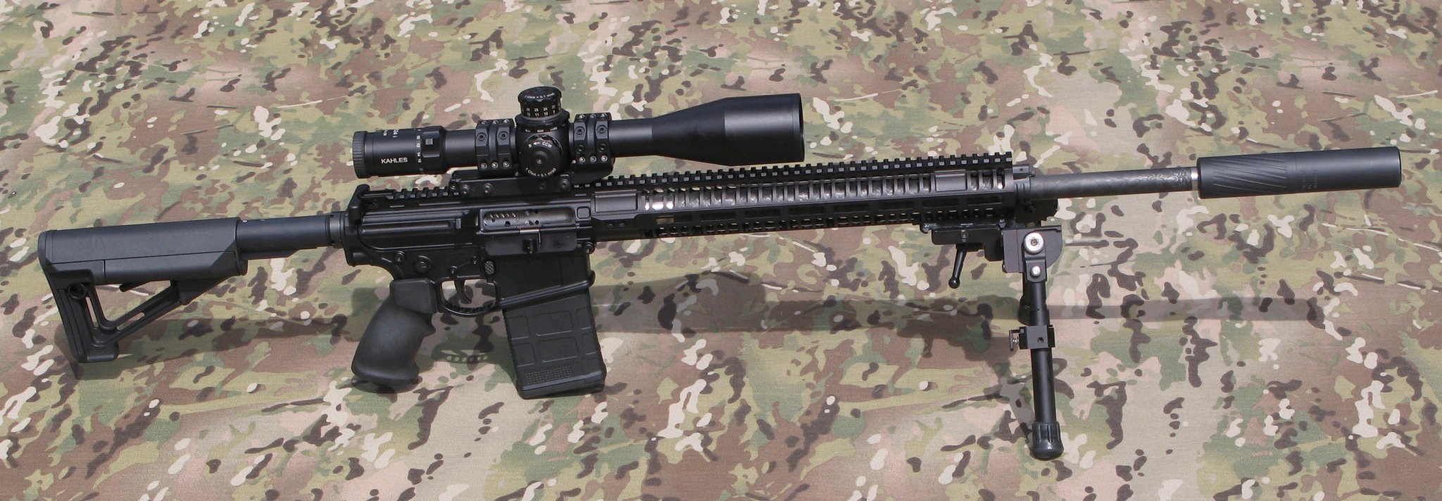

Here's an 8 pound, 2 ounce 22" 6.5 CM:
It's a way sub-MOA combo. You could hit 8 pounds easily by going 2" shorter, or swapping to a lighter buttstock.

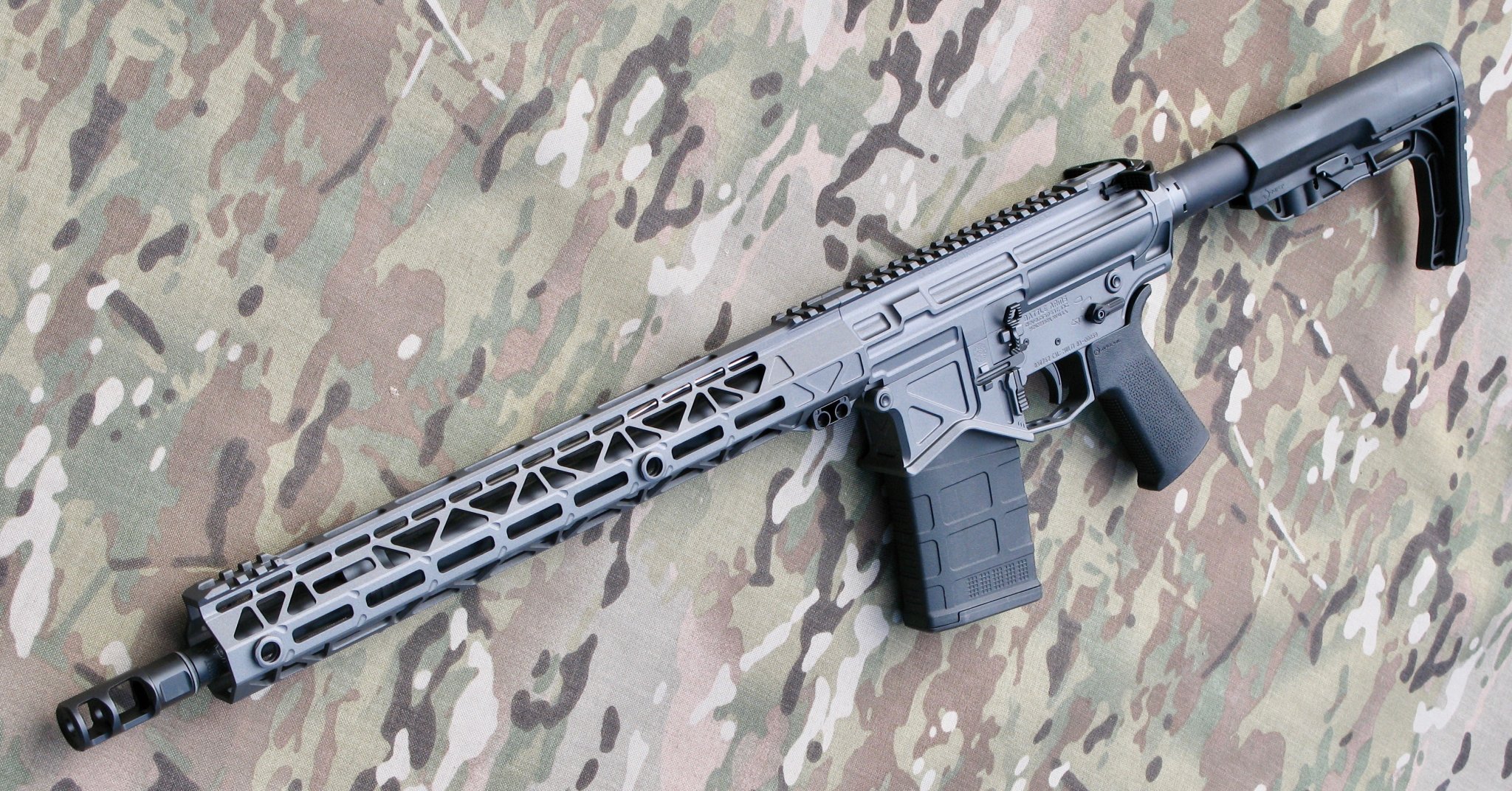

Here's an even 7 pound .308:
Nice builds. I wasn't prepared for how much heavier large frame ar's were than small frame. I was expecting about 8 lbs and ended up with about 9. I love the gun, but wish i had paid a little more attention to weight.
