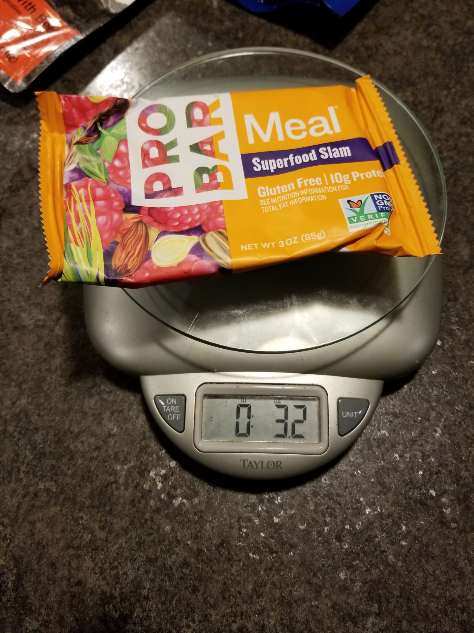

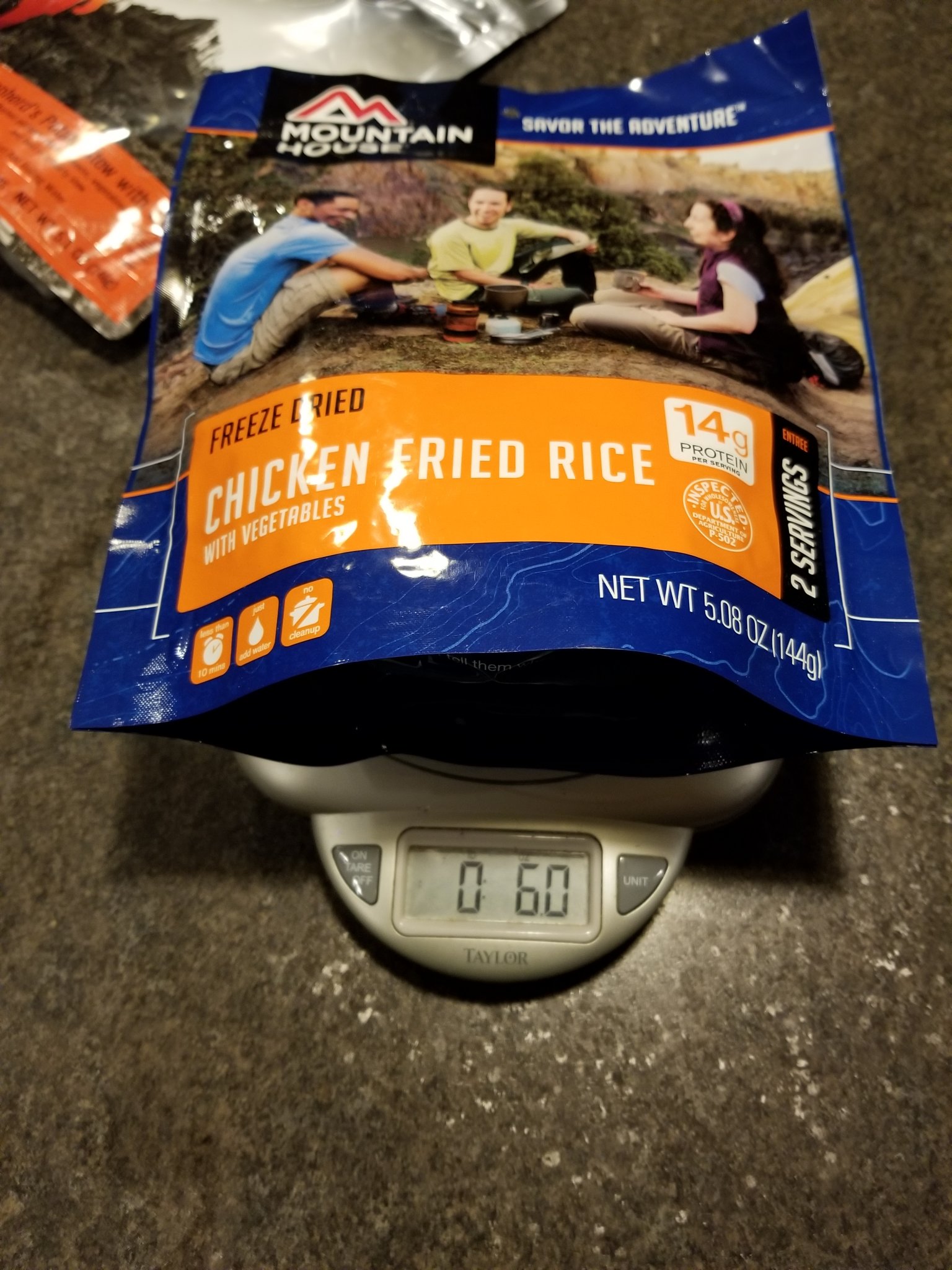

Not trying to derail the conversation, but food budget effects what you're willing to haul around for rifle and ammo weights. Here's some photo's that may help people in their planning. Next year, I plan to take more of the protein powder individual packets too.

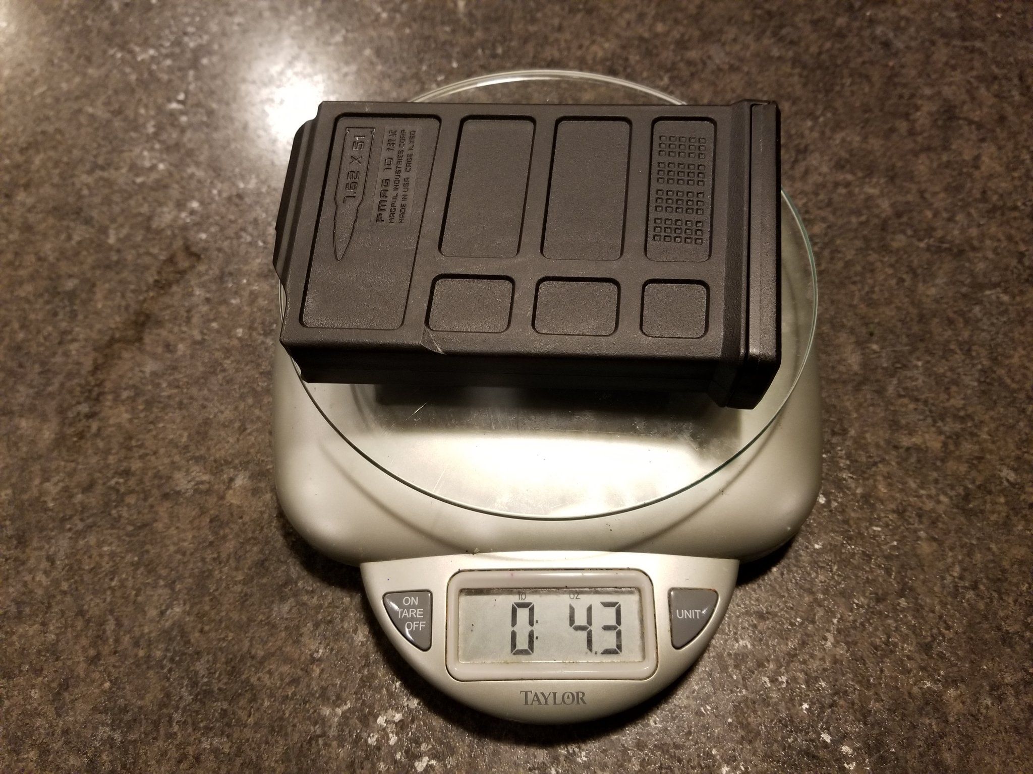

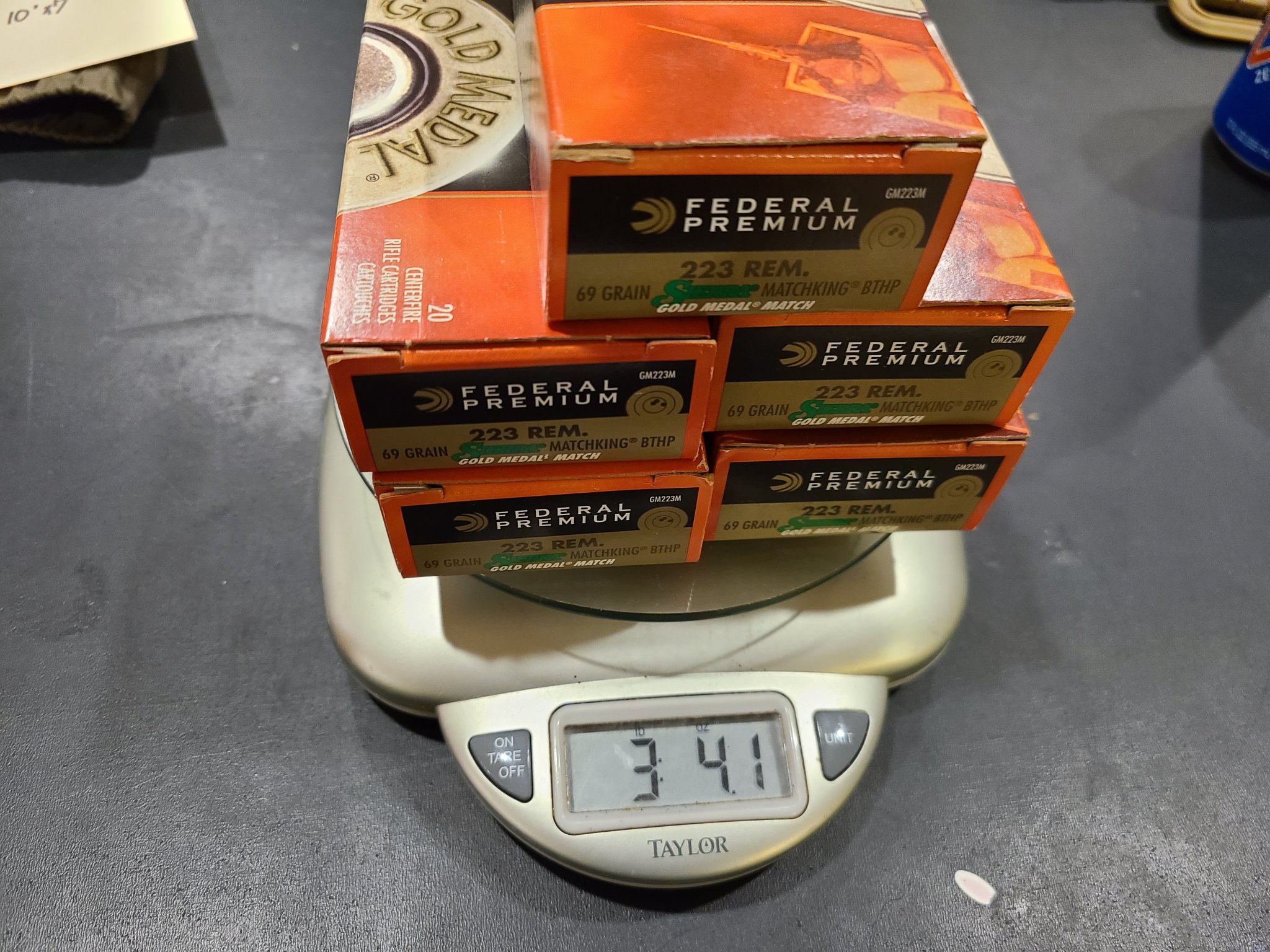

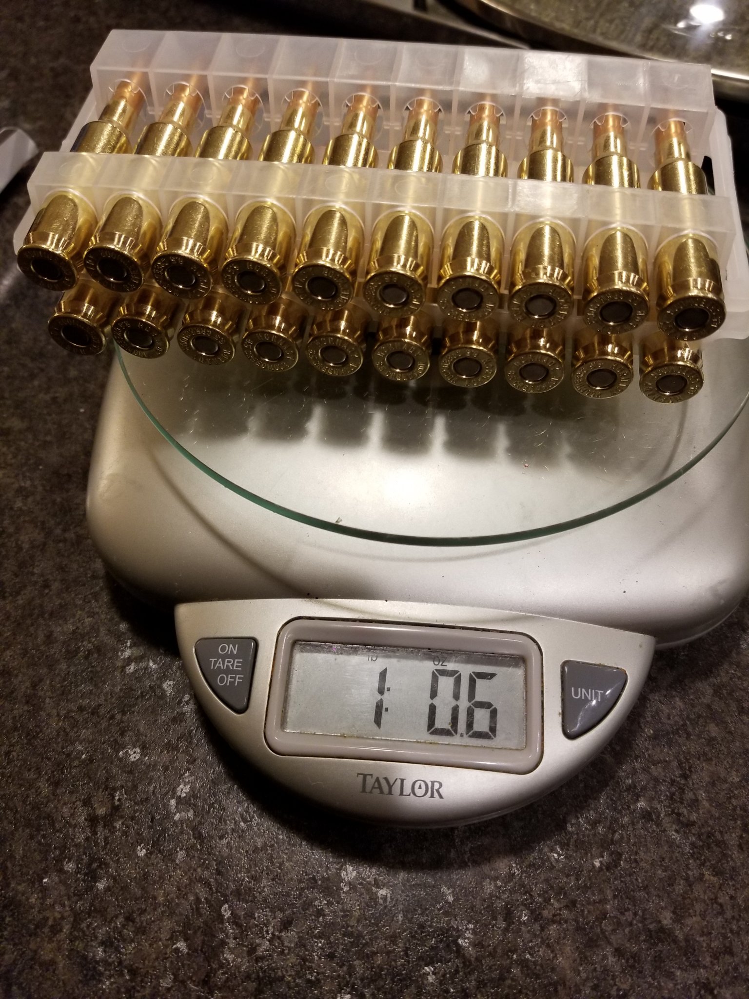

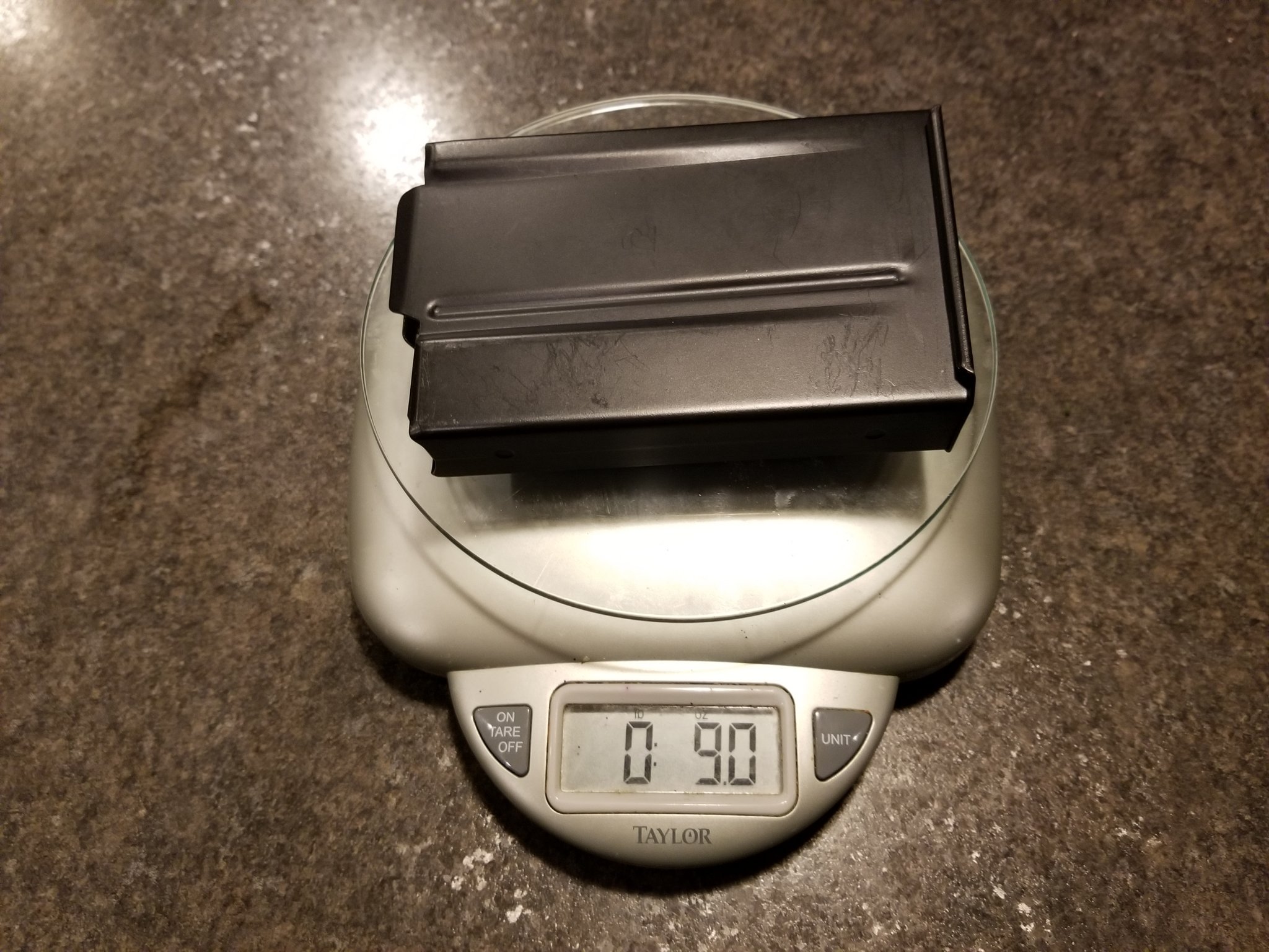

Getting back on rifle and ammo weight, here's a few things to consider. Even the magazines you chose will have an impact, especially since everyone likely takes two mags per gun.
For us, we'll likely each take 100 rounds of rifle and 100 rounds of pistol this year.
