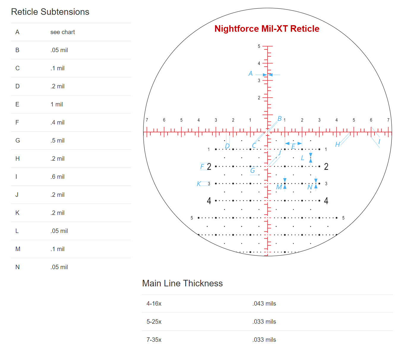

    I have found the dimensions of the Mil-XT reticle for the ATACR scopes, but it does not list dimensions for the NX8 scopes, does anyone know the dimensions for the line thickness in the NX8?
    EDIT: Nightforce sent me the following numbers for the NX8 Mil-XT reticle:
    The line thickness for the Mil-XT reticle NX8 2.5-20x50 is .041 Mils.
    The line thickness for the Mil-XT reticle NX8 4-32x50 is .036 Mils.

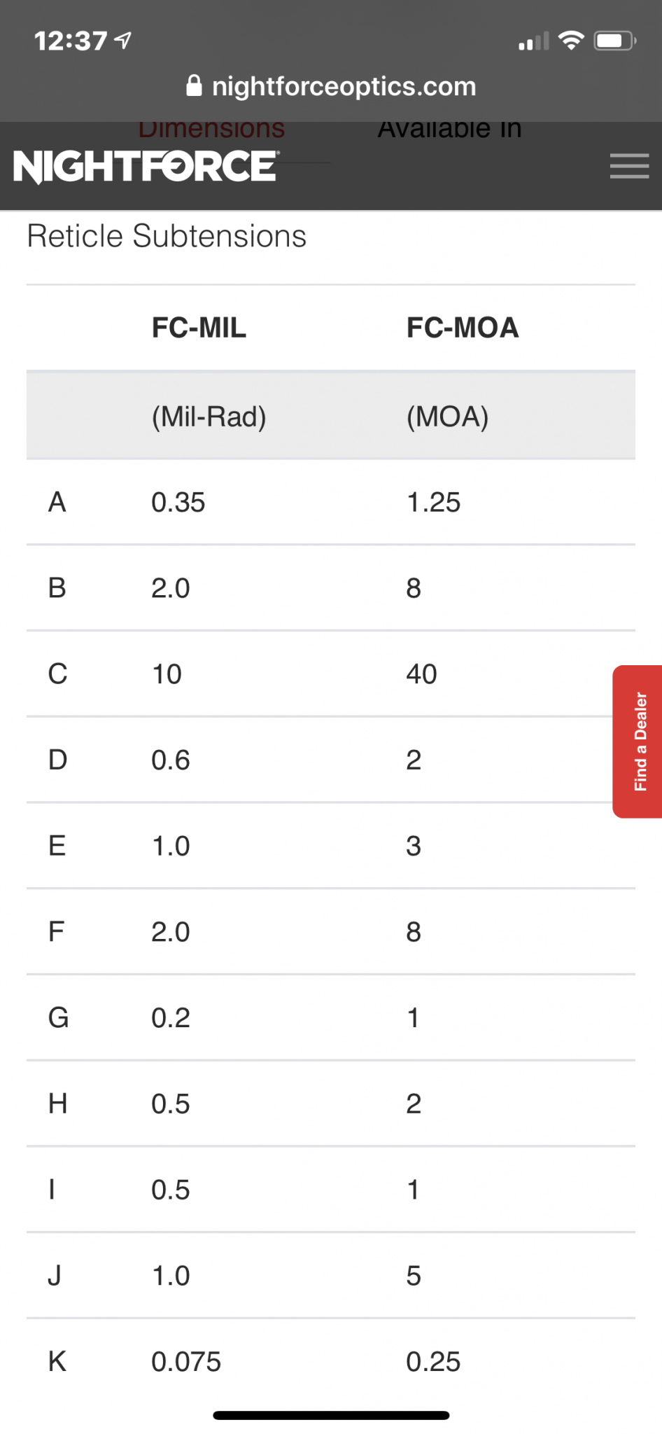

    Looks like it’s the “K” dimension:
    sorry not dimensions though, my bad. That’s a weird way to detail that.
    ^^^ Same reticle in different scope sometimes has different dimensions, for example between the ATACR 4-16 and 5-25/7-35, same reticle (Mil-XT) but different dimensions. In the below example it is the A dimension for the width of the stadia lines, 4-16 is .043 mil width while the 5-25/7-35 both share .033 mil width
