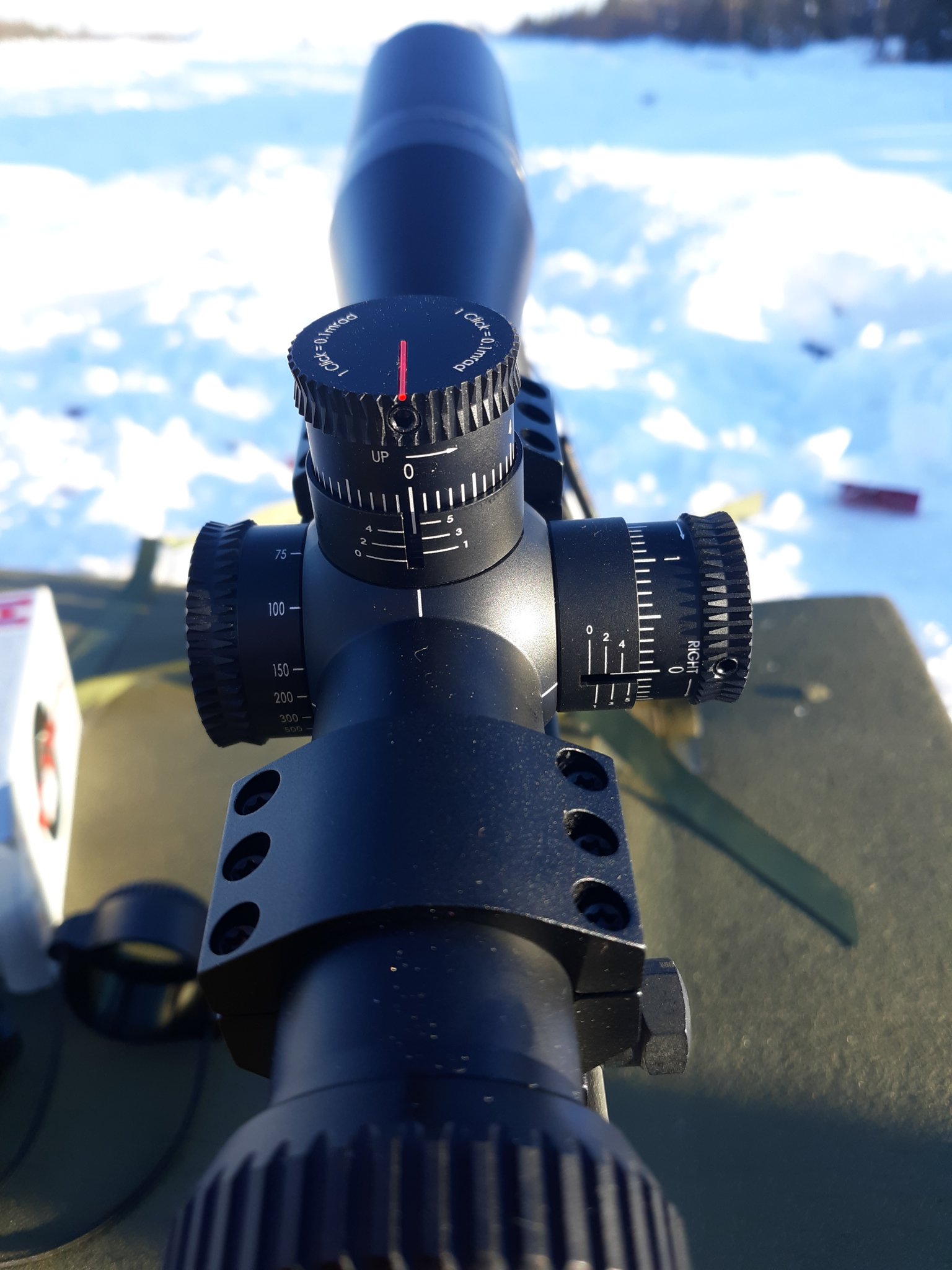

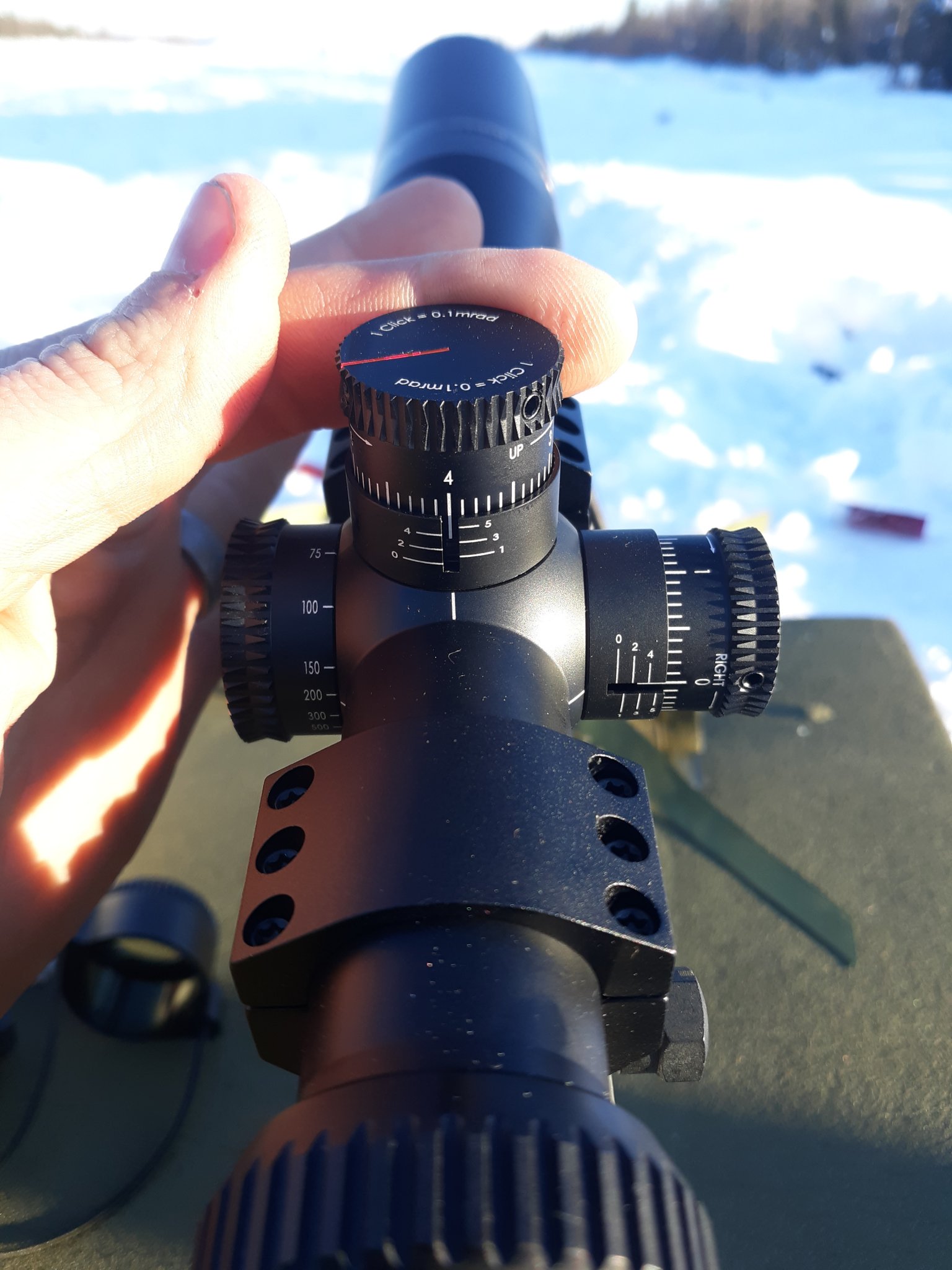

So bear with me I'm at the range just slapped my vortex hst 4-16x44 and got a good 100yd zero shooting some junk168gr bthp out of an 18"308win. I've never had these mil turrets to mess with before so I'm sitting here unsure when I turn the elevation one full mil( 10 small clicks) to show 4 it drills the 200yd shouldn't it be when I turn from zero in the direction listed up to show 1 that it would move point of impact up? Are my turrets some how backward? Or a I just uneducated on this?

Okay, now I’m confused. What exactly does this mean?
If you turn one full mil, shouldn’t it show 1? Or is your 100 yard zero currently at 3 on your turret?
And what does it mean when you say that when you turn one mil it drills 200? Does this mean that it takes 1 mil of elevation from your zero at 100?
I am only trying to understand what it is that you are doing and asking.

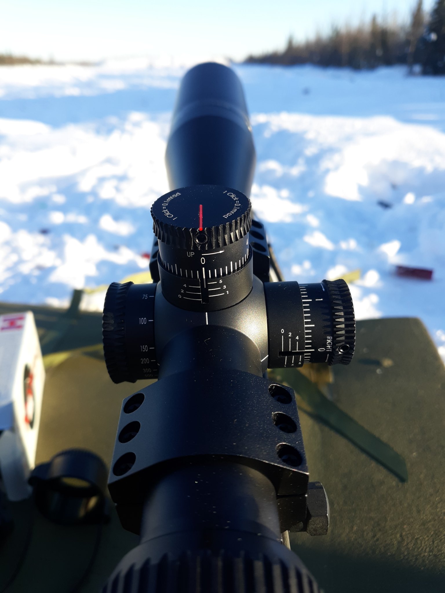

Another close up look at you pictures. You are turning your turret in the wrong direction. Notice that the arrow to the right of the word “up” is pointing to the right (or counterclockwise). That it the direction that you should be turning your turret to raise your point of impact. If you turn the turret to the right ten clicks, your turret will read 1. As it should. You will then be dialed “up” one mil from your zero.
That's what I was thinking as well however if I start at my zero and hold dead center of the target I impact about 3" low at 200 turn so I then turned the turret in the direction it says up and it then showed a 1 but I am then almost 6" low then at 200 yards but if I turn it opposite of the up arrow it shows 4 and my impact is almost dead on at 200 ? I shoot regularly with my hunting rifles and my redfields and Nikons I would turn with the up arrow to go up and this one has resettable turrets this is opposite I wasn't sure if this was a 'tatical' thing or not

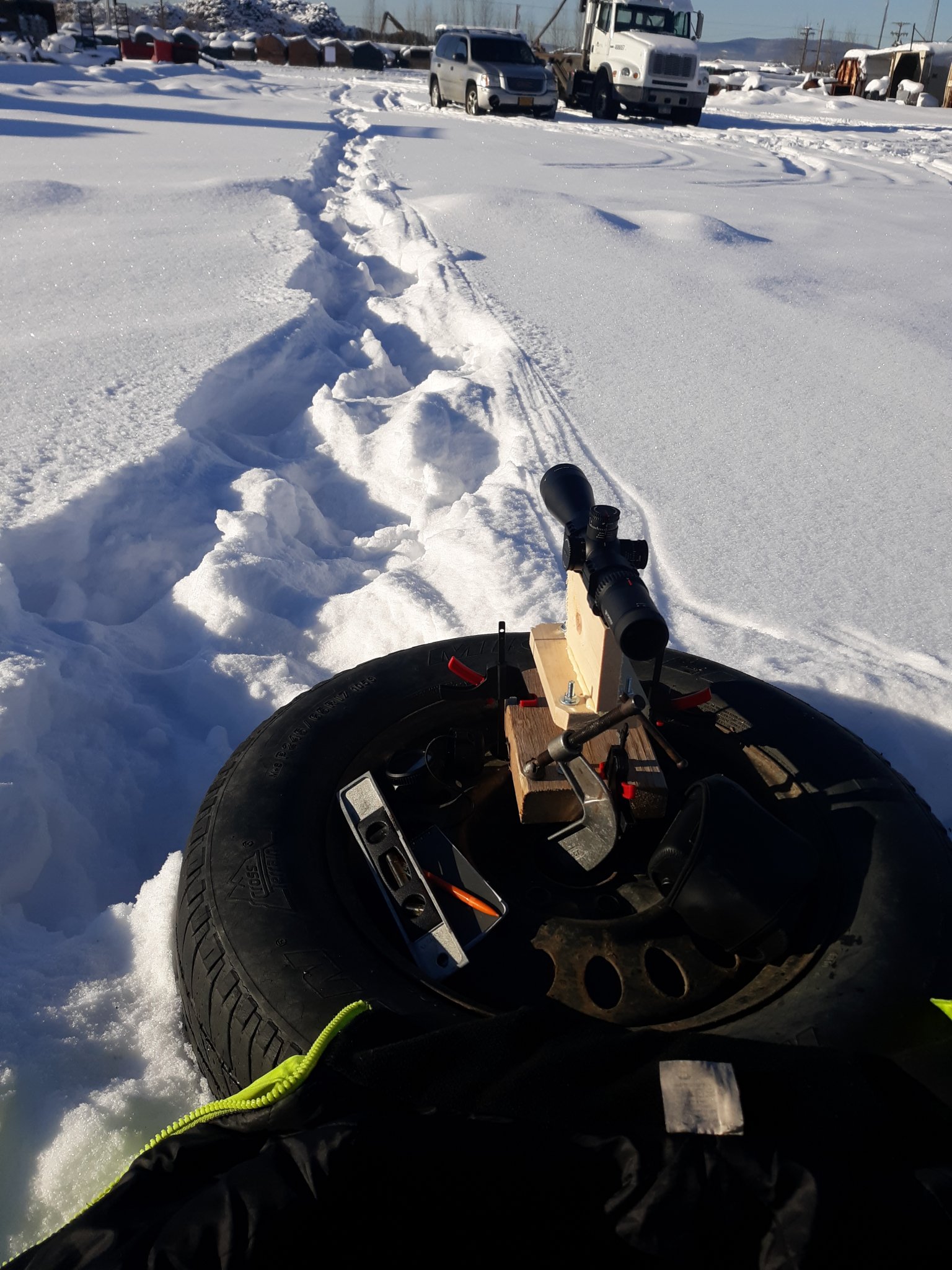

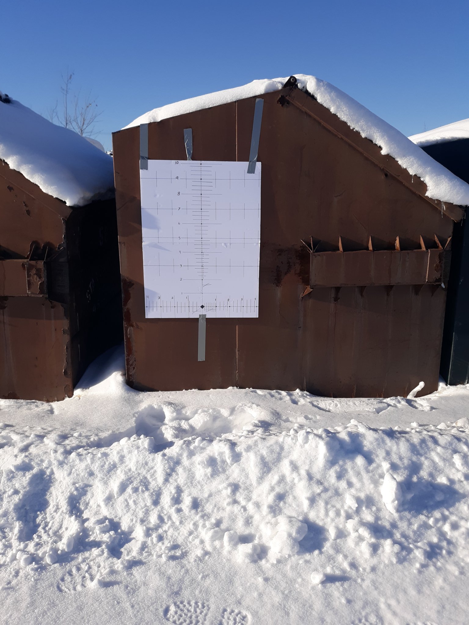

So I did this ? I mounted it to a block of wood with bolts to level it and that to a spare tire pretty solid setup and then measured out exactly 100yds with a tape. Leveled a target that was measured out 1mil inciments at 100yds. When I tried to dial up in the direction the arrows points the reticle moved down.... On the bright side it tracks quite well with only 1/10th mil off at 9mil just in reverse it appears. Think vortex would warranty it? I just got it on Wednesday.
The reticle should move down in the scope when you dial up. With that being said, the rest of your story doesn’t fit. I’m sure the scope is fine. Has to be the man on the trigger is pulling his shots.

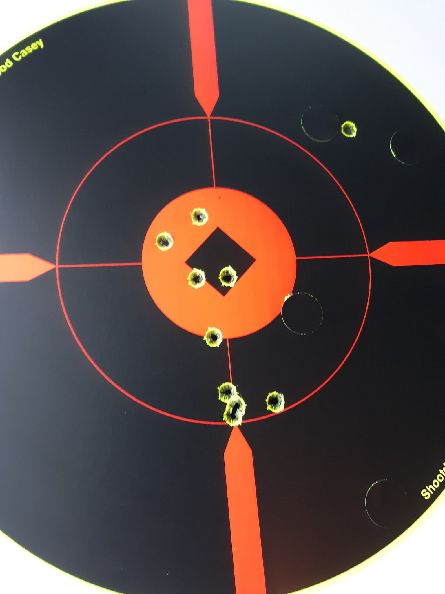

Boom I hit the range again after talking to my buddy and reading through all of this he suggested taking everything apart, take the zero stop out and start all over and since I normally shoot off my pack and to lose the bipod. While I was setting it up again in the warmth of my kitchen I found a little bit of pipe insulation made the cheek weld alot nicer and shooting off my hunting pack seemed more comfortable. I am pleased yet embarrassed to announce all is well thank you for bearing with me. Here's the 200yd its not precision but I ran out of ammo after the 10 I threw at the 100yd target to zero and put the zero stops back in and confirm it still was zeroed. I shot these 10 at the 200yd and used the scope in the direction it lists to walk up the target. Again thank you for your time and yup I got a high one always that high one
