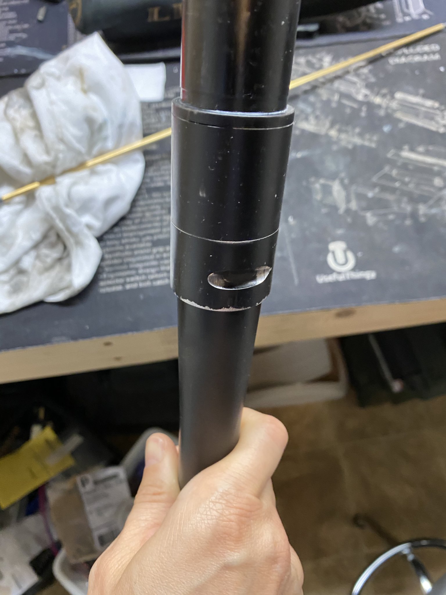

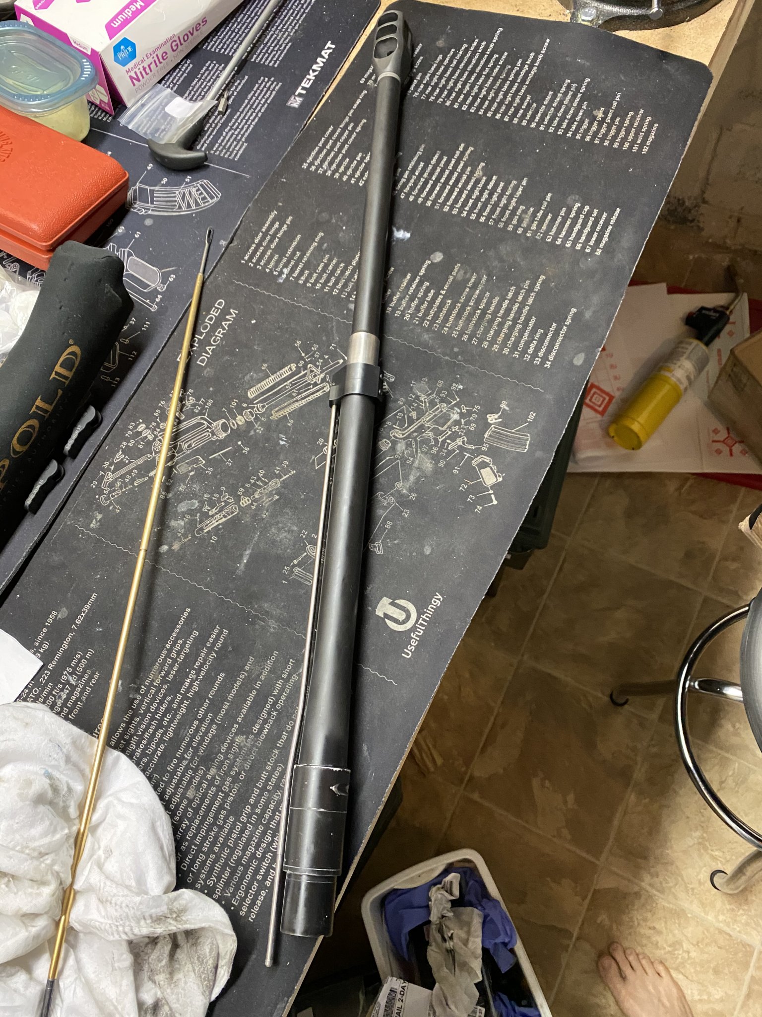

Picked up a used Lmt bartlein 6.5 barrel on the hide last year.
Didn’t find out who worked on it, but I tried it in two Lmt uppers and it does not seem to fit. It seems to thick to fit.
Very odd because the previous seller said it shot moa or less. Not sure how he made it fit. I tried on a quad and M-LOK upper.
I can’t seem to find the original seller but if you are out there contact me please. Maybe it wasn’t meant for mws chassis.
Any recommend smith or work that would need to be done?
Thanks in advance

The oddest thing is the gas block and tube, looking at it. I owned a couple lmt mws rifle, with 6.5 and 308 barrels both had straight gas tubes and the gas blocks were longer. It looks like there is a different gas block/ tube combo on your barrel.
Try contacting d.willson mfg. He performs barrel conversions on the LMT platform. Currently the website only mentions the MRP. But there have been posts on facebook about conversions for the MWS.
http://www.dwilsonmfg.com/LMT-MRP-Barrel-Conversion_p_12.html
This service includes the conversion of any off the shelf AR15 barrel to work in a Lewis Machine and Tool MRP upper.
You will need to supply:
  • AR15 barrel (any length, any caliber)
    • MRP upper
    • Cross Bolts
I'd second tono's suggestion. I've had dwilson mfg do some work on an SR-25 and recently replaced an lwrci m-6g barrel I shot out. I have a spare lmt gas tube that I can send you that will Atleast get you started in the right direction 🤙pm me if you want it.
