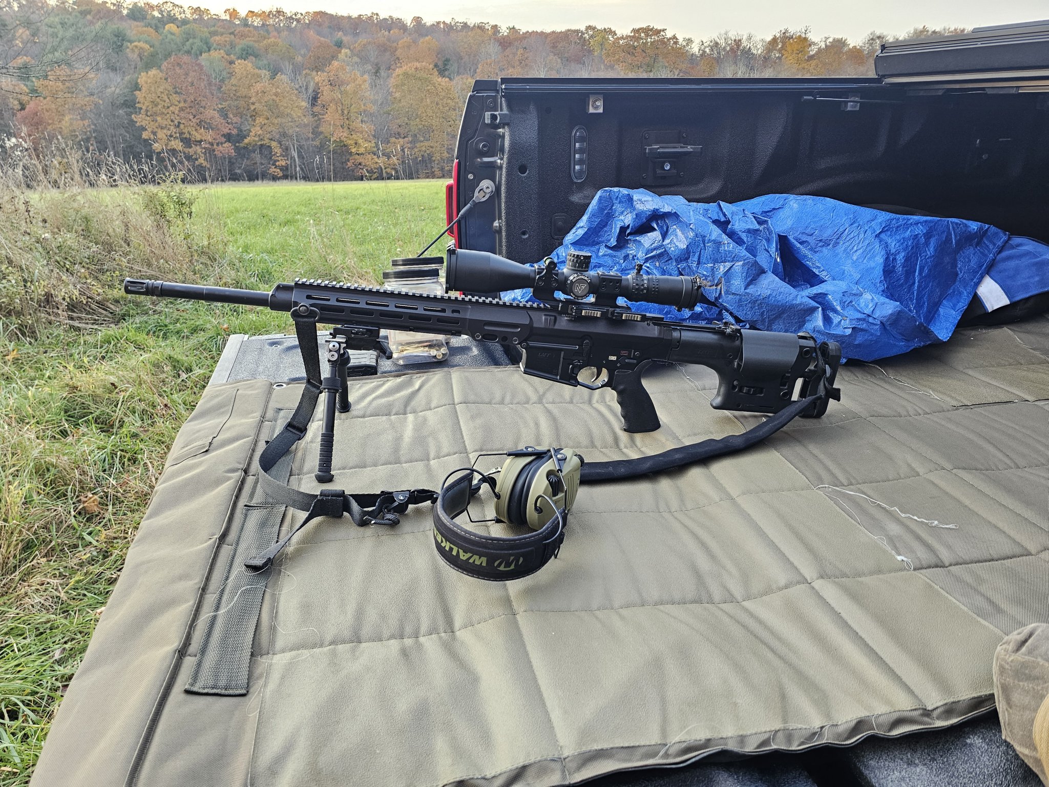

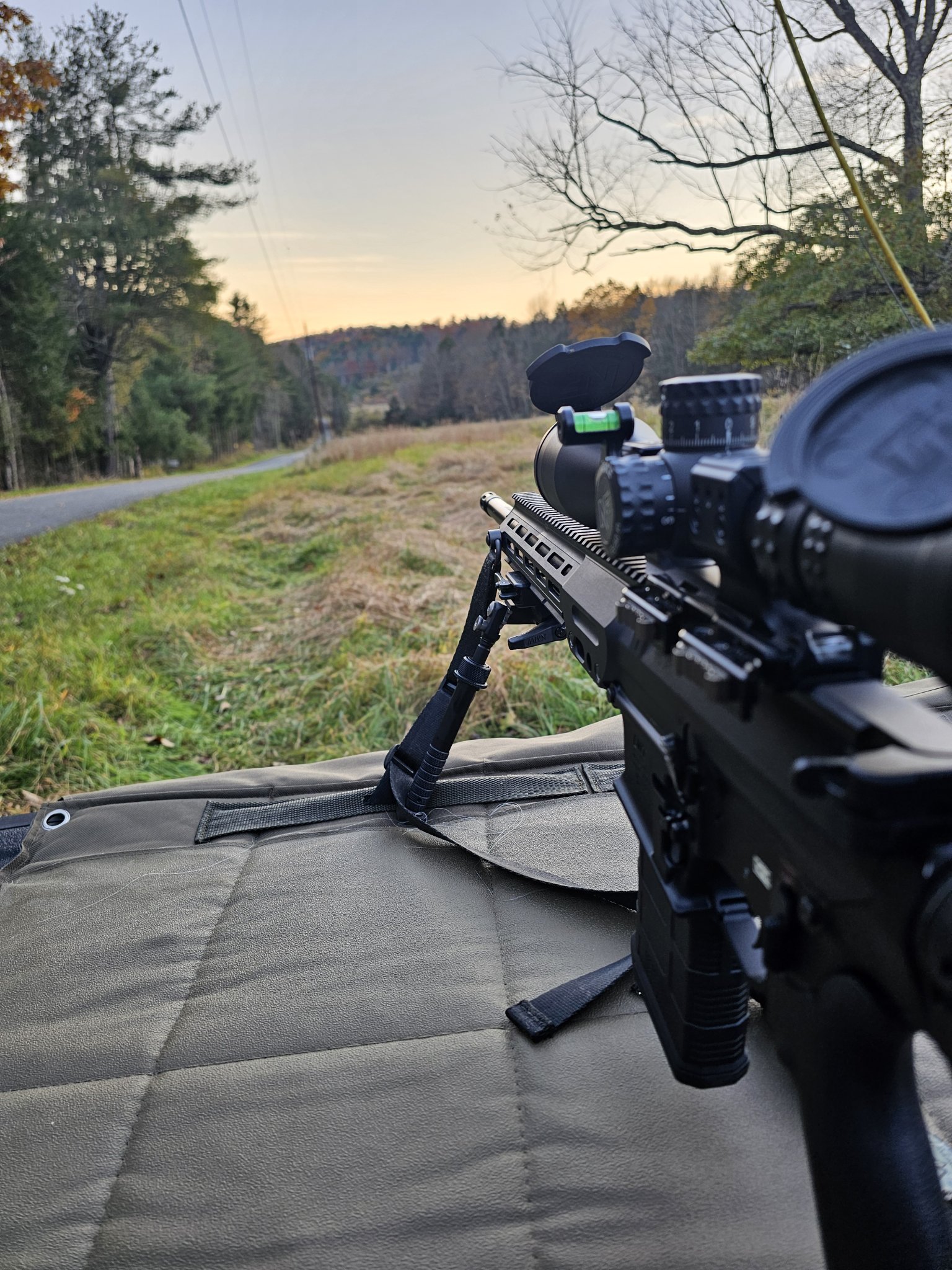

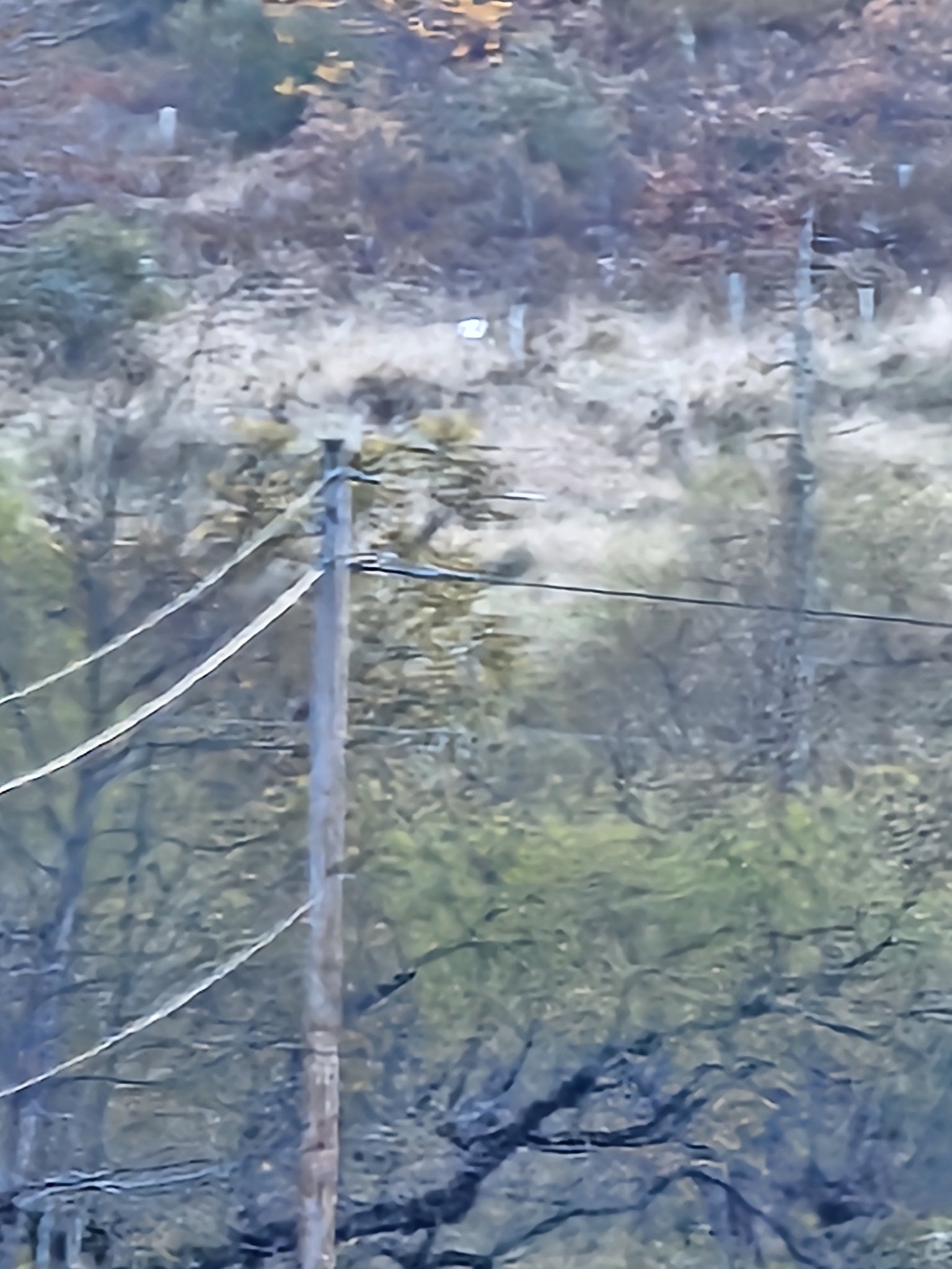

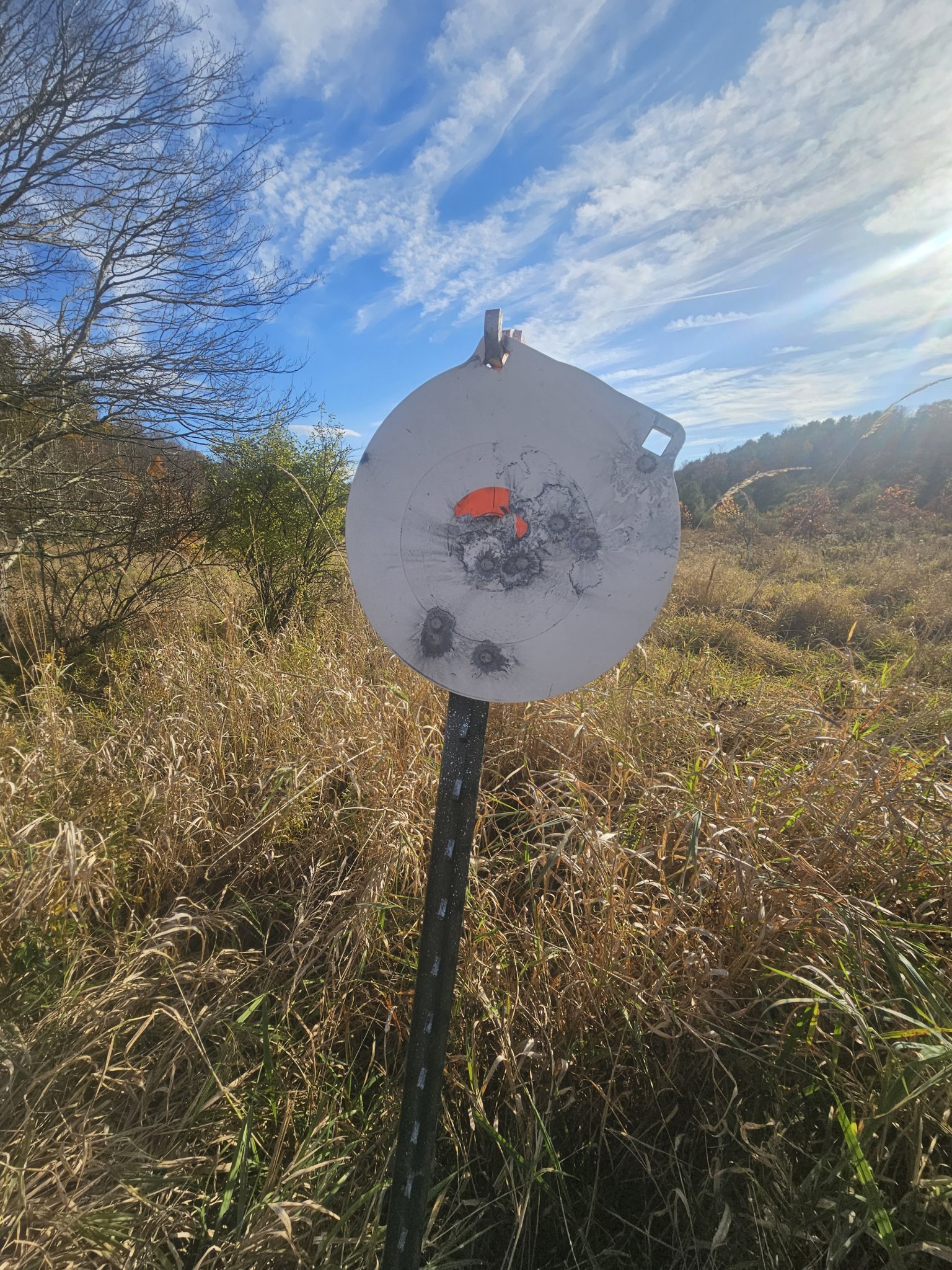

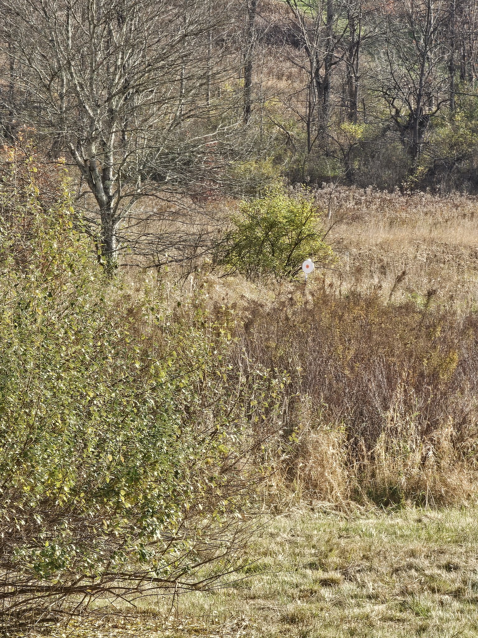

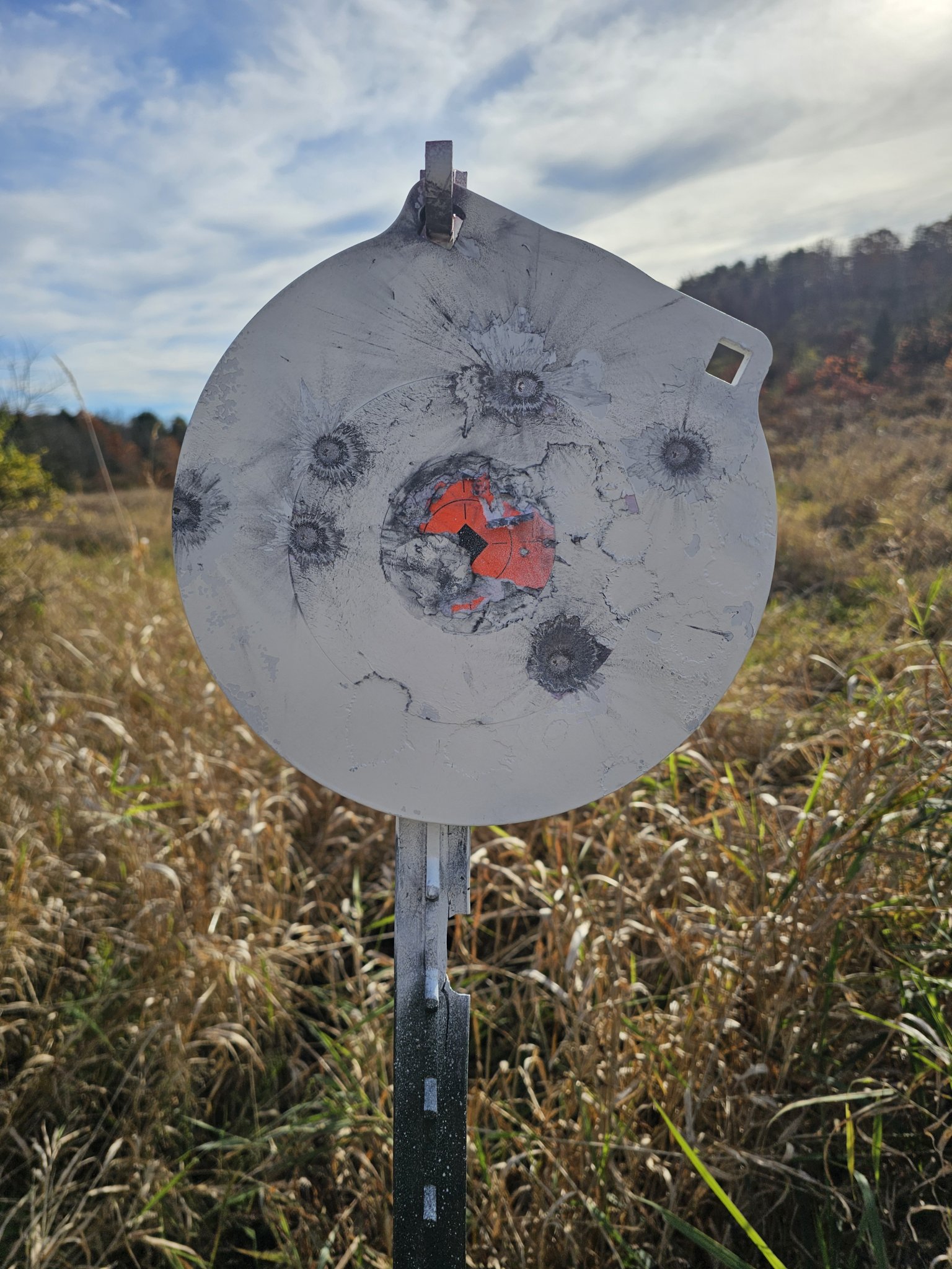

Finally got chance to stretch the legs on my LMT 6.5 CM. If I get creative here at my house, I can get about 640 yards without much difficulty. There is a slight pucker Factor as I am shooting over my primary electrical service cable to my house. I make sure I hold for elevation, not dialing today!
I'm happy with this rifle. The AR-10 platform is much more challenging to shoot accurately than a heavy bolt-action rifle, but I find the challenge fun. Honest accuracy seems to hover right around 1 MOA with Premium Factory ammo or hand loads that I've been shooting. 5 rounds at 100 yards will quite often get in the .7's, but just as often I will shoot 1.2". It's frustrating because it's always one flyer that opens up the group, typically a lack of focus on my part especially with follow through. Shooting fundamentals are so much more important with large frame AR, it is unforgiving when trying to print tiny groups!
Regardless, I was pretty happy that I went 9 for 10 on a 10" plate at 640 yards on a pretty gusty day from the bed of my pickup truck. I can't wait to get back out there and do it again.

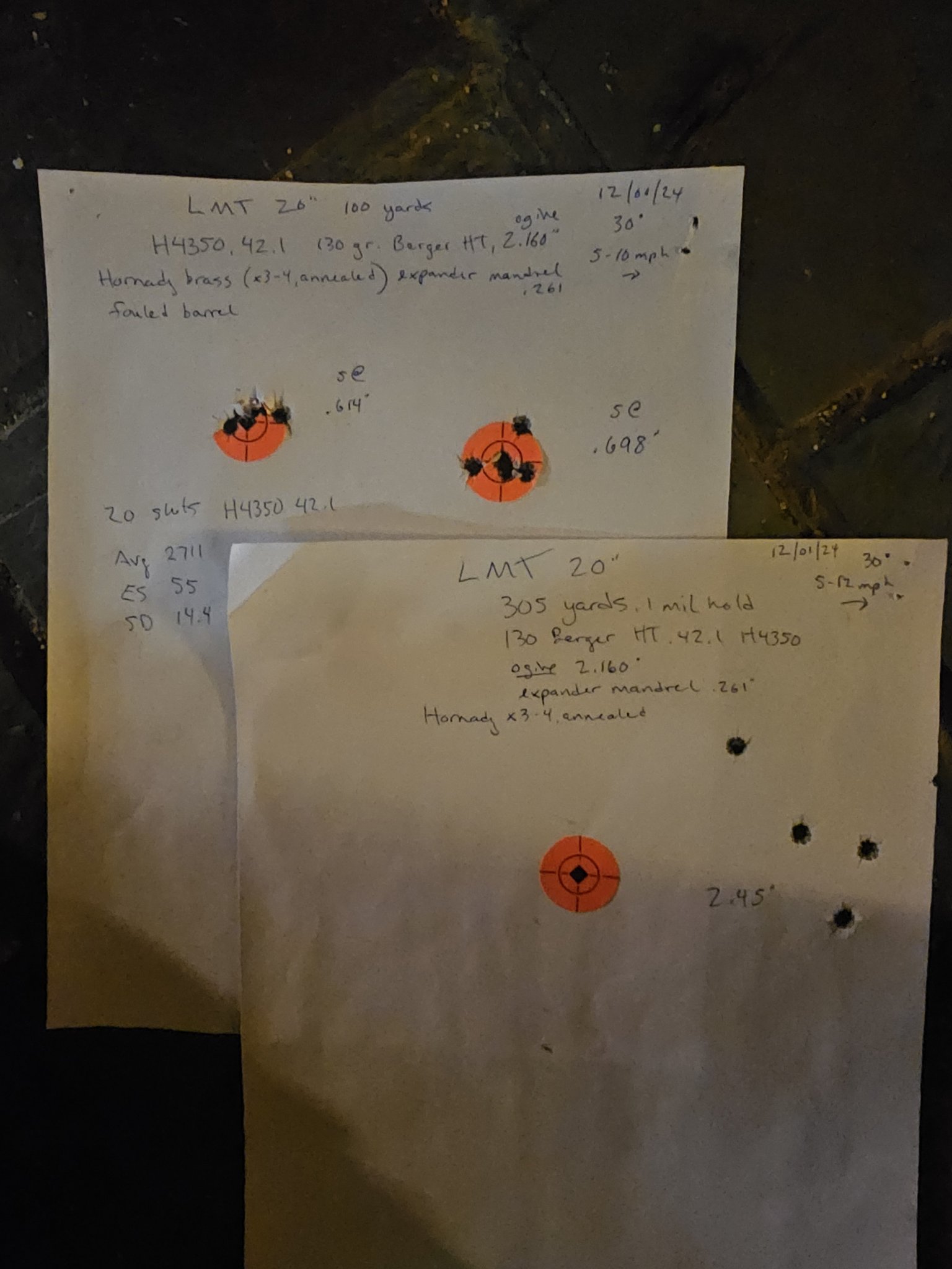

I've been playing around with increasing neck tension using expander mandrels, I've also been playing with a Lee Factory crimp die. Neck tension was .263 ID prior to using the mandrels, now I am getting 0.261 and I'm very happy there. The bullets seating force when hand loading feels much better now
Groups were very impressive today, .614", .698", .686", .903", and .848" at 100 yards, all five shot groups.
It was pretty windy, I only tried one five round group at 305 yards, that one was 2.45".

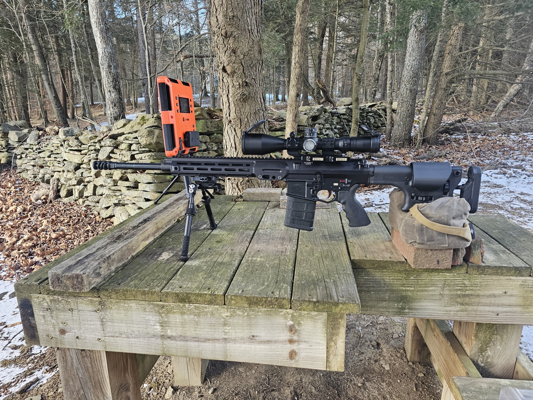

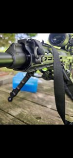

I added ARCA rails from D Wilson a while back, will attach a picture of those

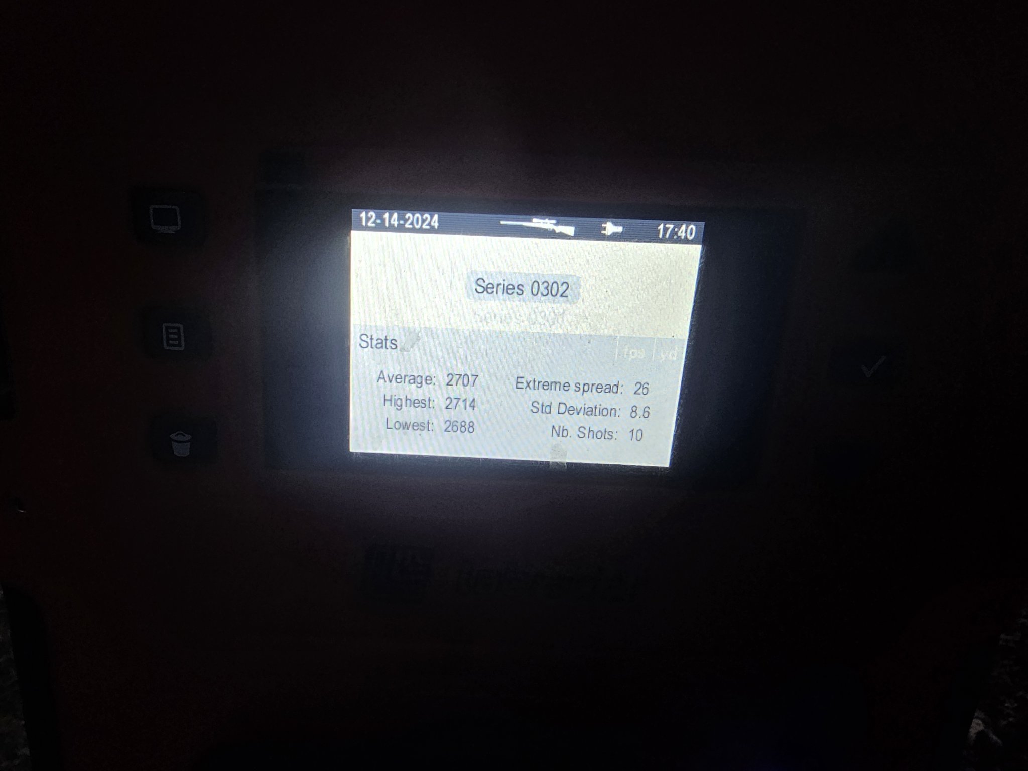

I'm still working on improving my velocity consistency, but 42.3 grains of h4350 with a 130 Berger hybrid seems to be the ticket. Average muzzle velocity 2732, extreme spread 38, standard deviation 11.5, over 20 rounds measured. 42.1 was also good. At this point I'm happy with anything over 2,700 with standard deviation under 14

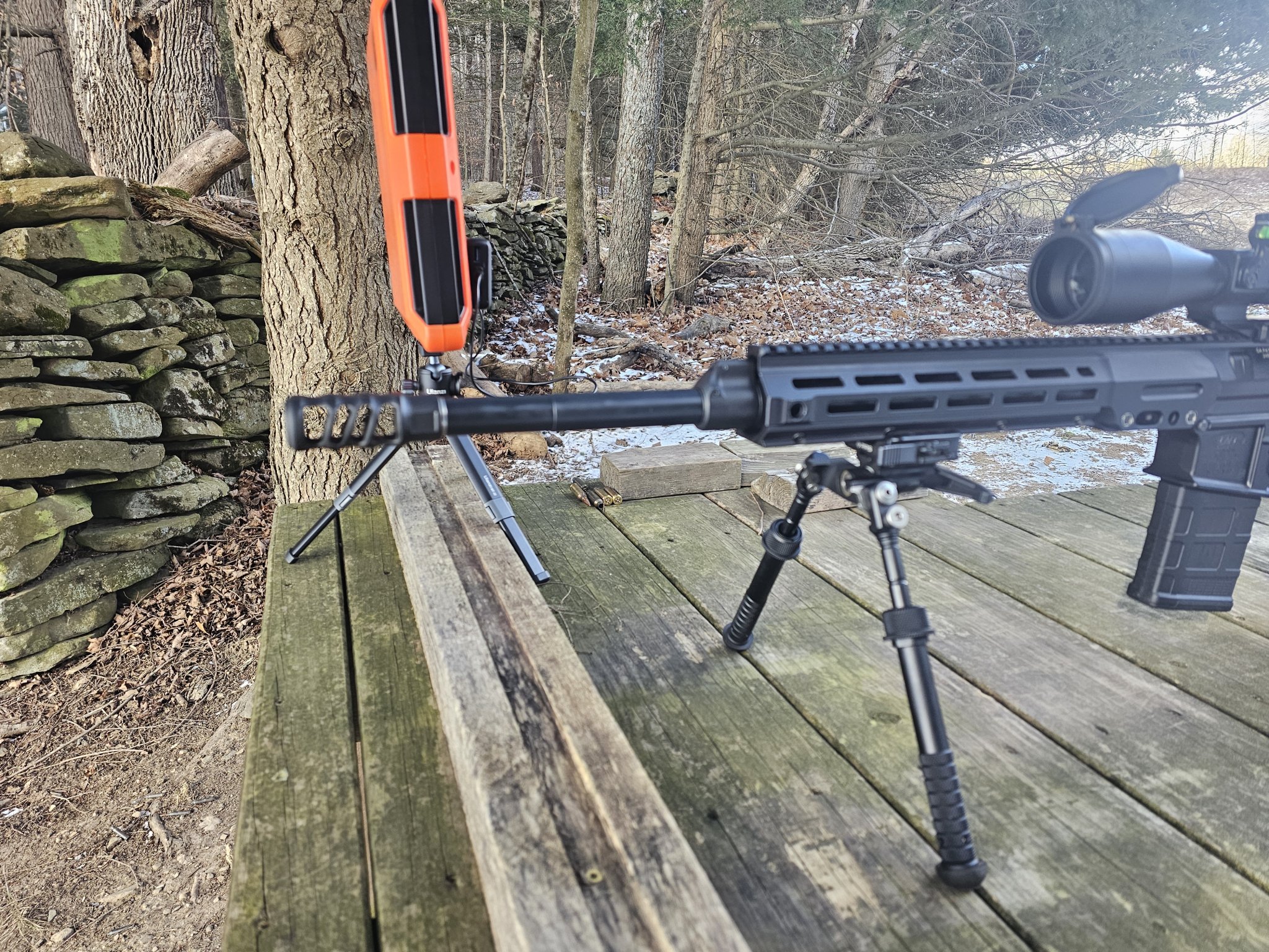

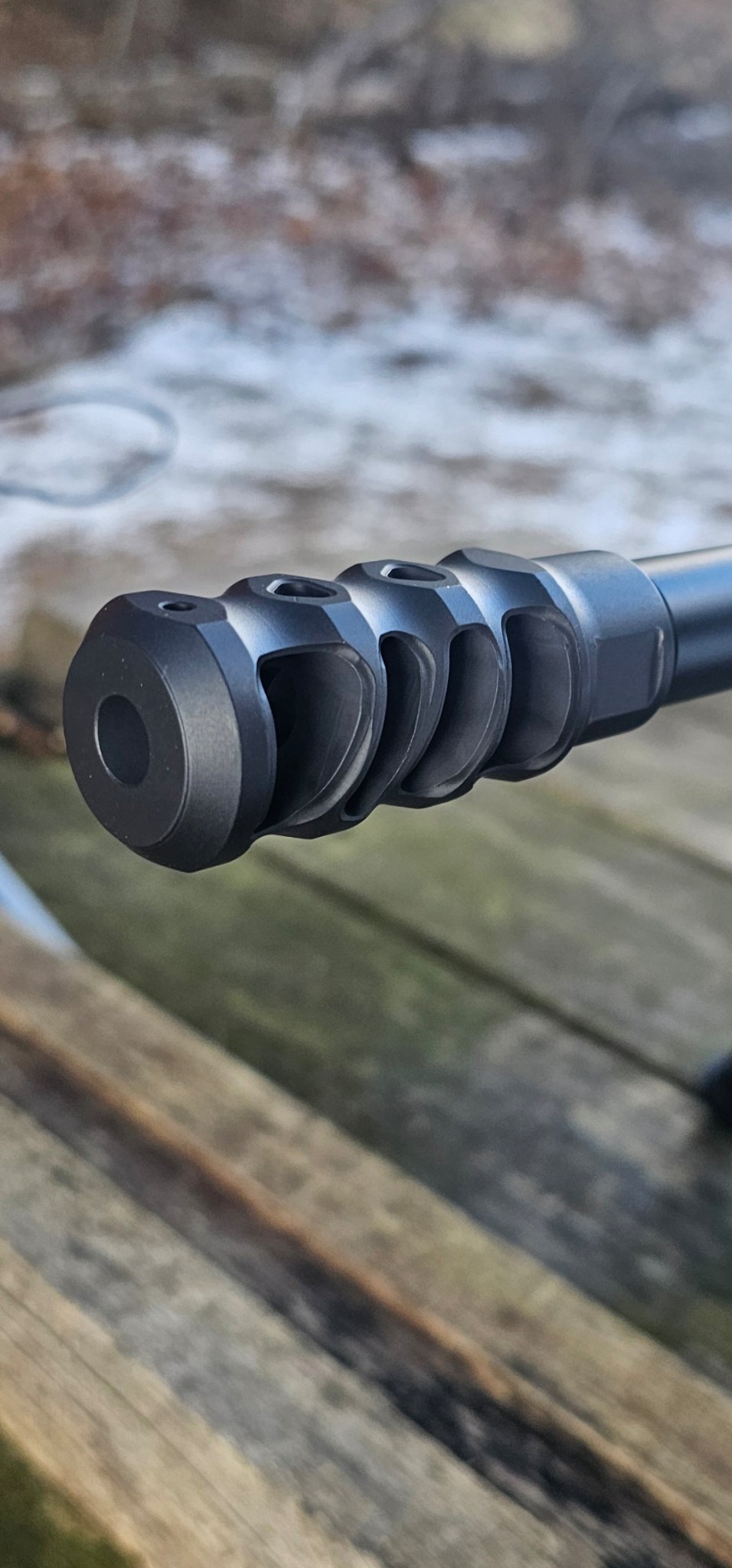

I spent another lunch break with the LMT today. I recently added a factory LMT muzzle brake, just a heads up they are clearing these out on their website for $25, they were usually $135. I had to get a shim kit separately. I used dead air, but surefire is probably a better option as it includes a wider variety of shims.
As someone who never used muzzle brakes very much, I was shocked at the recoil reduction. No exaggeration, it now feels like a 5.56 AR-15. I did not notice a ton of blast or additional noise to the shooter, it is an absolute pleasure to shoot this thing now vs the old A2 FH. I will say that it changed my point of impact / point of aim substantially, but during installation I also detached and reset the barrel, and also re-torqued the scope base prior to shooting today. The rifle started out extremely clean, I used a borescope, Boretech Eliminator, bronze brush, and cleaned this thing to bare metal following my last range day.

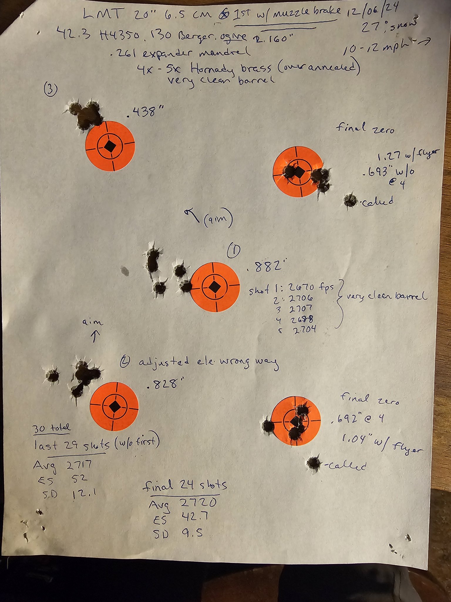

All groups were 5 rounds at 100 yards, keep in mind that I was adjusting my zero as I went. I shot my best group ever today with this rifle, just under .44". I had a couple of Flyers toward the end, the 27 degree cold and the 12 mph wind was starting to get to me, but overall I am absolutely thrilled with the performance of this rifle. Final 24 shots averaged 2,720 fps, extreme spread 42.7, standard deviation 9.5. I will take that all day long with a large frame AR.
