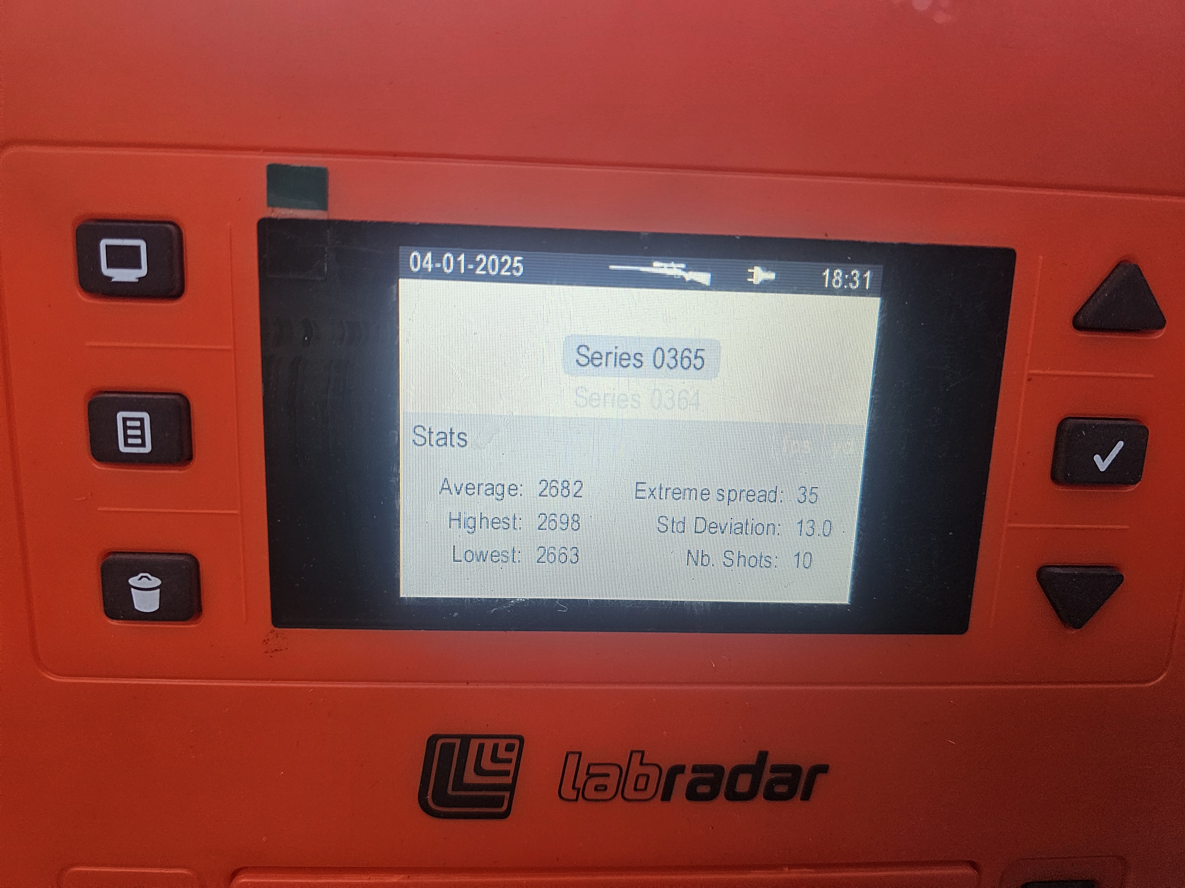

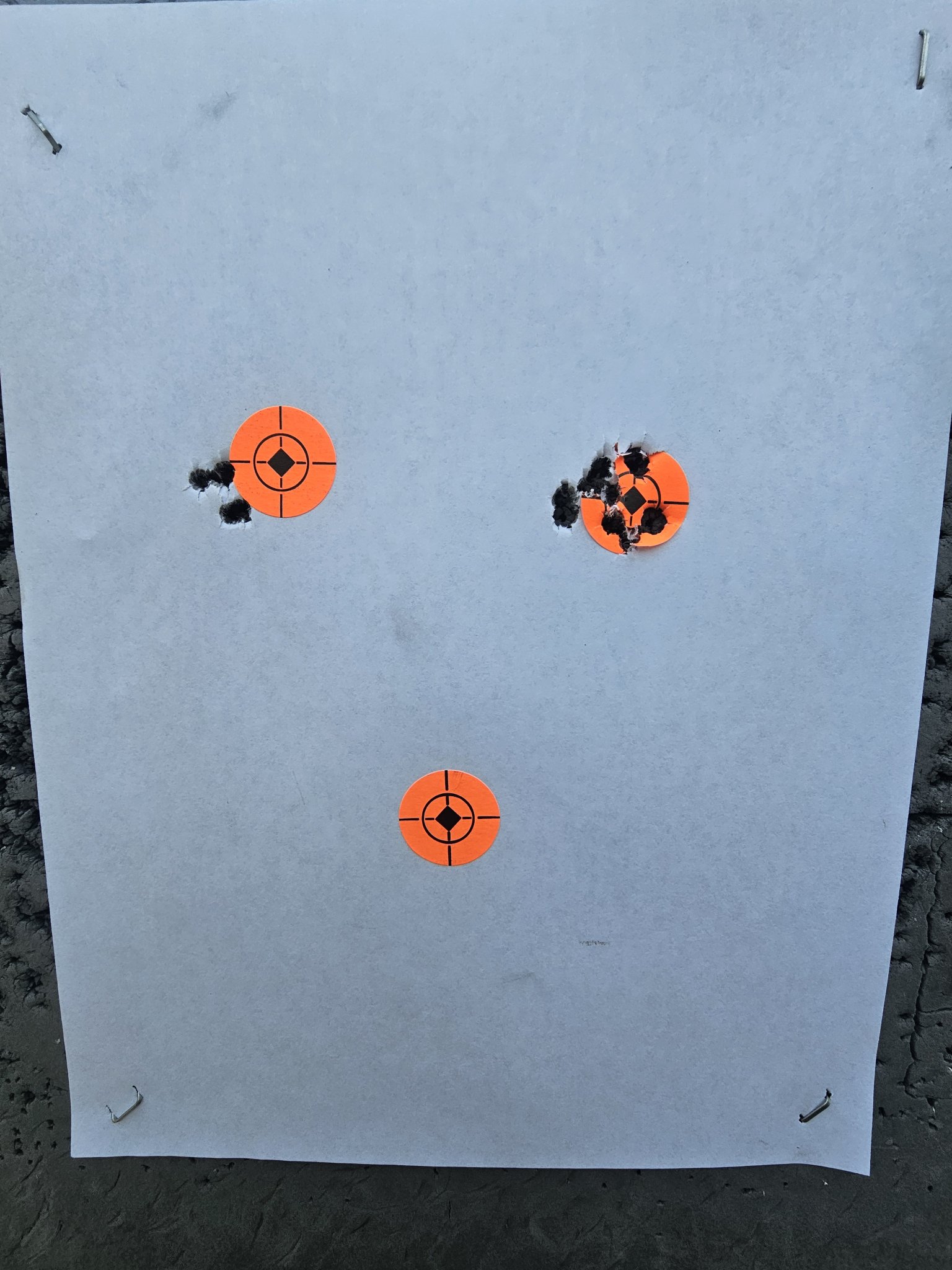

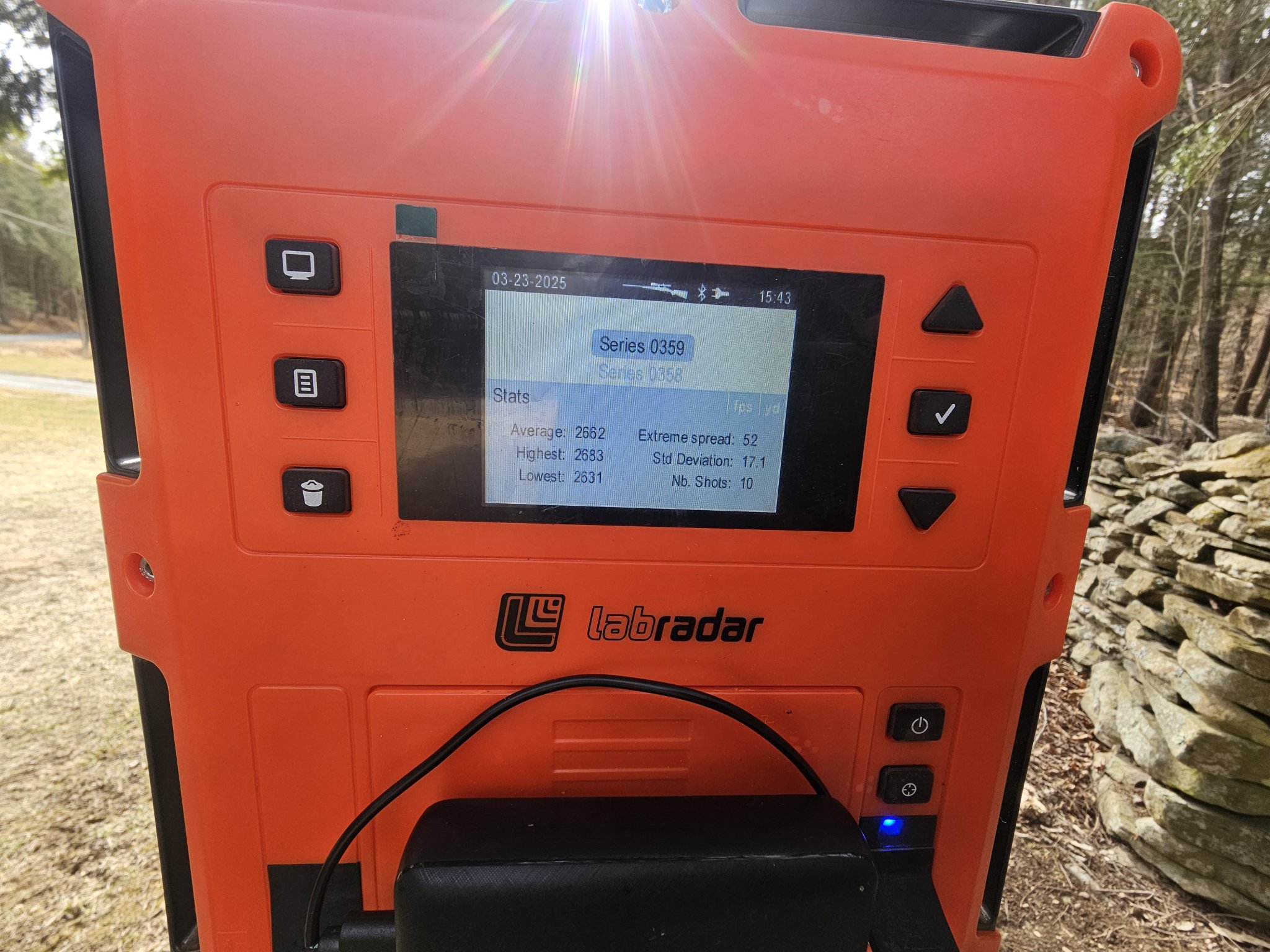

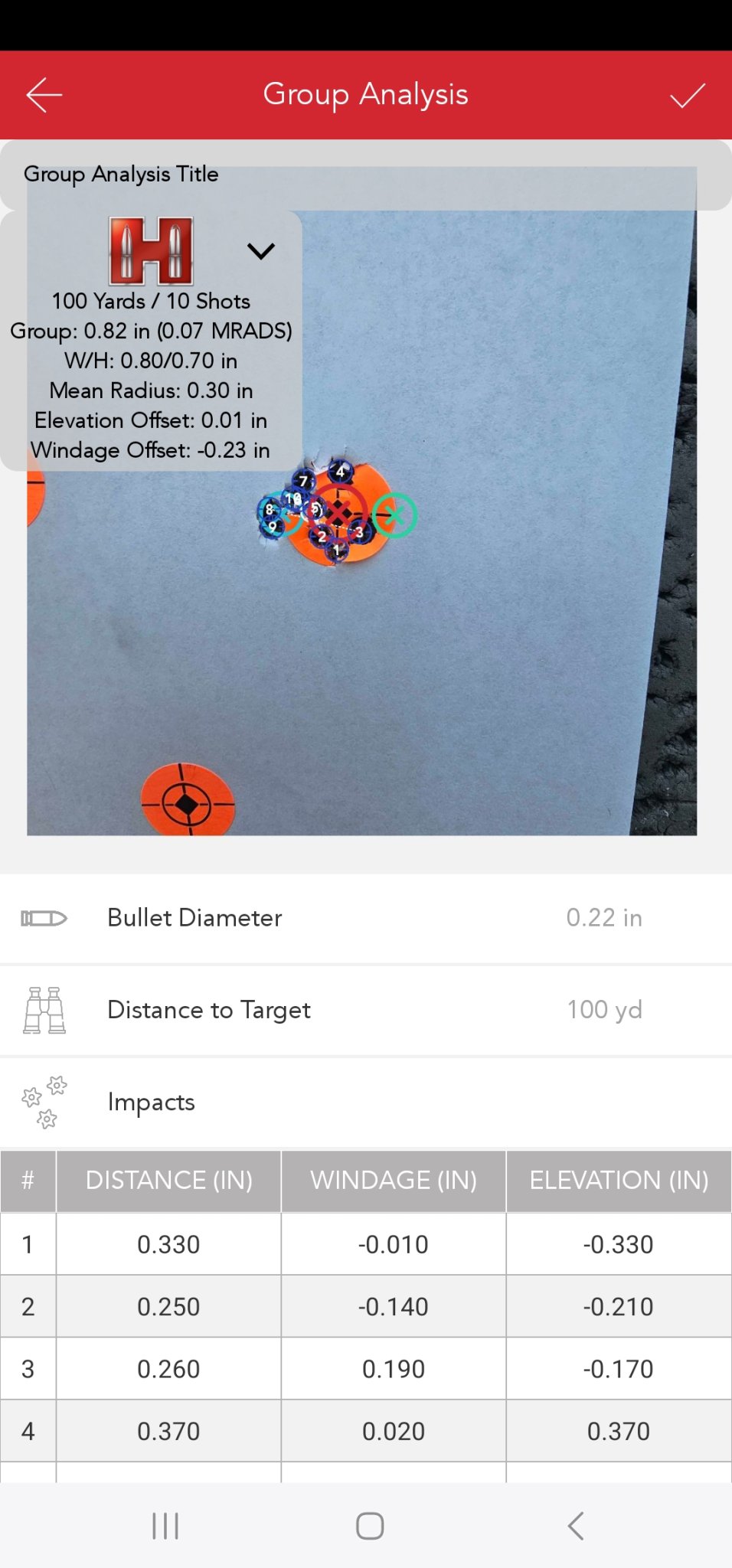

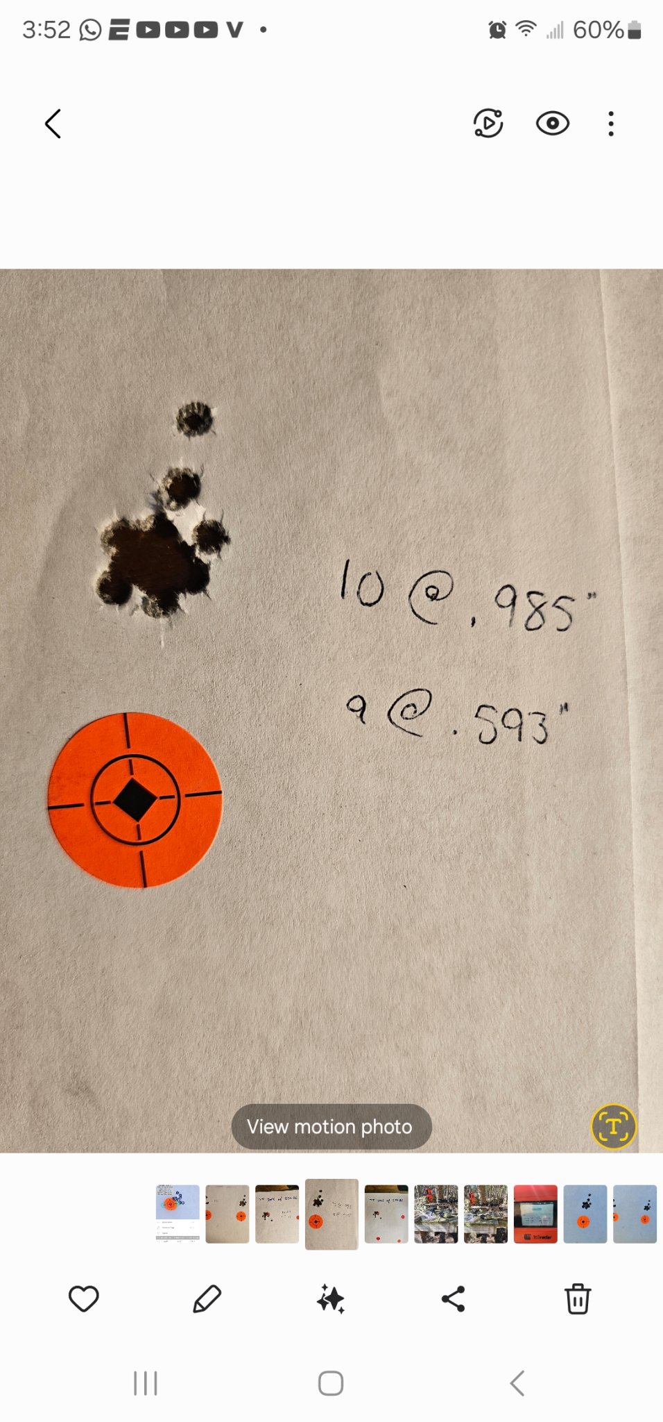

I'm going to post a quick review, as I was unable to find much information relating to LMT barrel conversion accuracy, specifically relating to how a barrel performed before sending it to D Wilson for conversion versus post conversion results.
I'm happy to say accuracy seems unchanged following the barrel conversion, which is to say it is very good.
I used the exact same ammunition, loaded on the same day with the same lots of components. This is hand loaded 77 grain Sierra match king, but other ammunition from AAC produced repeatable results as well. All groups were 10 rounds fired at 100 yards.
The barrel I'm focusing on today is a 16" Bartlein 223 from Craddock Precision. Prior to sending it off, I fired this group from a mocked up traditional AR upper:
I just came back inside from firing this group post D Wilson conversion:
That high shot was my first round, some of that might have been me, dealing with 20-30 mph wind and I'm not necessarily a precision shooter. That said, I'm very pleased with the results. I wanted to document my very unscientific findings, just in case anyone was curious.

I have multiple D. Wilson LMT conversions, all of which are Proof CF barrels and every single one shoots amazing. I’ve had him chop a couple of factory barrels as well and I noticed no accuracy degradation. Best in the biz for this service, full stop.

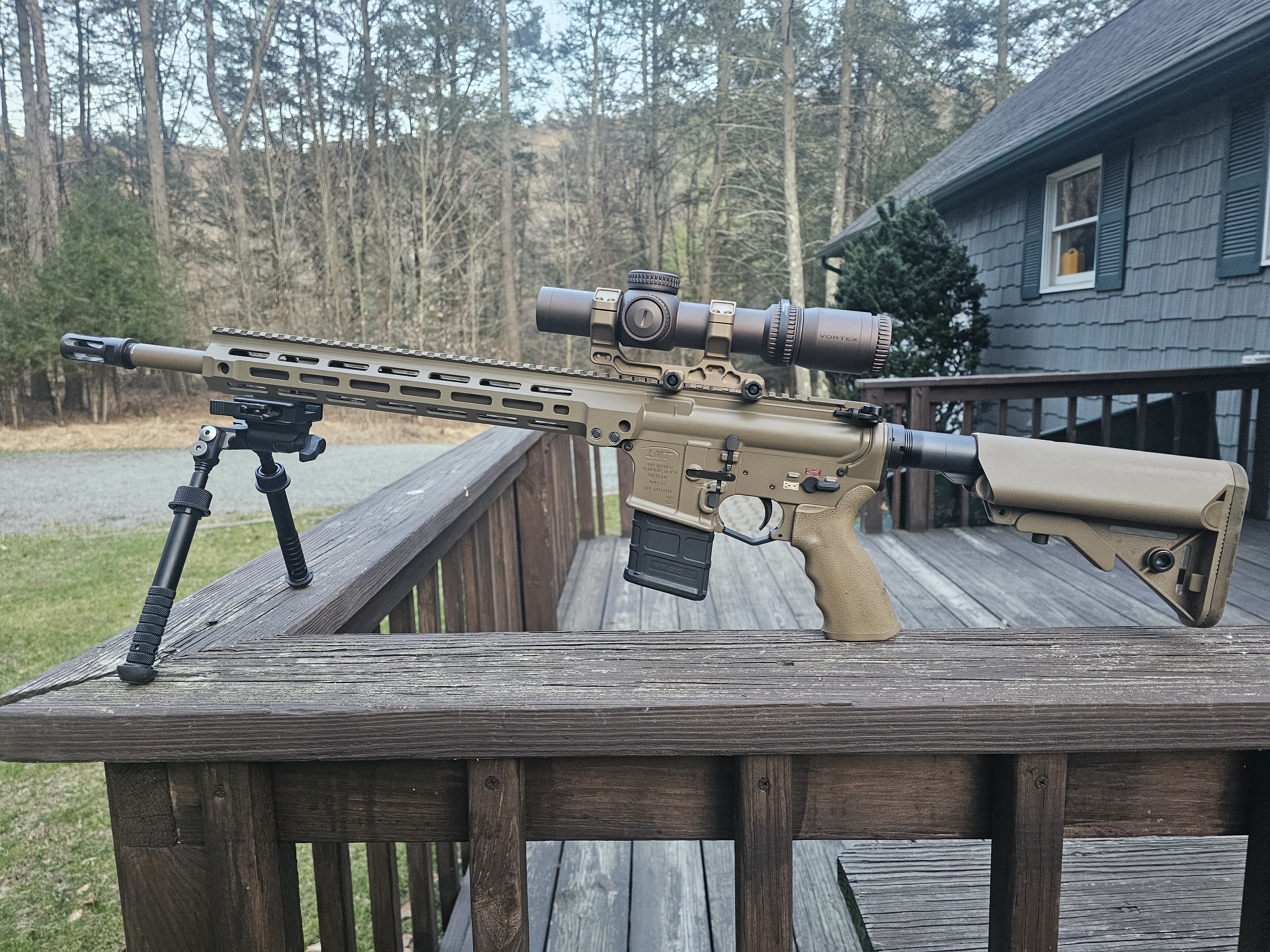

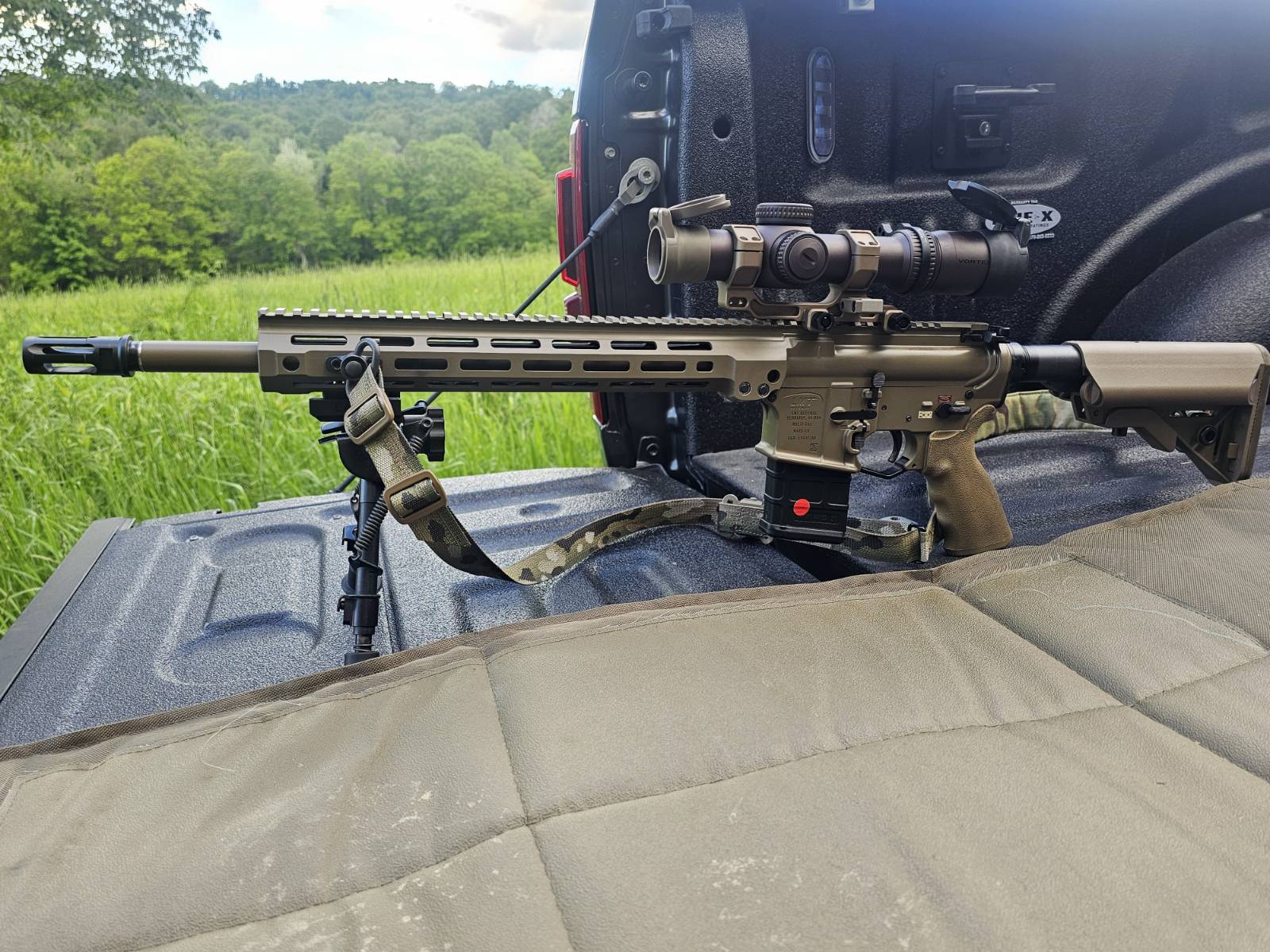

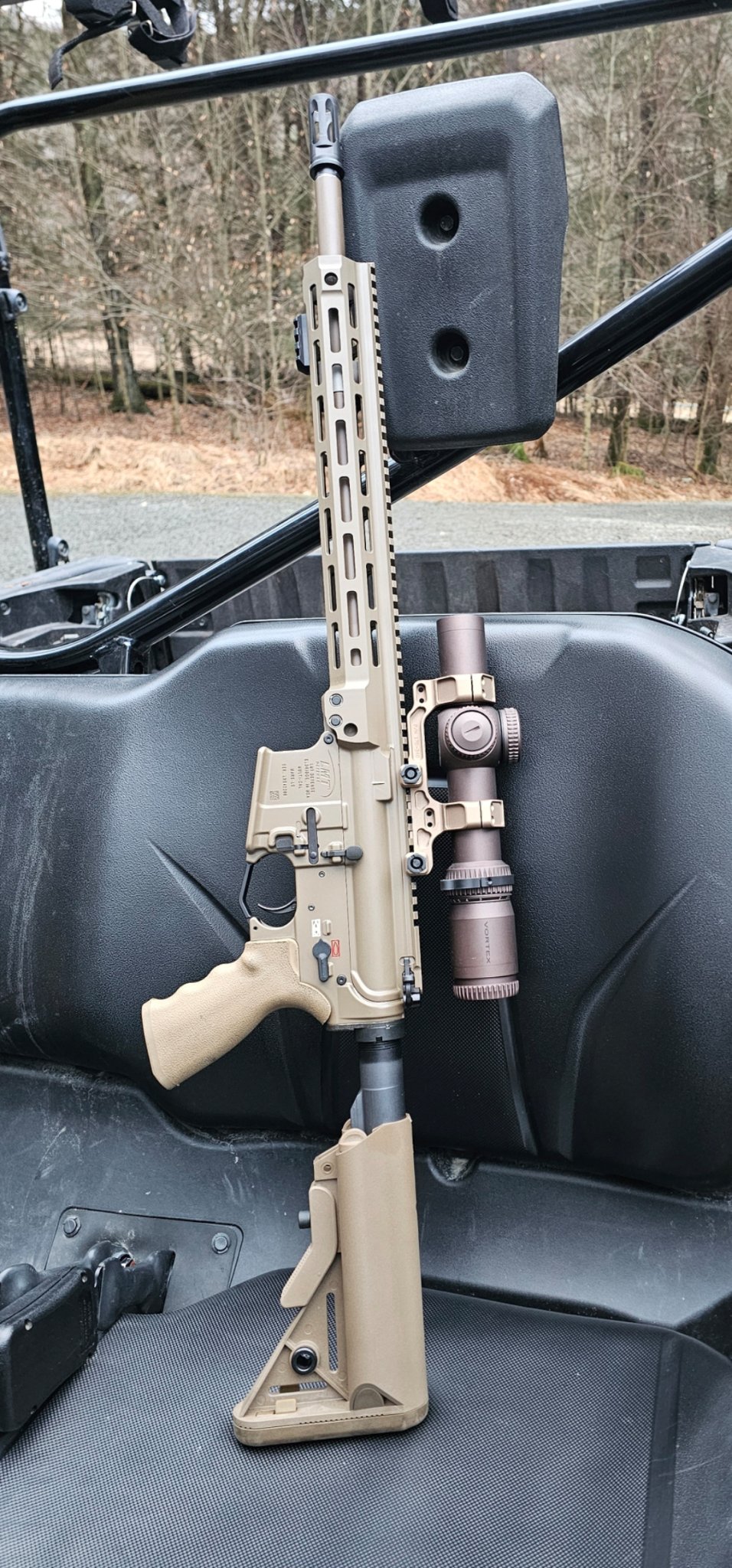

Just a quick follow-up, as the rifle is now in final form. It's still shooting great, I switched to a more practical optic, Vortex 1-10 razor. I've read some people shit on this scope online, but I think it's outstanding for my particular use. It can still shoot small groups, it's approaching Red Dot speed up close, and it's perfectly suited for an accurate AR-15 inside of 500-600 yards

I ran the Vortex Razor HD Gen 3 1-10x on my 14.5" 6 ARC this past season and it certainly got the job done, although I never took a shot on game beyond 300. I have since moved that optic to another rifle to move to a new optic in hopes of gaining some more top end, a larger objective and a better reticle for hunting. My biggest complaint about the Razor 1-10x is how large the center dot is in the reticle and when being used for hunting it doesn't allow for a very precise shot on game at distance.
I've replaced it with a Leupold Mk HD 3.6-18x in hopes of rectifying all of the areas where the Vortex fell short. It has 8x more power, a 20mm larger objective for more light in those final minutes of golden hour, a better reticle for more precise shots and all while only weighing an extra 4oz. If the Razor fits your mission then rock on because it's a great optic, I only replaced mine because I simply just demanded more out of the optic.

I almost bought a Leupold MK5 3-18x for this rifle, based on the same logic that it's only an additional 4-5 oz. However, the mount would probably be slightly heavier at 35 mm, and I'd still feel the need to add a piggyback red dot, so it's really probably another 10 oz or so.
Additionally, then I was thinking that I could just get a Nightforce NX8 2.5-20x, as that's only a few ounces more than the Leupold. Things started to snowball in a hurry 🤣
I plan on building or buying a Geissele 6 ARC soon, so I figured I would go that way with the next rifle.

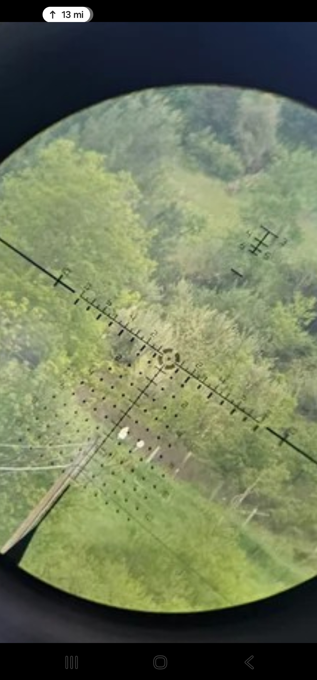

I believe the vortex center dot is .2 mil (.72"), but I like that it is translucent, I can kind of see behind the dot. I don't dial with this scope, so the reticle subtensions give me a finer aiming point at distance. I haven't taken this scope beyond 305 yards yet, but I was able to keep things at or slightly below MOA at that distance. I hope to take it out to 600 plus this weekend.

Oh I get it. Once I decided to move out of the 1-10x I considered the TT315 (heavy, crap reticles, pricey), ZCO 420 (heavy, pricey), NX8 2.5-20x (meh glass) and the Mk5 3.6-18x (slightly less meh glass). I went with a piggy back RMR for the Mk5 instead of my usual ACRO P2, saved a whopping 1oz lol. I think for how I use this rifle the Mk5 will be the best trade-off overall.

I agreee with that scope.
For me I find it easiest to zero and shoot groups , using the 1 mil hold line , then making sure gorup
Is 3.6” high

Take a look at the New Bushnell Match Pro, 3-18.
I did a short review on here in the Optics Section. Still very impressed with the quality, im up to 5 now.
Once I finish load development on the New Geissele 18" SPR Cut Rifled Barrel, one of my Bushnell 3-18 MP will have a permanent home on there.

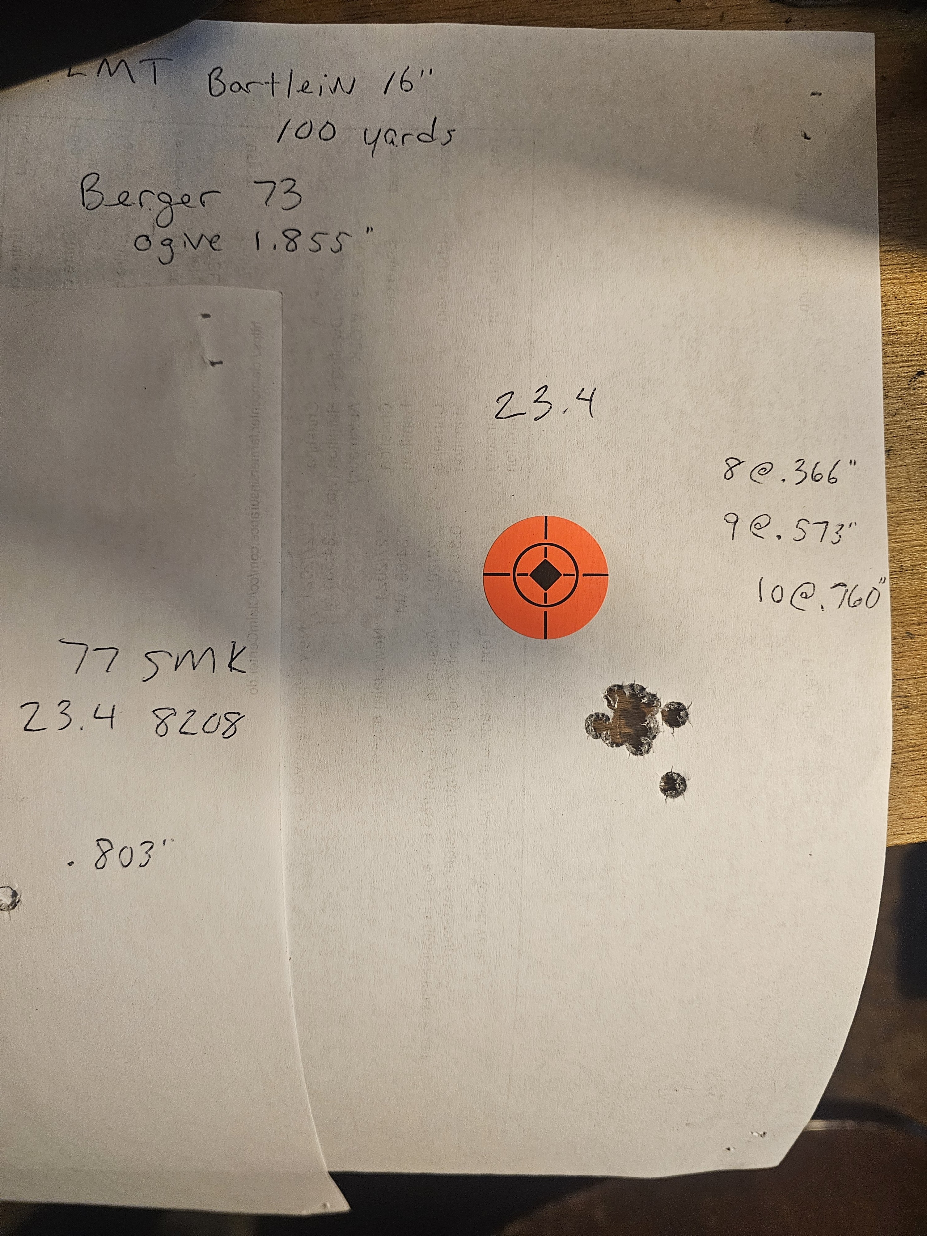

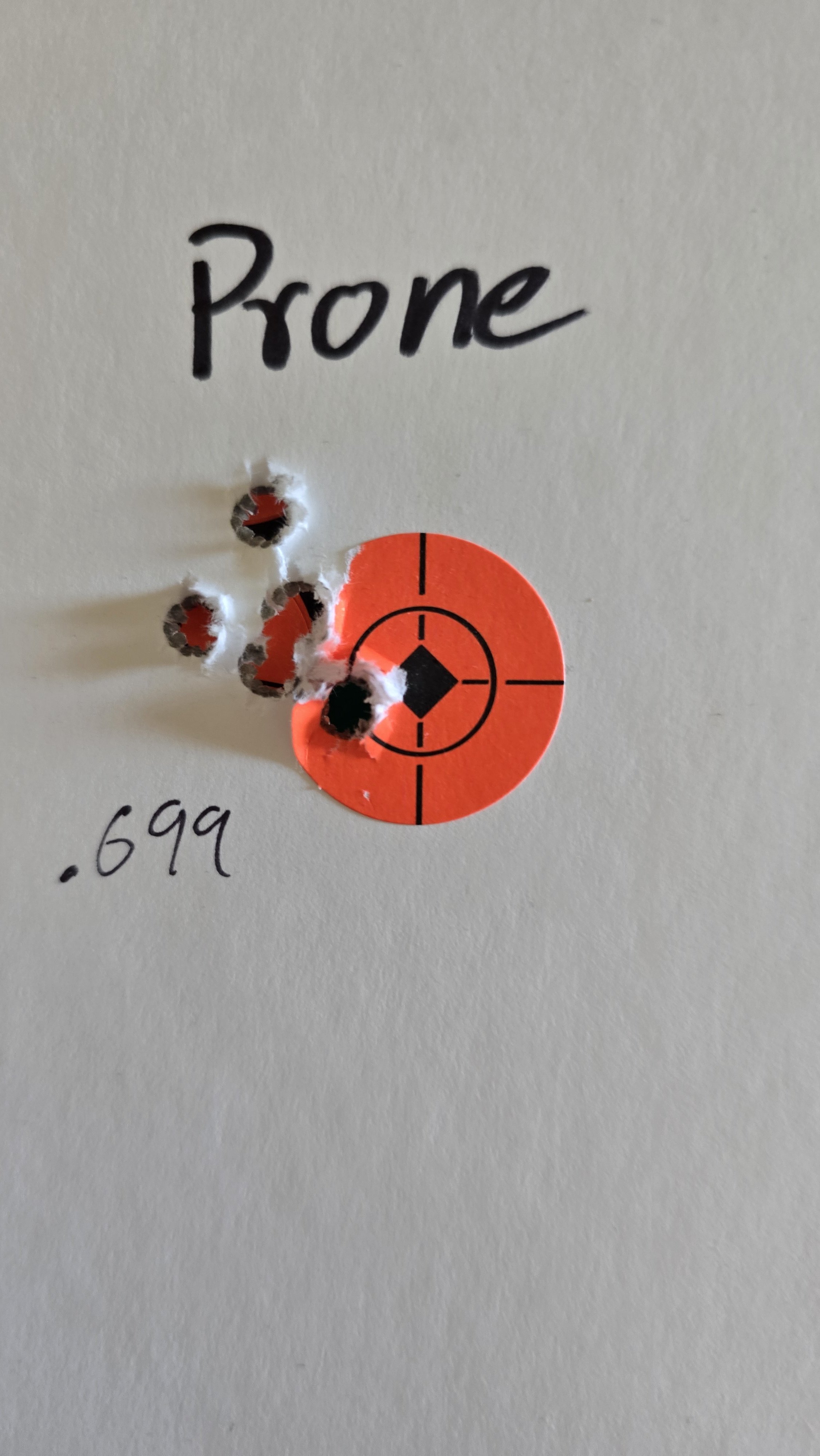

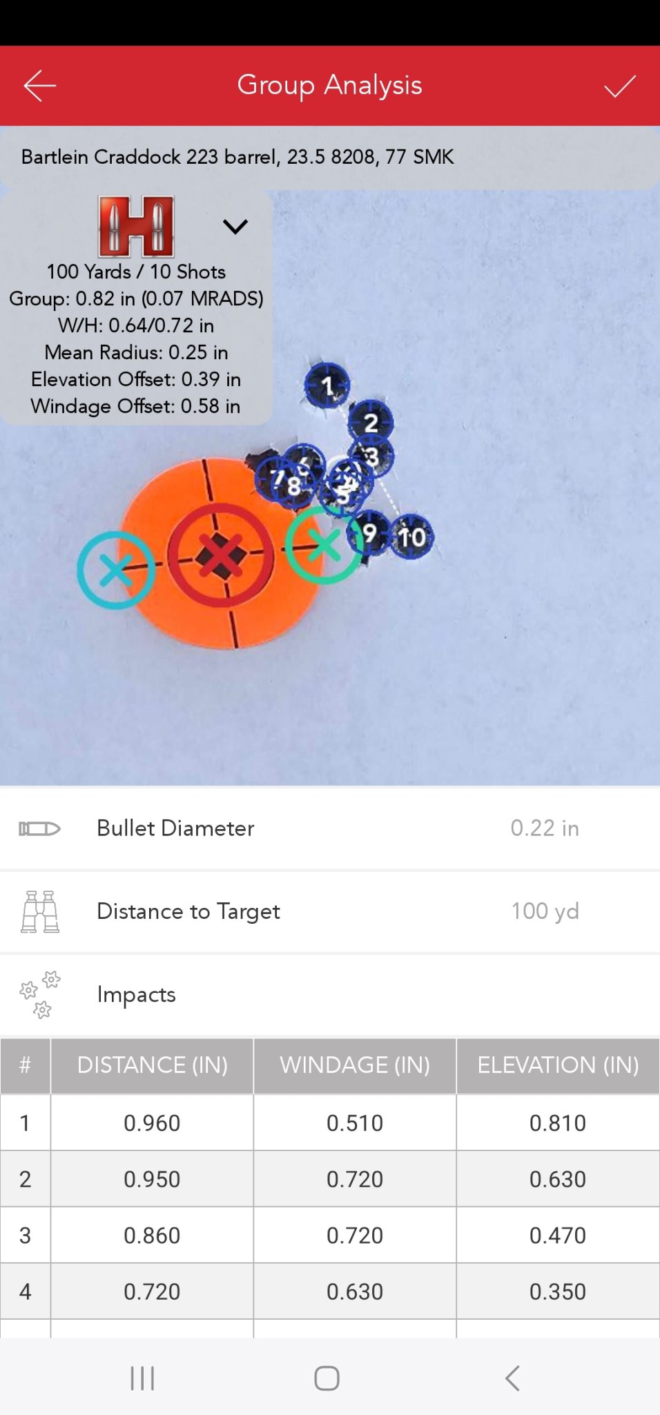

This Bartlein barrel from Craddock Precision continues to do really well in my LMT.
I think I'm going to switch to Berger 73 grain OTM'S. These bullets shoot really well in my three primary AR rifles. I don't seem to get any real flyers, and bullet dimensions are very consistent.
They are the same price as Sierra match kings for me, I'm going to order 1000 tonight. They did really well using a heavy dose of IMR 8208

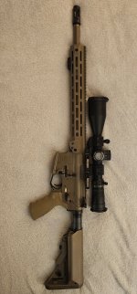

Looks great! Now you need to pick up D. Wilsons ARCA rails.
I have those on my LMT 6.5, they are outstanding. I'm actually trying to keep this rifle pretty lightweight, although the barrel profile a bit heavier than Factory LMT. Barrel profile is one thing that I'm willing to add a little weight on.
I know they don't add much, but I'm even avoiding backup iron sights and hunting around for a lightweight sling that I like 🤣

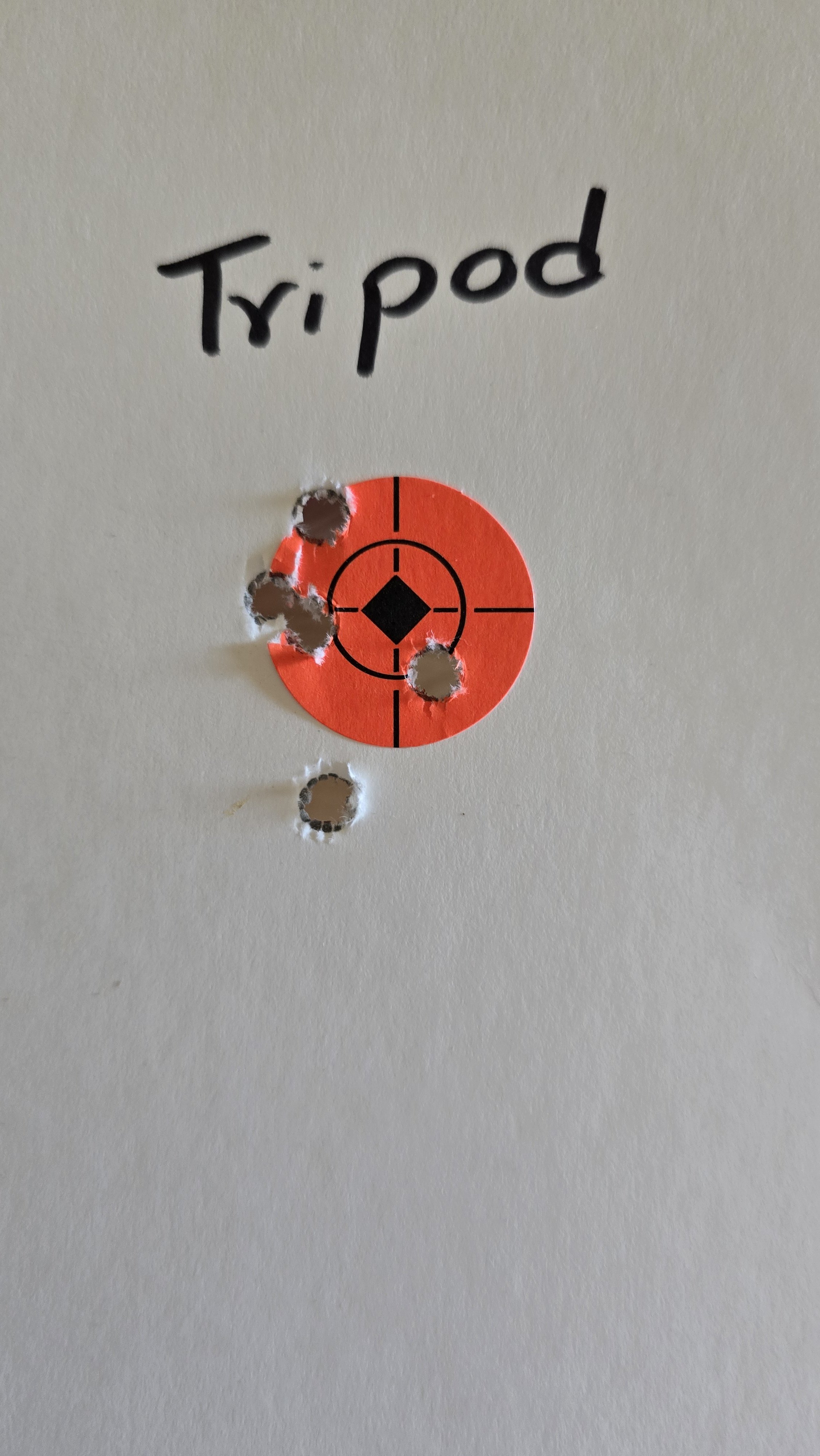

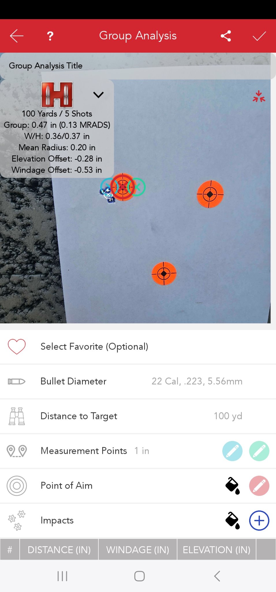

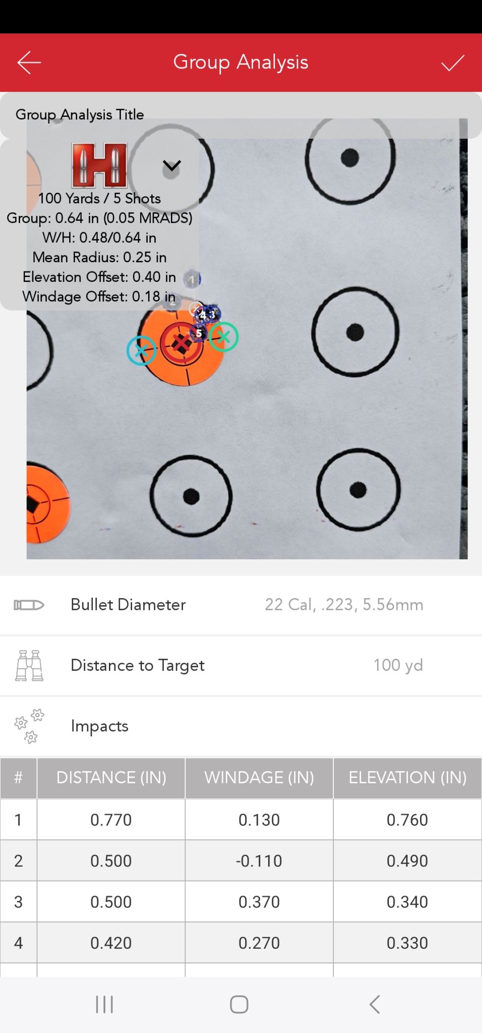

I have a similar report.
Just got my barrel back maybe a week ago but took it out yesterday. I didn't shoot a lot but the accuracy held. I was hesitant with this barrel to begin with but it seems to have gotten sorted out.
Pre- conversion
Post- convention
It was pretty windy and didn't feel great on the tripod but I'll test POI shift more later but if there is any it's not much.

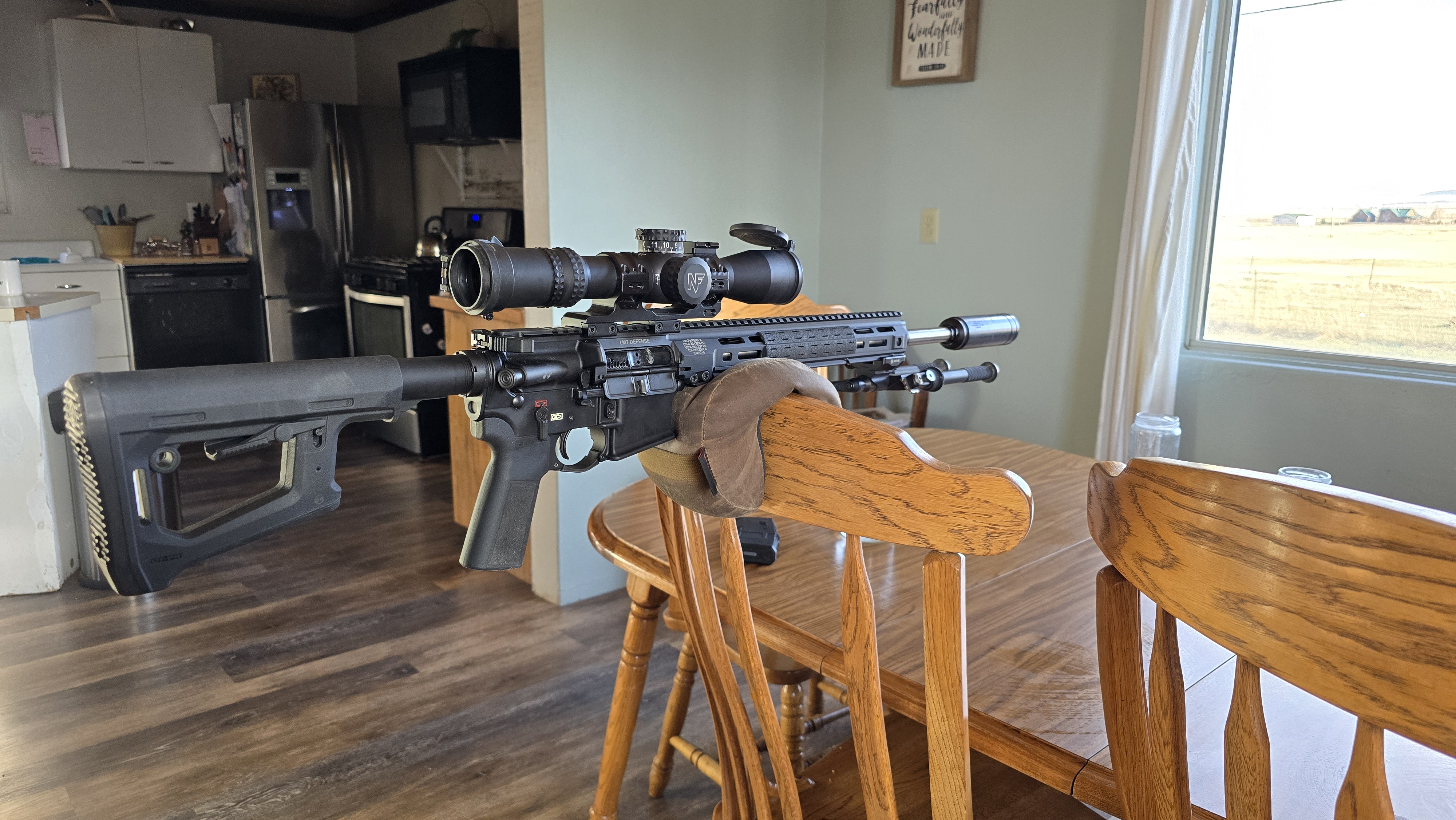

I wish I would have built this gun a long time ago. Colorado is forcing my hand so I guess it's time to build a large frame lol.

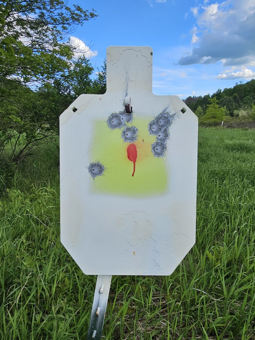

Yesterday, I shot at 636 yards with this rifle, it was one of those rare days where there was very little wind at my house. I am so impressed with this rifle/barrel, equally impressed with the vortex 1-10. I wasn't sure if I'd be able to make accurate hits at distance with this type of optic, but it was pretty easy.
One of the signs of an accurate rifle is the fact that it listened to me when I made small corrections. I could see a relatively tight group a little high and right, I then held a little bit lower and left, and then centered them up. The rifle did exactly what I was telling it to do, I'm so impressed with this setup. It's an absolute blast to shoot.
