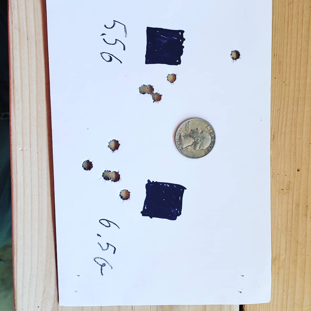

I had D. Wilson spin up an 18in Satern 6.5G barrel for the LMT MRP platform. There is about 2MOA MOA shift from 5.56 barrel to 6.5G barrel.
I initially did this test at 25m with the optic zeroed for the 18in SS 5.56 barrel. The POI between the two calibers at 25M was barely discernable. I moved the targets to 100m and fired the 6.5G group first, then re-installed the 5.56 barrel. Not exactly a true return-to-zero barrel swap but I also didnt torque the bolts back to the exact point either, the included torque wrench leaves something to be desired. Still, close enough that re-zeroing wouldnt be a huge issue between barrel swaps
My POA was the bottom right hand corner of the respective black square.
