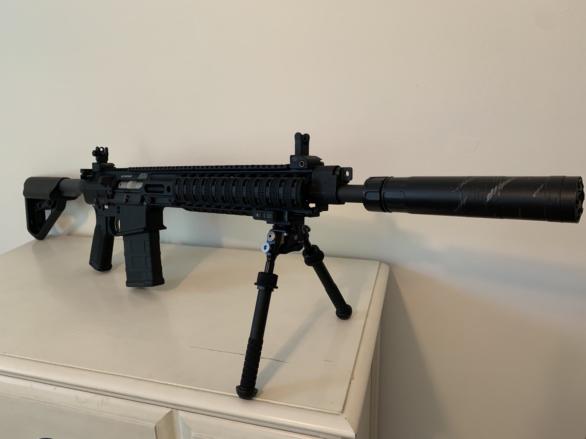

Older thread, but I’m a new LMT convert and wanted to share a lesson learned. Just found an over run of the 308 piston barrel for LMTs Estonian Defense Force contract. Hadn’t convinced myself I needed an Ar-10 platform, but this was too rare to pass up. I had a stag stripped lower (agree with previous trailer edition comments) that I was going to put a new mrp on for a quick solution. Long story short…they are not compatible. Got lucky and found a MARS lower for $500, jumped on it and am now just waiting for all the parts to show up to finish the build. I’ll update with a pic once it’s complete.

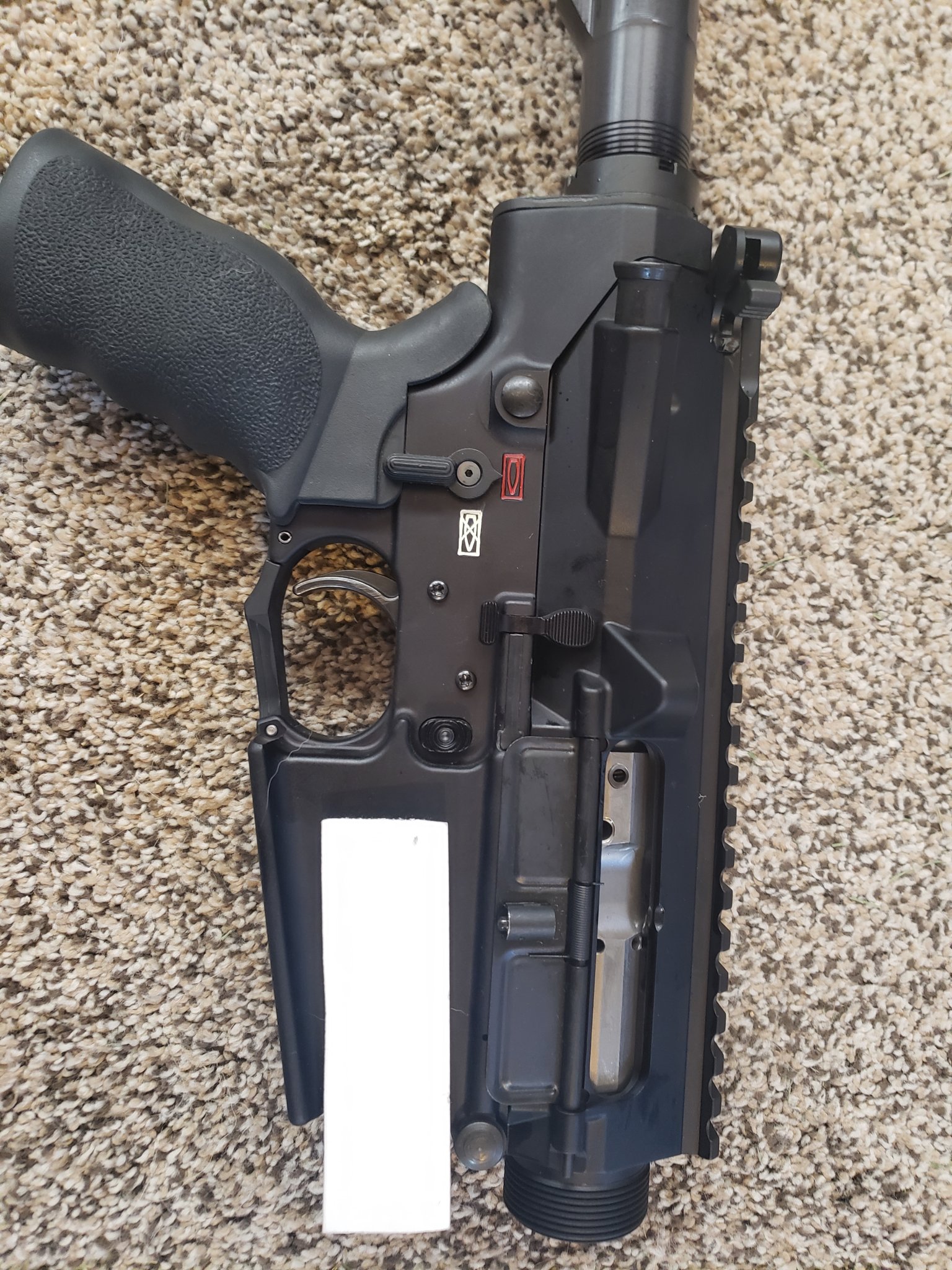

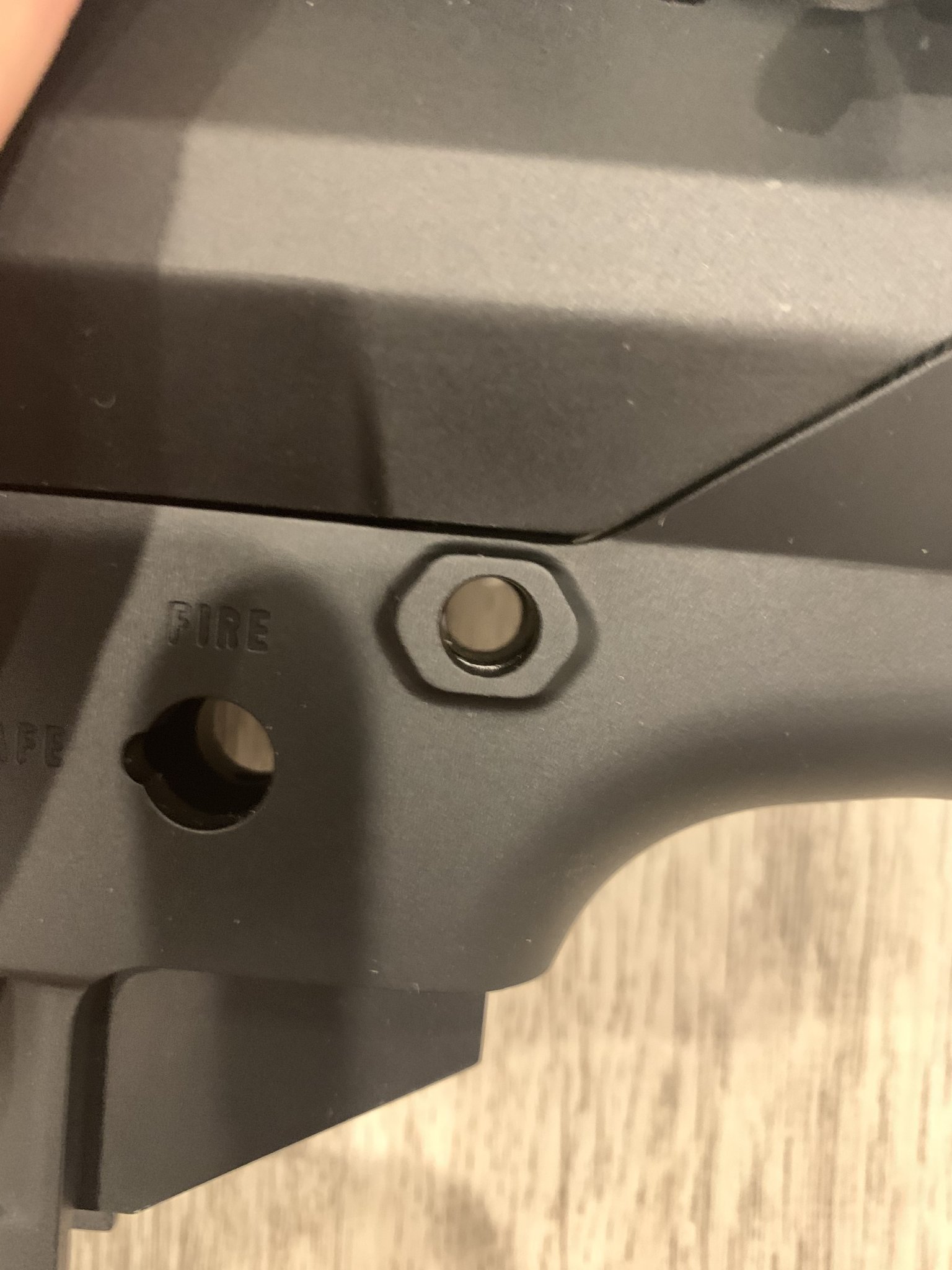

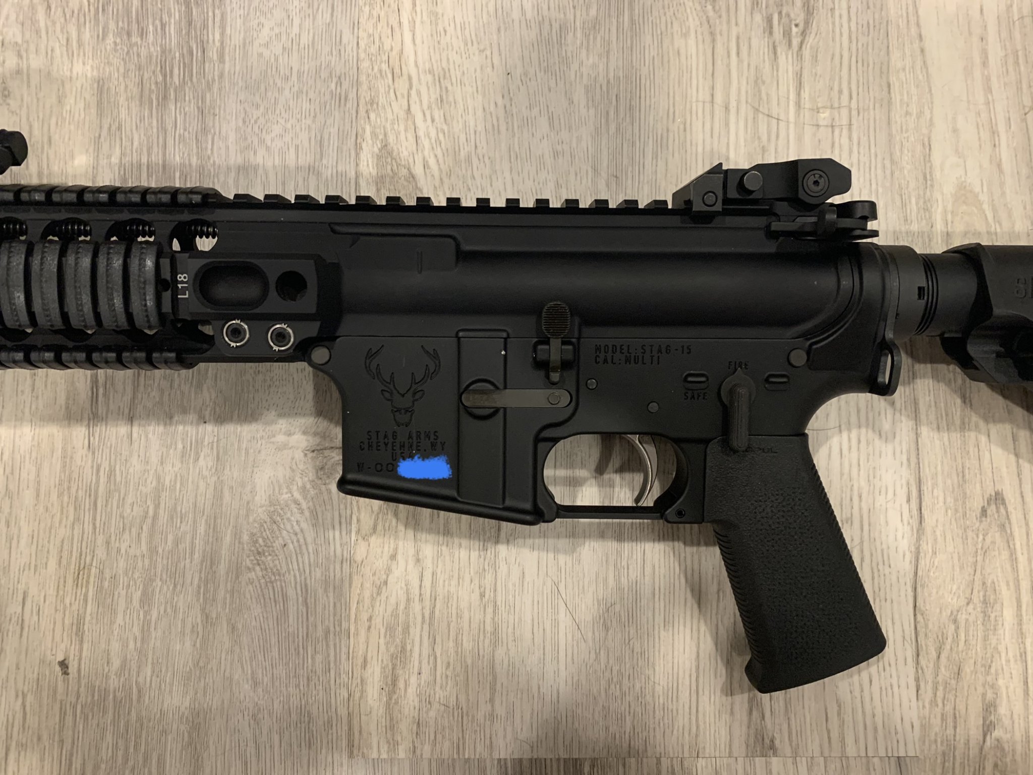

Interesting cuz here is a stag ar10 upper on a mws mars h lower...
Reactions: sinister
The upper has a lip, that I assume fits a recess on the MARS lower. The rear takedown pin impacts the upper receiver and there is visible overlap between the upper and lower take down holes.

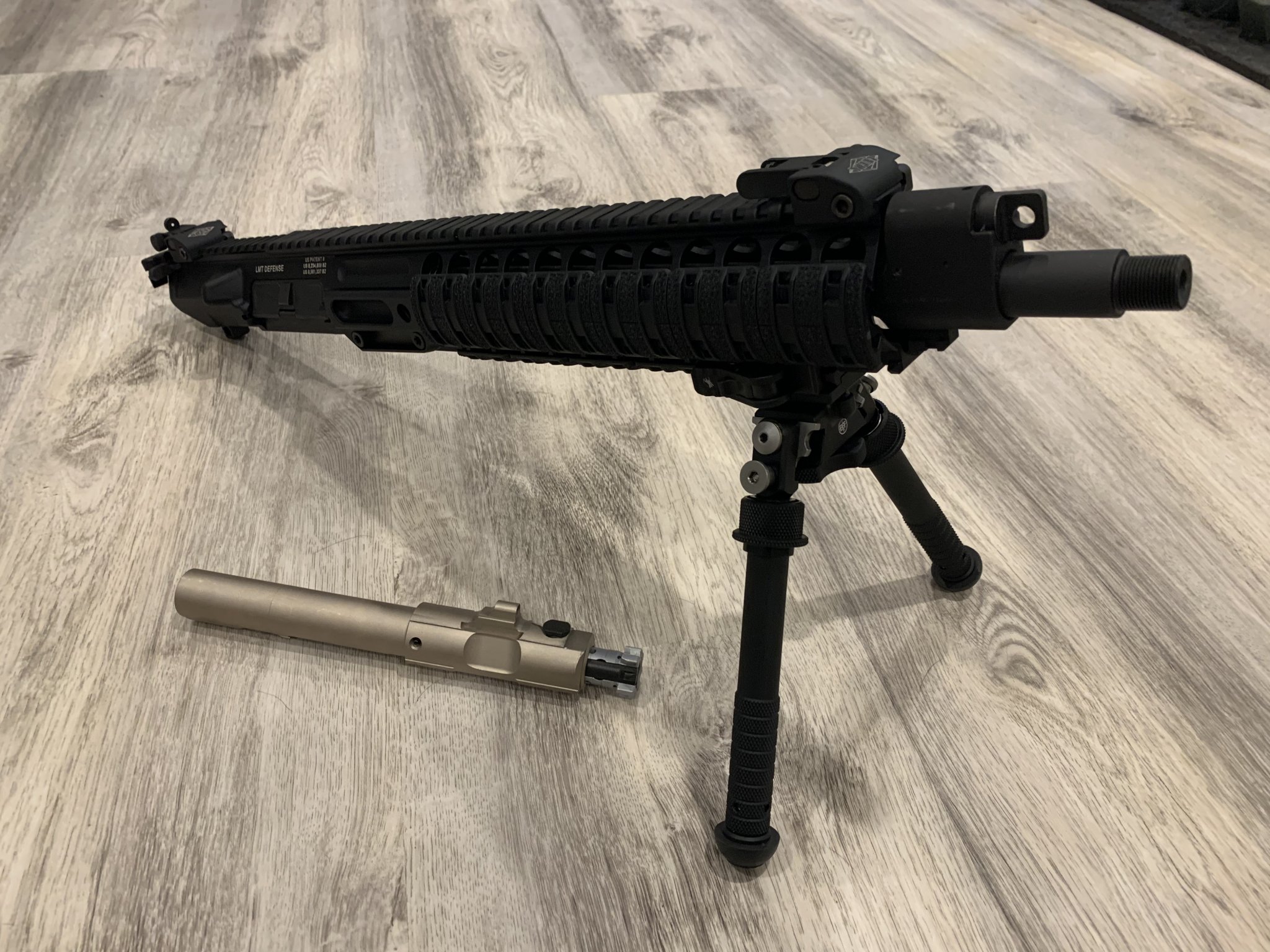

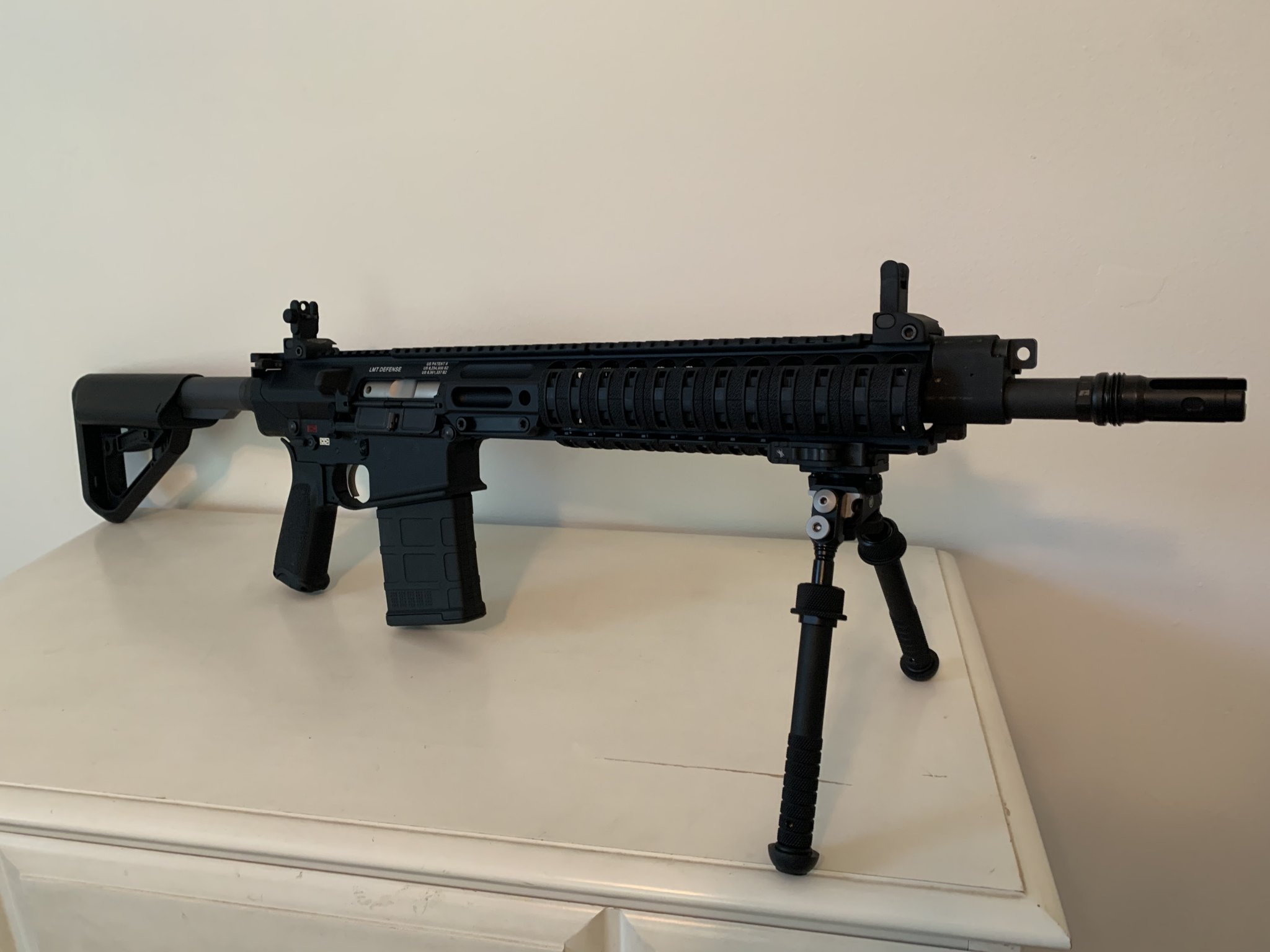

Right on, it is an overrun for the EDF contract. I’ll post a pic of the final build when my MARS lower gets in. Pre Covid, I believe LMT intended to release a civilian version in 2021. Seems unlikely based on current demands of their mil contracts.

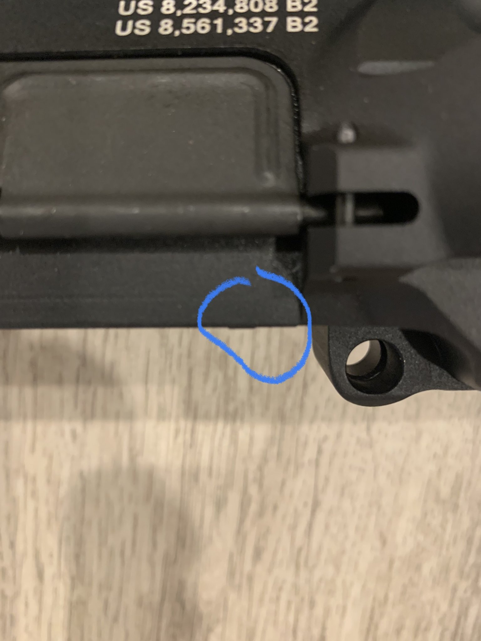

I’ll post this on the 308 builds thread with more details, but here it is! Didn’t need to file the “speed bumps,” nice tight lock up, too. What you’d expect from LMT!
