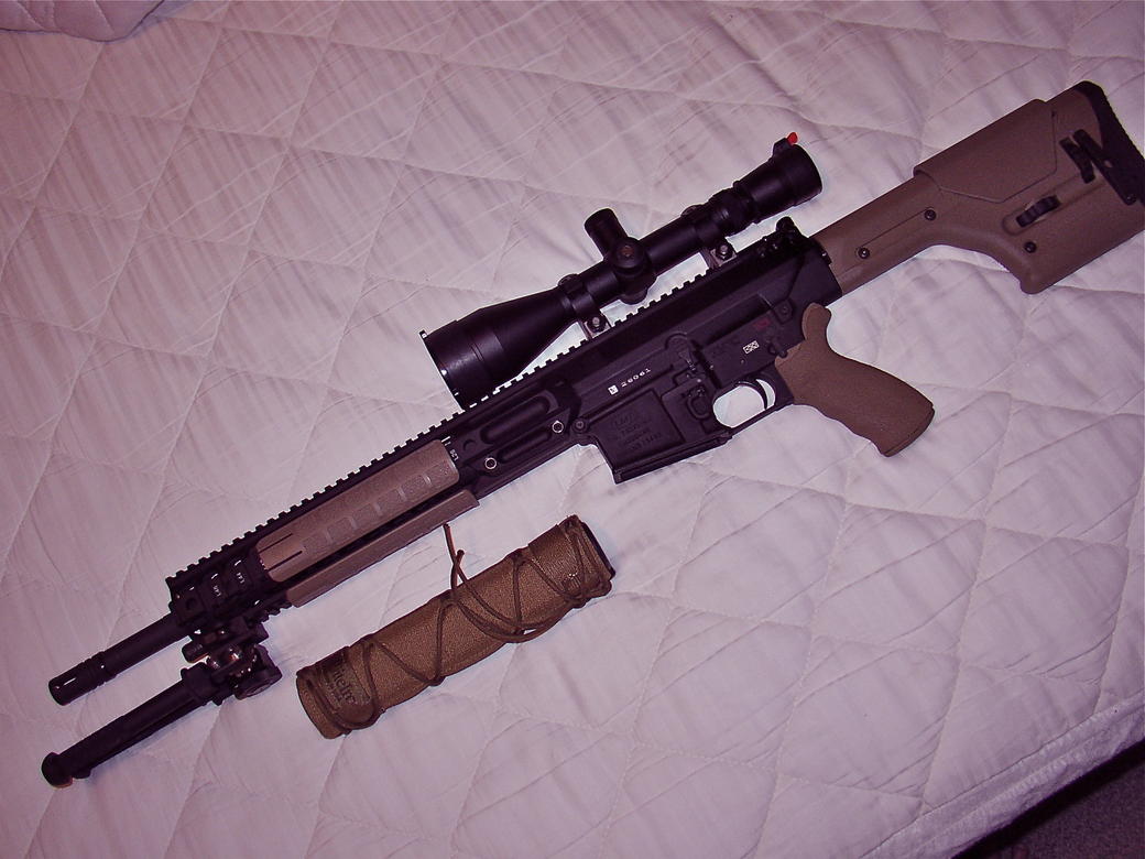

I would not recommend cutting an LMT barrel down. The 20" is an all round fine shooting length which yields higher muzzle velocity for longer range applications. The 16" is better suited for use with a suppressor with less overall rifle length and less POI shift from the unsuppressed configuration. If you want a 16" CL barrel, hunt around, they are available. Sell the 20" to another shooter that wants it for a spare or replacement. Or not, just my .02
