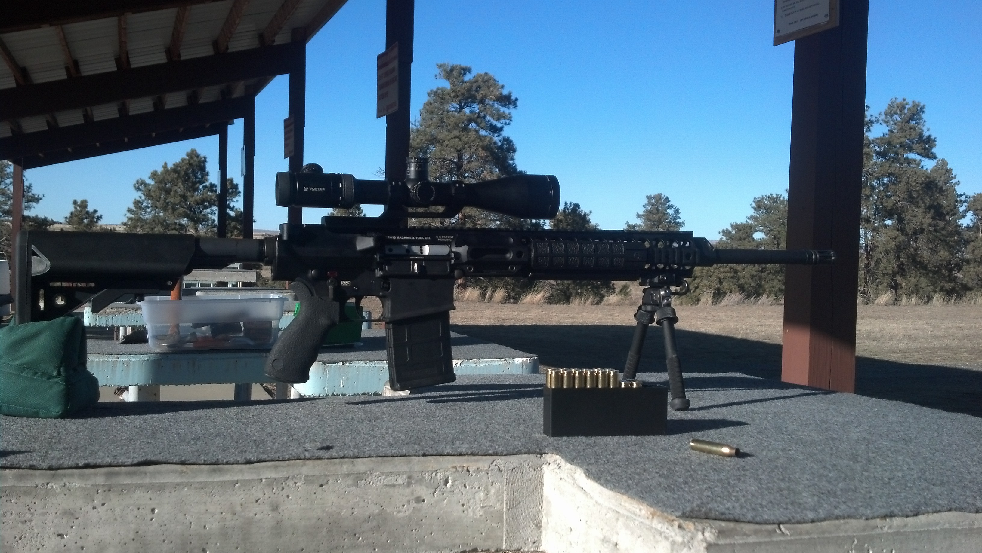

    I was shooting from a Atlas Bipod on the shortest setting. I use a rear bag from a bench on those days. I have a vortex pst 4-16xffp I can't remember the name if the mount but it was a spendy vortex mount it is not a QD. I don't have any pics on the ipad I will repost them from my phone in a few. I had the pst 4-16xffp scope on my Bartlein barreled 6.5grendel that I shoot Submoa all day with that. The SCAR17 has a sfp 4-16x vortex HS with the American defense QD mount. So both were 4-16x, the MWS had the better scope of the 2. I am just a civi who has a itch for reloading and trigger time. I shoot frequently. I am not saying I am the best I know I can learn more about technique but I don't believe it's me.
    Here is the MWS. I consider myself a capable rookie. I have been shooting semi auto rigs for about 3 years. I have somewhere around 3-4k rounds down range in the last few years all semi auto. Half of which were my own hand loads. I know many of the pros on the hide shoot that in a month but that is my rough round count.

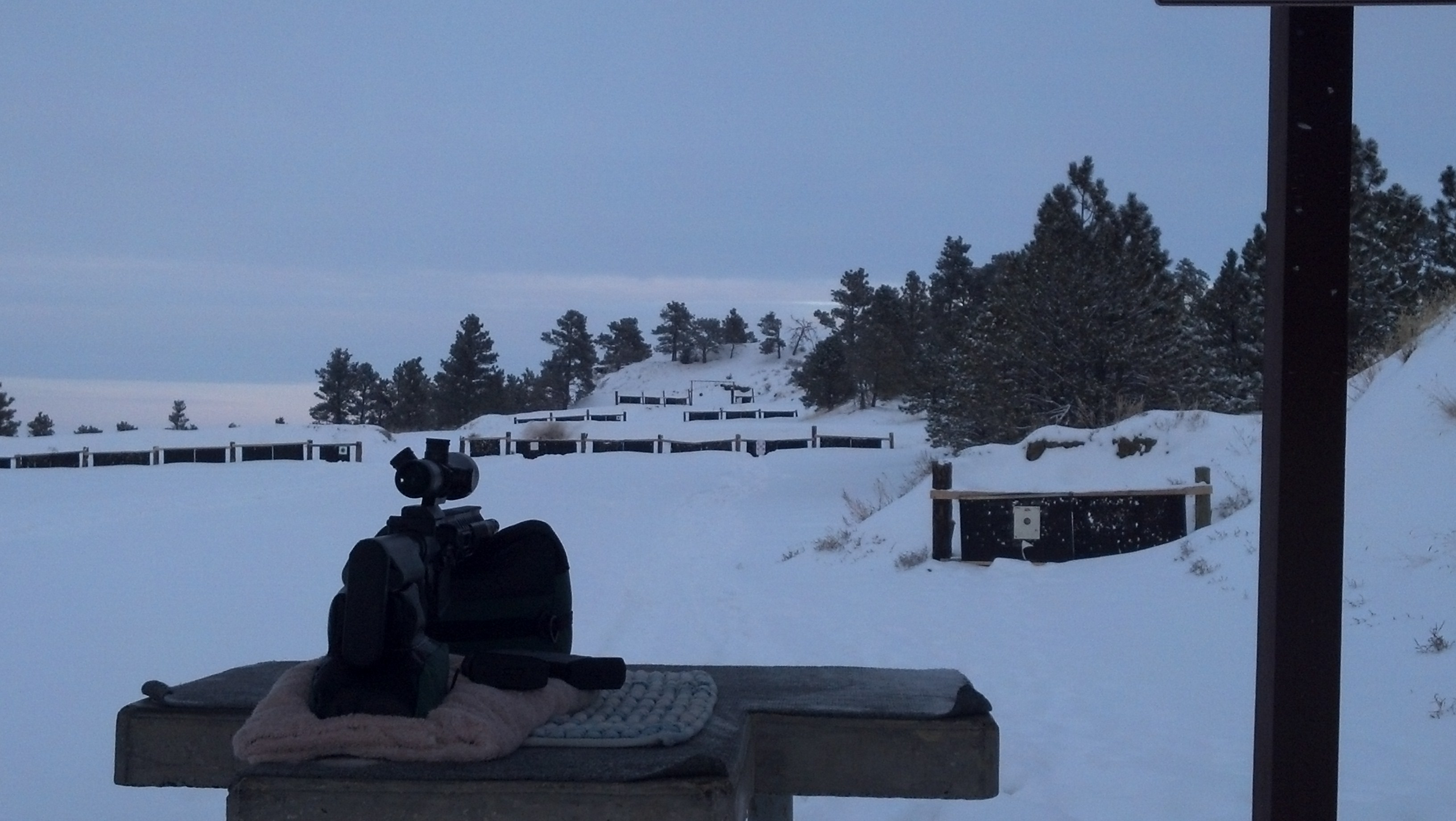

    I made it to the range for a 15 down the tube. It was around 0 Degrees F with about 10-12" of fresh snow. Finding my brass was a bit of a chore :rolleyes:! After removing and reinstall my barrel with a quality torque wrench I finally got some groups close to 1 moa. The POI shifted about 2 Moa to the left. If I get out of work early enough today I am going to go back to the range for a few more. Attaining some reasonable results is making me feel a little better about this purchase. Thanks for everyones input!
    Snowy Montana.
    Here are some pics of the day.

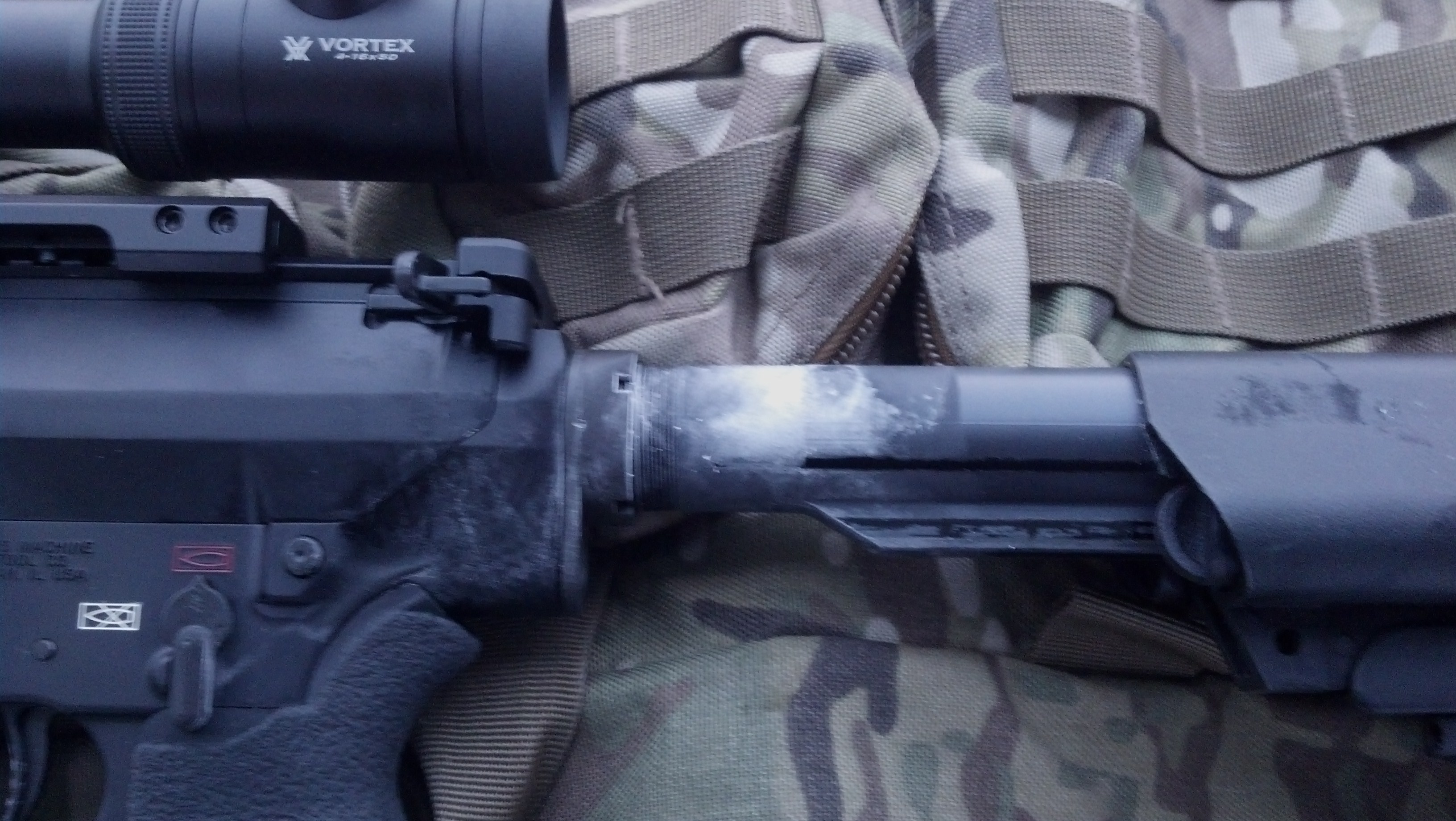

    My breath was freezing to the gun. Wind chill of -20Degrees F Was right around 0 F. Brrrr.

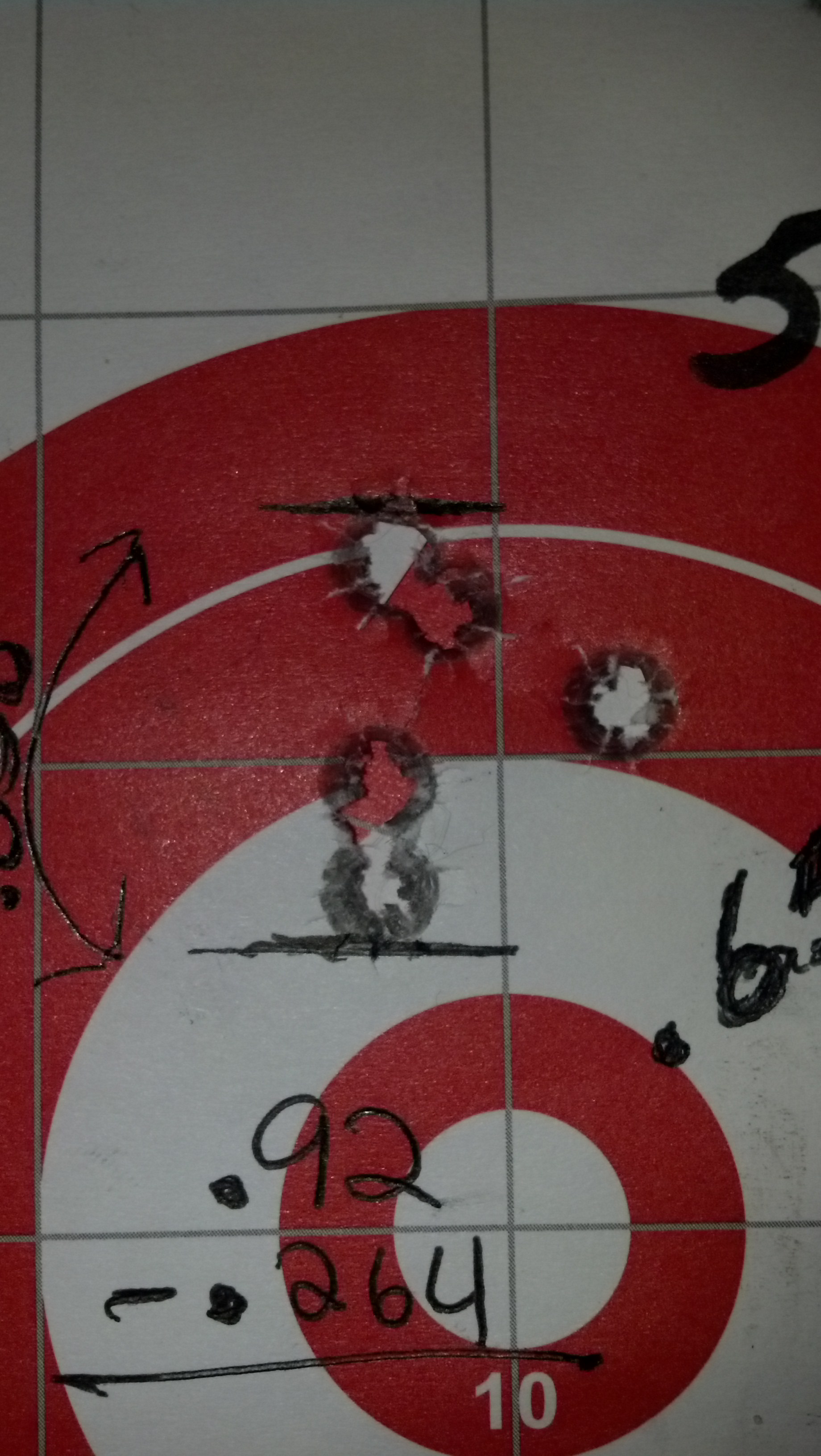

    Here is my best group of the day. This was a handload of H4350 41.8GR and a 120Amax loaded .020 off lands. In once shot Hornady Brass set back .003

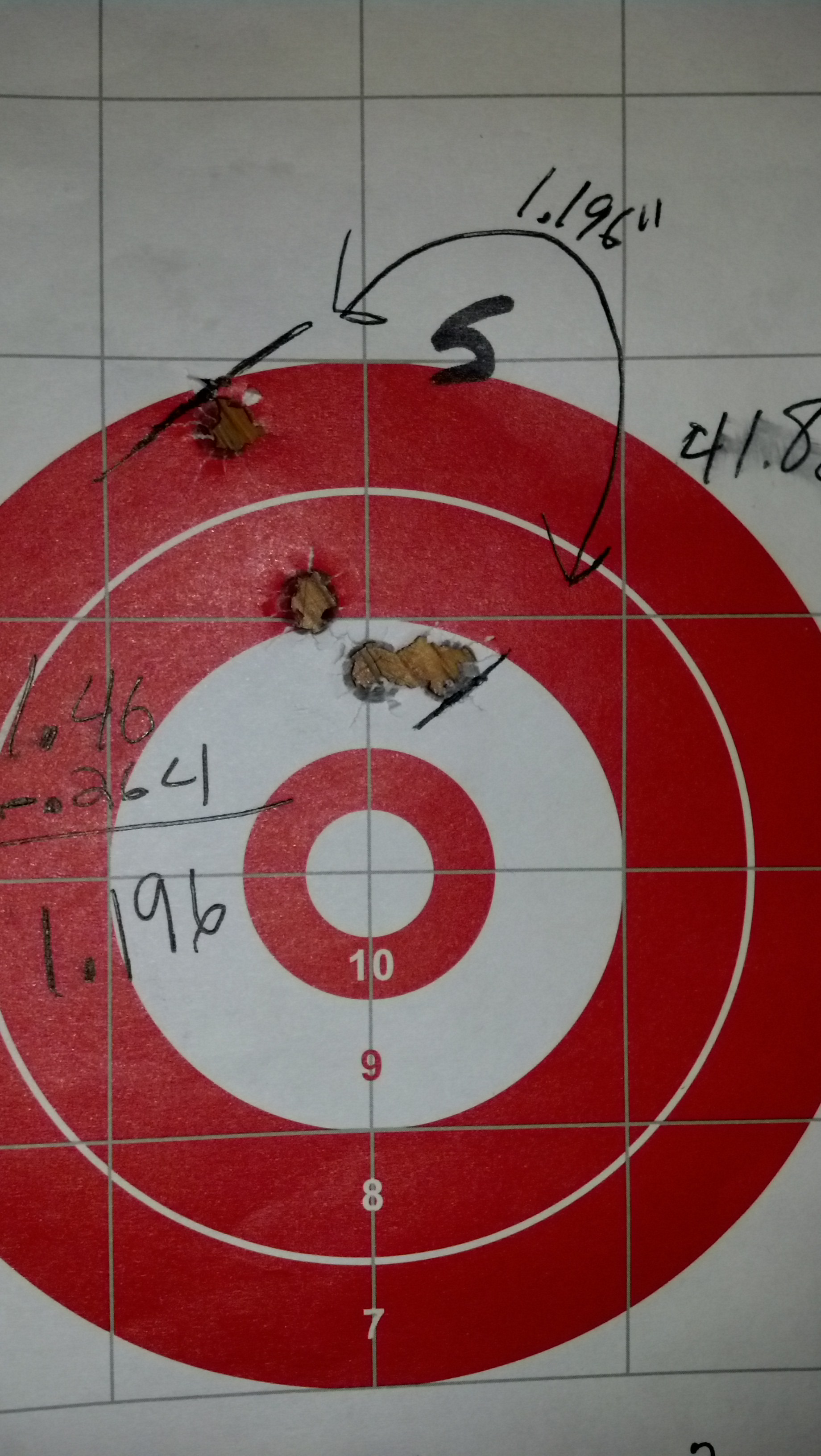

    I had 10 bullets for every powder drop. So I shot 2 groups for every drop. Here is the other 41.8 group.

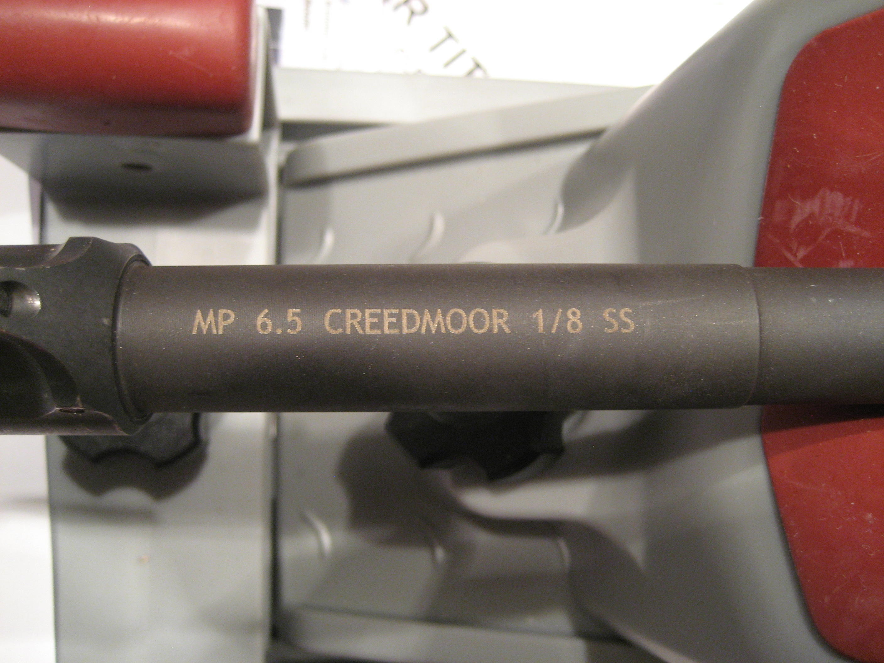

    I ordered a 6.5 CM barrel at the end of last month from LMT and confirmed it would be a 1:9 twist. I settled on running 120's and 123's.
    What showed up at my door was a 1:8 twist. I had purchased some factory Hornaday 120g A-Max loads thinking I would be running the 1:9 twist barrel. I decided to shoot this ammo anyway and I currently have 80 rounds down the tube with okay results.
    Is the 8 twist to fast for the 120 grain bullets? Could this affect accuracy?
    The 1:8 twist is fine for the lighter bullets too.

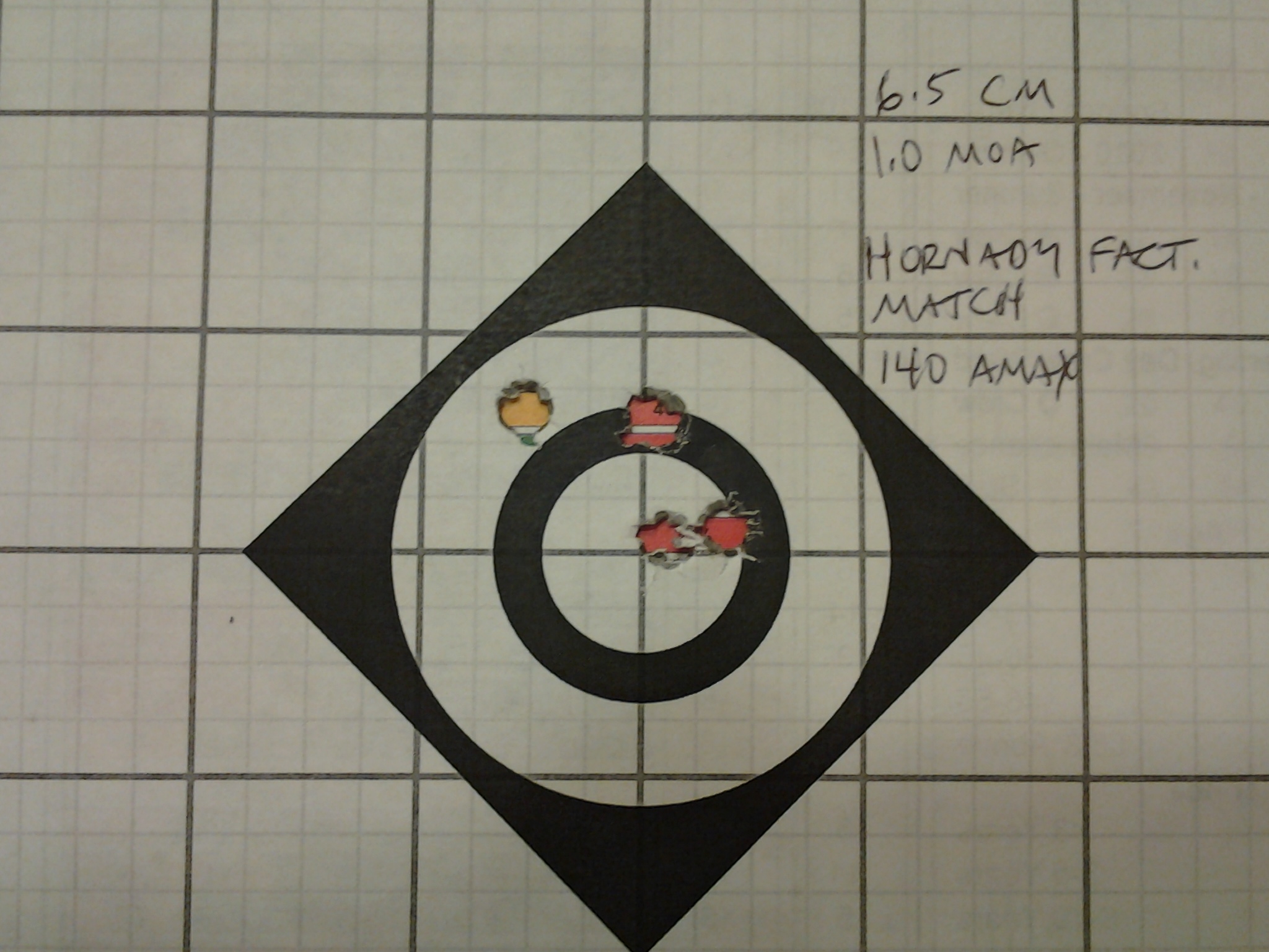

    It was $566 + 20 for shipping. He said they receive them, shoot two 5 shot groups with factory ammo, and as long as they go into an 1.5" they go into the good bucket. He said they dont really have the man power to do much more than that. He said with handloads guys are getting less than 1 moa. So its safe to say they guarantee 1.5". Im pretty confident I can get it to under an inch. Hopefully I get really lucky and get a really good one!

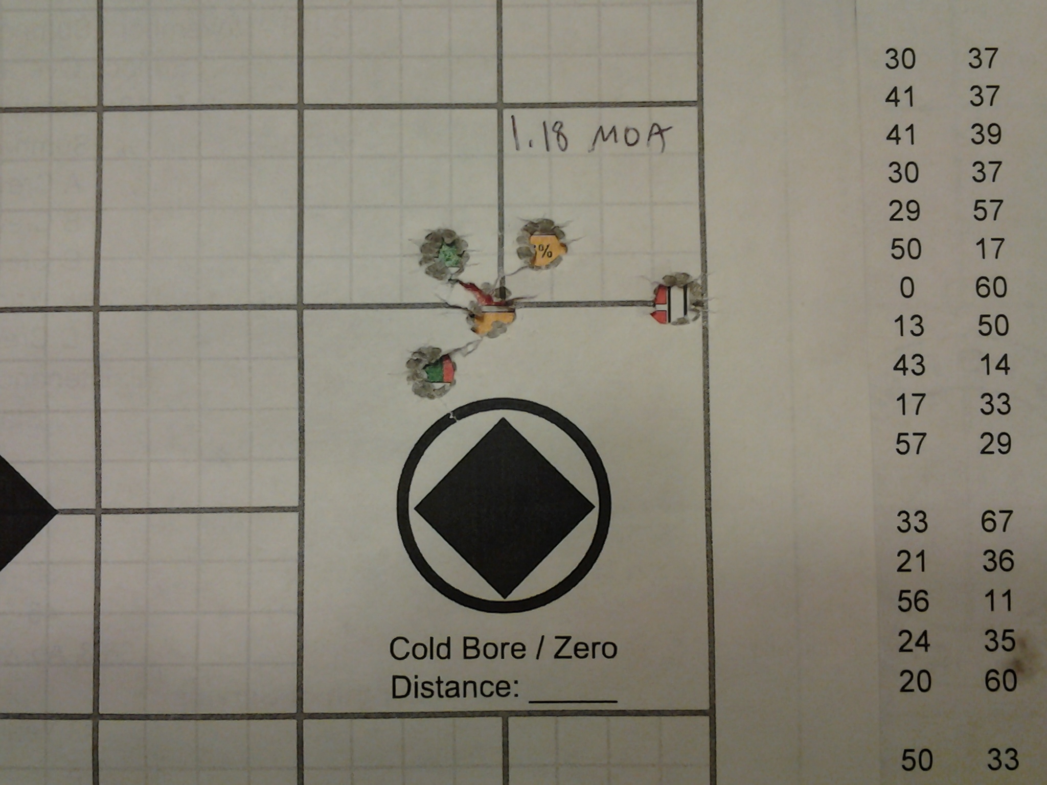

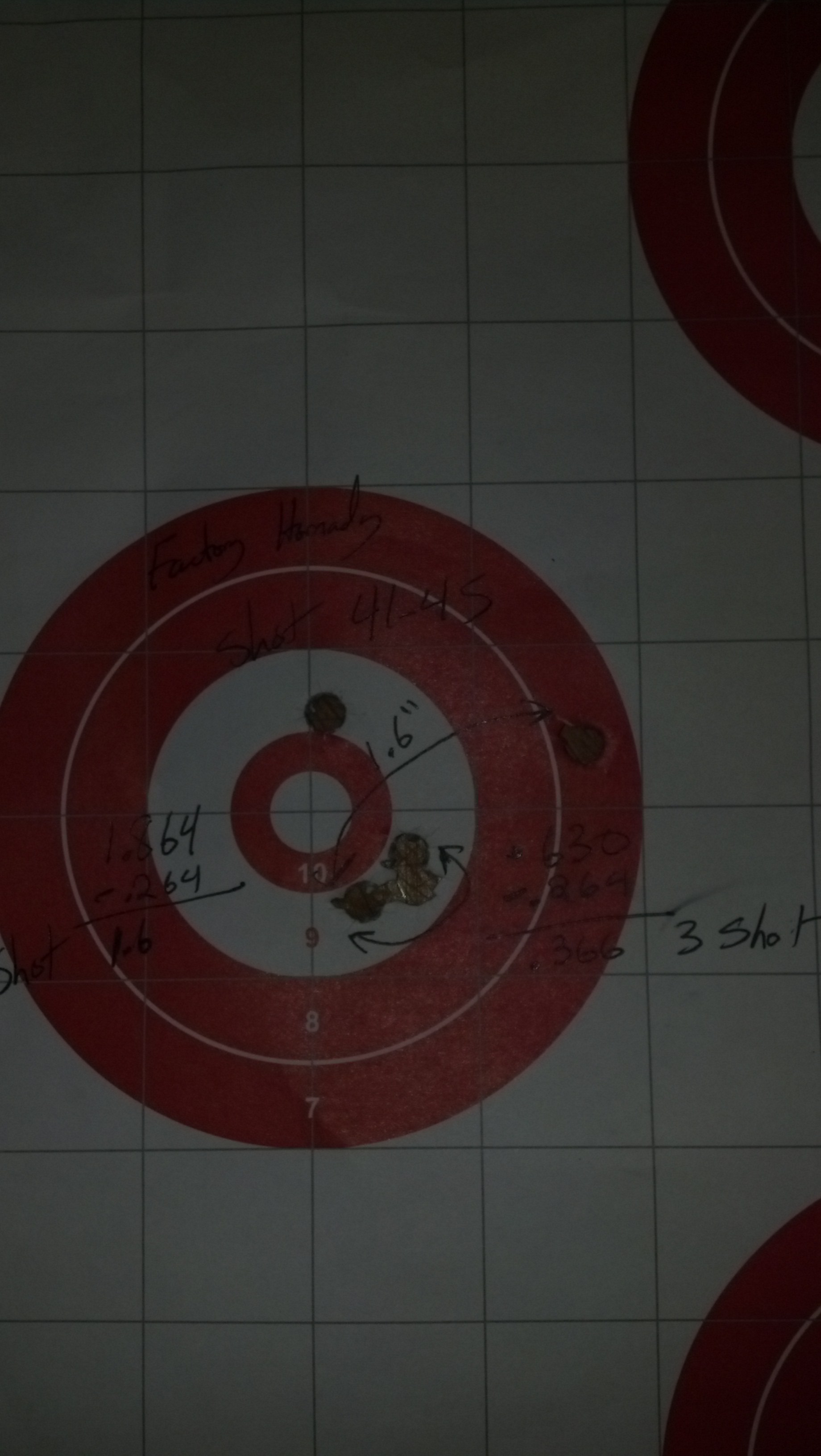

    Well after I did the barrel break in I only had time for 2 five shot groups. I had to shoot out of the bed of my truck which is only 6 ft. Not very comfortable with my position and only 25 rounds down the tube I know this combo has some real potential once I start hand loading. Hornady fact. match 140 amax. I will be out again later this week so more groups to come.
