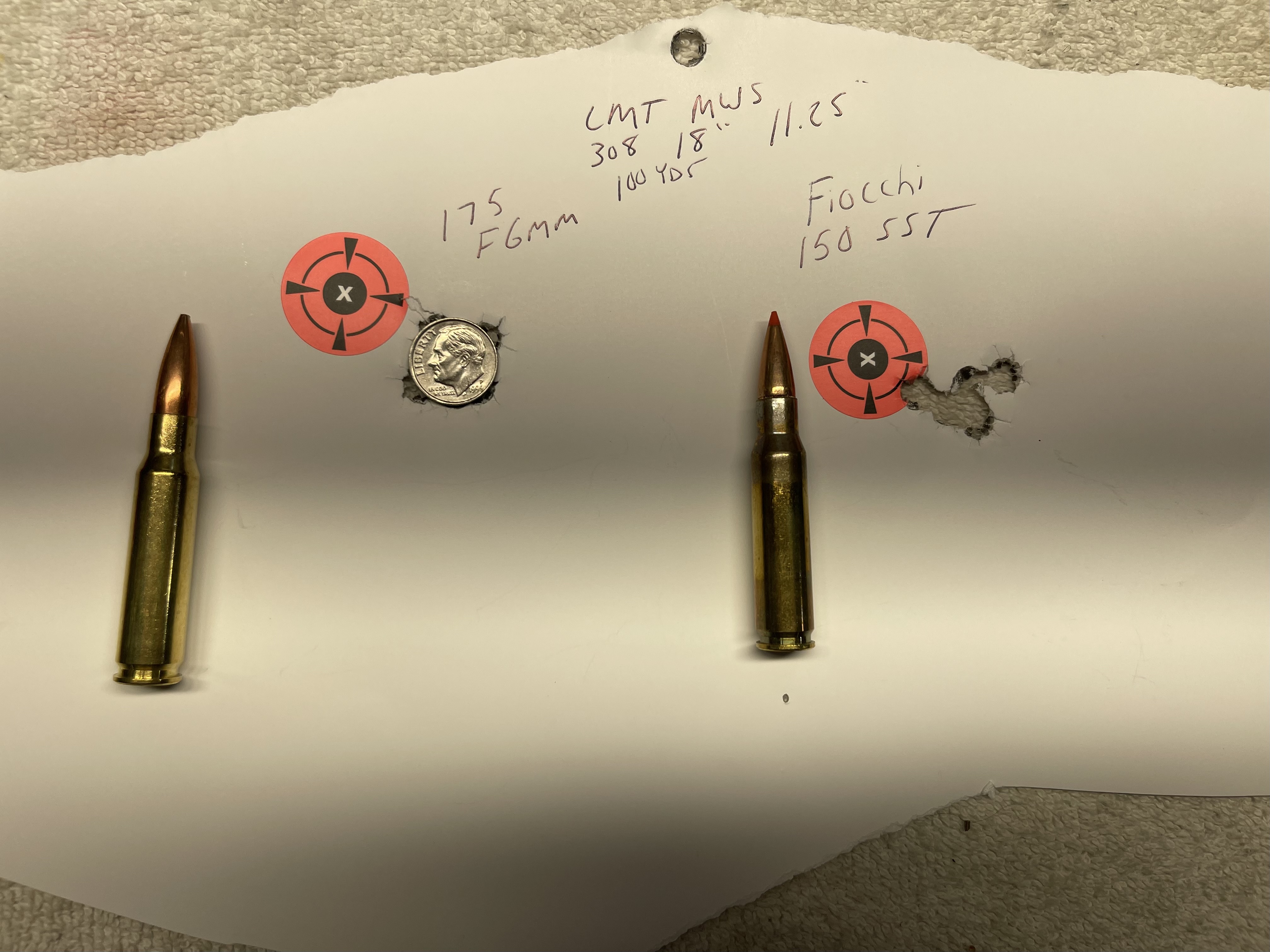

    Let’s talk accuracy from your LMT MWS setups. 6.5/260/308
    I’m putting together a MWS and have a 16” CL barrel I picked up from the px on the way. Will run hunting ammo in hopes of under 2 MOA accuracy but will be looking for another barrel 18-22” range in 308 for it
    Share your setups and accuracy
    CL and SS also looking into custom from D. Wilson
    I recently tested my 16” CL 7.62 barrel with Norma Target 175gr and Hornady Black 168gr.
    Shot 10 round groups at 100yds with both and it ranged from 1.6”-1.9” groups with both.
    I am wanting to try a SS barrel or have one modified by D.Wilson. Hope this helps.

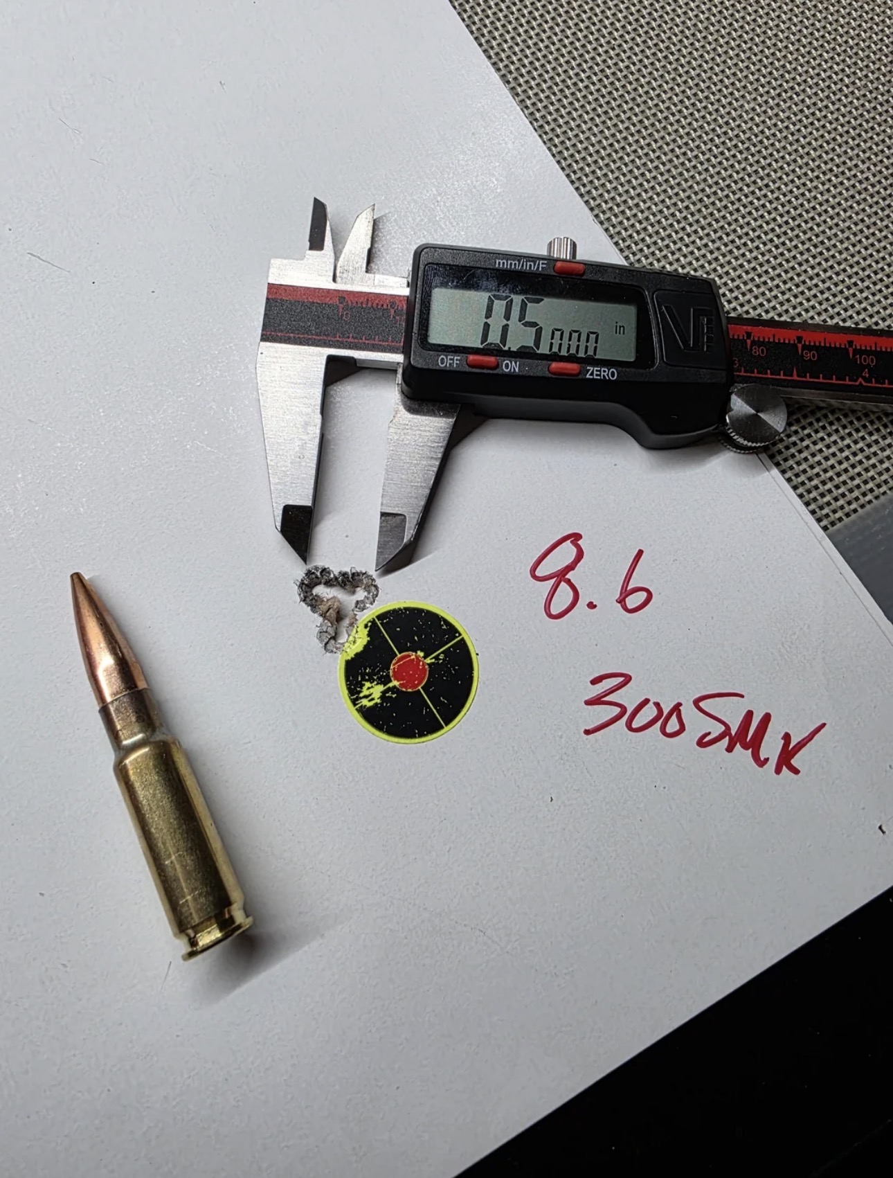

    My samples are all 2020+ models - MARS H & L - 7.62, 6.5, 6, 5.56.
    With factory ammo, pretty much anything worth it's salt has been sub 1", but more realistically closer to .5-.7". 5rd groups fired at 100y when zero'ing.
    I have not found any barrel, CL or Proof, to have any sort of accuracy issues.

    If your MWS can’t shoot GM308M2 at 1MOA at 100 through their factory CL & SS barrels, there’s a serious issue going one.
    As for hunting ammo, no idea as I’ve never used any of em. But my 16” CL and 20” SS 308 barrels (MARS-H MWS) both shot GM308M2 under 1MOA with a bag and bipod from table top prone. That’s as of earlier this year and late last year. I just sold the rifle a few weeks back because I rarely ever shot it…but when I did, it was outstanding.

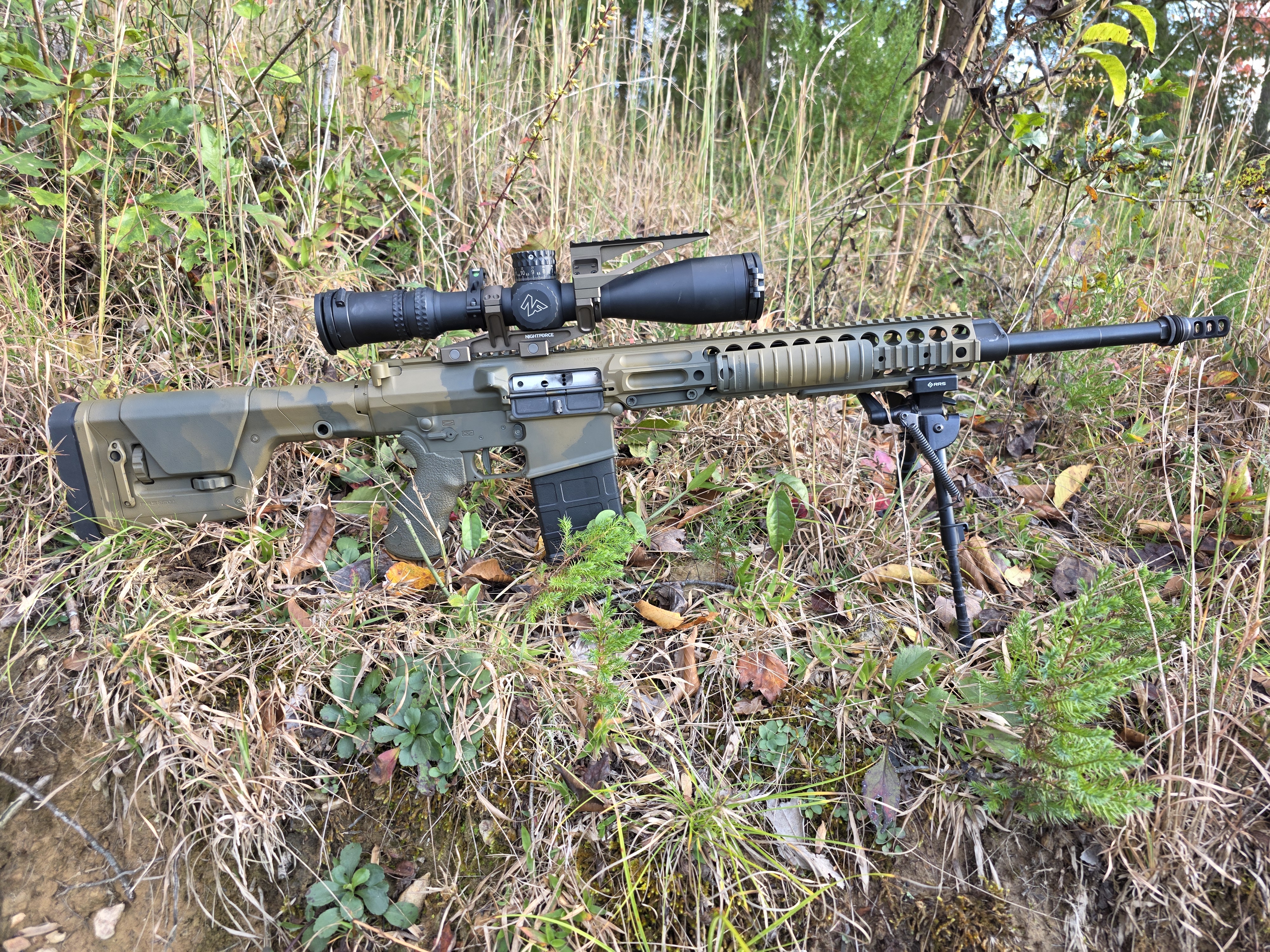

    We have one with 6.5 Creedmoor that shoots like a hand built custom
    Bolt gun. Little bitty groups. We have 2 16” 5.56 that are under one moa as well
    In short they shoot great

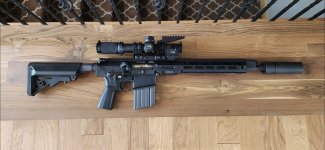

    I picked up a 13.5ss lm8 upper from @SkyScrapin and had some 168smk loads that i initially had loaded for my scar. Shot about 1.25in @100 which i was thrilled with because i suck at shooting large frame ars.
    I ordered a tubbs flat wire and a brt tube to help with running a suppressor. I started to have malfunctions around 200rds so I plan on keeping the bcg wet next time to see if that helps suppressed
    Reactions: SkyScrapin

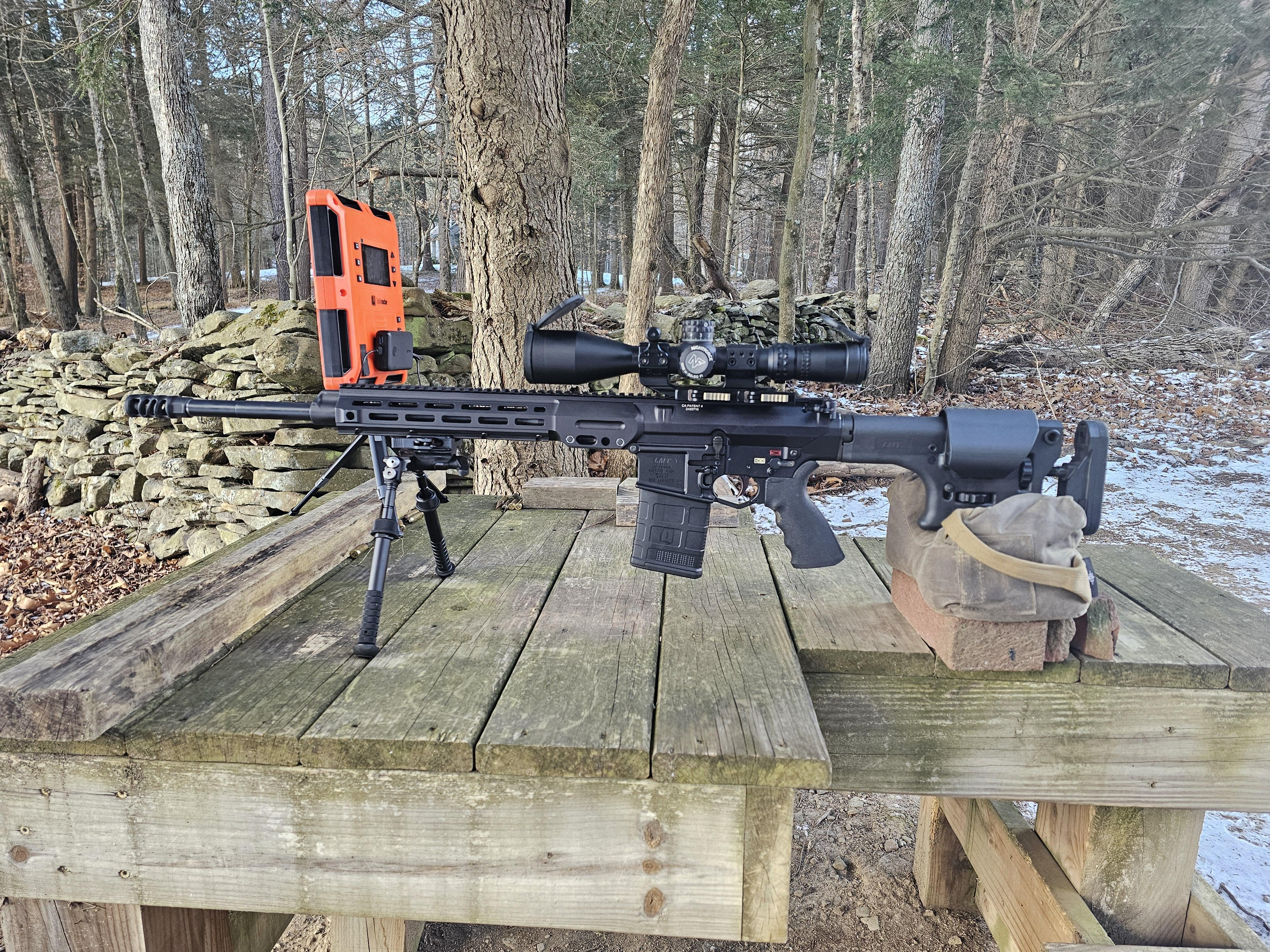

    16” chromelined 308. 20 shot group at 100 yards.
    Damn that is crazy!

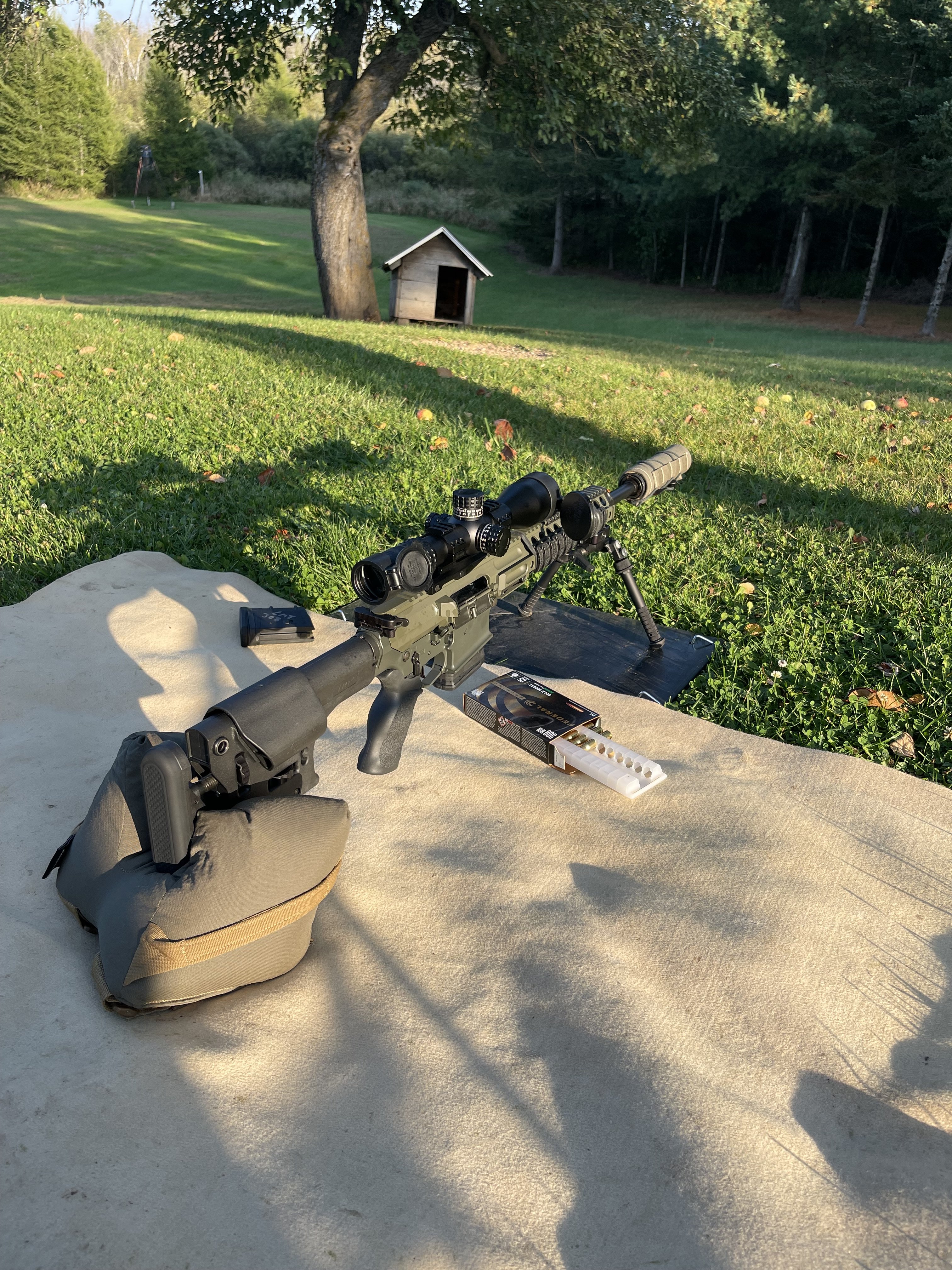

    I just put a XH buffer/rifle spring in mine. Been sitting in parts for a while as I got sidetracked working on another AI.
    Have my 16” CL to test but that’s just going to be some left over hunting ammo to burn up in crop damage.
    Have a 18” I just put a suppressed BRT tube on and can’t wait to try that with some 175 smk. Previous owner said it’s a 1 moa gun with that so we’ll see
    In the end if the results aren’t what I’m looking for I’ll be getting in contact with you. Everyone recommended you for best results. Even LMT said you’re the man for accuracy on this platform

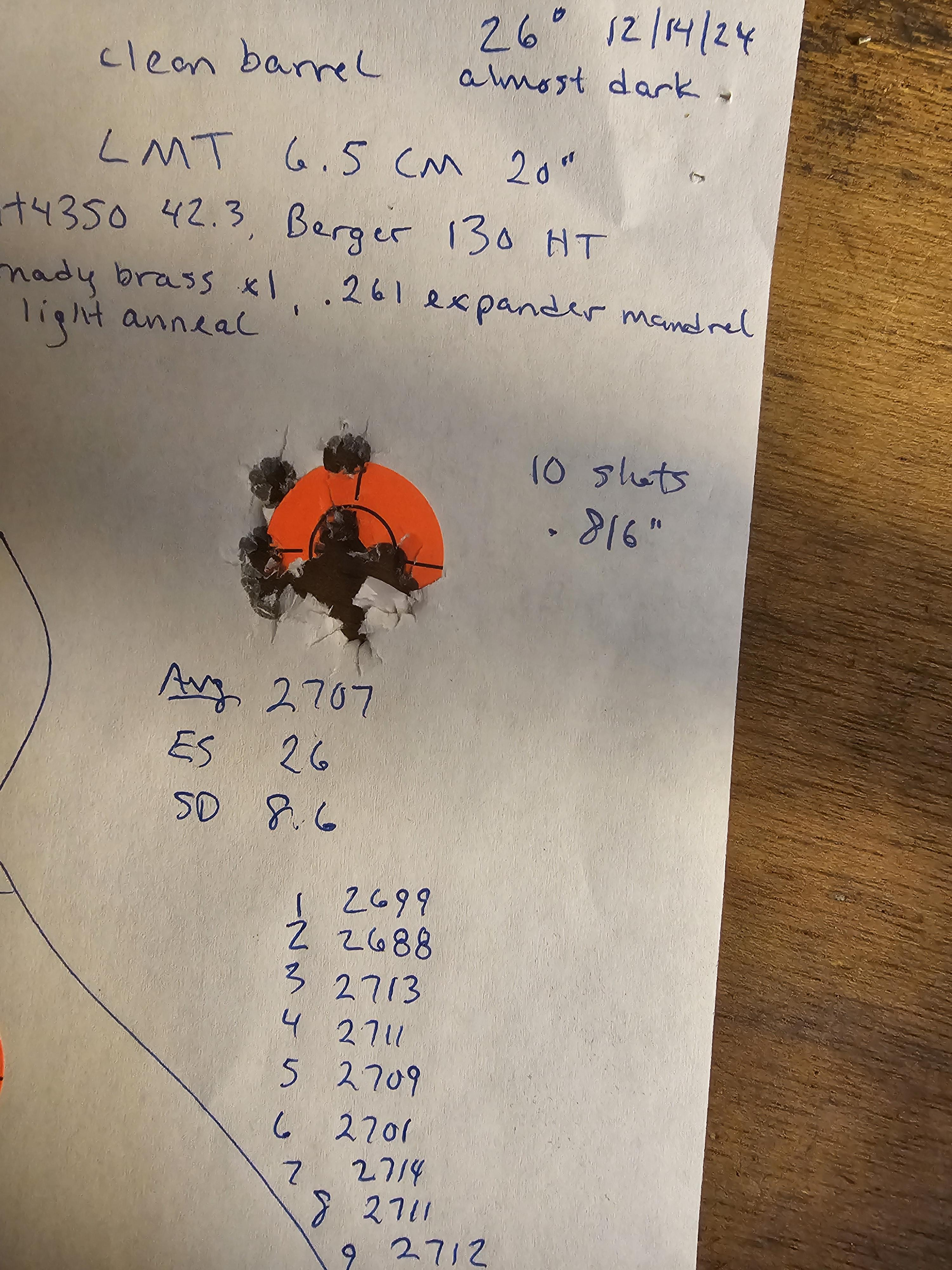

    I had a XH Carbine buffer and EA1095 spring in my MWS. The heavy buffer did help with the over gassed issues that are common with LMT MWS barrels. But it also adds a lot of reciprocating weight. You really notice it when the bolt closes.
    I switched to a 0.086 BRT gas tube on my 20" LMT .308 barrel and now use a 3 oz buffer with the LMT factory MWS spring. I use the same setup when shooting the 24" LMT 6.5 Creedmoor barrel. The recoil is very light and the rifle cycles perfectly. This combination also works with a HUXWRX Flow 762 suppressor.
