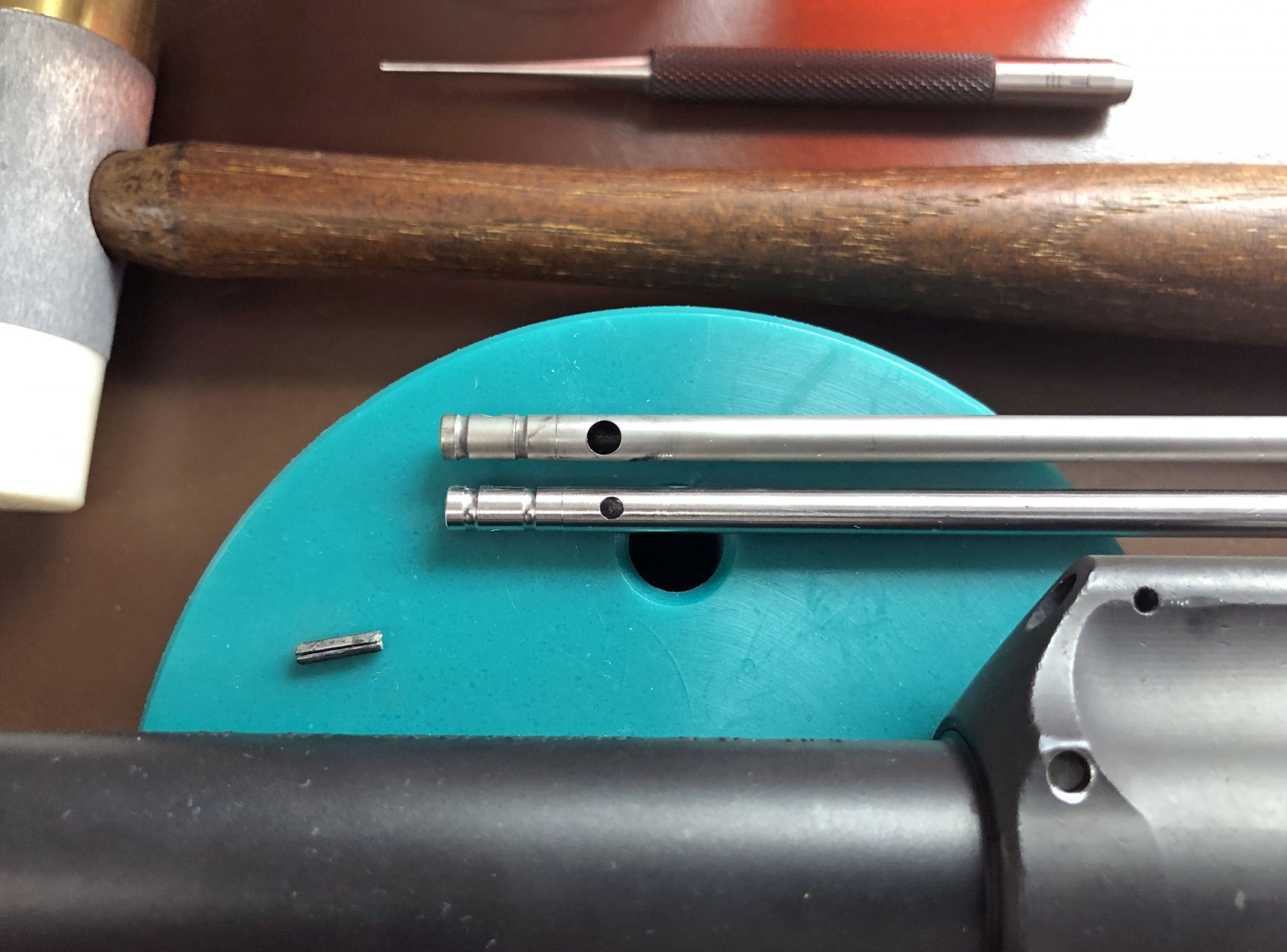

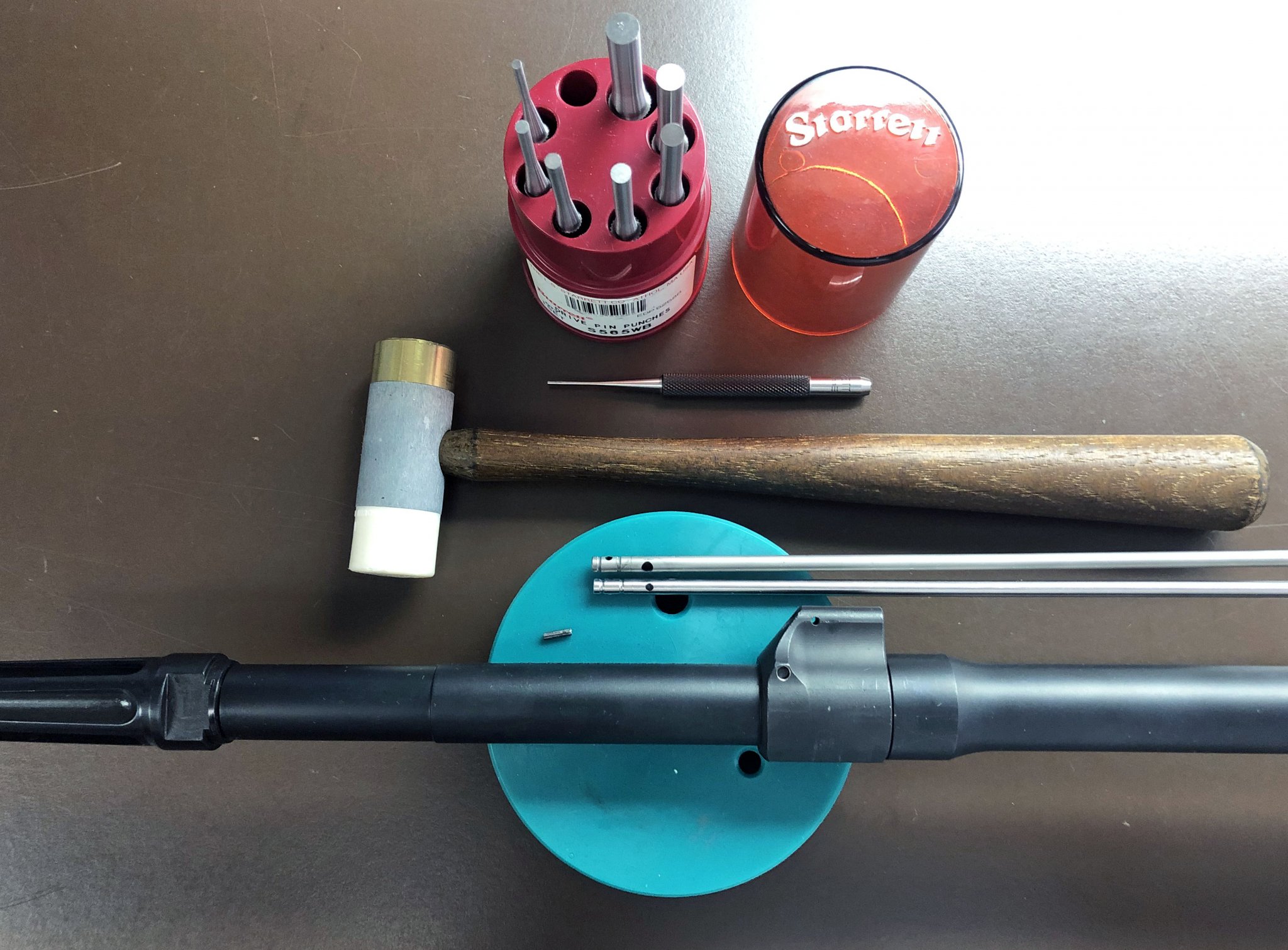

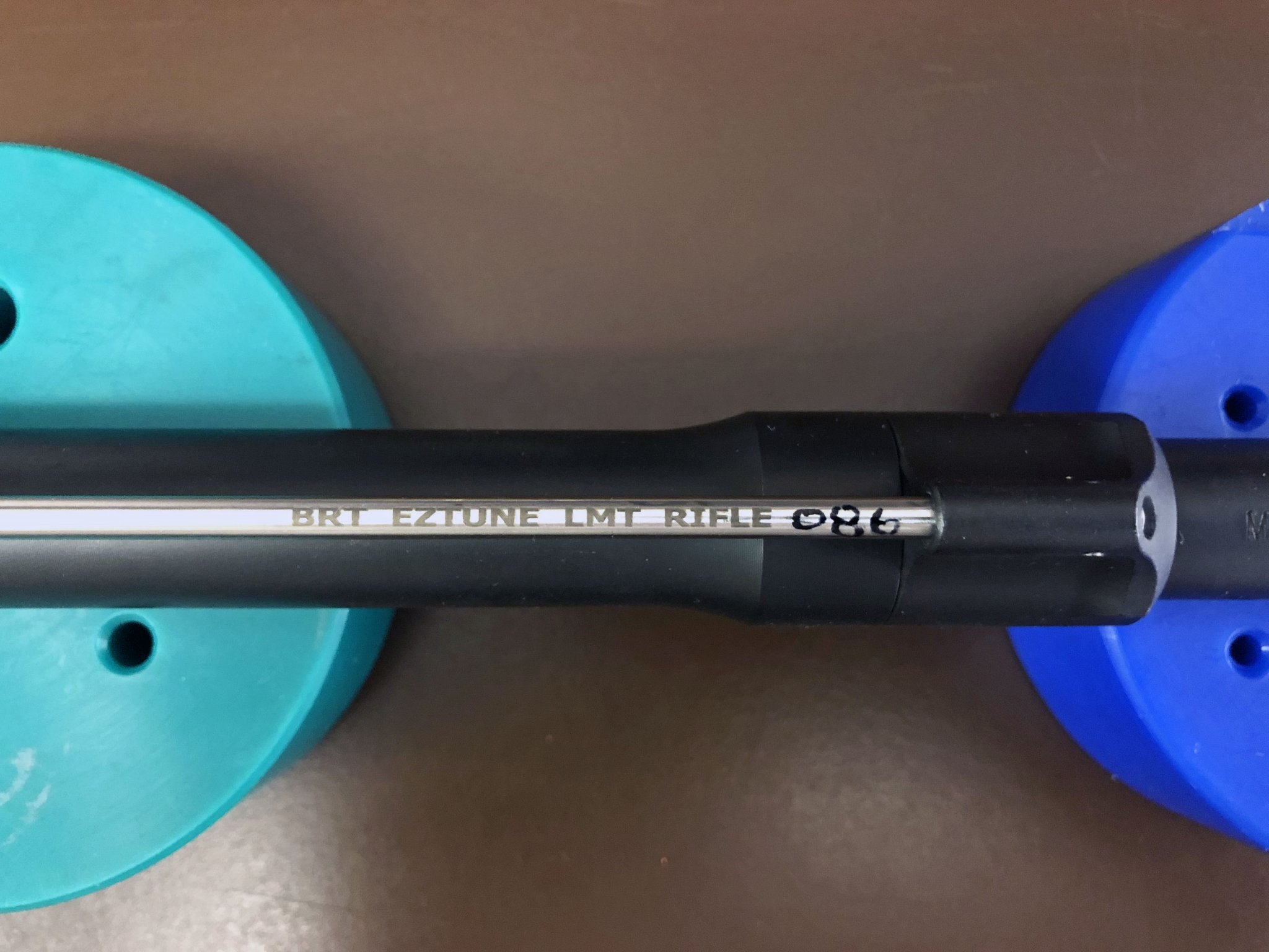

I received my BRT EZTUNE gas tube for my LMT MWS with a 20” 6.5mm CR barrel that was over gassed. The .086” orifice in the BRT gas tube is a major reduction from the 0.125” orifice in the LMT gas tube. It was an easy install. I will post how it shoots after I have time for a trip to the range.

While I love LMT, there gas port sizing is a little generous to say the least. Love their reliability, and there parts engineered to be more than durable enough to take the increase pressure.
Considering that gas ports erode, I wonder what the service life is for these gas tubes? Considering the price and ease of swapping them, I think they are a good solution to over gassing issues in AR's
I think these are WAY better solutions than adjustable gas blocks and carriers. Generally speaking, I am not so much worried about the gas system being as efficient as possible where it barely locking the bolt back, but more along the lines of taking 10 percent off that top so its no longer running at red line, but one does not have to worry about failures when shooting weaker ammo in cold weather.

I am eagerly awaiting one of these tubes for my MWS with a 16" bbl and rifle length tube (I chopped a 20" barrel down). I was shocked to see just how large the hole in the MWS gas tube was.

I finally had an opportunity to go to the rifle range yesterday and the EZTUNE gas tube performed flawlessly.
Previously with the overgassed stock LMT gas tube installed I measured the following with the RCBS Precision Mic on the fired ejected cases. Average +6.8 or 0.0068”.
With the EZTUNE gas tube installed I measured the following with the RCBS Precision Mic on the fired ejected cases. Average +4.5 or 0.0045”.
That’s a significant reduction in case expansion.
