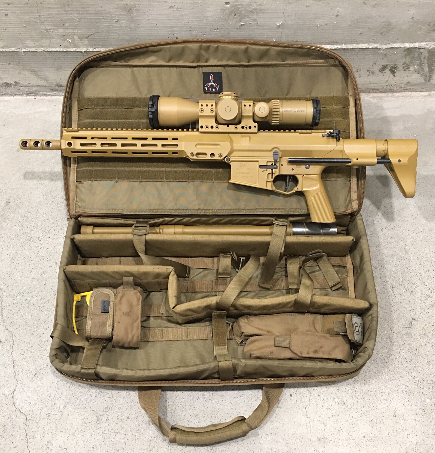

I am really happy with the SB 5/20 Ultra Short. I just added a 45 degree offset Aimpoint Micro T2 for inside 100 yds. (not shown, old pic).
Rasyad
Reactions: Snapper314
