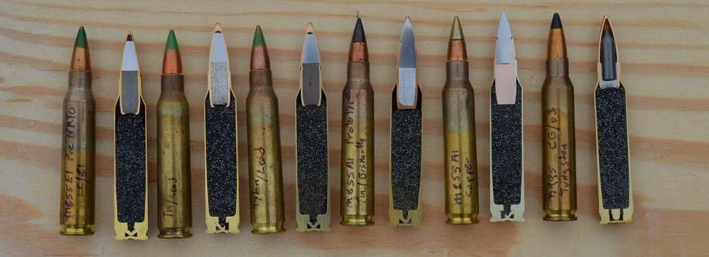

    Problem with 62gr M855 and SS109 is the steel penetrator under the jacket and concentricity. It’s hard to get mass-produced military ammo like that to be made precisely. Sectioned samples of M855, M855A1, and M995 AP:
