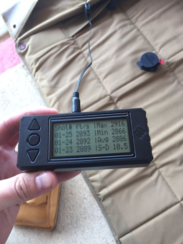

I know it's not exact apples to apples - but my converted Lapua brass is running avg 4860 with 140 hybrids over 42.8 gr of H4350. So I would think with the small primers you could certainly get there. Just watch for pressure signs as usual
  • Wow
Reactions: PBR DRIVER
Auburn, you might want to edit your post to correct velocity. Either that or check your batch of H4350. A muzzle velocity of 4860 fps is smoking!!! :eek:;):confused:

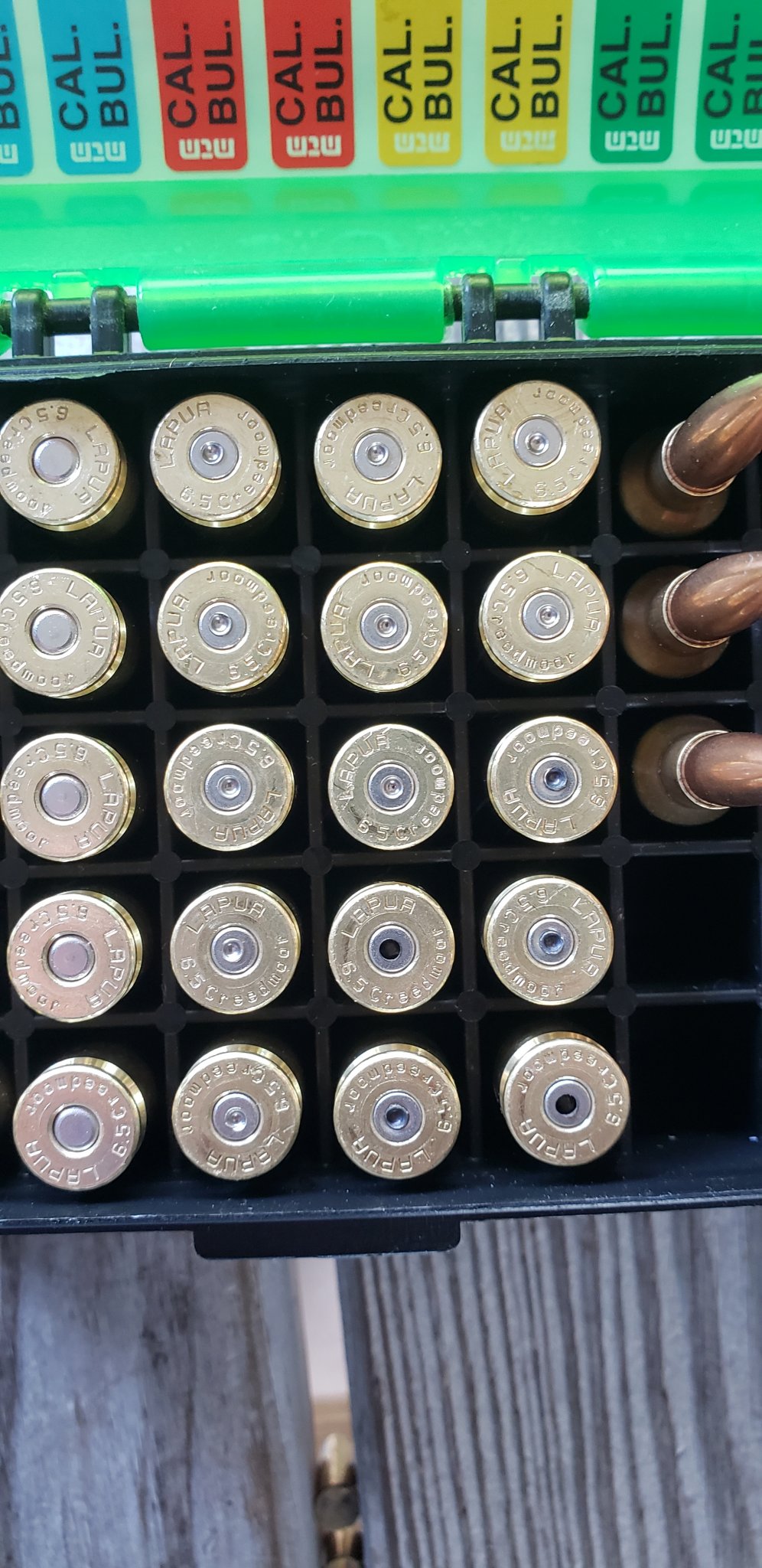

I'm having all kinds of pressure issues with lapua brass. I'm 3 grains under my load in hornady brass and im piercing primers. Has anyone else had this issue? Pic is 40 grains h4350 using the lapua brass with cci 400 primers
If youre shooting small primer brass in an large pin unbushed bolt you will get that.
You can just keep lowering your charge, not what I would do.
You can switch to a large primer brass, maybe but not what I would do.
Send it into someone like gretan and have him bush the bolt to make it a small firing pin.
