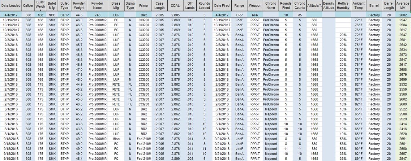

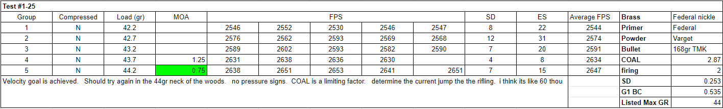

My initial shooting was with a batch of 100x Hornady 178GR BTHP match factory ammo. It was around 1.5 MOA (5 shot groups unless noted otherwise).
I loaded some 168 GR A-max's after that which were accurate at 0.6MOA at 2628 FPS on 43.7GR of Varget. However the commonality between most of the 308 factory ammo and bullets I found was they were not supersonic out to 1k. So I began load development based on the 168gr TMK. I have shot the 77gr TMK before in my 223 bolt gun and was pleasantly surprised. Further to this the BC's were very high.
Rifle: Bergara B14 HMR in 308 20"
Optic: 24x DBT

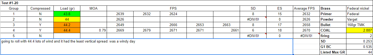

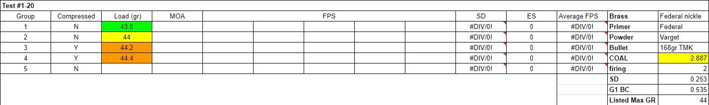

I was not feeling particularly stable. Below were my initial results.
0.75 MOA is good enough for me. My goal is to hit a 10inch gong at 1k yards. So that gets me in the ballpark. My velocity goal was 2600 and was hoping for near single digit SD's. So both of those goals were met. SD of 7 is great by my standards.

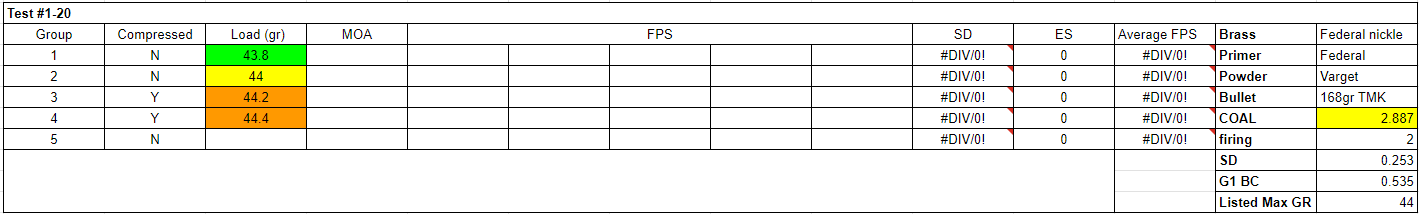

I have started doing larger increments with my initial load development than in the past and it has become a preference. I also do not believe there is much reason to go below 0.2GR increments with the sample size of 5 shot groups. I would expect a 10 shot group minimum to yield repeatable results.
With a ballpark figure of 44.2 GR and COAL of 2.870 feel I have a great starting point. I am beyond fortunate having access to a farm to shoot on 50% of the year when the corn isn't too high, I probably shoot 20 weekends per year, or more. hopefully within a couple weeks I can get out and do this load dev. Below is my next loading table.
I usually am unable to hit the rifling using the standard magazine since I primarily reload 223 and 308 for AR length mags. However in the case of this bullet at 2.887 I am still a long way from the rifling. I like fabricating unnecessary problems for myself, and worrying about things that don't actually matter. so the change in COAL is probably not needed. They will fit in a steel MDT magazine, but not a standard plastic magazine. but that was the primary change this time around. seating the bullets out 0.015 longer.
Within my next update I intend to include; testing results of the second table, a measured distance of jump, And hopefully a final selection on what to load for my 1000 yards goal. Also note I am using nickel plated brass because it makes me feel fancy.

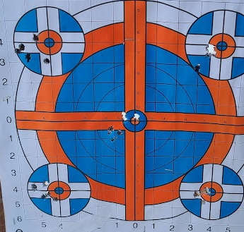

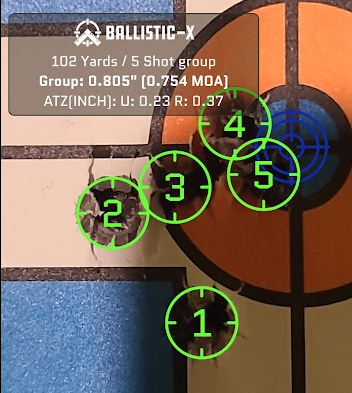

Well. I have some more results. The weather was a little on the cold side, around 0 Celsius. The primary focus this trip was hitting steel, but I managed to squeeze this bit of load dev in. My Labradar wasn't having a great day though, so we lost some data.
Both groups were around 0.8 MOA. The SD's were still single digit. Overall I am satisfied. I still wish I could squeeze a little more overall accuracy out of this load. Being 0.100"+ off the rifling probably doesn't help. Given that there was a sporadic 5-10MPH crosswind I am electing to go with #4 as it shows very little vertical spread. I have since loaded up my 35 remaining pieces of brass to 44.4 GR of Varget and next opportunity I get to shoot long range I will try my luck. The 1 MOA at 1k yards challenge that youtuber Texas plinking does is fascinating to me. That is what we have been doing. Picking up the additional velocity from 44.2 to 44.4 grain is an added benefit.

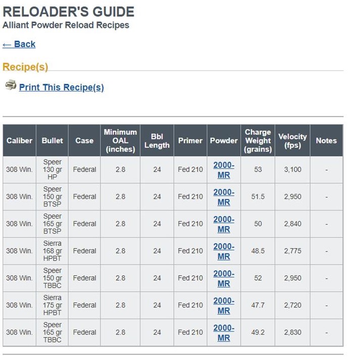

I played around years ago with the 178 AMAX and 2000-MR but didn't finish the work up but I think that powder could get over 2700 fps. The only drawback is the amount of muzzle flash and it only get about 90% burn. I will say it did show promise if you were looking for velocity.

Likewise, it's been a few years now since I played around with 2000-MR. Below is Aliant's powder reload recipes for .308 and the data I recorded for 168 SMK's and 175 SMK's:

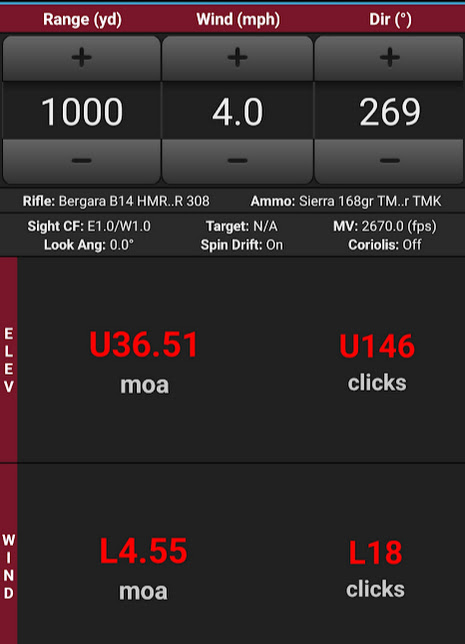

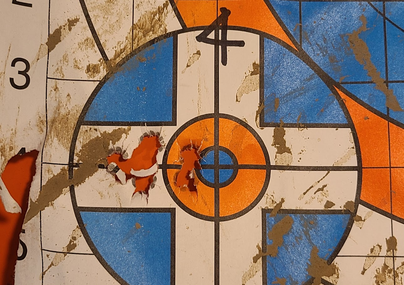

Well I did it...
I managed 2/10 at 1k yards on the 10 inch plate.
Velocity was ~2660 on the 10 shot string. SD of 6.0
There was a fair bit of mirage from the snow and sun combination. I didn't really have any trouble spotting impacts and misses. But my main takeaway was this is much more challenging then I expected. I found that shots in quick succession to adjust for windage worked well. I also wonder how much the mirage affected me. it was pretty extreme, and not something I have a lot of experience shooting with at such a distance.
Shots 1-5 were finding windage. 6 was a 2 MOA elevation adjustment, which wasn't enough. 7 and 8 were the hits. 9 and 10 were same hold but missed.
I ended up around 39 MOA. i should have properly ranged the target as it was actually at ~1010, which with this caliber mattered more then the previous calibers I've attempted this with(300 WM, 6 creed).

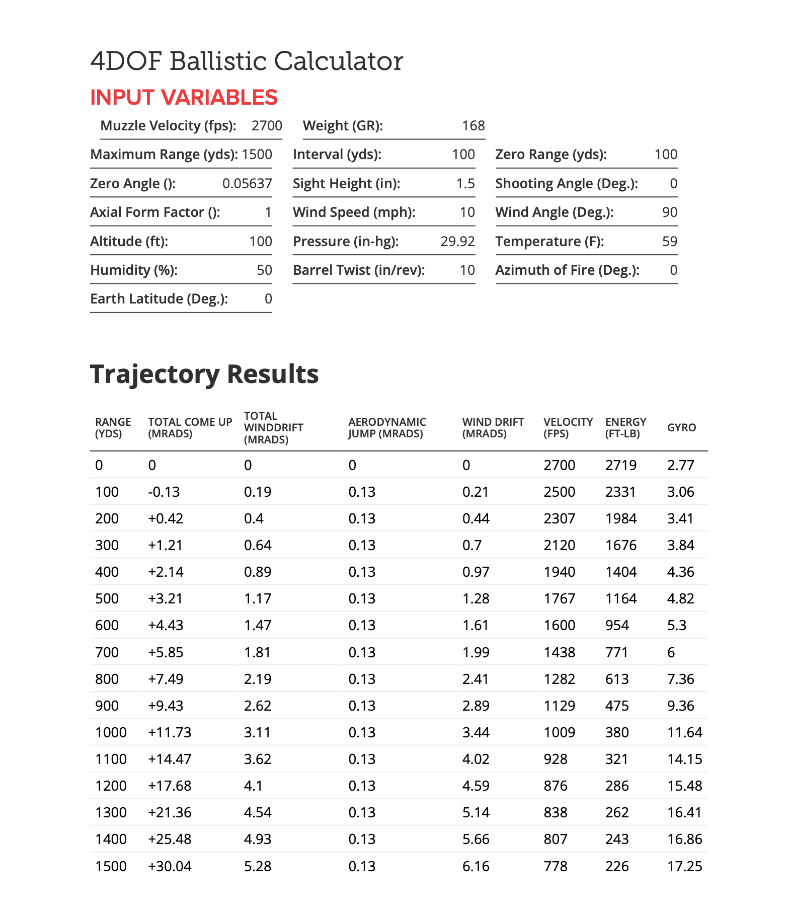

I don't know if its just me or not. but I have trouble with the 4dof app sometimes. I am familiar enough with AB that I can usually figure out what I'm screwing up. therefore I use it.
With 4DOF I will get the odd value that just straight up doesn't make sense. I feel like it could be a bug with the app or something? IDK.
