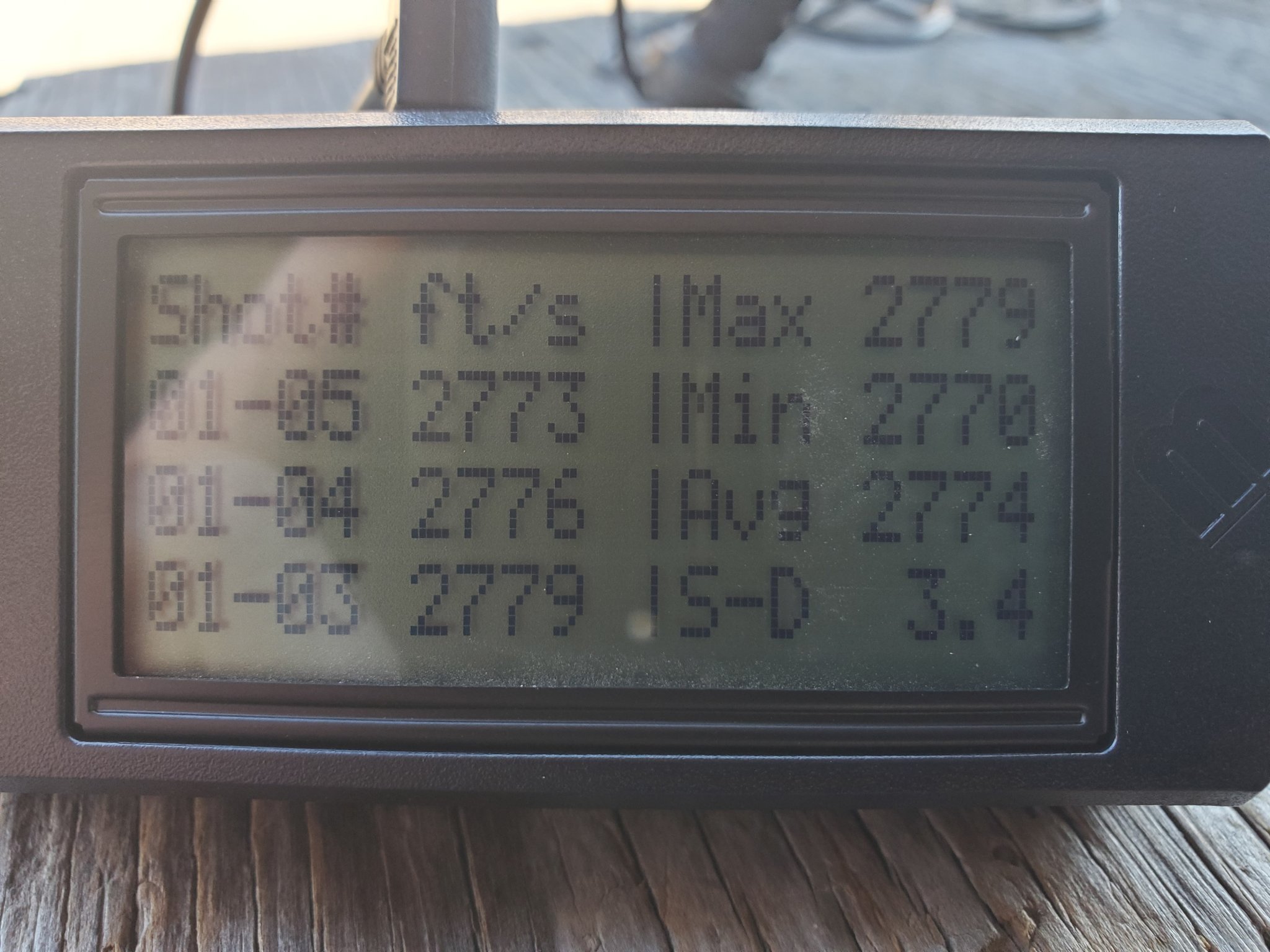

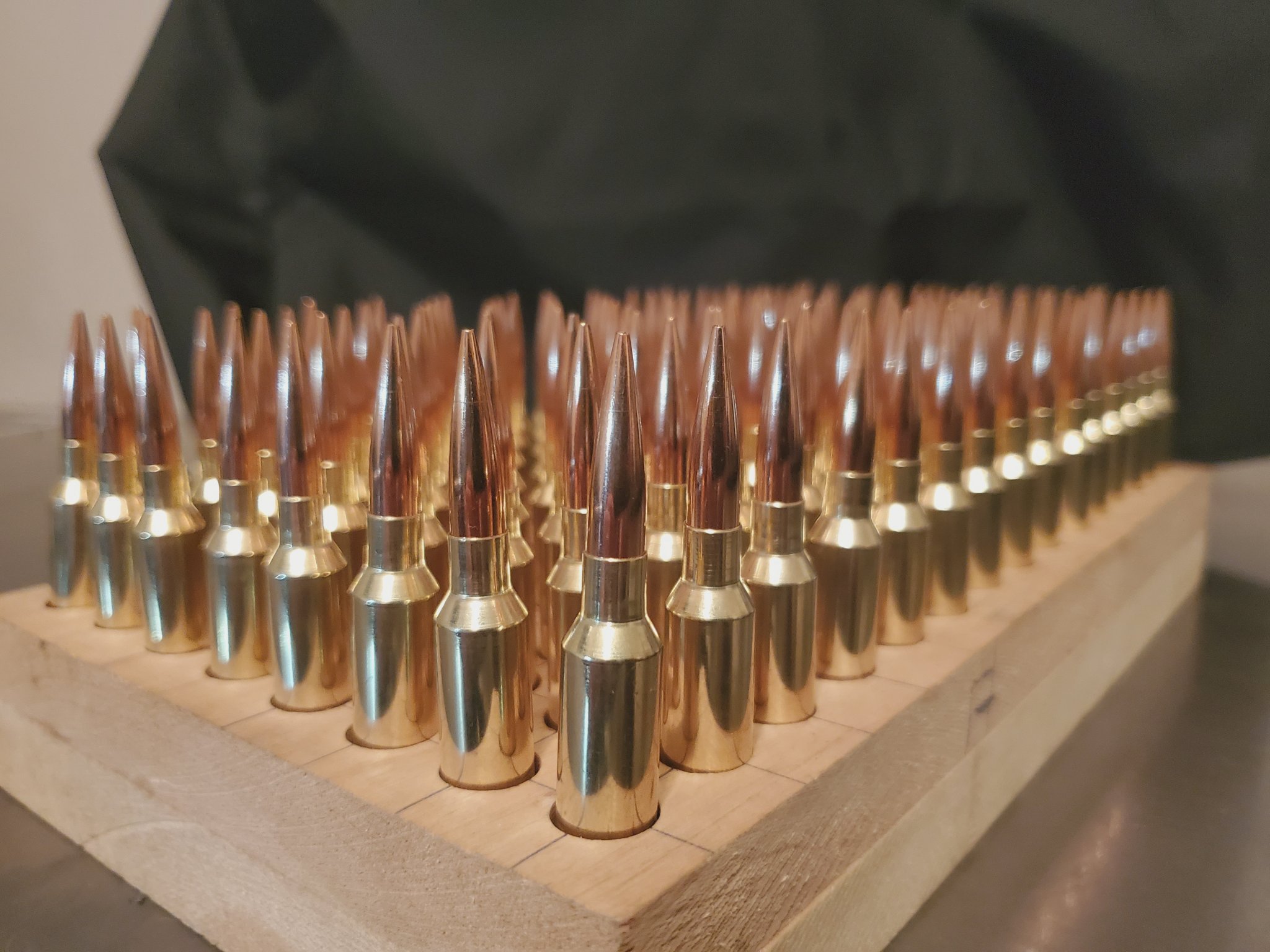

+2 on 41.5 H4350. With 140 AMax, 136/139 Scenars, 140 Nosler CC and 140 Hornady BTHP. A ‘universal’ load?...probably about as close as you might get. Work seating depth to really nail it.
Lapua Brass
Berger 140 grain Hybrids
H4350
FGM SR primers
