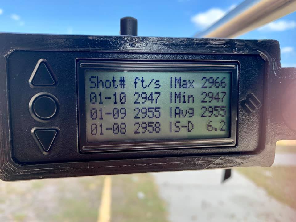

You don’t need to be giving out reloading advice until you show us some chronos.
I could easily just fake chrono numbers. If I were you, I'd ask for better proof than that. If you're going to try to call someone out, at least make it hard.
Anyone paying attention enough to know who I am knows my ammo has been performing well for customers, demos, and my own performance well before you were a member here.

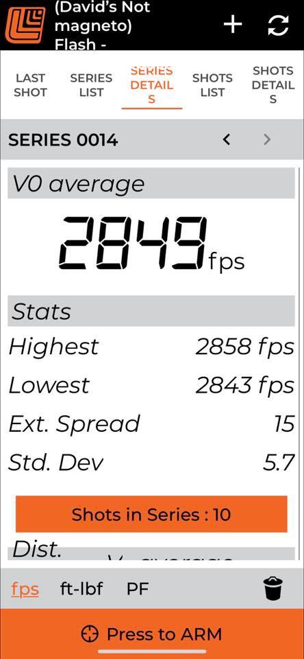

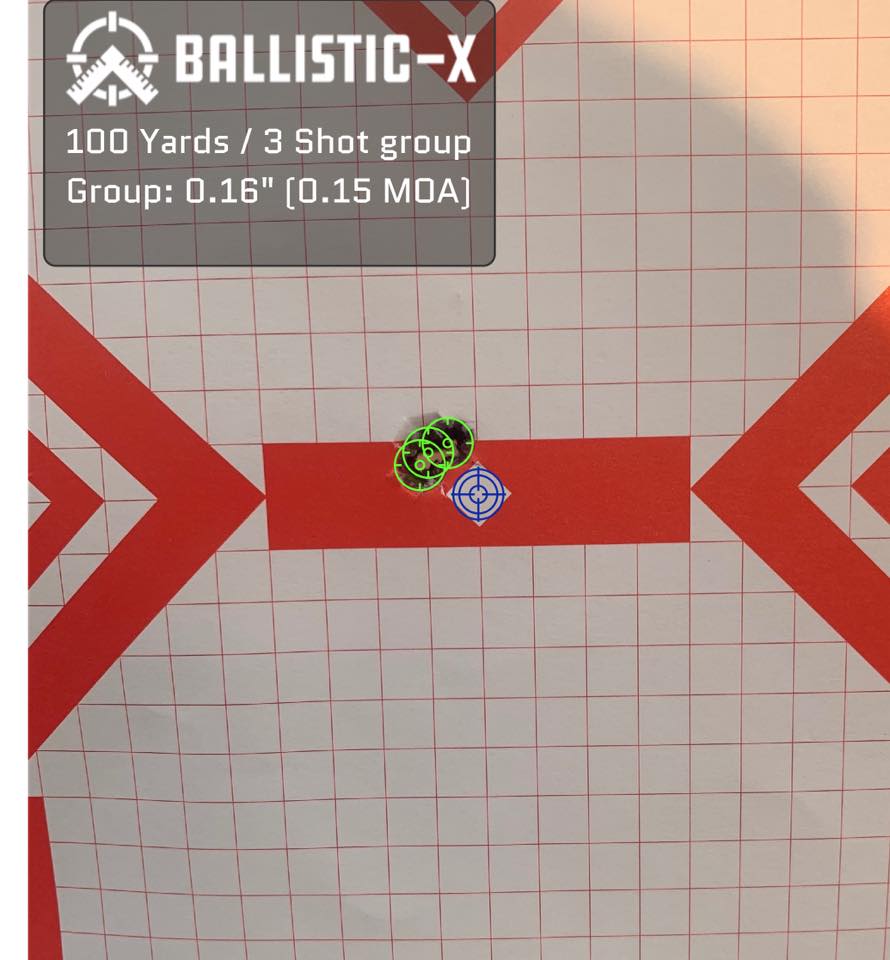

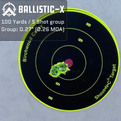

But, since you asked and you seem to like getting in over your head. Here's a few that won't waste too much of my time posting.
As I said though, this literally proves nothing. I could just be faking or cherry picking all these.

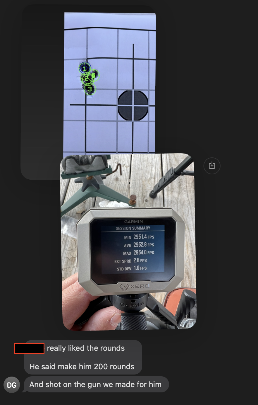

Here's a screenshot from a text from a local shop who had us make some ammo for a customer. Only 5 shots. So, fairly meaningless. But, you wanted "proof." This was a 7prc. Pic was from customer.
Tell the customer he needs some work... With numbers like that those holes ought to be stacked like dinner plates. Unless that's 500 yards of course. 😂
These are all over magnetospeed and the Garmin has been out for months. Something smells fishy here
