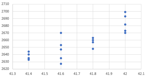

Here's the chart:
Honestly I think you should see if you can keep bumping up charge weight unless you're seeing pressure signs, but you need to run the OCW test without the MS on the gun, then come back and check MV of your pet load.

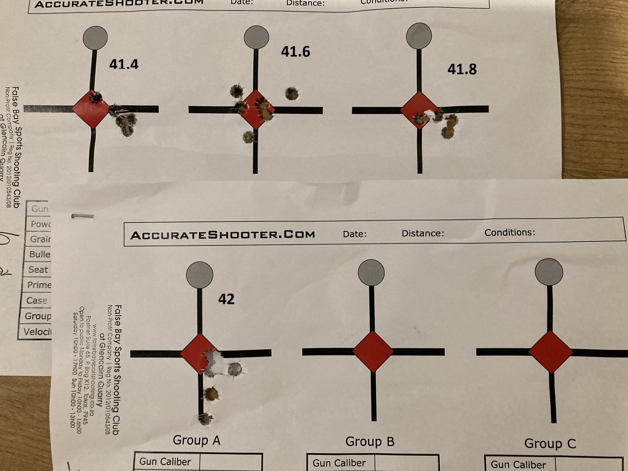

Post pics of the target. Don’t worry about SD at this point in the process.

Here's the chart: View attachment 7896987

I’ve seen mixed results with the off-barrel MS mounts; I had the Wiser mount, used it just long enough to verify that I still had a POI shift so I sold it on down the road. Cool concept, just didn’t work for me. So my takeaway was that the MS can still impact POI, so I don’t ever use it if I’m shooting for groups. Others feel differently, but it’s very easy to test; shoot a group with it on your mount, then take the whole assembly off and shoot without. If your POI is the same, you *might* not be influencing the bullet, but since group size is about more than just average POI, I’m still not personally willing to risk contaminating my results.
Bottom line, my advice is to re-run your OCW with no MS involved, plot your average POI location for each group, then look for 2-3 consecutive groups with the same average POI. Group size is then tuned using seating depth, one you pick your preferred charge weight. I think you also need more powder to make your desired power factor, but proceed carefully and at your own risk. Tikka barrels have a reputation for being slow, so you might just be limited to running right at the edge, or you might switch to the 147 ELDM which will let you drop to a minimum 2600 MV.
