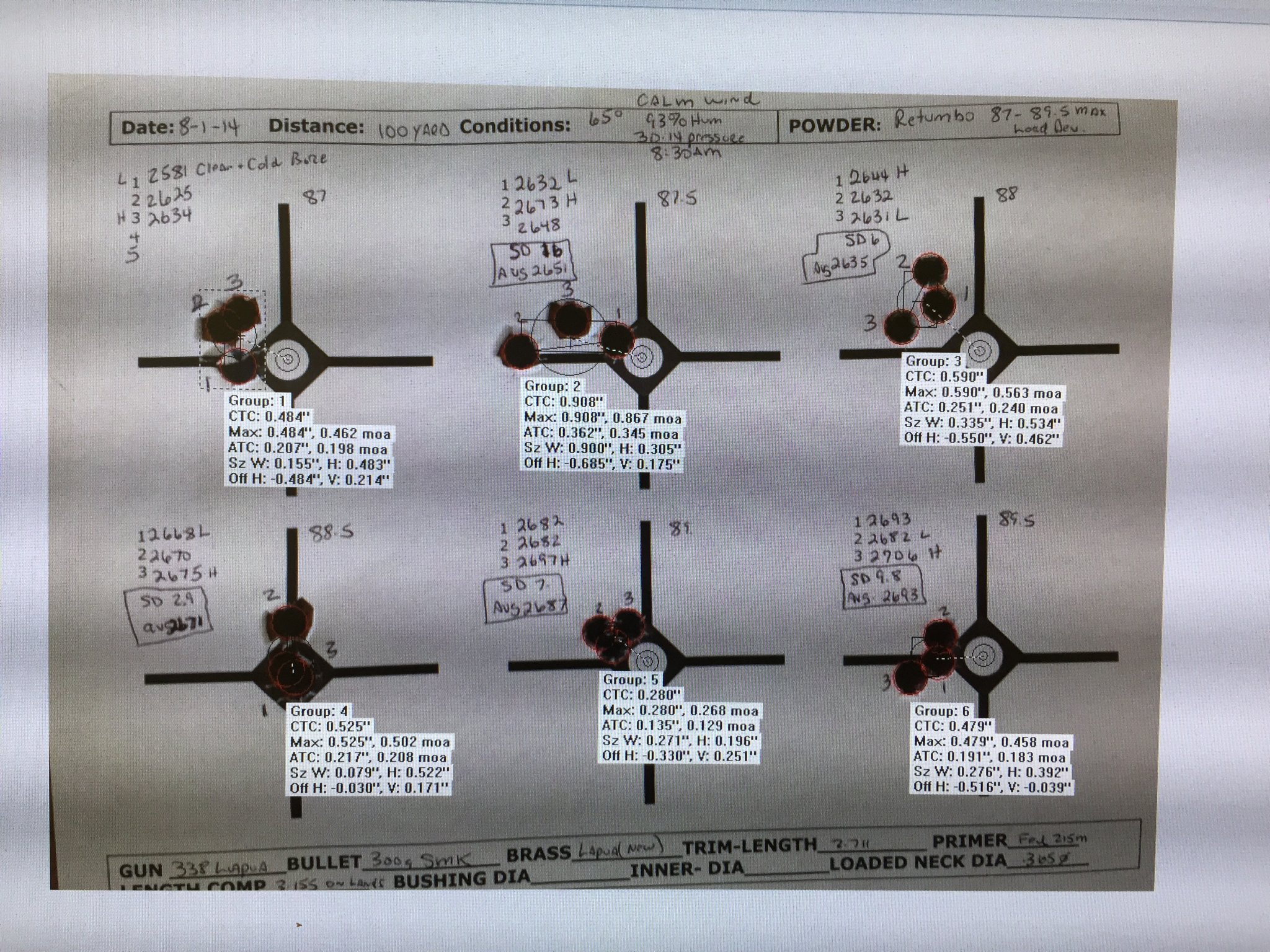

    Did load dev on virgin brass when I first got my Lapua
    Didn’t seem to matter to much
    Have to start somewhere I’d say
    Ended up going with 89.3gr retumbo
    300gr smk @2720fps
    Hope this helps

    I was down to my last 50 cases that I haven’t loaded yet, and I ran out of the 130 VLDs I was using. I decided to use these last ones to do load dev for the 140 Hybrids. Since these virgin cases are within .001” headspace of what they’ll be when I resize them, I’m just interested to see how much difference there is in basically the most ideal situation possible. The results gave a good illustration of my earlier point that .5 to .7 moa loads don’t require load dev to get when using a quality barrel and action.
    That’s a 15 round group, where there was bad mirage for the last 10 shots, each shot was a .2gr increment in charge weight, and the velocity gap was 210 fps.
    I also ran 10 rounds of the fire forming load I’ve been using over the Magnetospeed while I was out there.
    I didn’t do any load dev for these at all, just picked a charge weight I knew was a commonly quoted node and loaded them. As you can see, they have the same ES and SD of what I would consider very good match factory ammo. This is why I typically don’t do load dev on virgin brass.
