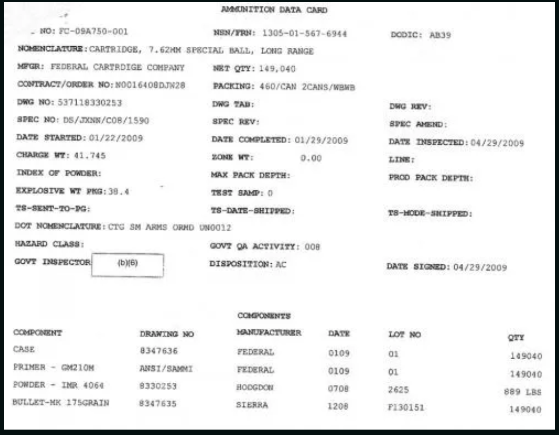

    "Cartridge, caliber 7.62mm special ball, long range, MK 316 MOD 0: A 175-grain (11.3 g) round specifically designed for long-range sniping consisting of Sierra MatchKing hollow-point boat-tail projectiles, Federal Cartridge Company match cartridge cases and Gold Medal match primers. The propellant has been verified as IMR 4064 (per NSN 1305-01-567-6944 and Federal Cartridge Company Contract/Order Number N0016408DJN28 and has a charge weight per the specs of 41.745-grain (2.7 g)"
    In my case, I have a bunch of Accurate 4064 that is a tad bit slower then IMR 4064, so I am going to start with 42.3 and see ware that puts me with current M118 LR and I am also using Berger 175 OTM with FC brass/ Federal 210 primers.

    There are several versions of M118 per my earlier post. I believe that LC produced both 173 and 175 versions of the M118 LR. The 175 probably used RL15 but it had serious issues in Afghanistan. The nitroglycerine would tend to separate out at high ambient temperatures. This lead the Navy to contract for the development of the MK 316 version of the round.
    Here is the MK 316 Mod 0 build sheet from 2009. I have seen deconstruction of later years that have a higher load.
