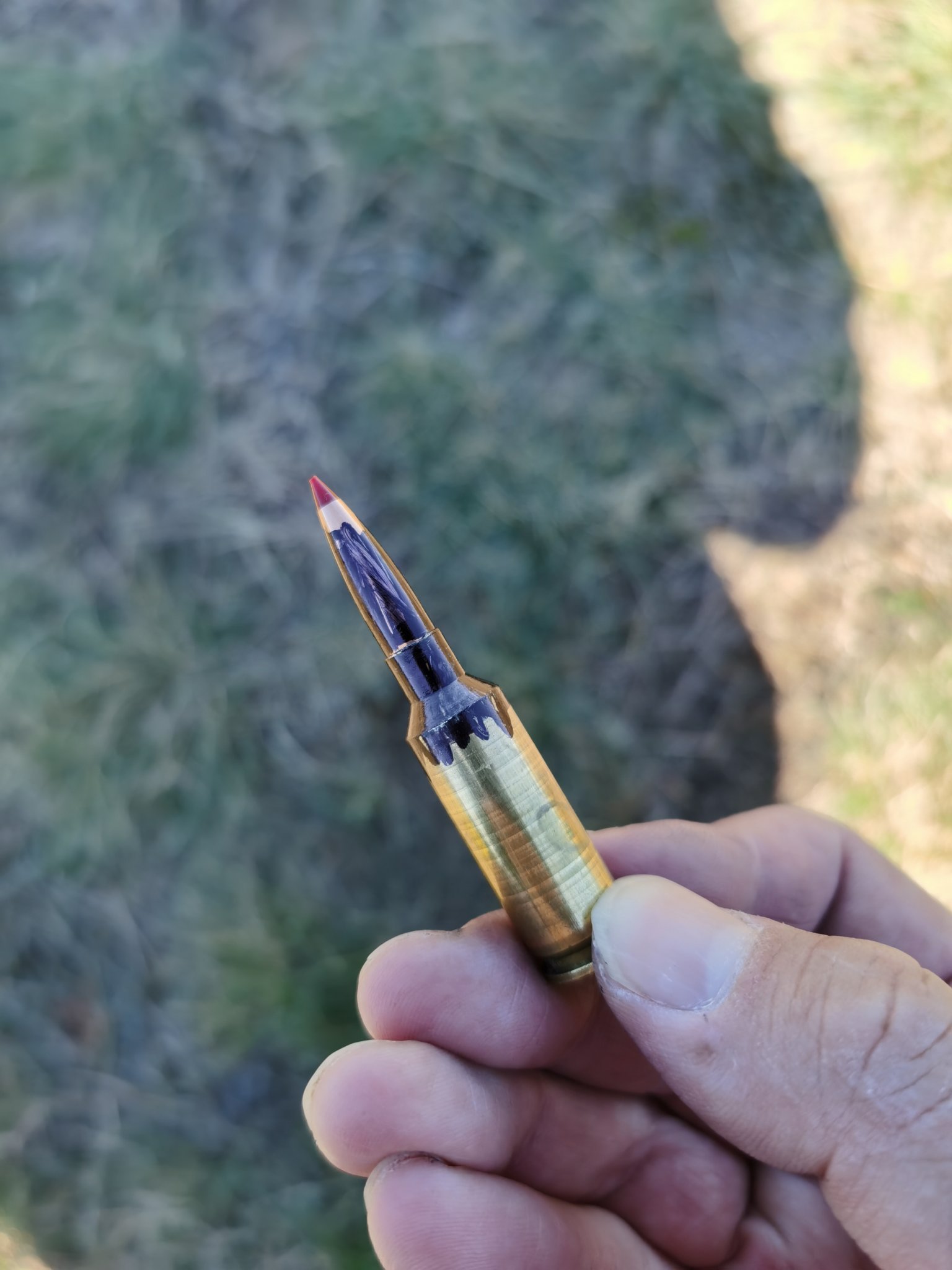

Have you actually sharpie'd a round like the first post suggested? We'd like to see a picture of it after you've coloured and tried to chamber it.
Yes, I managed to use marker to colour the brass and bullet, then tried to chamber. Not something really obvious, but it might provide some info.
Both rounds cannot be chambered, I cannot tell there is any obvious mark removed or scratch.
But on another unchambered round, I found some light scratches on the bullet, not sure if it happened when I hand feeding the round into the chamber. But bullet seating depth is same as those can chambered.

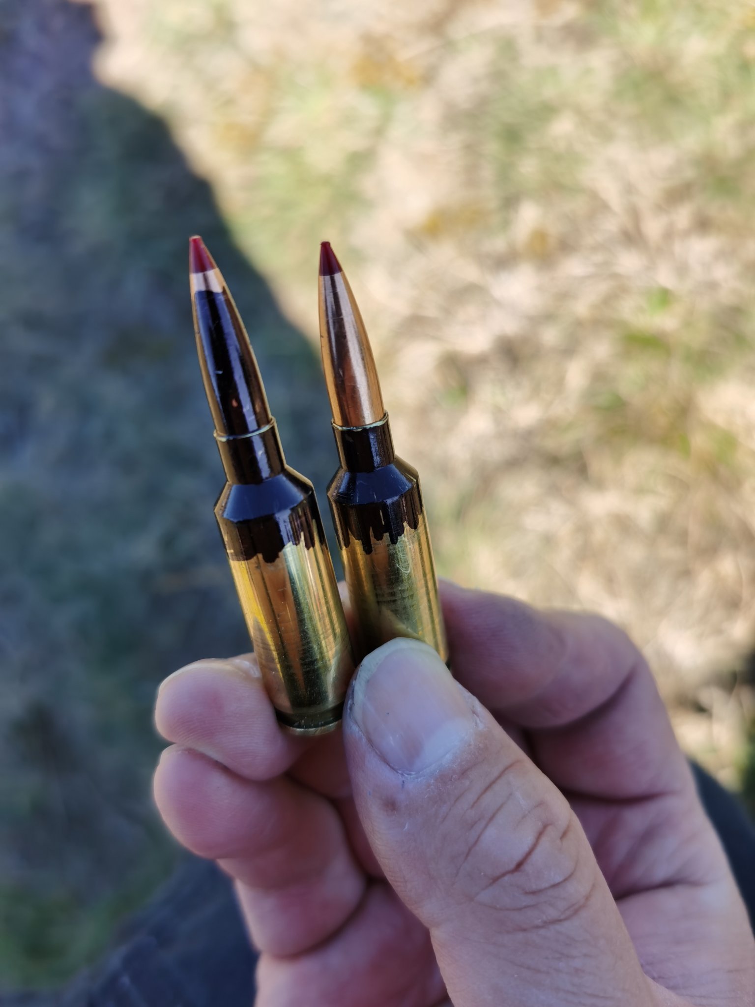

First picture looks like they're hitting at the case neck.
Sharpie the whole case to see if it is near the web. Does it come out of the die with all that layer cake scuffing on the body?
Also, your seating stem is crushing those bullet tips.
Agree, case mouth. Carefully measure midway down the neck and exactly at the mouth. May be a few thousand more at the mouth. Are you wet tumbling?

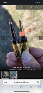

Never said if your wet tumbling but case mouth peennng looks like your issue...... I've seen it numerous times.
Give them a generous outside neck chamfer and I bet it solves your problem.

It's the neck. Best guesses from most to least likely culprits:
1. Neck flared because you bottomed out the expander mandrel - screw the die up/out a full turn
2. Peened the necks wet tumbling - run a debur tool after the tumble
3. necks too long and bottom out on chamber - double check trim length.

The second pic looks like that is from the ejector scraping it along side the chamber. Now color just above where your hand is and try again. I know you don’t think it’s down there but try it anway.

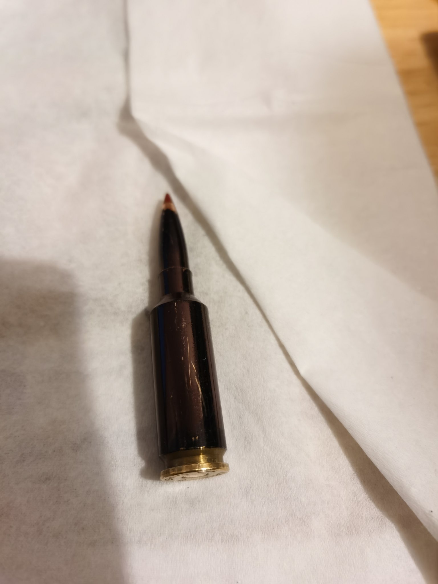

3/4 of the unchambered rounds can be chambered now, I need to push harder, some would need using both hands. Really strange.
But still have last 5 rounds cannot be chambered no wonder how hard I tried to push.
And here is the fully coloured round from the last 5 left, I couldn't tell any obvious mark except a few tiny scratches which could be from the marker or top edge of the magazine.

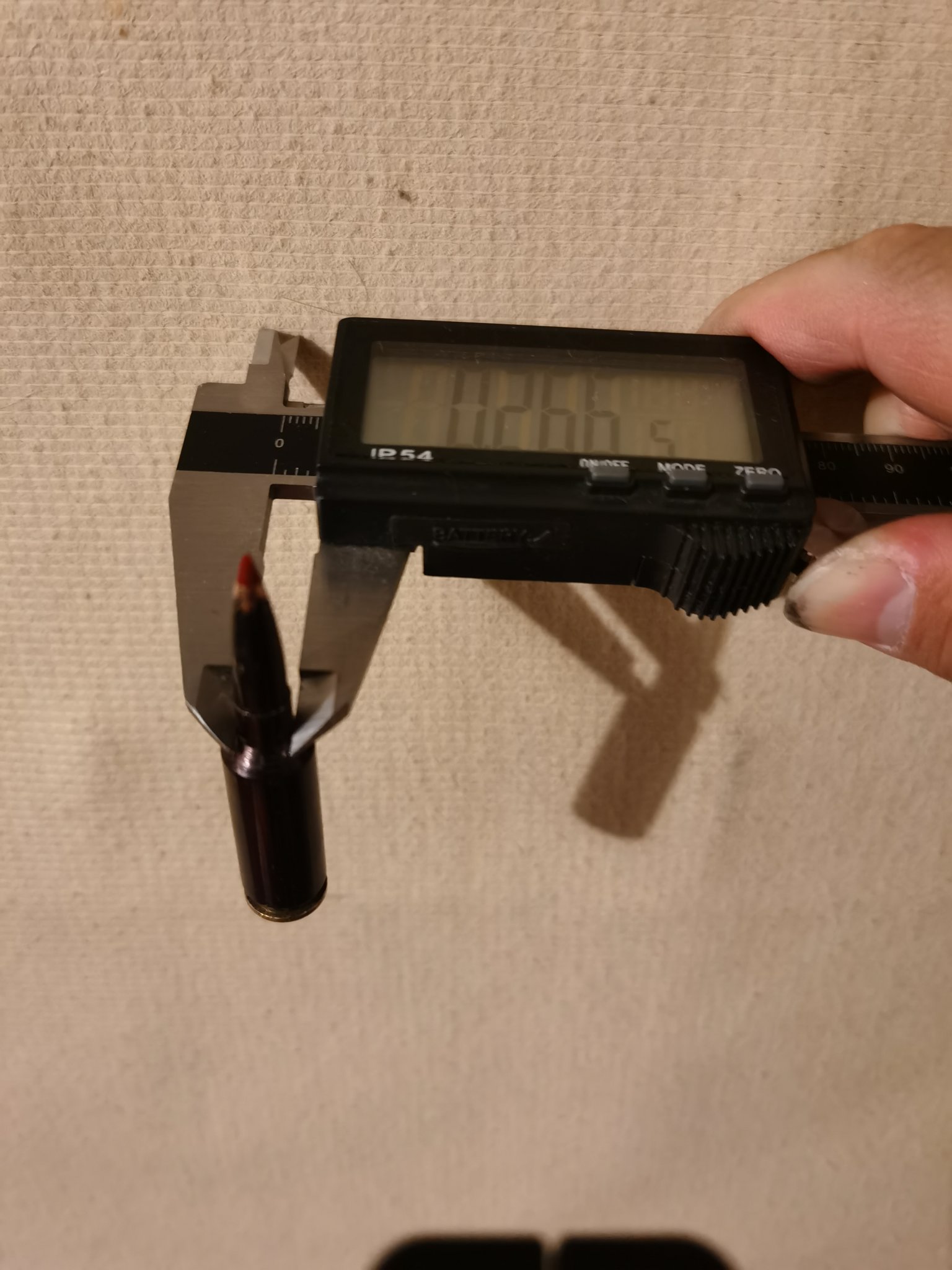

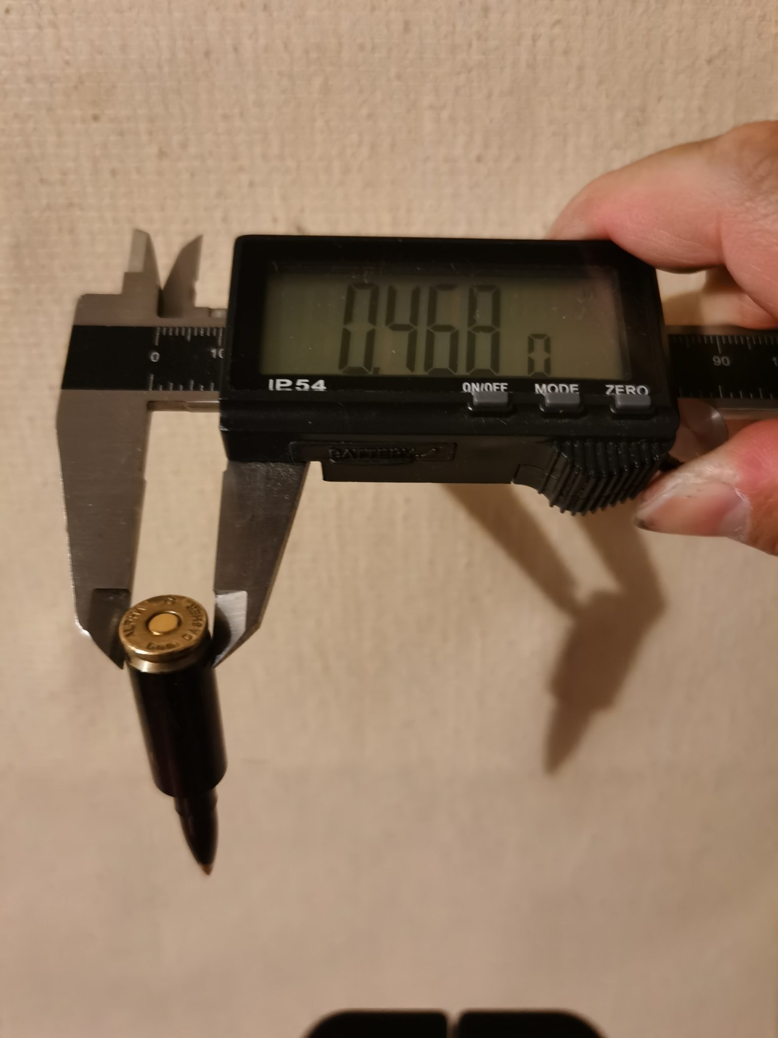

Also I measured one of the last 5 unchambered rounds(able to push some into chamber this morning with harder force), seems all under Specs.
Above extractor grove, body just under shoulder, neck above shoulder and neck at mouth

Based on your base diameter of .468" I'd say you should be good to go and your neck diameter is fine..... my guess is still a slight peening of just the mouth of the case causing the issues.... I know you said you have chamfered the outs side neck diameter but sometimes it takes quite a bit.... based on your original pictures the only shines spots are right at the end of the neck which makes me think that's your problem.... I have never seen a case base expand enough from when fired from the same chamber to cause issues, old brass in a new chamber sure thing but not from existing.

None of those pictures shows actual case mouth measurement. Use the fatter part of the caliper blades and measure the exact top of the case neck. Also, if you slide the calipers up the neck, if the mouth is peened, the blades will catch on the peen. You’ll feel it.

Just saw this, and have a few thoughts.
1. Like was said, use the calipers up into the jaws more. You will get more accurate measurements.
2. In the pics, it appears you are squeezing the calipers tight enough to hold the rounds without them sitting on the table. You are squeezing them harder than necessary. This can give false readings. A light touch is all you need.
3. You mention you are looking at Mitutoyo as an upgrade. Excellent choice. I work in a machine shop, and I'm still using the same Mitutoyo 8" dial calipers I started with twenty years ago. I have a 6" set at home for reloading.
