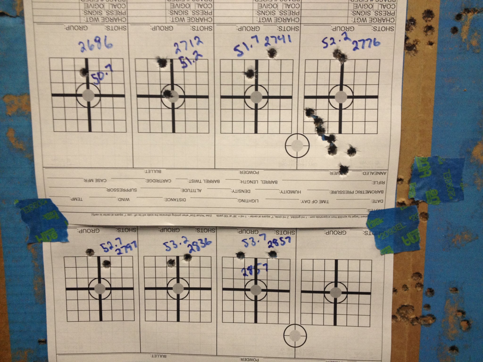

Here is an OCW I did for 162 with h4350. The large bunch is all the 3rd round per charge weight fired over the magneto for velocity. This is a 21" 1 in 8 barrel. The first charge was load suggested to me by another member. It was very accurate, but kind of slow in my shorter barrel. The charge weight I chose also seems to be very accurate and much faster.
My throat is not great for 185s in my 21" barrel.

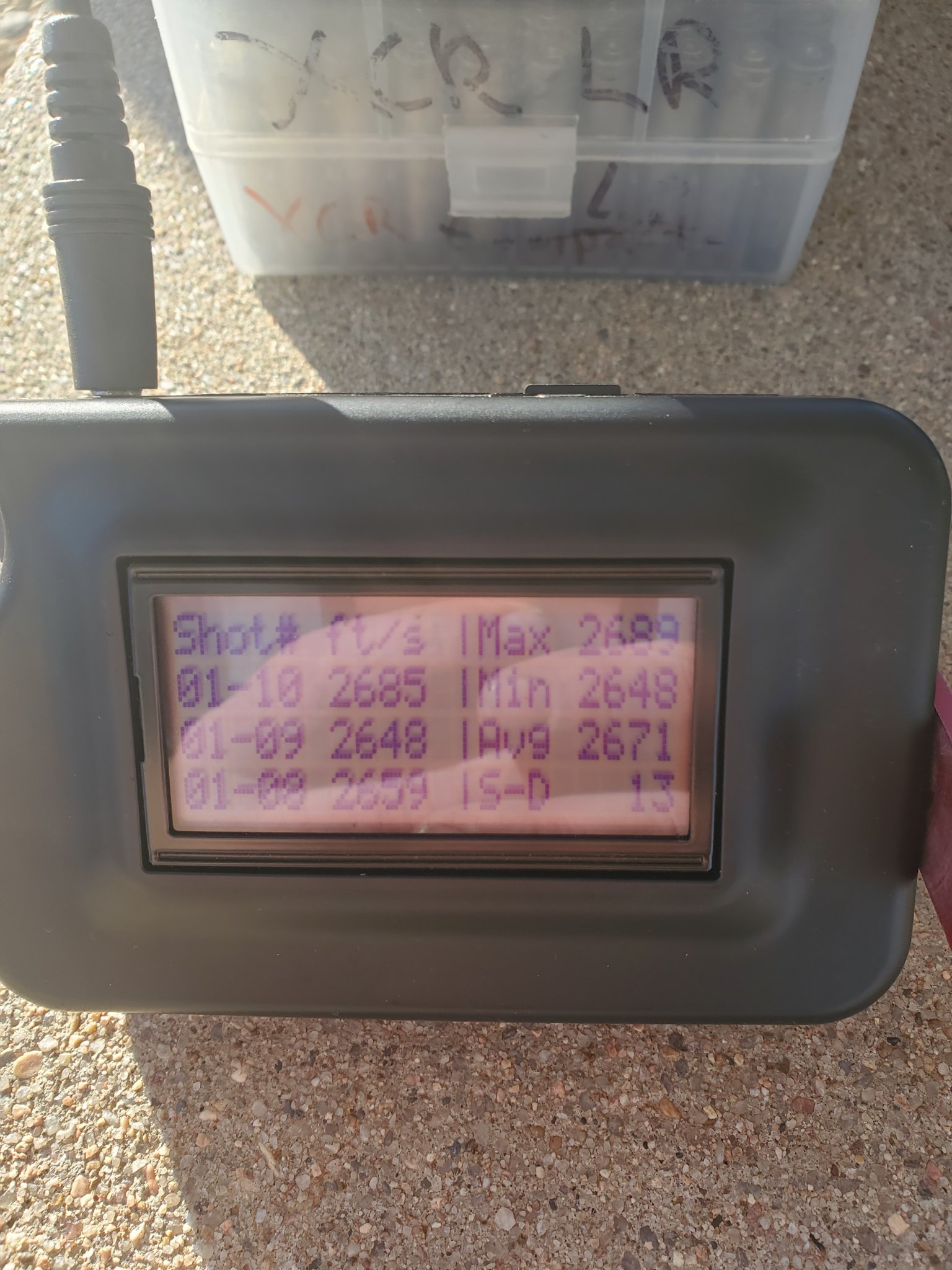

I saved the back row to run over the chrono as they were shooting pretty good from a 10lb hunting rifle.
Brass is either 9x or 10x fired nosler. I was expecting to run into pressure but I don't think I did.

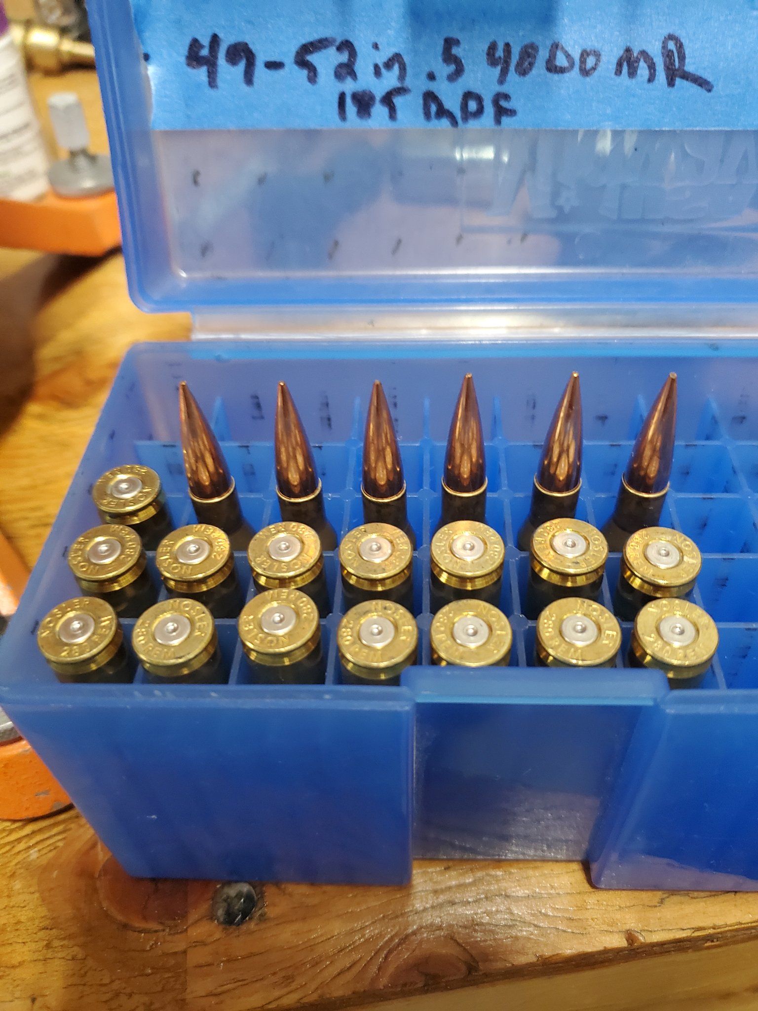

I've been running Re22 in 2 different standard 280's (both sporterized Mauser 98's) and in my Kimber Montana 280AI with a Hornady 154g SST in all. I'm a couple grains below book max in both Mausers at 2800 fps. Decent hunting accuracy in one Mauser and Holy crap that old Mauser can shoot accuracy in the other. I am using Re22 in a couple cartridges because I have a bunch, bought all they had at a deep discount when my local Gander Mountain closed up.
