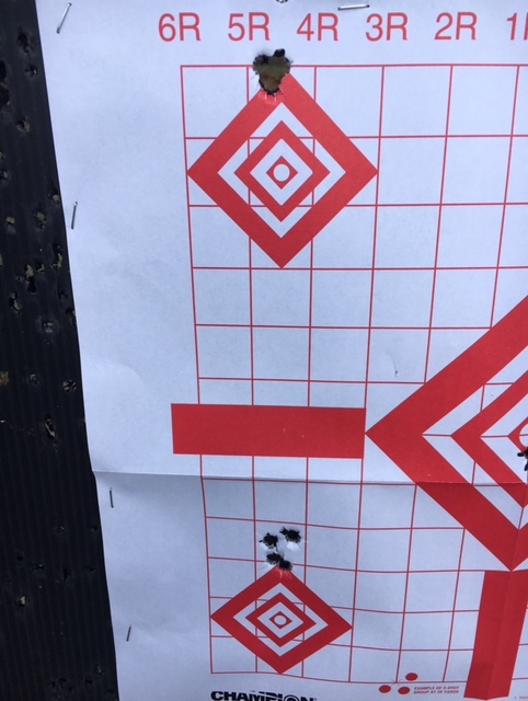

I load Federal brass primed with Fed 210primers, 43.1g Varget under the Nosler175RDF...2570fps from a 18.5" RCB 5R. (900'msl 40degrees-Magnetospeed clocked) Loaded to 2.160 ogive OAL
Bottom group is New Hornady Match brass I was comparing that day. The top group is Federal. 4 rounds and 1 flyer the edge barely visible at the top of target.

Not sure what you are shooting these from but in my gasser I was using 178AMAX,Hornady178bthp and ELDx. 42.5 Varget. Then I found those RDFs...love em.

Mostly used Federal in the 178s. I had picked up some Norma brass to try and the RDFs came along about the same time. So I initially used new Norma brass when I stumbled on to this load. But I was happy to see Federal likes it as well. (which is good because I have more of it). The new Norma brass worked great, but after resizing, I couldn't reproduce the same results. Still trying to sleuth that one. They were resized with the same die as the Federal.
