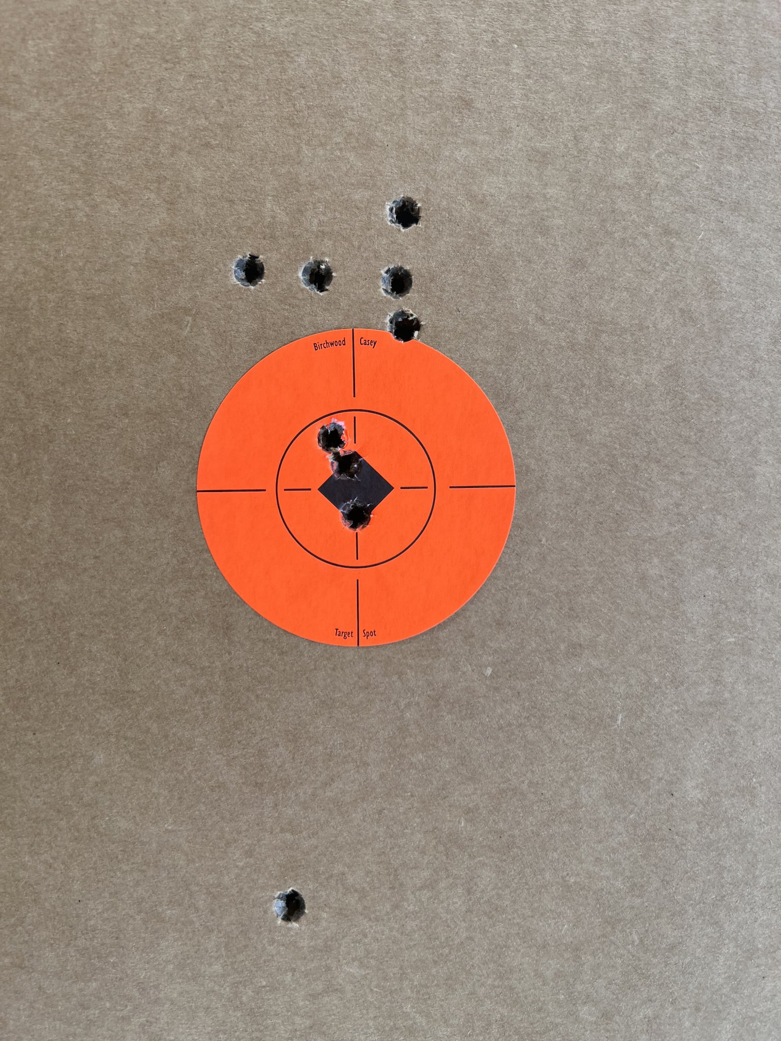

Fc brass, 42.2 4064, 175 [email protected]. FGMM clone. Target is at 100y. I did change out the butt stock to a valtor sop mod and added a trigger Tec ar10 duty trigger

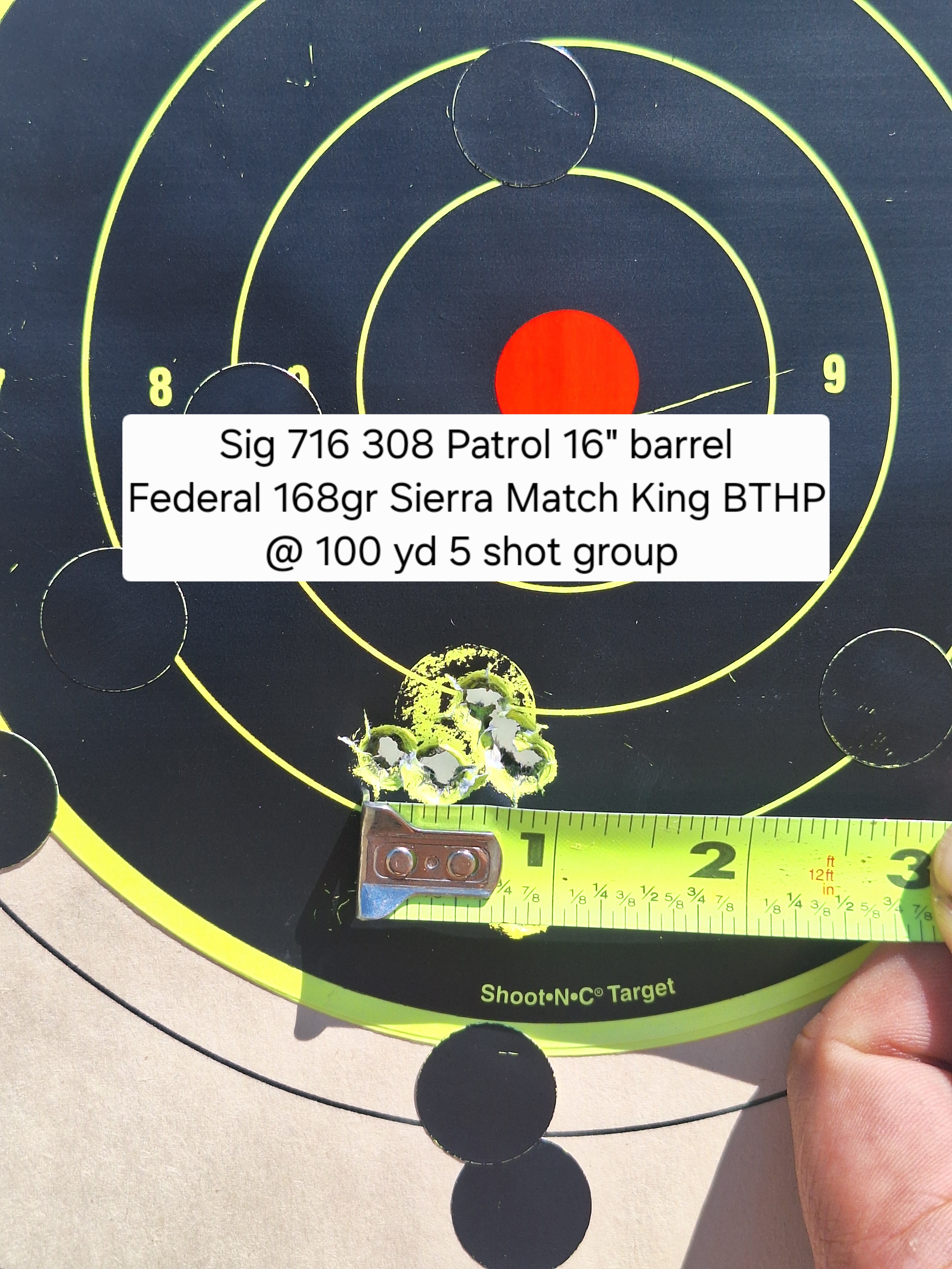

This is the Factory Federal Gold Medal Match 168gr. I have the patrol model not DMR. I would think it will have similar or better result. SUB MOA Accuracy! It does not like milspec ammo
