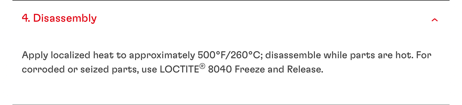

Only way to be sure is to check concentricity with an alignment rod just under the diameter of your bore. A cleaning rod won't cut it. You can get steel rods from McMaster Carr for pretty cheap. Personally, I'd heat the muzzle device with a propane torch for 30-60 seconds to melt the Loctite. Then you can spin it off with minimal effort and redo it. I don't see how it could fully cure in less than a minute. Even using a primer, it would take 10-20 minutes to cure. You certain the brake threaded on fully with no resistance before you applied the Loctite?
I had the same issue with red loctite. Now I put it on only about 1/2 the muzzle threads.
I would just heat it and start over.
Thank you very much everyone this is the conclusion that I came to as well it's a brand new suppressor and I am terrified to take the chance on messing it up so tomorrow I am going to order a alignment rod because I'd rather be safe than sorry I mean I'd rather spend a $25 to $35 on a rod and mess up a suppressor LOL.
So luckily I'm off work tomorrow so I'm going to take the heat gun to it and see if I can melt it with that and if that doesn't work I do have a torch.
The old oxy acetylene torch should do the trick and yes that's a joke I'd never touch it with that I'm talking about a propane torch LOL.
As a side note I do have extra shims so I should be good there I'm thinking about instead of using the 620 Loctite that was recommended by LaRue I'm thinking about using the rock set that came with the muzzle device since it will give me a lot more working time.

I use a propane torch. The thing I like about a torch is that I can heat the brake fast and get it off without heating the barrel as much. My attempts with a good commercial grade Steinel heat gun took more time and allowed the heat to tranfer in that time. The positive of using a heat gun is that you can set/limit the temperature.
With red 271, it always turns to caked powder an Is fairly easy to clean off the threads.

My apologies I meant to get back with you gentlemen today I started off using a heat gun and then I decided the hell with it and use the torch and the muzzle device came off just like you said it would with ease it was like nothing was even on it.
Then I reinstalled one of my muzzle brakes with Roxette that came with the silencerco muzzle brake.
And then I did the same with my second gun and by time I got to my third gun I went to open up the little pack of rocks that came with it and it was a firm gel and I noticed the package had a small hole in it so it pretty much dried up LOL.
I used the 620 Loctite on that device but it's on an AR platform so I'm a little concerned about the Heat I fire slow but in a shit hit the fan scenario I may need to fire rapidly.
I have Vibra tight hot lock but I'm afraid to use it on my LaRue Barrel because I heard a horror story of a guy that used it and it didn't play nicely with the metal they use on their barrels and pretty much disintegrated his threads.
When I contacted LaRue about it to see if it was true they said that they don't recommend hot lock for their barrels but apparently they use 620 Loctite whenever they send out their rifles that have quick detached muzzle devices on them.
So I figured it's good enough for LaRue it's probably good enough for me but I still have my concerns about it getting too hot for the 620 Loctite that claims it only goes up to 450°, but I believe it weakens to about 50% strength at 300°.
So I'm probably going to get some more rock set just to play it safe thanks to you all I'm no longer intimidated by 6:20 Loctite now that I know how easily it comes off with heat LOL.
