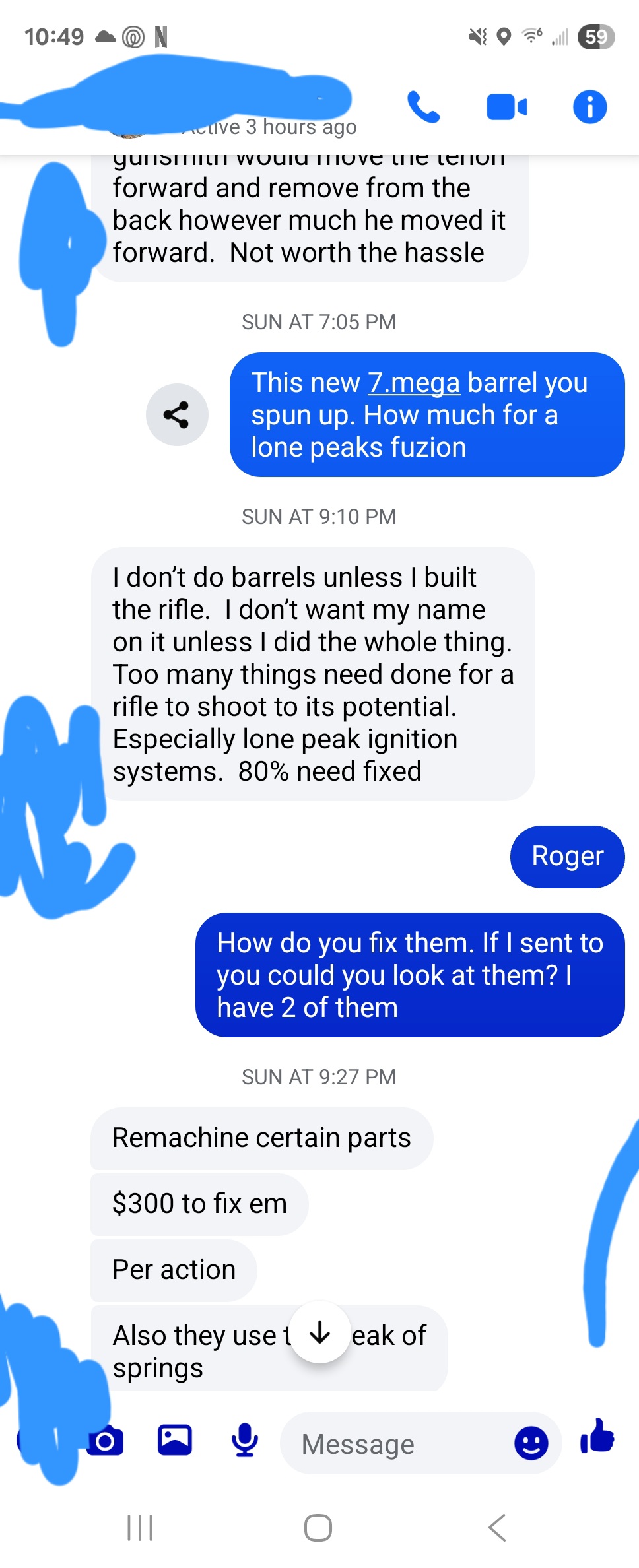

So i need help, I purchased 2 lpa actions. 1 long action ti and 1 steel medium both fuzion both full dlc. I had 2 carbon six barrels made and that's where I'm at 1 7prc amd 1 6.5 max. I inquired with a well know Smith to make me a 7 mega barrel for one of the lpa actions and he refused to make a barrel for lpa. He said they are junk. He said for 300 he could make them to their potential, here are the issue he state and I'm just wondering if it's worth him to fix or try to part of ignore what he said. Here you go. Copied and pasted his comments below
Their shit is generally junk if you want benchrest accuracy consistently
1)I don’t do barrels for lone peak arms Too many things need done for a rifle to shoot to its potential. Especially lone peak ignition systems. 80% need fixed
2) they use too weak of springs
3)Firing pins, cocking pieces binding, inadequate firing pin travel. Weak springs. And their actions are one of the most crooked actions on the custom market. I refuse to build on em anymore
4)Horrible cock on close generally also
5)Proper ignition is crucial for consistent benchrest accuracy. Without it the the gun wont shoot light: out. In big magnums I’ve seen hang fires in cold weather w their actions due to ignition. Fix the ignition and it’s cured.
Remachine certain parts $300 to fix em per action.

That's weird I'm only taking about the action not talking aBout any other part of the rifle i just had a smith refuse to make a barrel for that action. Not sure what a builder has to do with it. The one barrel i have is a prefit barrel from carbon six that I'll put on myself. I was just curious if others have heard any of these issue the Smith stated. From reading other blogs just now it seems like and issue

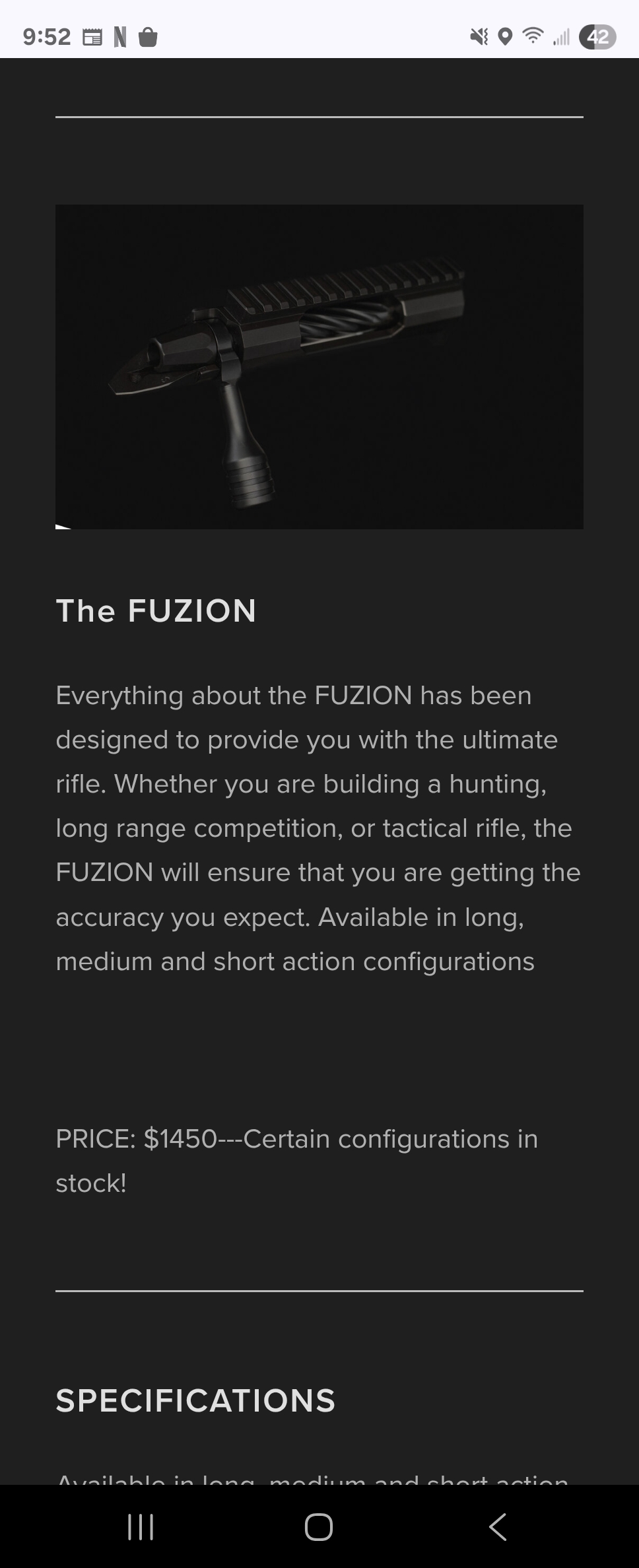

Says right on the website from lap for hunting

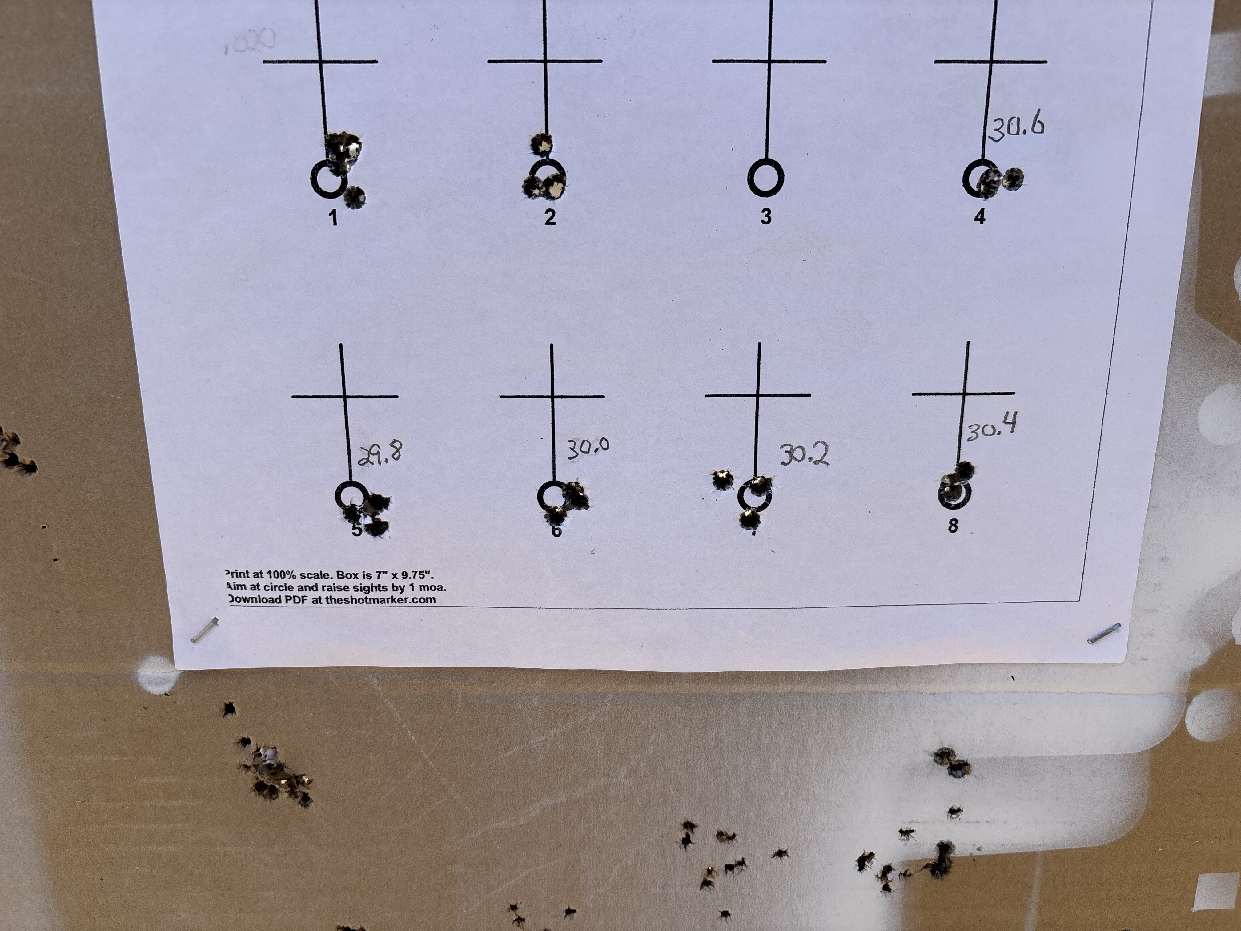

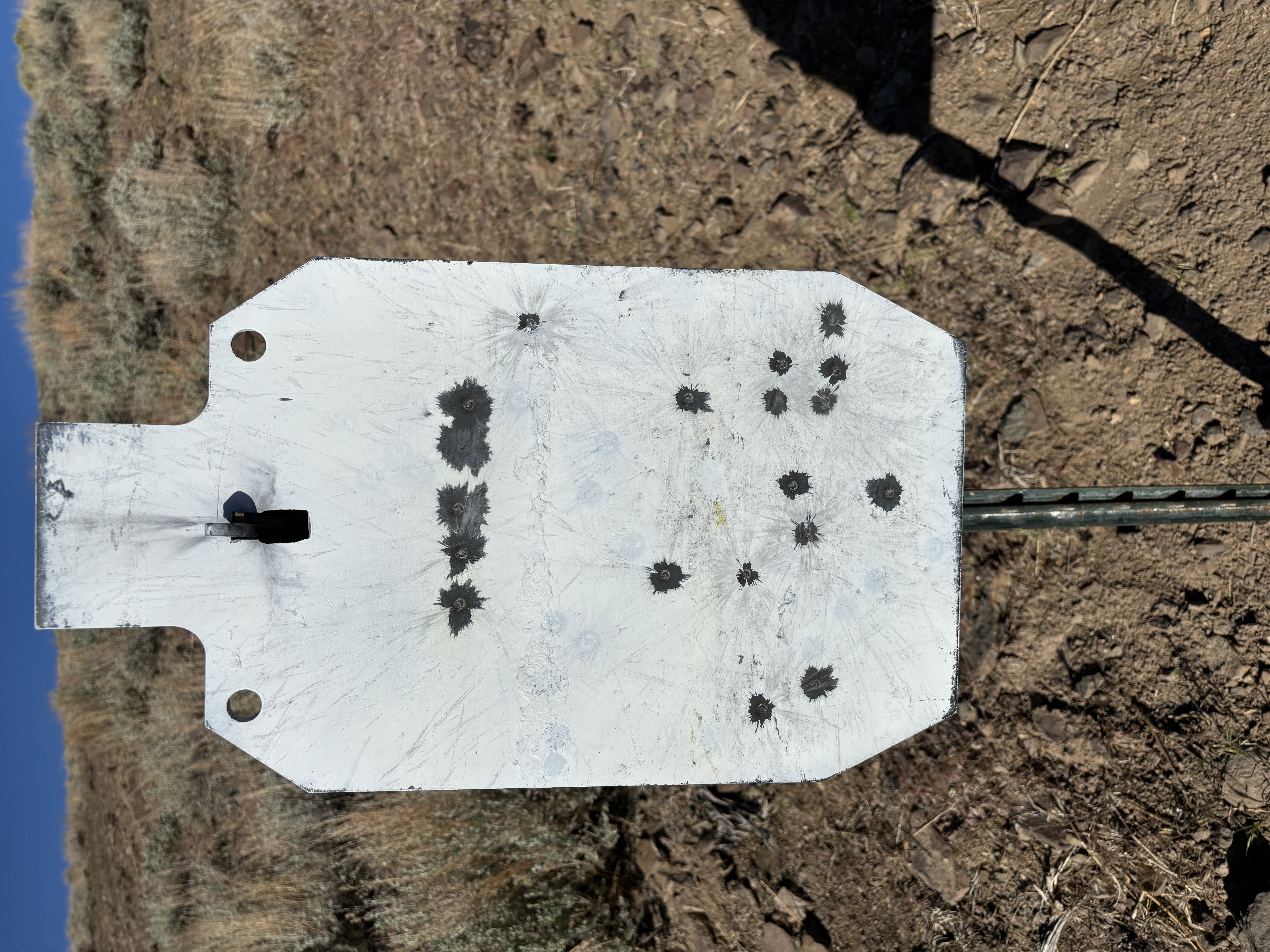

These are Lone Peak actions
All 4 groups are 15 rounds each....
4-5-6-7-8 all shot yesterday off my tail gate, 80deg mirage was bad...
last pic won't load so gotta double click....5 shots high are the water line at 850yds from my Lone Peak 6BR 24" ACE barrel....so as someone already said I'd be looking for a new smith unless you building a full BR gun.
