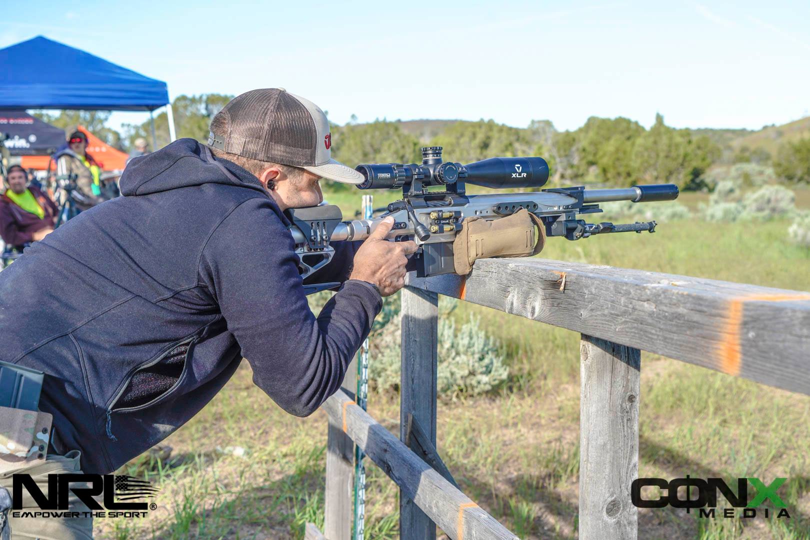

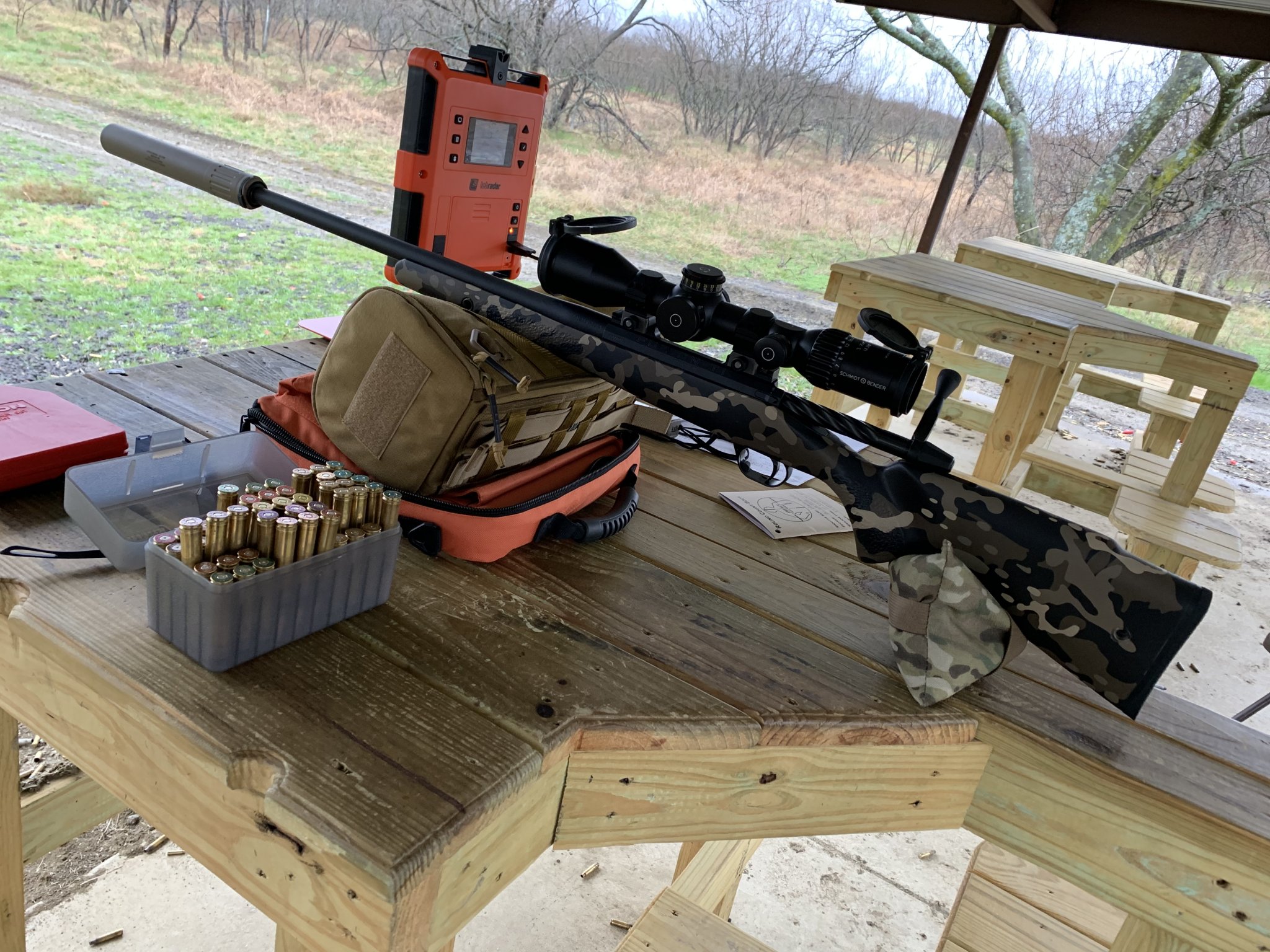

Since I haven’t found one that exists, how about a Lone Peak Arms Action thread to include experiences with the action?
A thread to share past, present, and future builds?
LP Fuzion Ti LA Magnum
Bartlein 10 Twist 300WM @ 19"
AAC Mk13-SD
CG Extreme Mod-22 @ 2.5lb
S&B US 3-20 H2CMR
NF UL 6 screw rings
Manners EH6
Ti BDL with Wiatt's guts
Chad Dixon did the work, but Kalli sexied it up.
She squirts 215g Hybrids at 2600fps with ease... I'm think I'll mess with 175g, 185g, and 200g projos as well.

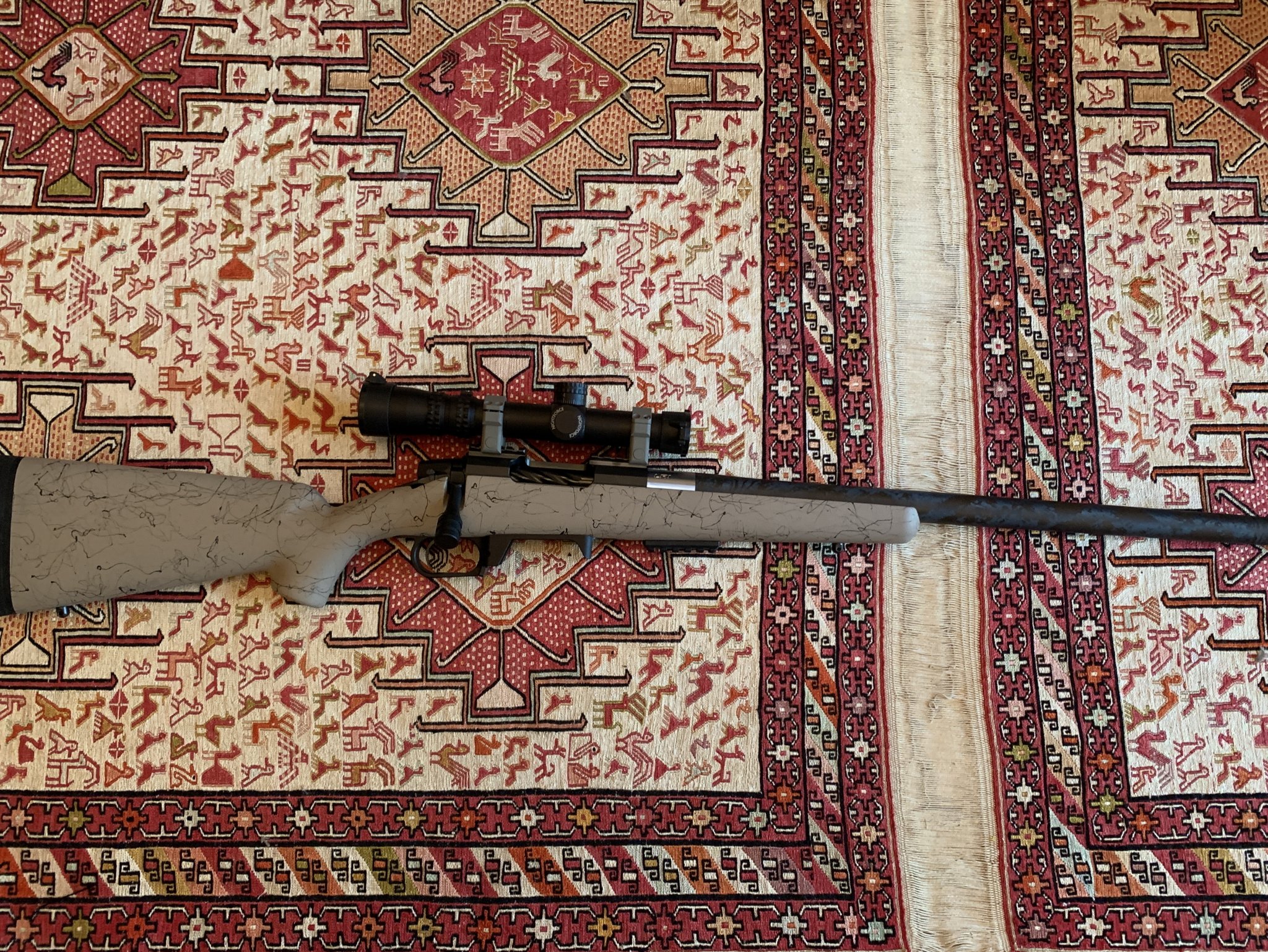

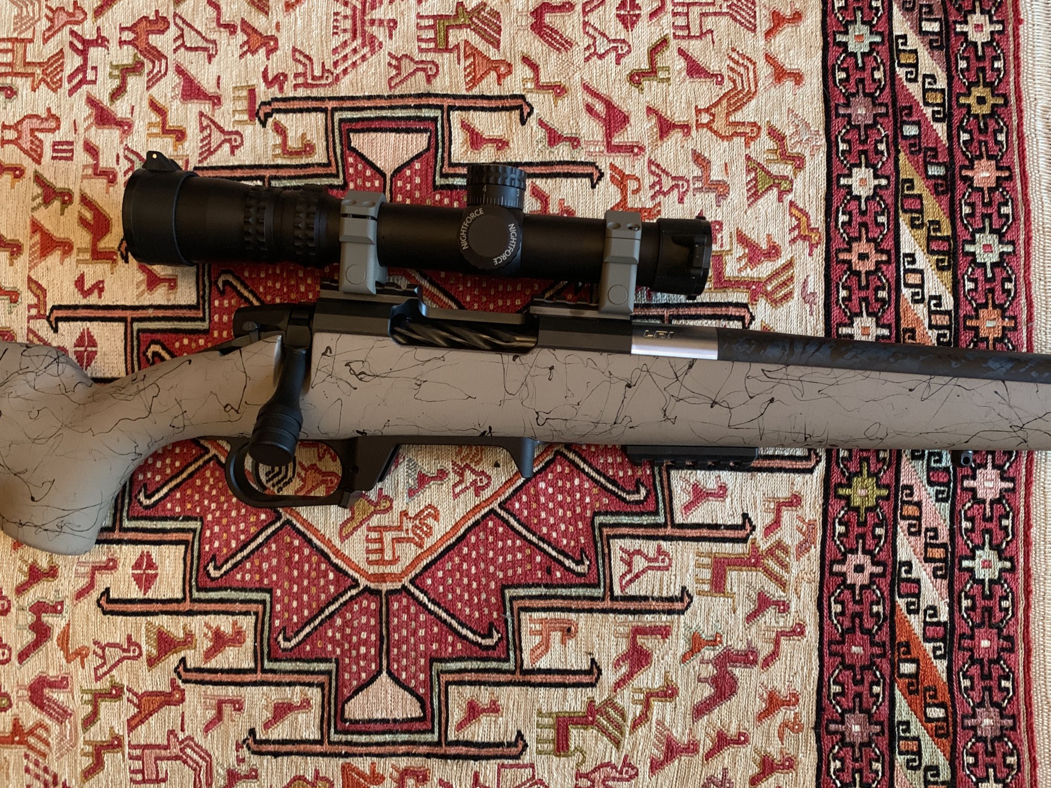

I have a Ti Fuzion in .223 AI. It is now in a Manors but will go in an AG Composites stock that is to ship Friday.
Barrel is a Proof CF 7 twist. I am getting 3050 out of an 80 Grain Amax. N540 and Lapua case. CCI 400. 70 degrees.
This is the rifle before I put the TT315M scope on it.

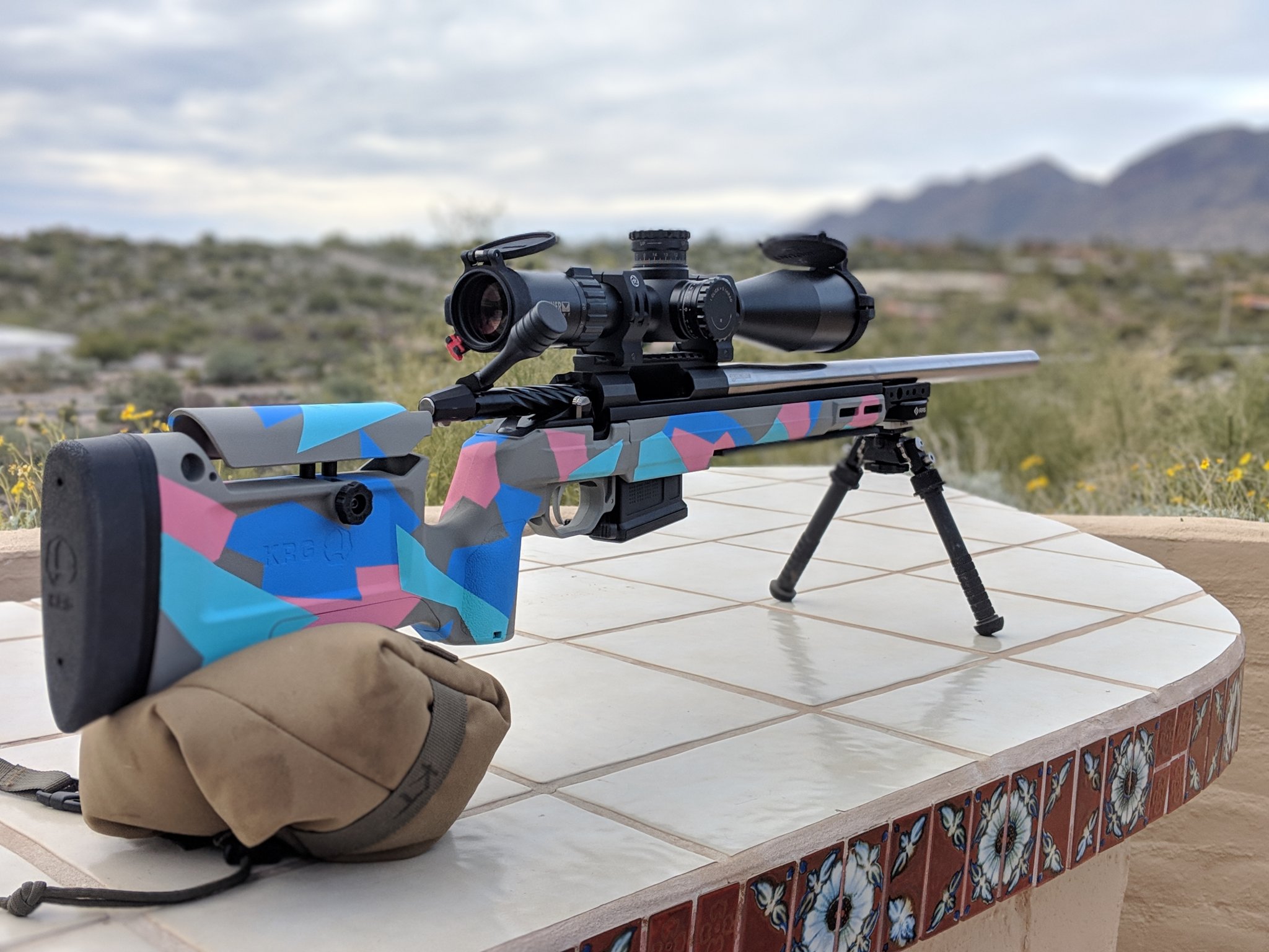

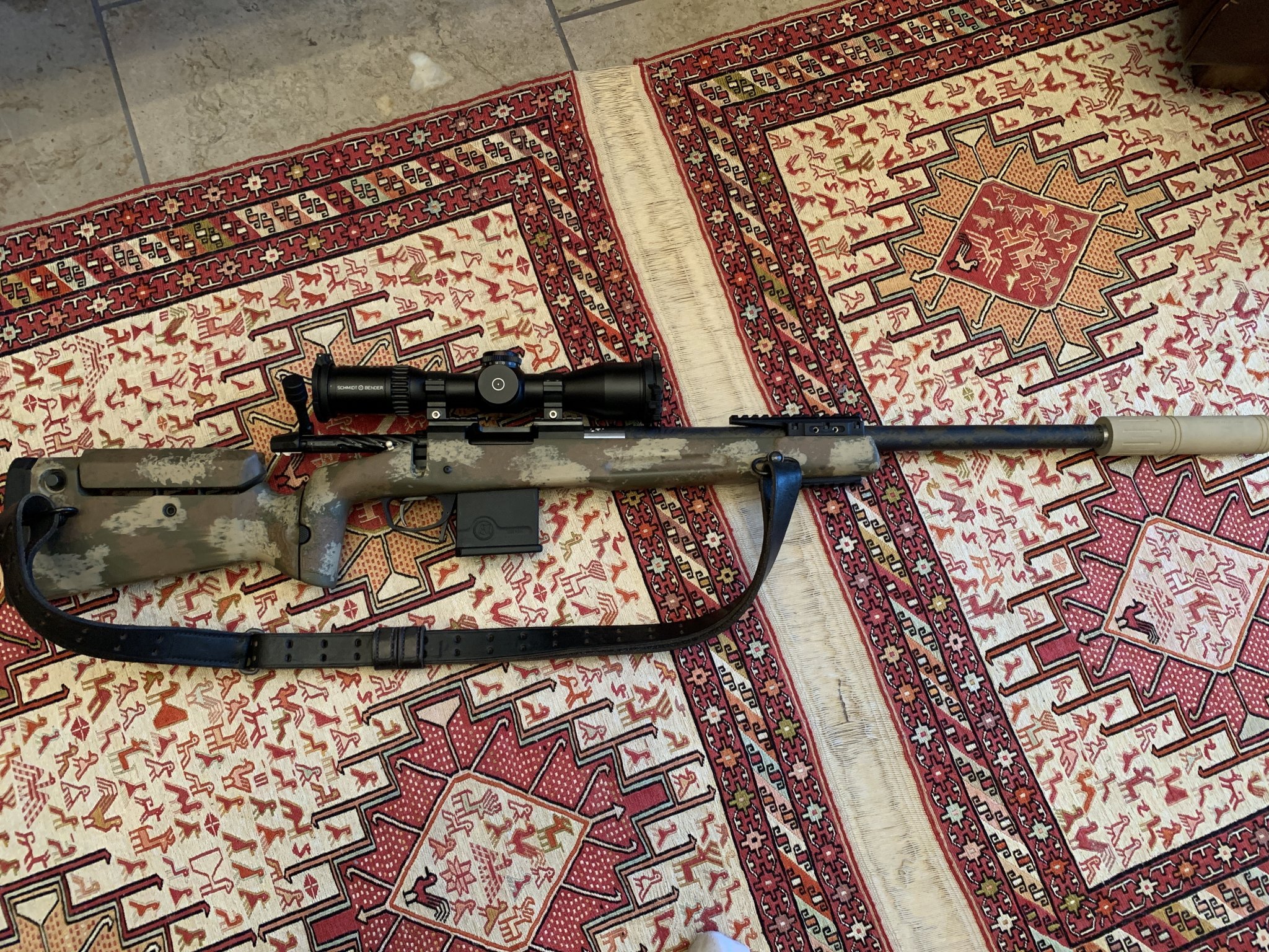

Built a 6BRA rifle for my wife on a Lone Peak Fuzion action. It's a pretty badass push feed action. She only has about ~120 rounds down it so far, but it's breaking in nicely.
The action seems to "snap" open and close, when you run it with a little bit of steam. Runs great dirty or clean. If I was in the market for a push feed action, I'd seriously consider another Lone Peak Fuzion.

I really don't know. It was coated at the factory and will go in a light stock so I did not request anything special. It is far heavier in the heavy Manors that I had hoped for. The AG stock will take off literally a few pounds.

Love the pattern! I got a Lone Peak on order right now and I’m happy to hear about the feel on open and close. It’s one of my favorite features about the Curtis actions.
Reactions: kthomas
No pics, as I am in the middle of a move right now, but I run a titanium Razor. It sits in a Manners EH2 with a Proof CF barrel chambered in 300WM. TS Customs built this one as well. Hawkins Precision BDL, Hybrid Rings and 3 Port Brake. Topped with a TT315M, the thing hammers with factory Nosler ammo. It’s been a while since I weighed it, but it’s right around 8.5# loaded with sling.
Thanks! The wife certainly loves the colors and patterns I came up with her rifle.
You are going to really like the LP Fuzion, it's a great action.

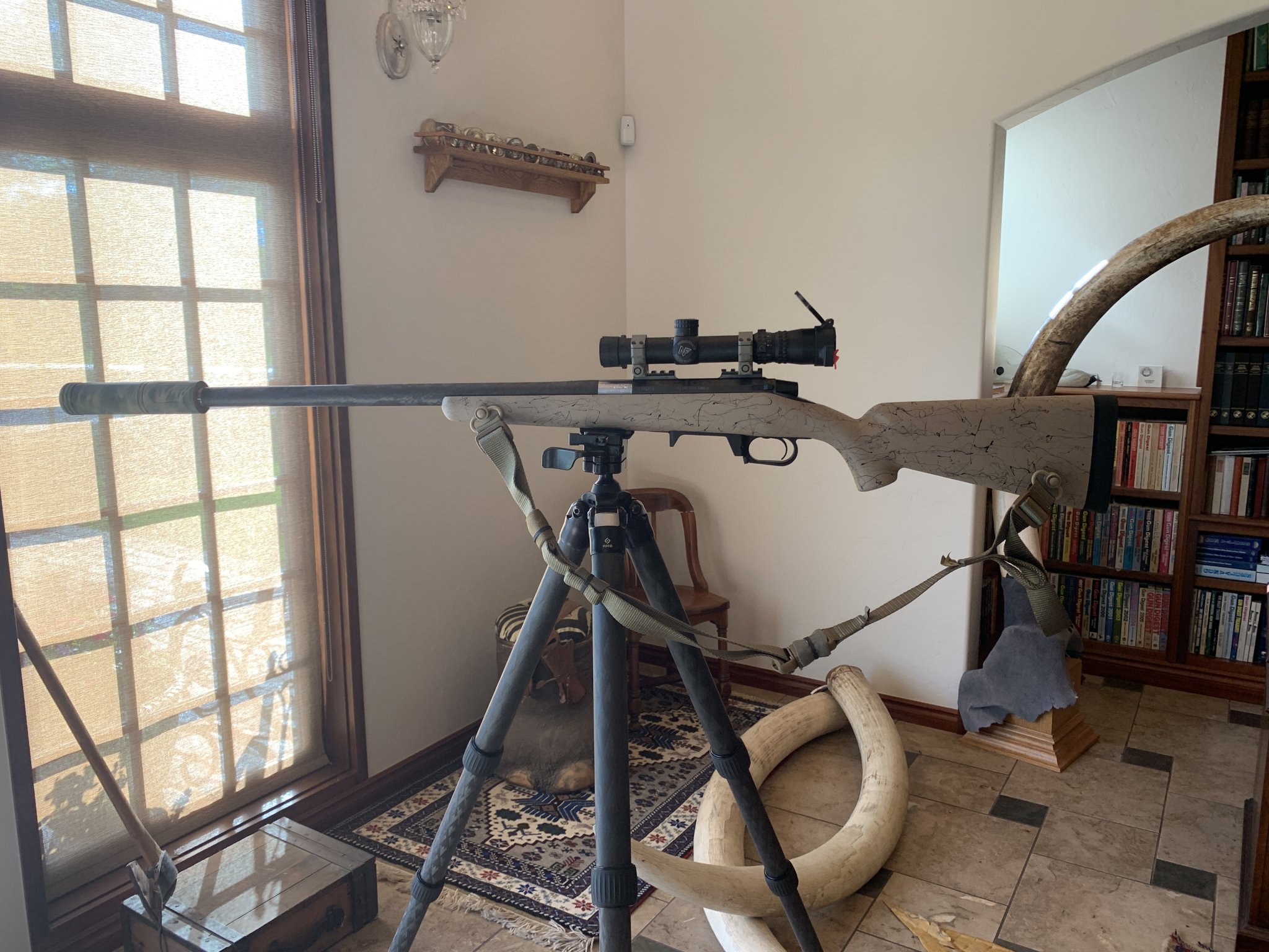

The rifle hit 10 consective .25" dots at 100 yards on first attempt.
It has 320 rounds fired so far.
Shooting 80 grain A Max at 3050 fps. Max load of N540, Lapua case.
Your rifle looks wonderful. Sounds like a shooter too. What contour/length barrel, and what's the rifle weight? Also, what inlet cut on the stock and what bottom metal? Thanks!
It is the Proof Sendero contour. Larger than the Rem Sendero.
Barrel is approx 22”.
Weight without suppressor is 8#7 oz. That includes scope and sling.
Thanks for the compliments.

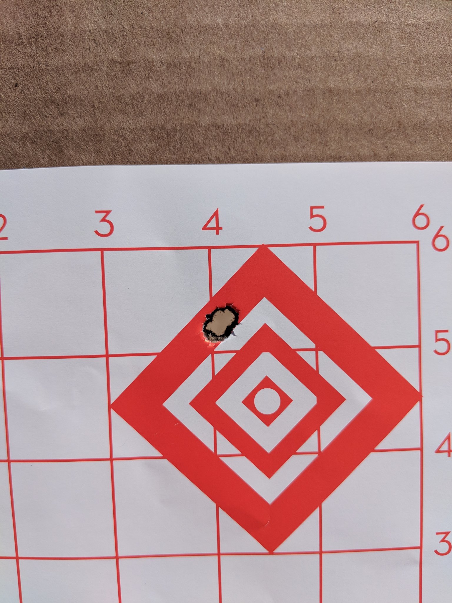

TS Customs is my preferred gunsmith these days. He's built me some absolute "hammers" (as the cool kids would say).
Here's 5 shots at 100 yards with one of his barrels:
That’s an impressive group. Maybe shoulda waited before I direct shipped a barrel to PVA. They don’t do prefits for the Lone Peak so I gotta send it in... But after I smoke it or buy another Lone Peak... haha
