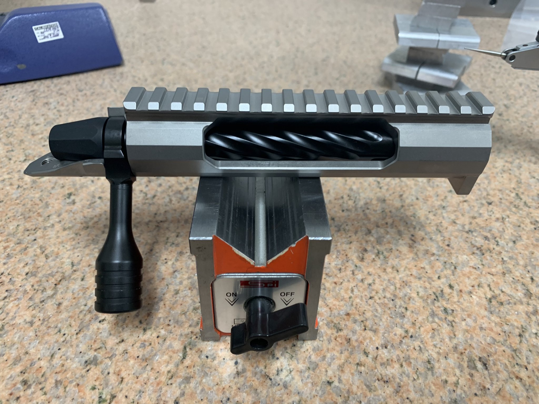

Received this Fusion TI last month. Impressive action!
Reactions: CStroud and kthomas
