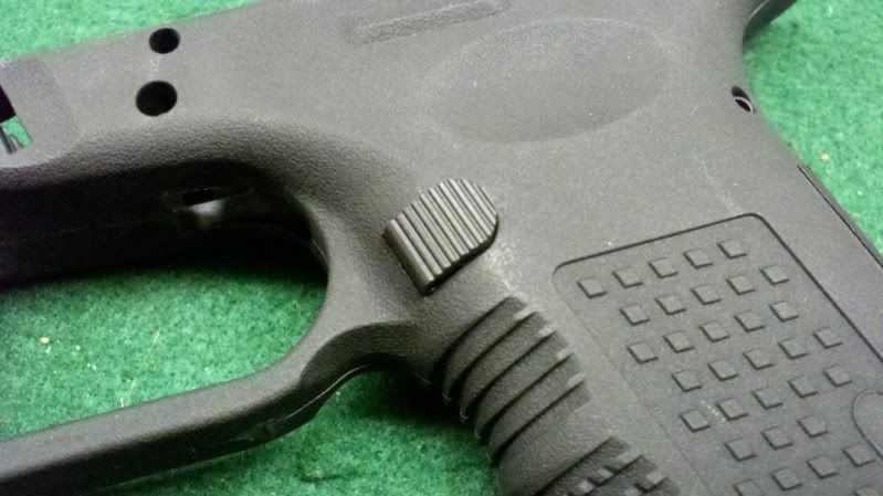

I looked at these at SHOT and really liked the feel. I like the beaver tail, interchangeable back straps built in grip reduction (no hollow space behind the mag), and bigger mag release.

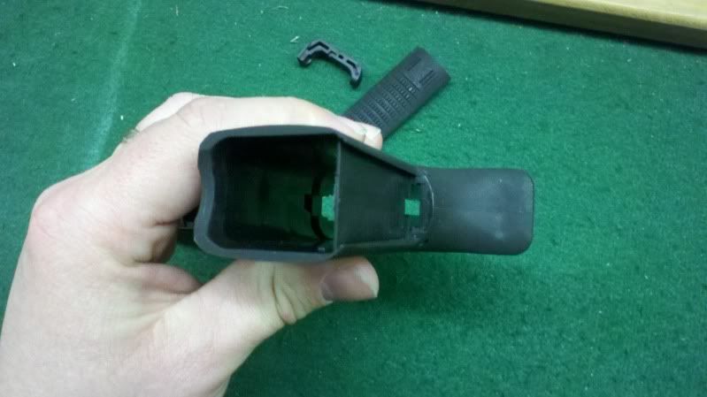

It went together easily no fitting required. The only thing that was a hang up for me is that the trigger mechanism housing from my gen 3 G22 with the Lone Wolf over travel stop would not fit. They use a gen 4 trigger mechanism housing but it is easily drilled and tapped for the set screw.
If you are looking to get a grip reduction on your Glock you may want to look at going this route. This frame is everything I like about my Glock just better
Oh and the back strap had a compartment that will carry two Crimson Trace/scope batteries
