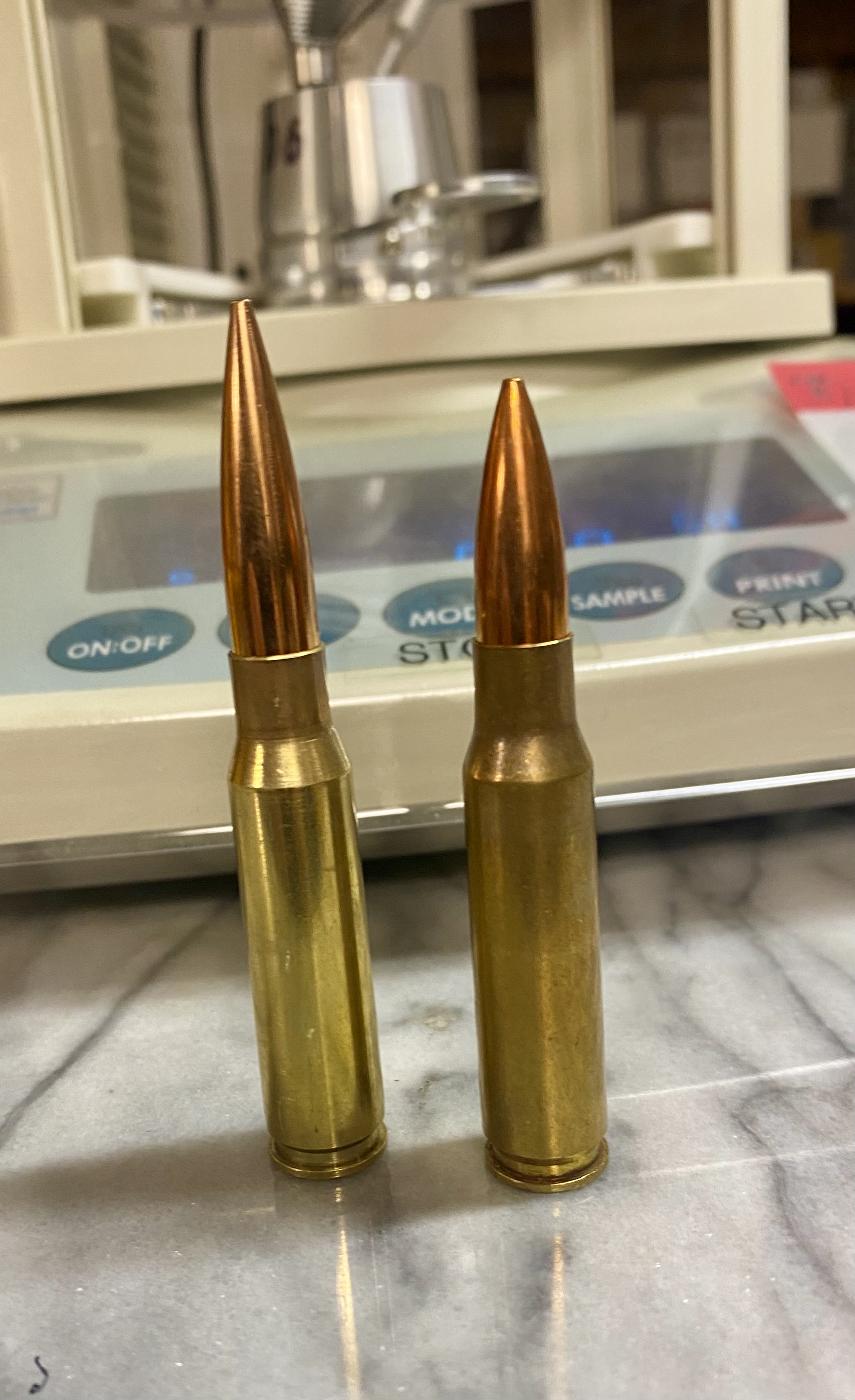

Which is problematic for the short actions. Accurate Mag does make a CIP length 5 round 308 magazine. I have two that I’ve tried with 6.5 CM and they have been fairly reliable, but sometimes nose dive. One major flaw is that they appear to use non-CIP length followers so the follower can easily tilt/shift.

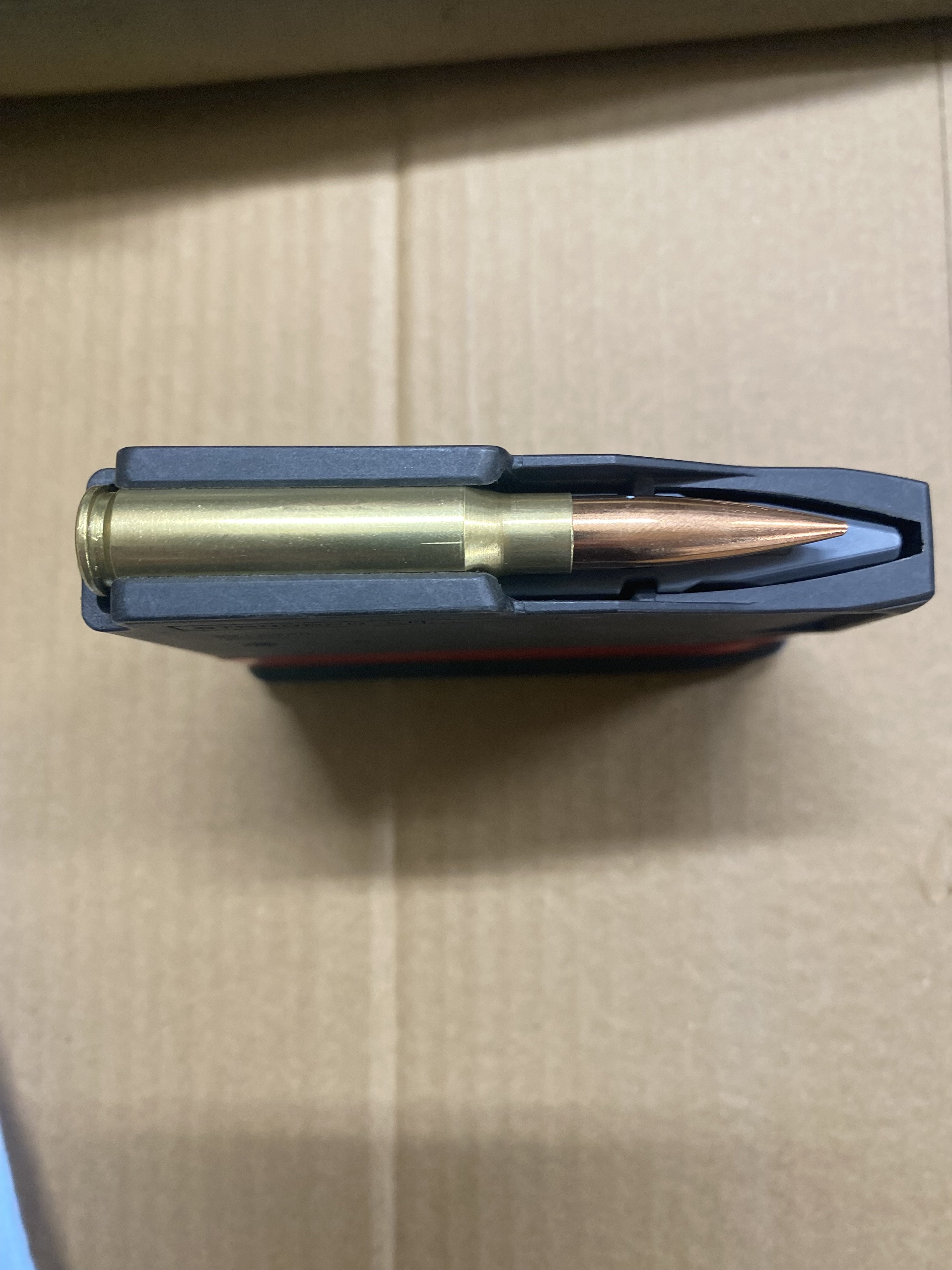

I have also tried Magpul 30-06 mags that I built up the front with polymer epoxy and sanded flat so that the mags are 3.850” long. However, these all nose-dive for the 3rd-5th shots. I did test this prior to doing the mod and saw the same issue, I just hoped fitting it to size would help.
I may be able to adjust my mag latch to solve some of the issues. But the sloppy follower in the accurate mags has me thinking of some solutions with 3D printed spacers with their own ramps to help feeding, but haven’t made them yet.

I tried an Accurate mags that @PappyM3 mentioned and I didn’t like the way the follower would tip.
I ended up using the plastic MagPul AICS LA standard (30-06) magazines and they worked without any problems.

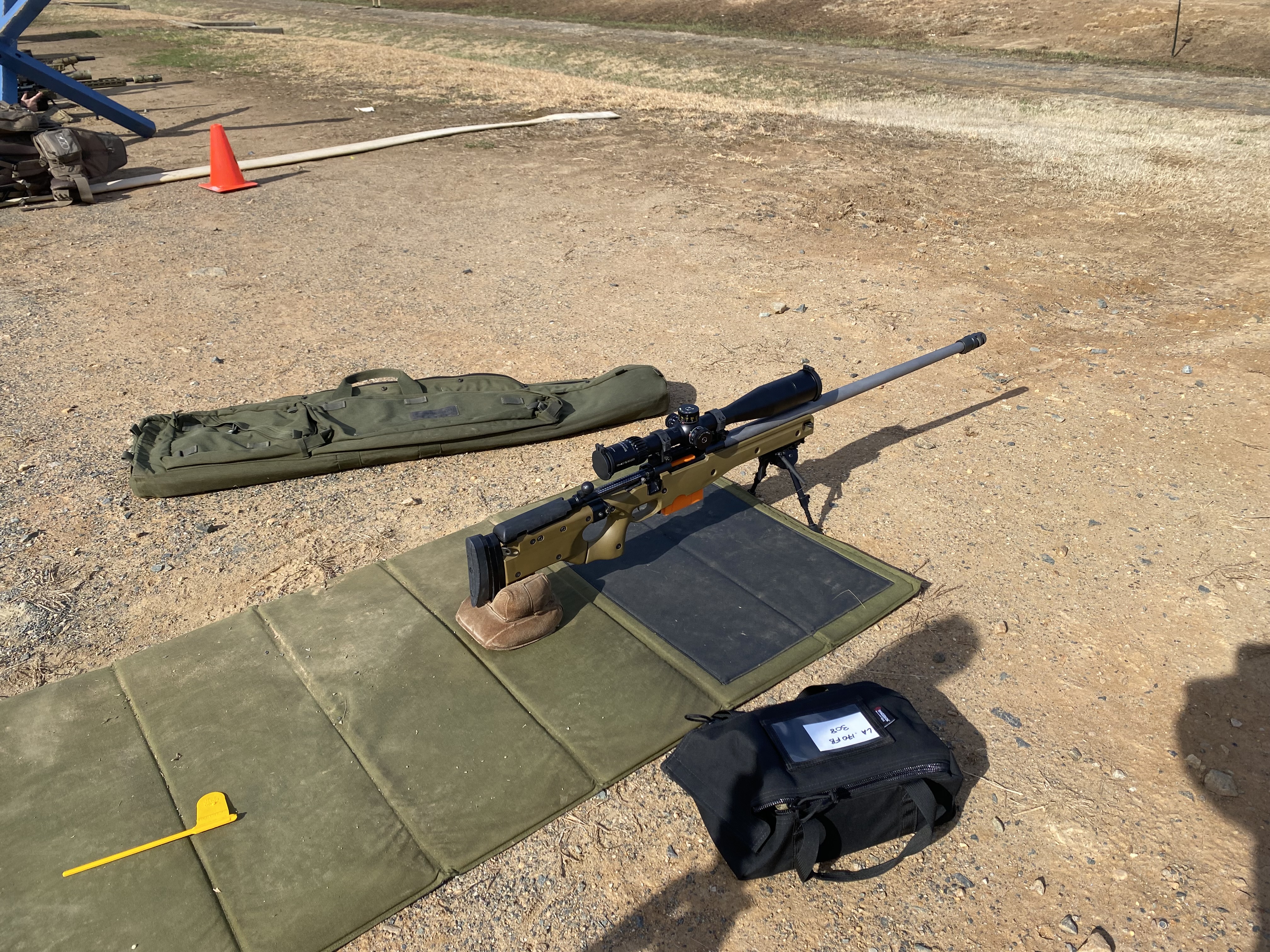

So I just took the rifle to a two day class. I haven’t checked the exact amount fired yet, but ~250 rounds fired. Of those, about ~140 fired with the two Accurate Mags.
Of those ~140, I only recall one instance of a nose dive. However, there were a handful of instances where a round wasn’t picked up. One instance was on a timed stage and I couldn’t pop it up, so I had ti drop the mag slightly and hand load a spare cartridge.
At home yesterday I tested one of them feeding a whole mag, 6 times. Of those, only one instance of not picking up the cartridge and a slap of the mag helped it grab it. Then I switched to the other mag and had 3 failures to pick up within the first 5 rounds. I ran out of time, but will do more testing next week probably.
Edit: in my KRG W3, the mags aren’t jammed up to the action, but there might be a mm of vertical wiggle room? I’ll have to confirm with calipers. Also, the feed lips seem to position the cartridges high enough without letting them pop out, but I can get measurements later.
