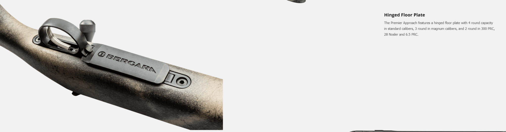

The factory configuration Bergara Premier Approach uses a hinged floor plate design. No AICS compatibility unless you switch out the bottom metal.

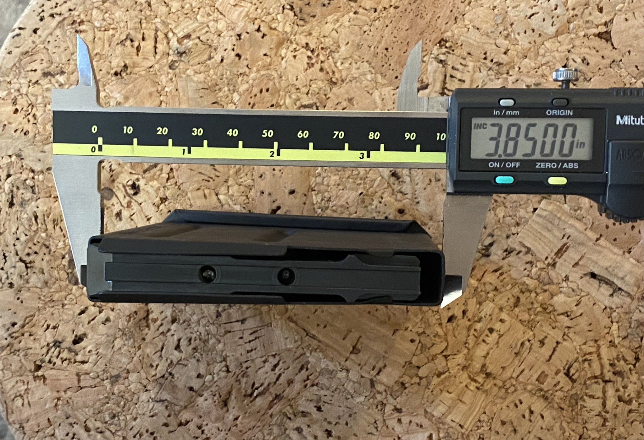

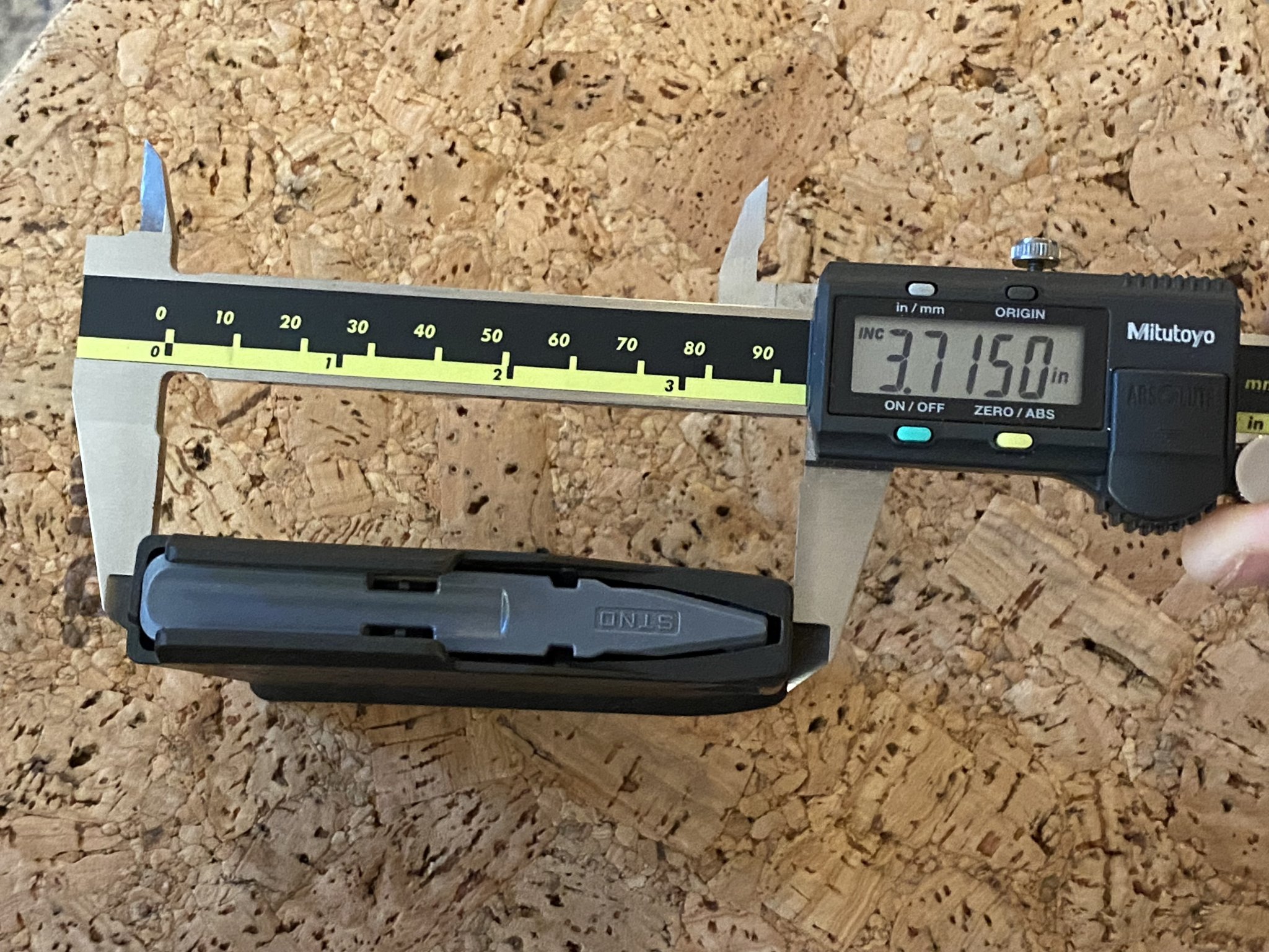

If you did switch out the bottom metal, use calipers measure and the mag well dimensions fore and aft, then measure your mag. 3.715 (standard) or 3.850 (CIP) are outside dimensions for the mags.
The Oryx chassis only fits 3.715 mags, if you buy 3.850 mags, they won't fit in the mag well.

Is the 3.8/3.7 an outside dimension? Because yeah--calipers and boom.
