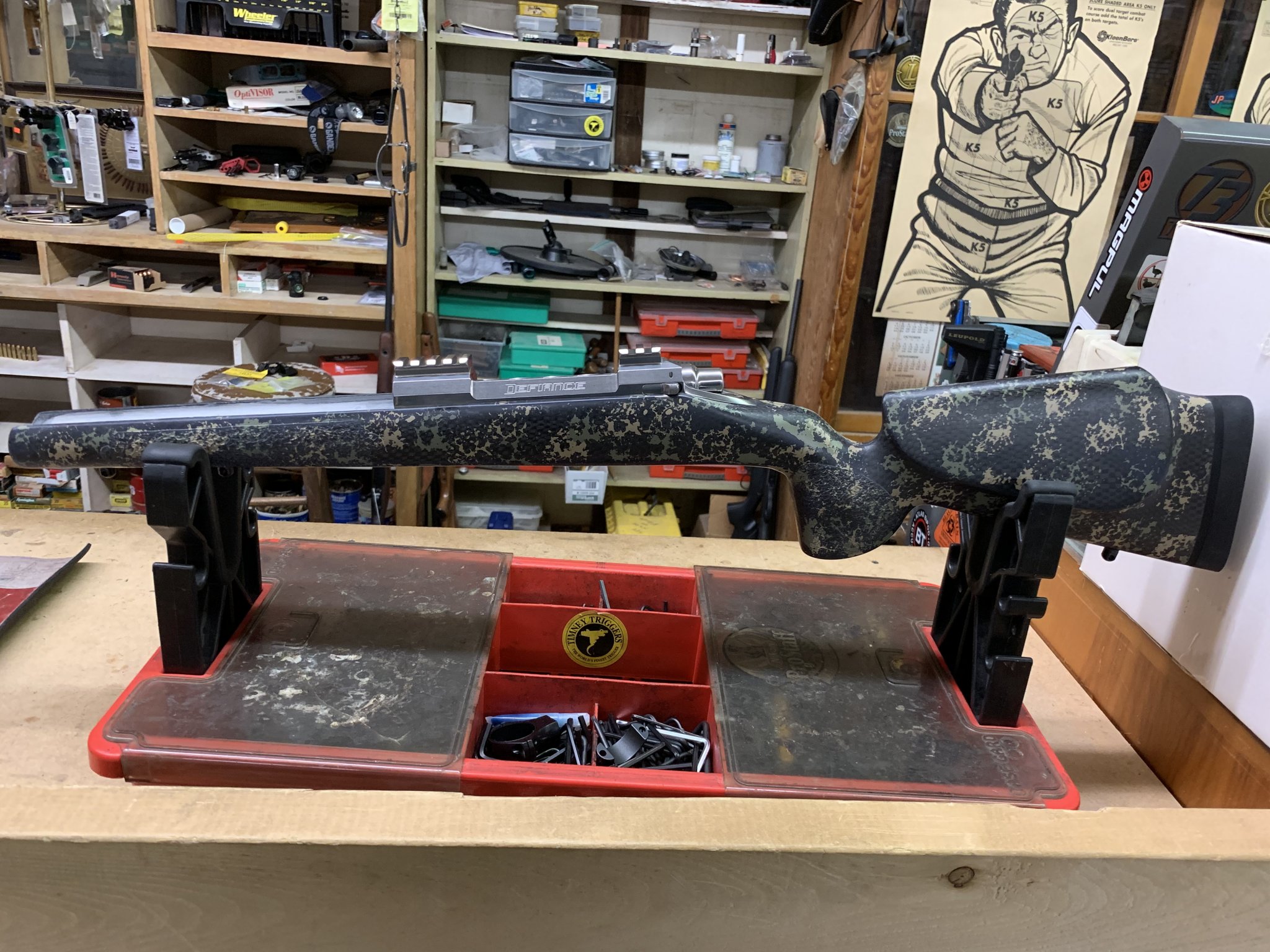

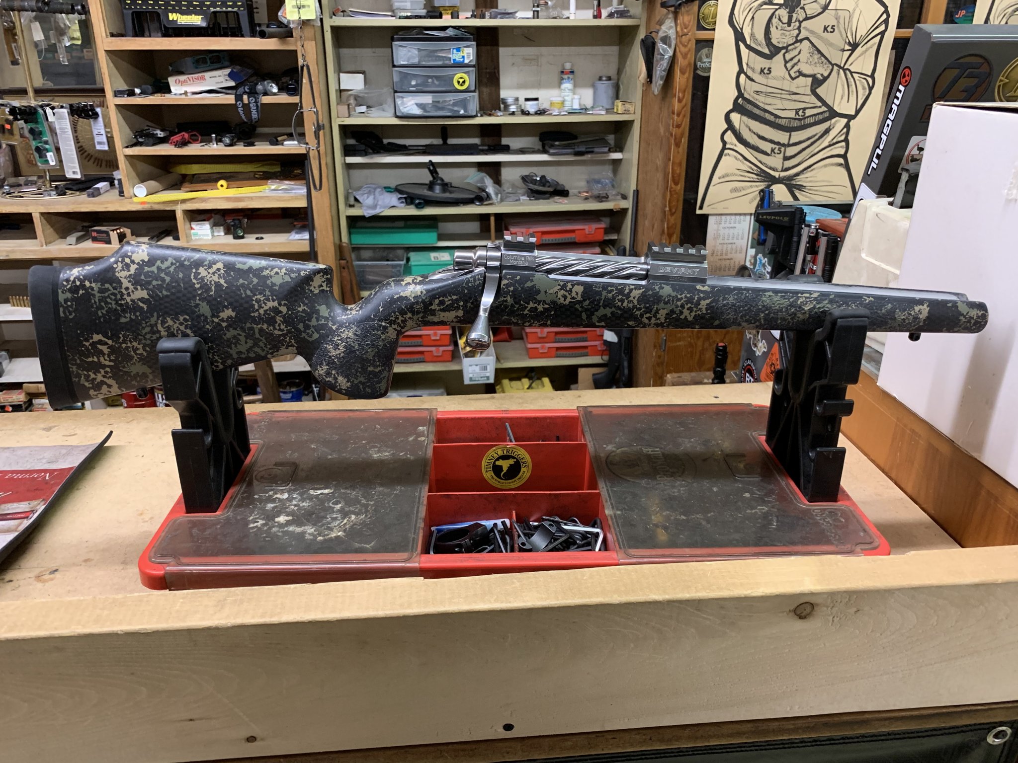

I got my 300PRC built on a Mausingfield Hunter action from LRI. Only put around 20 rounds through it so far as I've been focusing on my 6.5CM shooting, but that action is impressive. Only regret is wishing I had bought a Proof CF for it at the start vs ordering one separately that should be getting here any day now.
